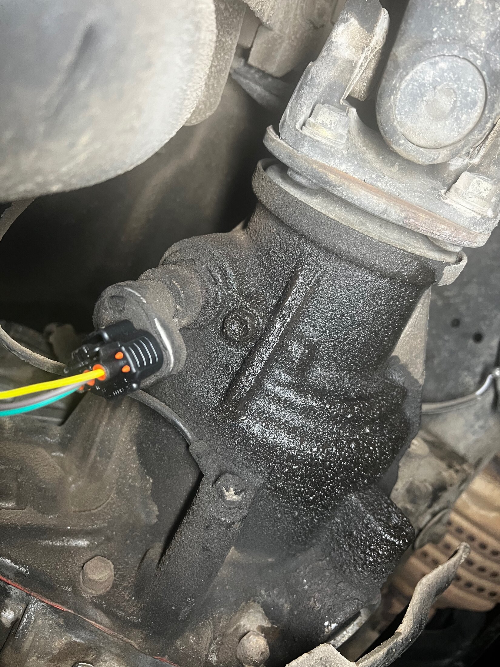

Installed my Lutz Speedo Correction kit a week or so ago. When I was under the truck this evening I noticed this leak on the TC.
Looks like its coming from the seal between the harness and the TC. Not exactly sure what you call this harness, but does anyone know if this is a simple r/r of an o-ring or is it more involved?
Haha, thanks! I used all sorts of search terms, but not "speedo", duh.
Should be an easy fix!
This is the way...one of the more satisfying (and cheap!) leak fixes on the 80. My t-case was soaked when I first got the truck and the little o-ring on the sensor did the trick.
