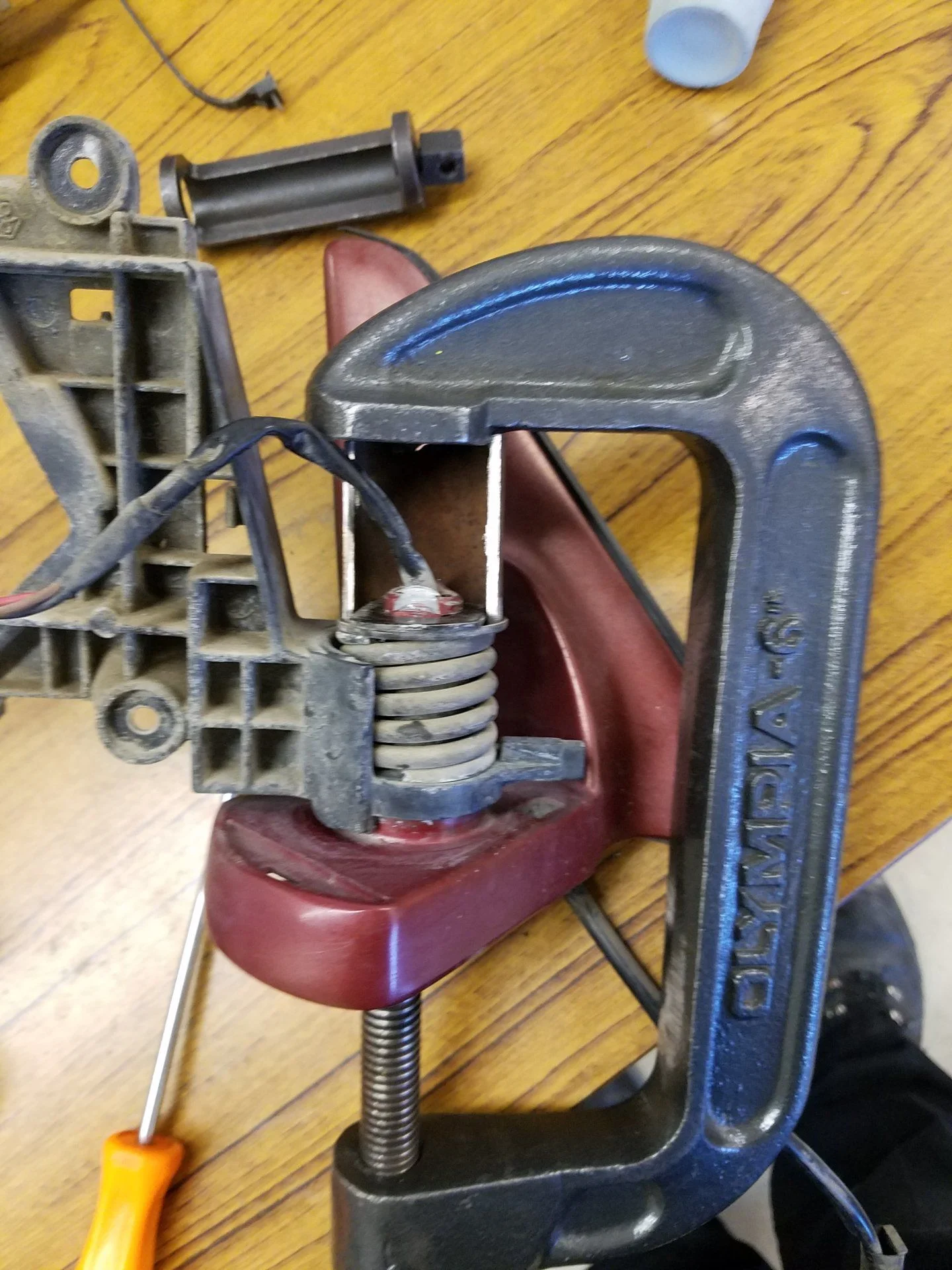

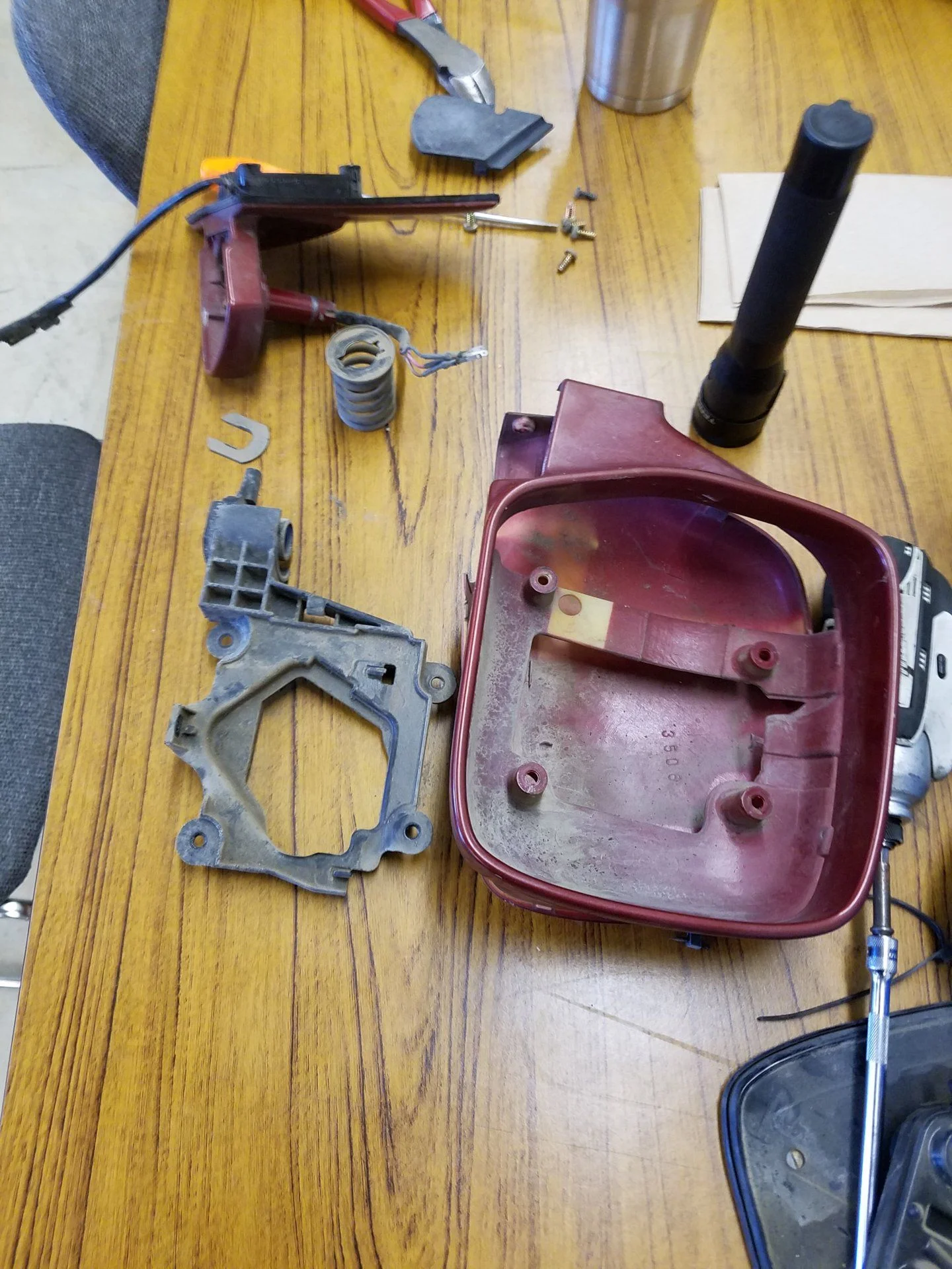

Had the loose mirror issue which started a couple weeks ago. Finally got around to pulling it off for the fix. Quick research led me to the @Tools R Us solution found here.
1907961
While not everyone pulls the mirror totally off, I chose to do so. This method involves grinding new slots for the retainer clip 90° from the old, broken ones.
1907962
1907963

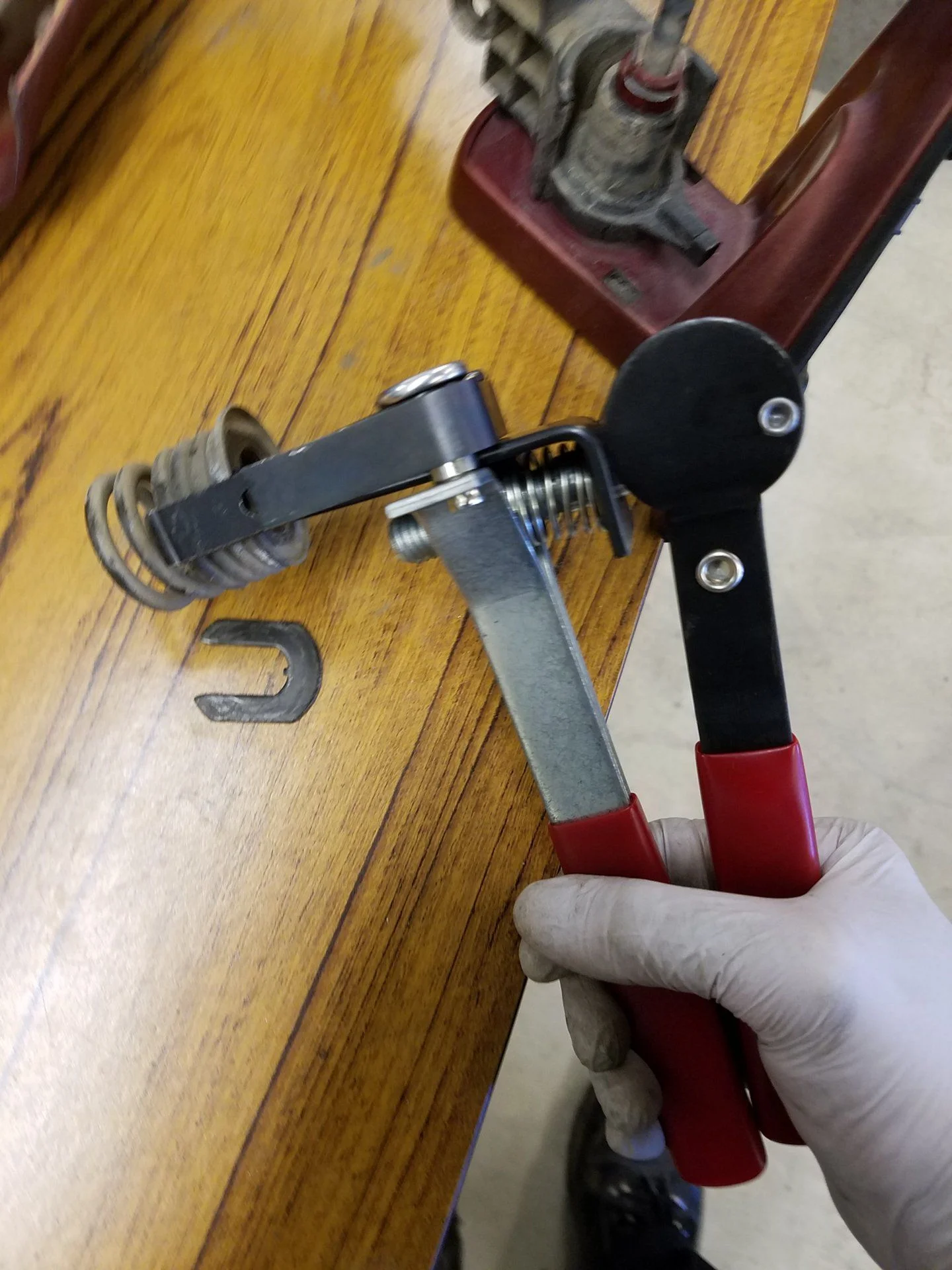

I first tried to use a valve spring compressor, which was strong enough, but too bulky for the job. Instead, I whipped out the grinder and made a little tool to use with the C-clamp. It worked like a charm.

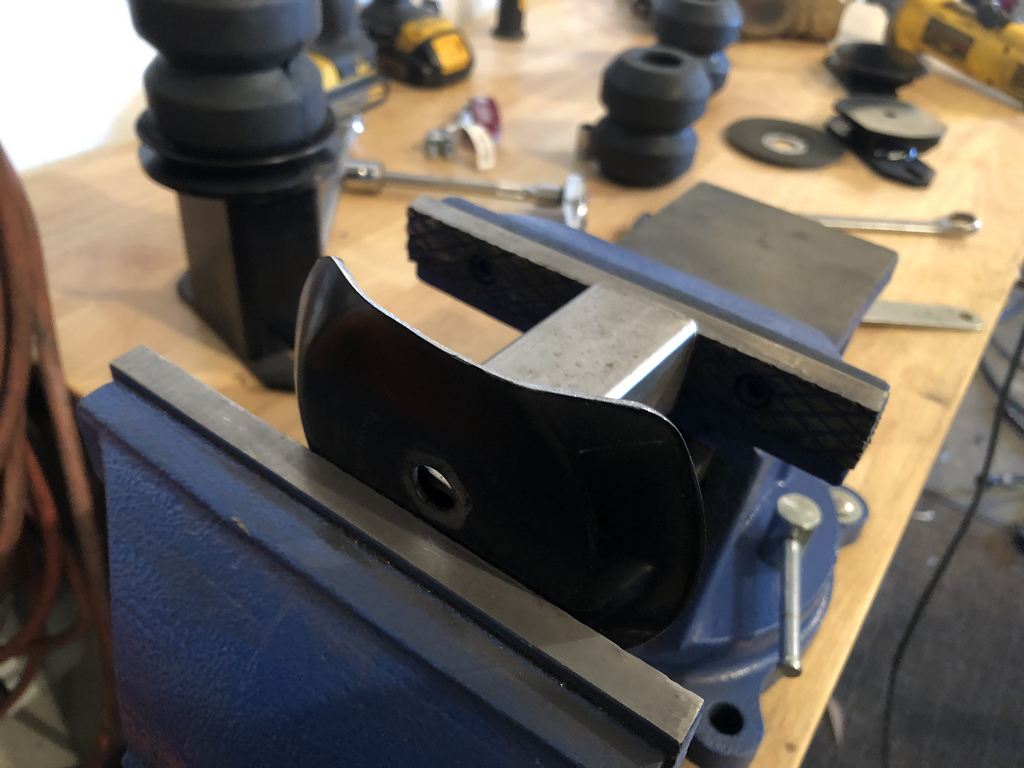

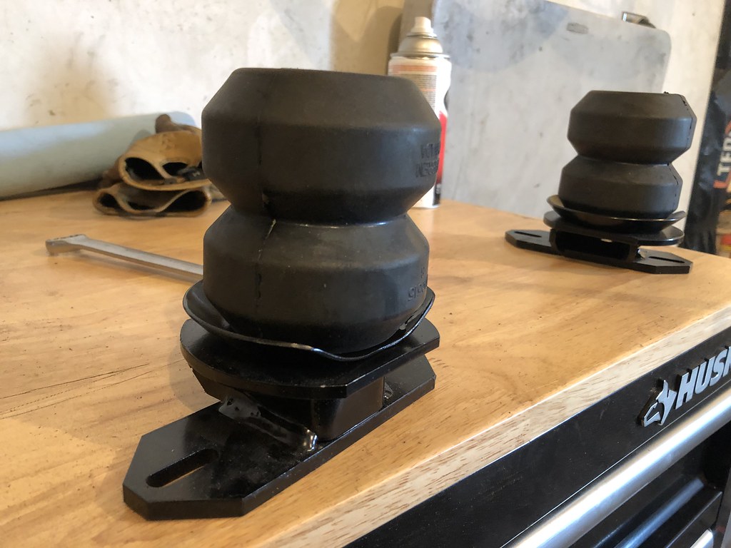

Getting my Timbren bumpstops installed. Still need to modify the brackets for the rears, but I got the fronts installed. The cups needed to be trimmed a bit so they don't hit the Slinky springs. Compressed, these will be roughly equivalent of the 1" taller solid rubber ones I had on the frame.

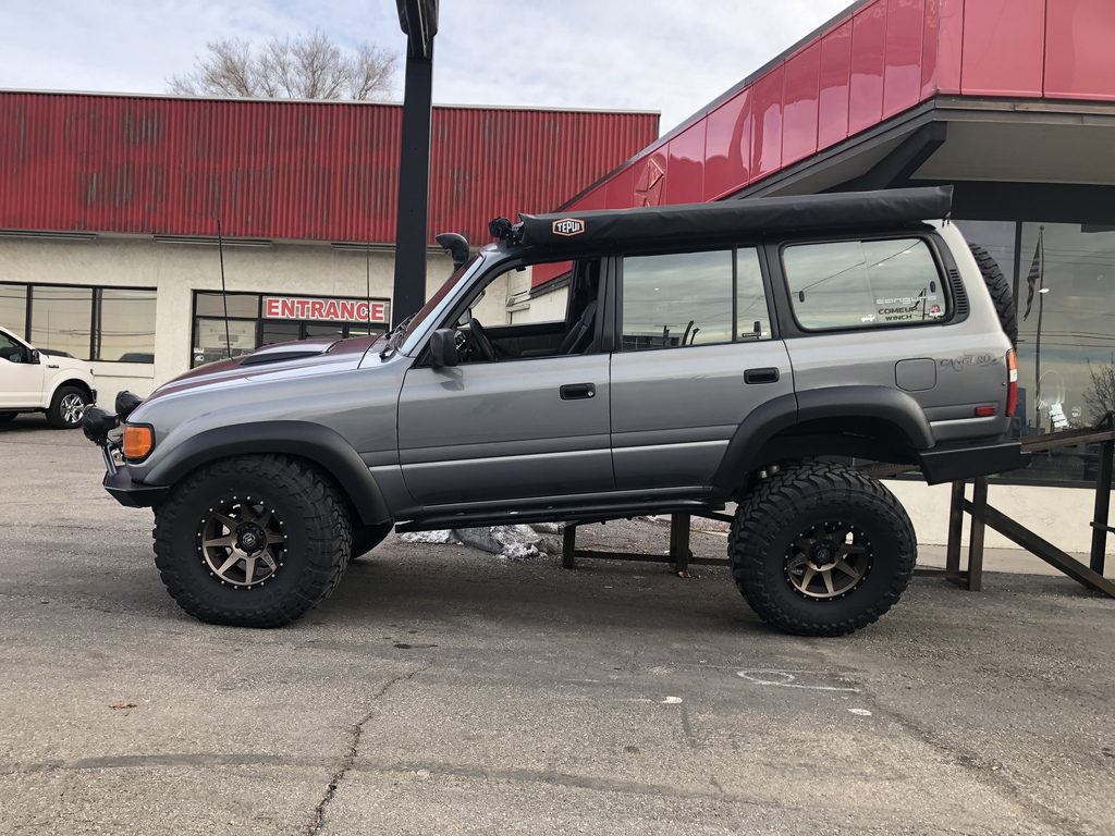

Forward 1.25” seems like a lot for a 3” lift. The package looks nice though.
It's not for caster correction. Just for making more room for large tires at the firewall.
Exactly...... +3” requires approx 0.25”forward. You have definitely improved approach angle though. I understand you are making 37’s fit. I trimmed a little bit off the lower rear portion all fenders and pushed the front inner fender back to meet it. This worked well with stock arms and now with the Delta 6” arms installed and being 0.5” longer, putting the axle in the correct location, there’s even more room behind the tire. Looking forward to seeing how this all works out for you because I know those Toyo’s are a wide tire.
Right. Definitely moves the axle farther forward than stock location but makes huge difference in making room for tires at the back of the fender/firewall.
This isn't fully stuffed but you can get an idea of the clearance gained at the back of the fender.

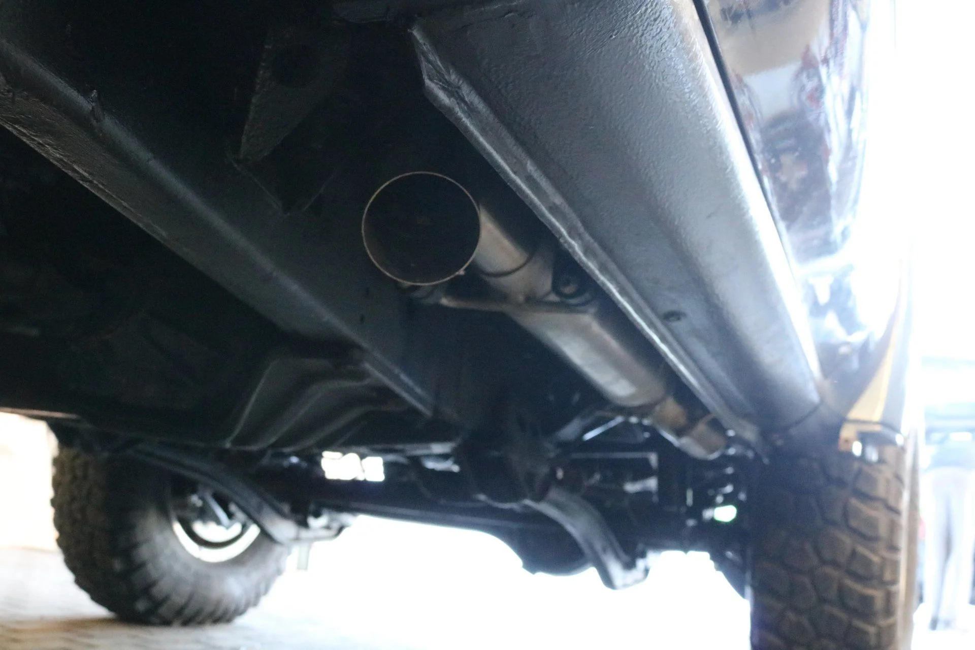

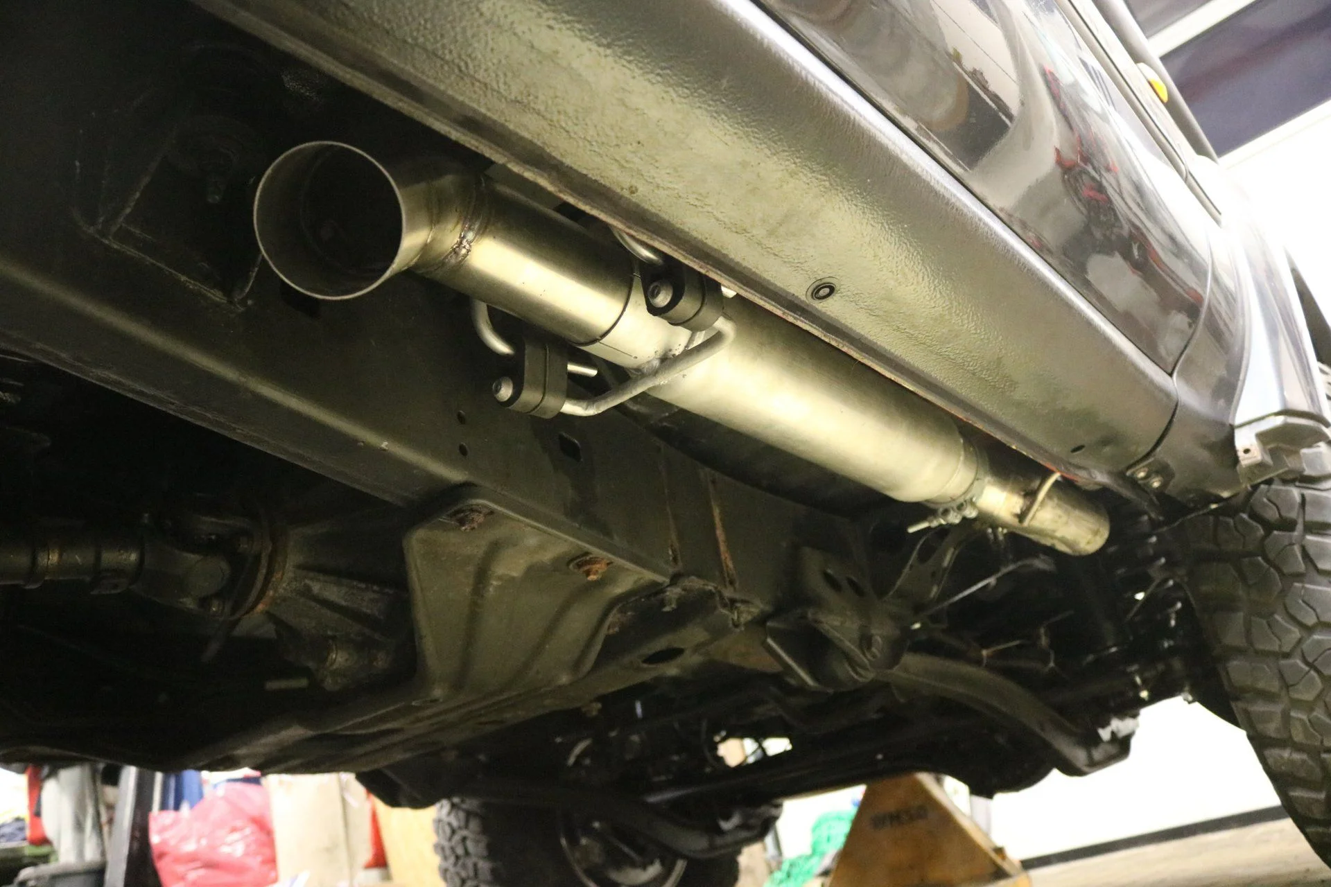

While I'm sure that looks and sounds great, I would be concerned with exhaust getting in the cabin, particularly when idling or slow moving such as on trails because it does not protrude beyond the body.

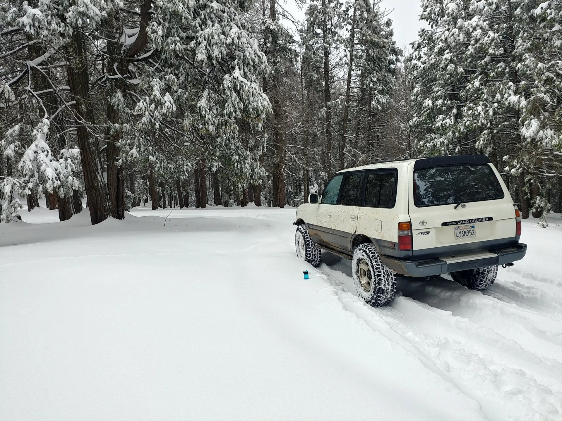

Took my stock 1995 FZJ80 and my buddy Chris on the Pacific Mountain Cruisers annual snow run. Turnout was down this year but we still had a great time. Chris got to use his chainsaw and I got to lead until we were in waist deep snow and had to help each other to get un-stuck. A great day out with a great group of people!

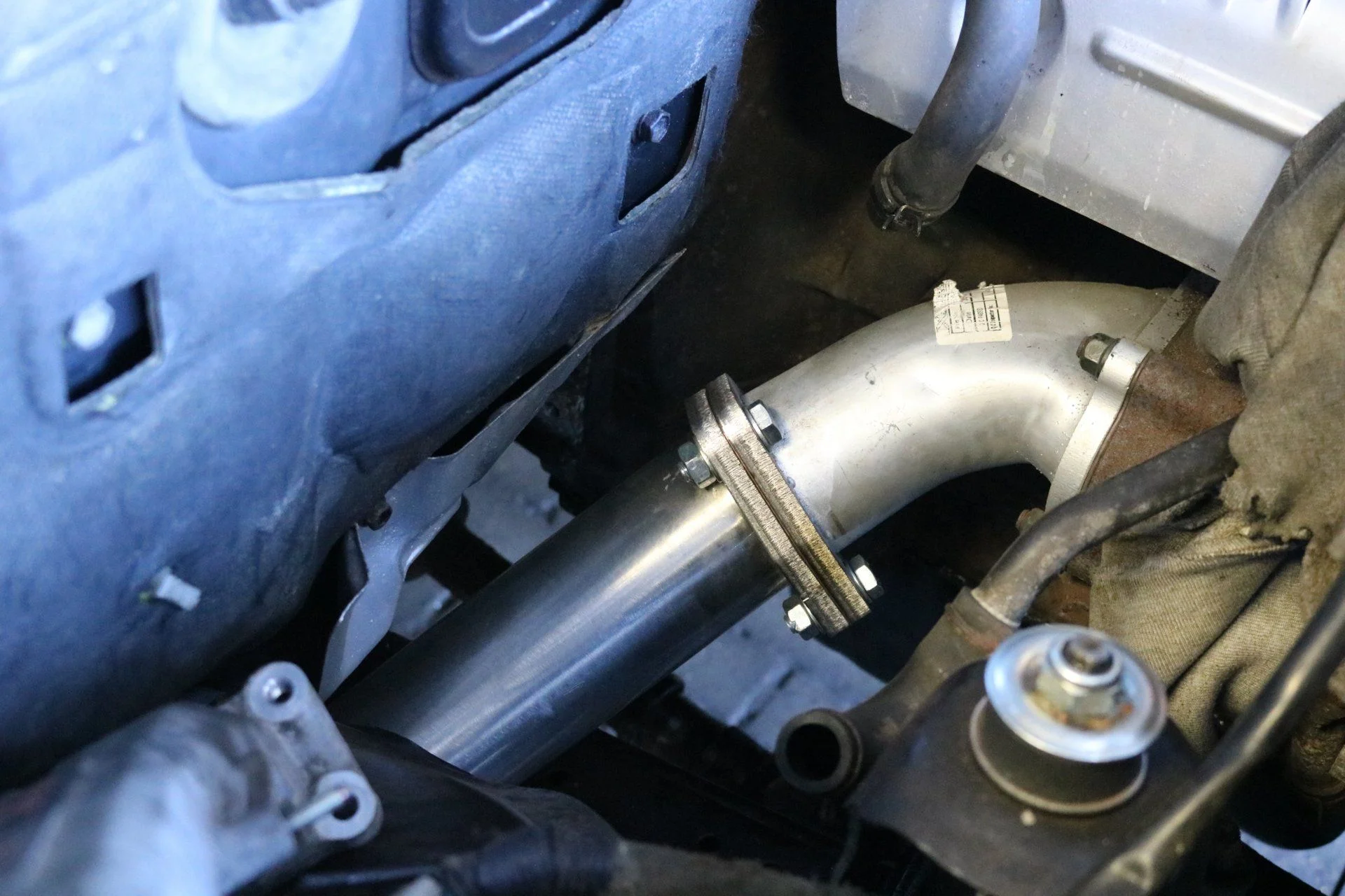

Thought about it. We tried to keep the exhaust as high as possible because of ground clearance. Limitating factor is the body mount. I can not remove it, it is the last one on the cutted body, followed by the camper box. Shown a few pages before.
The last ellbow is blowing to the ground, a little bit back and to the right. We will find out. Eventually i will close the window on the passenger side while idling.
