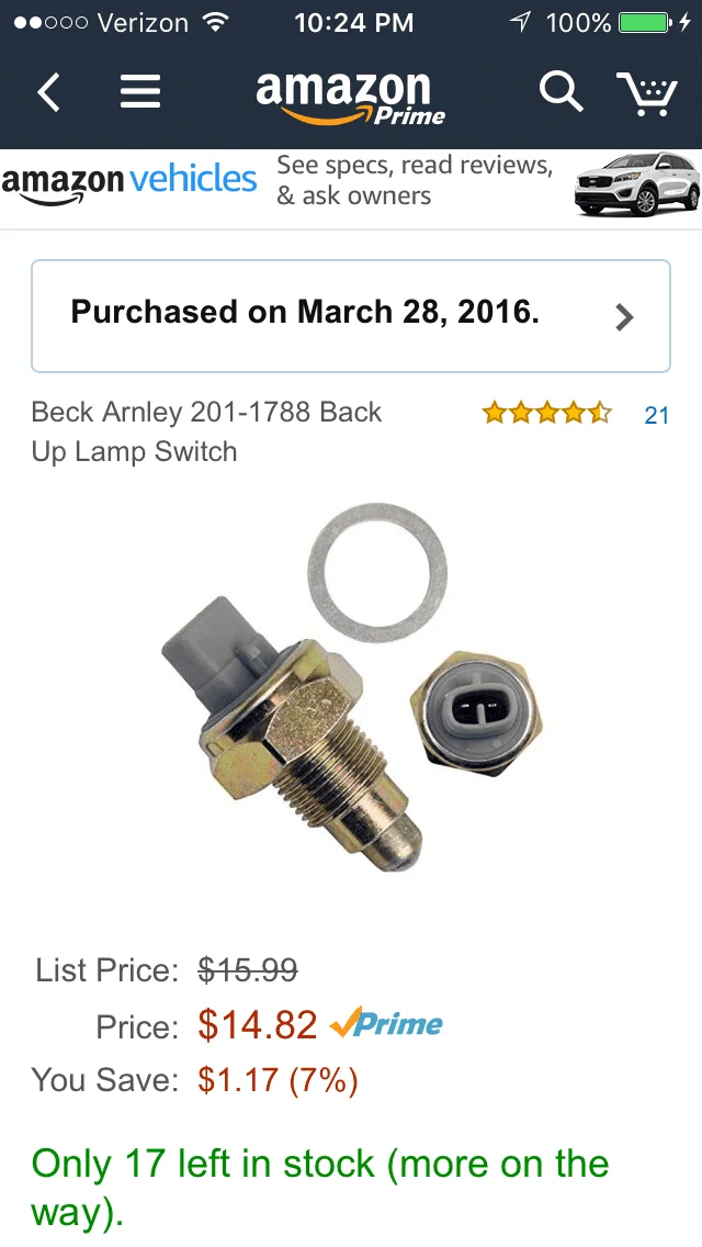

27mm = this sensor is 27mm. On the transfer case.
27mm ... knock sensor

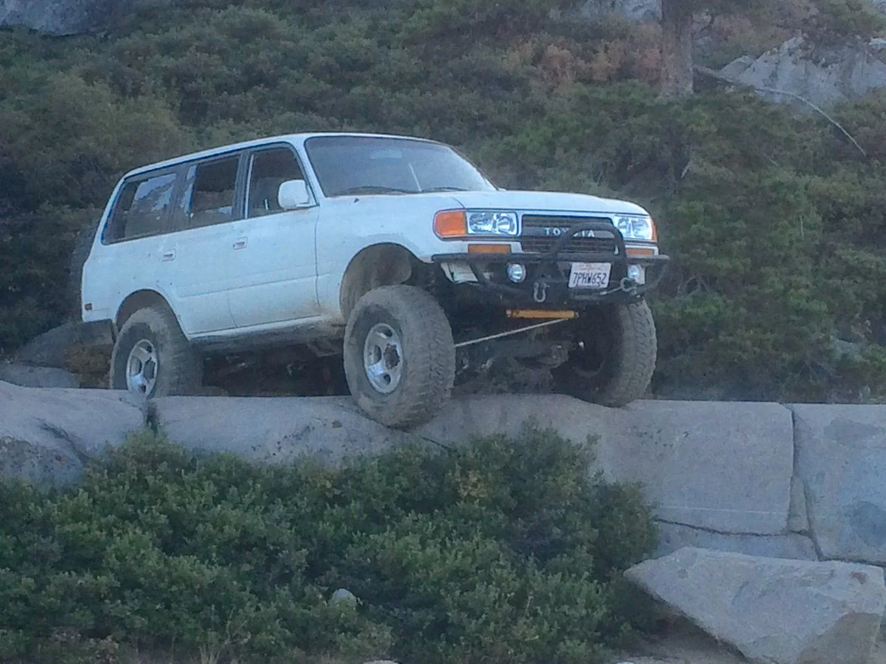

Hit the Tahoe end of Rubicon at 9pm Friday and wheeled in to Buck Island Reservior through the night, alone. It took 6.5 hours, a couple of winches and high lift Jack sessions and one shattered rear hatch window but very rewarding as there is little room to error especially when you are solo. I spent three nights on the trail and headed out the Loon Lake end Monday. As usual I met lots of great people and saw some nice rigs. My photos are boring as I can't snap cool pics while I'm drive but I'll work on it. :)

View attachment 1317627 View attachment 1317623 View attachment 1317625 Hit the Tahoe end of Rubicon at 9pm Friday and wheeled in to Buck Island Reservior through the night, alone. It took 6.5 hours, a couple of winches and high lift Jack sessions and one shattered rear hatch window but very rewarding as there is little room to error especially when you are solo. I spent three nights on the trail and headed out the Loon Lake end Monday. As usual I met lots of great people and saw some nice rigs. My photos are boring as I can't snap cool pics while I'm drive but I'll work on it. :)
Going backwards against the grain to pass every rig going up... your such a REBEL...
