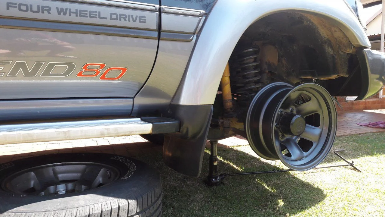

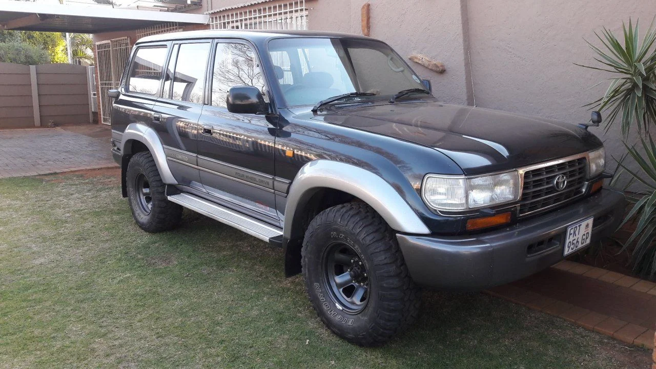

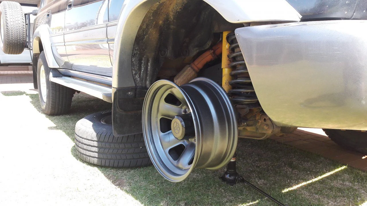

As you guys know, it is very difficult to find 15 inch rims to fit 95 upward models with disc brakes. Had my buddy to change/modify my 15 inch Hilux wheels to make them fit on the car.
Silver wheel is the standard wheel
Gun Metal wheel is the modified wheels.
He cut the centre dishes loose, machined the smaller to go on in the inside of the rims and moved them 30mm deeper, and the wheel is a -30 offset now. Running 32" Maxxis at the moment but won't go bigger than 33s.

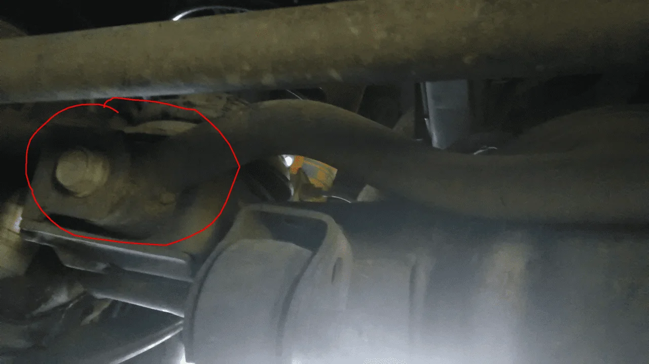

Before I call you guys over to help fix it, I need to ask you if this is the one I need to loosen up.
On the PS it seems impossible to get to the nut since it resides inside a "box"
The other one is the steering rod, which I am not sure if I need to touch at all in my case.

Loosen the one on the passenger (axle) side. The nut is a captured nut, just need to loosen the bolt.
@jtwopark if he's changing suspension it a good idea to loosen the trackbars and links until the new suspension is installed and the truck is back on the ground at ride height, then re-tighten them. Allows the bushings the adjusts for any changes in height/geometry.
Either m impact gun cannot handle the amount of torque the two front lower control arm or the nuts are welded in place.
The 22mm nuts will not budge at all.
Hit with some PB Blaster and let em soak for a day or two. Mine were seized badly when I was moving all my old suspension stuff over to the new truck after I got it.
The bad thing is in the PS where I got the diff locker in the way.
I can only do it on the bolt head side if I take the wheel out, but on a previous page someone said not to do it on the bolt head side since it's got some teeth to grab the metal bracket.
I see a washer there, is the washer the one which can mess up the bracket?
