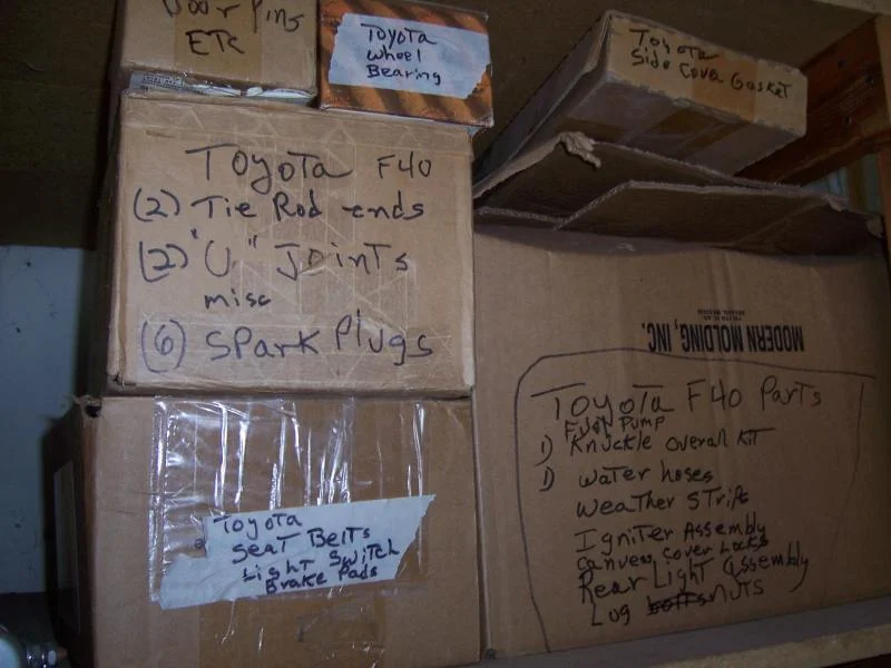

I'd appreciate any info you can give me. I've got spare parts (of course), new metal for many of the rusted areas, original hard top and ambulance doors. Runs great. Uncertain of miles- speedometer quit working well some time ago but I know it's over 130K. Engine was rebuilt about 30K miles before we bought it in 2001. Thanks in advance.

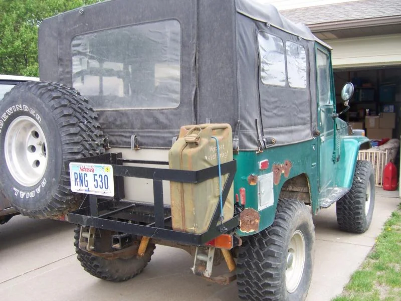

Vinyl factory-style softtop, the "bows" alone are worth about $600, and the top another maybe $400.

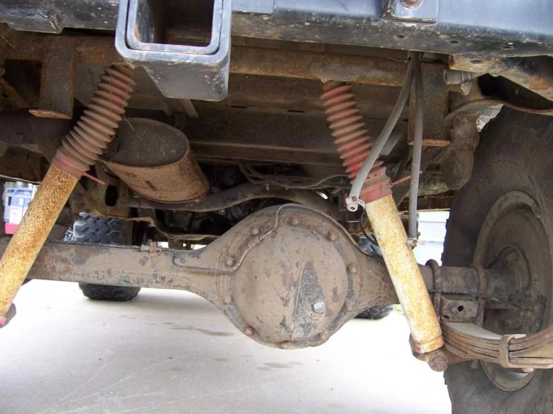

33x10.5 tires, 2.5" or 4" SUA lift.
Nice Nato gas can with holder for four cans or one and an ice chest.
Warn or Bellvue winch with nice bumper and roller fairlead. It's not a PTO winch.
Some pretty good rust there on the rear quarter panel.
Rear aux fuel tank has been removed.

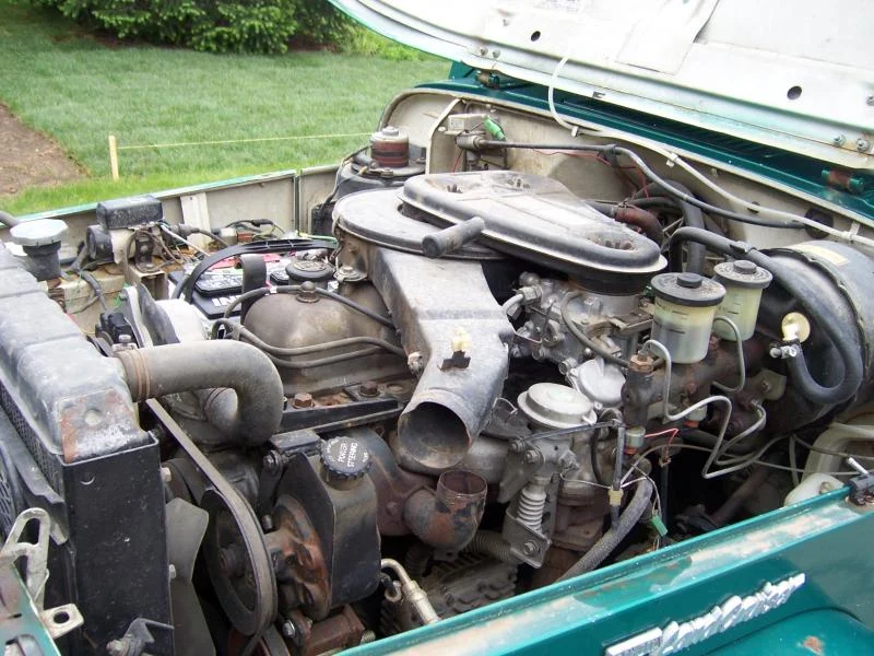

Can't see the power steering in any of these pics. Need pics of the interior and under the hood.

Sylvia looks like you husband had great tast...an oem style soft top is a big bonus...it is a Pakistan top ...not oem....but still very good and he had kept the top in good shape...did he buy the top or did the truck come with it?
looks like a 1978? fj40
33" sidewinder Mt radial tires
Bellevue Winch
Good lift maybe 4" total?
Reciever
Alloy rims

I was going to say it must have been an early ehsan top...he hasnt really been making the single large window in the back for quite some time...he definitly has some posts on here if he was on that group order...the early group orders took well over a year to get their stuff.
for those reading it a '76 FJ40

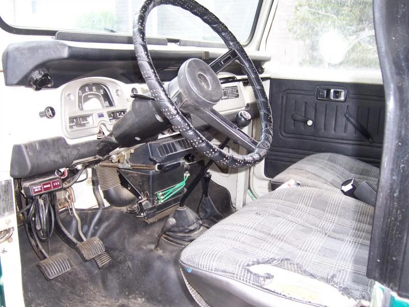

There is a PTO shifter poking through the floor, PTO box visible in undercar pic. But no PTO winch on the front. If there is a PTO winch in the parts stash, the PTO+winch package can be worth some money. Since there is already an elec. winch on the truck, the PTO could be pulled off, and the whole PTO winch set-up sold separately. Depending on condition, can be worth anywhere between $400-$1000.
Looks like a Mini-Truck PowerSteering install. A good upgrade that is not very intrusive to the truck.

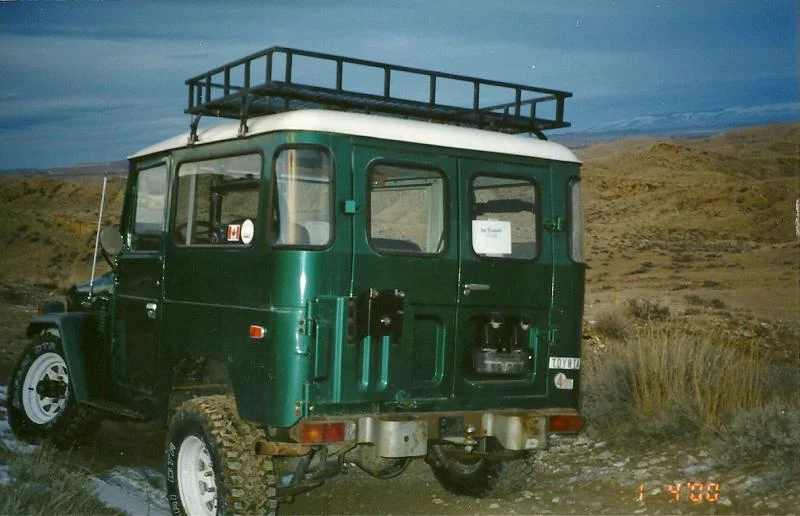

here are some more pictures from Sylvia they bought it in 2000 looks like the 1st picture was before some mods...she does have the hardtop mayhave sold the rack...
