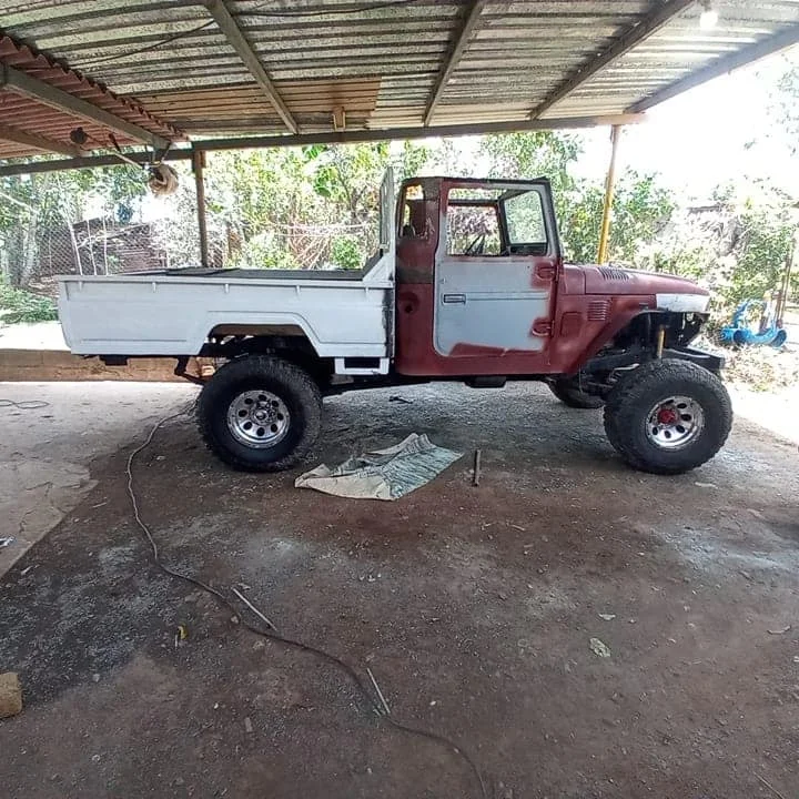

I'm a few borders south of the border visiting for a few months, and I've started looking at classifieds at classic Land Cruisers to drive back north.
Unfortunately I don't know enough about them to make sure I don't waste money.
I was looking at one project to start with, a pickup. Ad says "mechanically perfecto", but bodywork, not so great.
From the two pictures that are posted, it looks solid, with the exception of the roof, which is missing.
I have sent a couple of messages to try to find out more. Not even sure about the year.

Anything is possible! But the consensus is that SA trucks are trashed. Prove the masses wrong and rip it north and enjoy it.
These trucks are made of metal, fix what it needs if you have the KSAs
assume the worst, you wont be disappointed
I bet $7500 is the fuel bill to drive it home. Look into import fees, documentation, wait times, and some sort of insurance. Good Luck. I have had my FJ for 40 years.
I bought one in Honduras. I saw it before I bought it while on a mission trip. I would highly recommend looking it over really really well. It will probably be covered in bondo. Make sure you check the frame too. Trucks get taxed at 25% when they come in. You can probably expect to pay 2x asking price after all the fees taxes etc. I’m glad I bought mine and I learned a lot about importing, however I probably will not ever do it again from Central America.

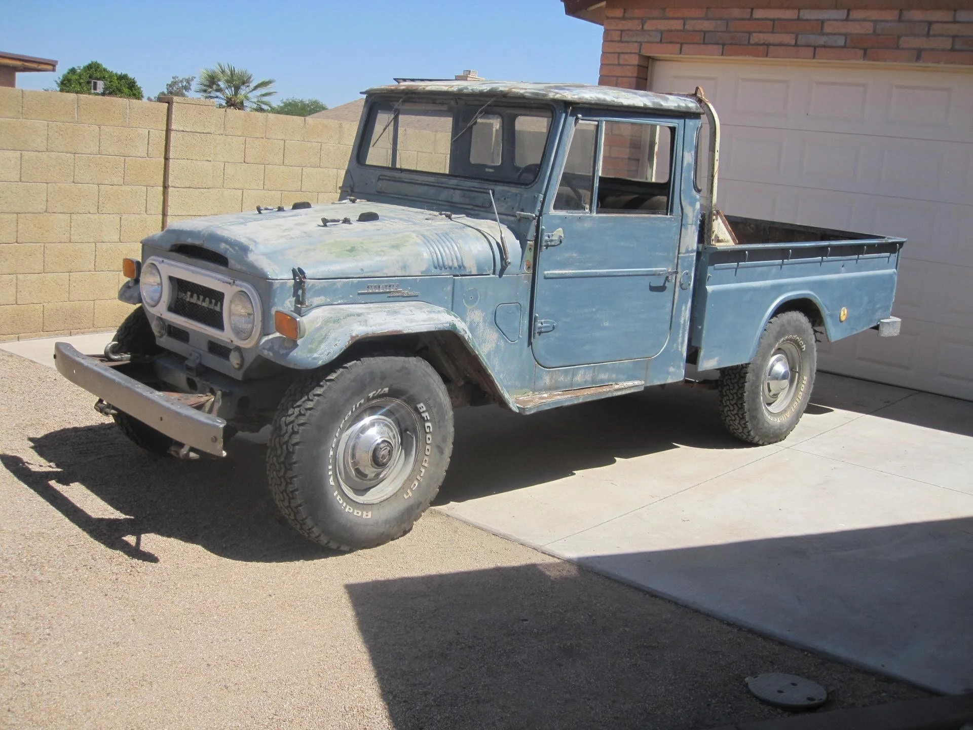

This is what a FJ45 bed looks like. That one looks repaired thatway or maybe of a 70 series or other vehicle.
