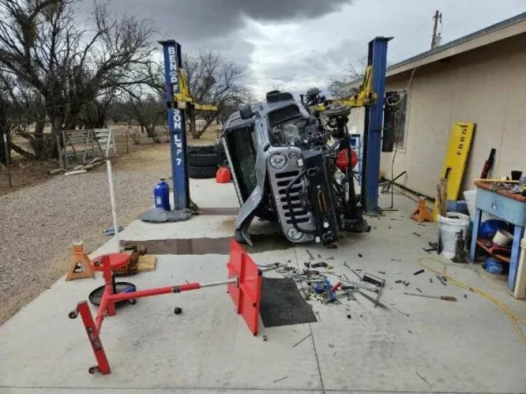

Couldn't find any backstory on this one.
Looks like the arms on the left upright swung out?
I suppose it's possible but highly unlikely. Those arms lock into place with large meshed teeth once they are an inch or so off the floor. I'm thinking they were doing something to the Jeep that caused it to slide off that side. Human error is usually the root cause of these types of incidents.

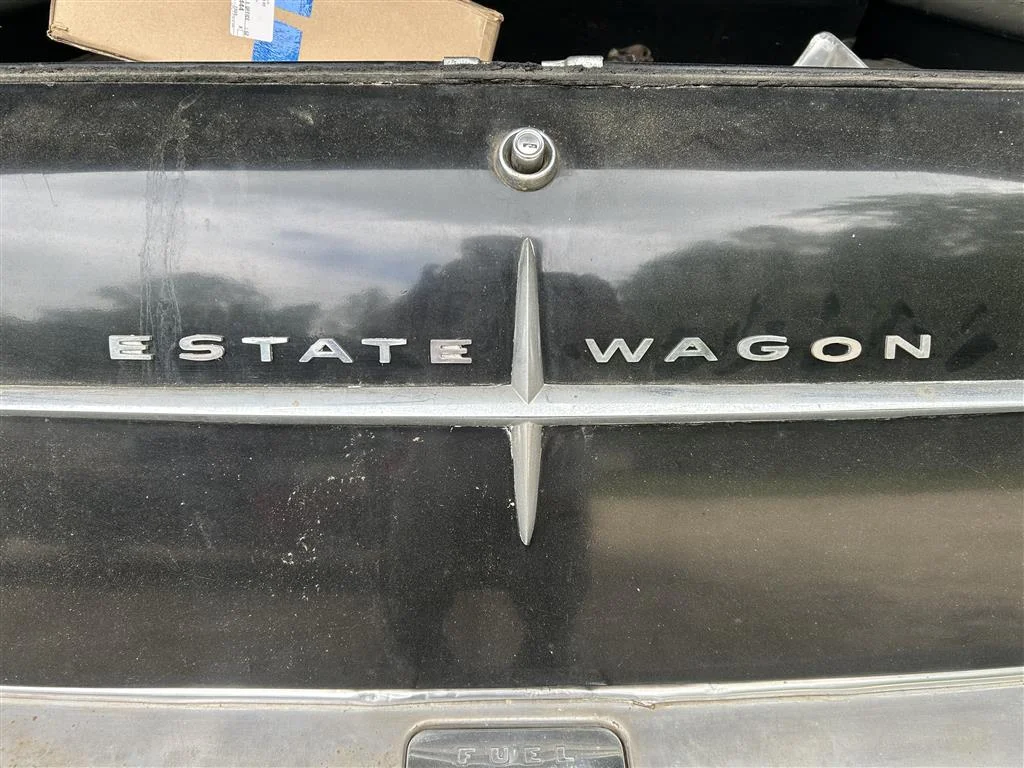

Big thanks to @Jdc1. I've been looking for a set of tailgate letters for my '58 Buick Caballero wagon for a couple years. He connected me with a guy that knew another guy and I finally got complete set. But it wasn't without the requisite comedy. First set was lost in mail. Took a while to catch back up with seller and fortunately he had another set. They really need to be restored but since I'm planning on leaving the car as is I'll probably leave that for the next guy.
Glad it worked out- USPS is a complete joke when you have something important and rare.
These letters are hard enough to come by and you found a guy with TWO SETS?…awesome!!
I think he has a Buick junkyard. Believe that's the last set he had. After all the trouble/cost I'm a little underwhelmed now that I've got them.
I get it. When I was an active restorer, there were always parts that were the ‘holy grail’ and the hunt would begin. After that was in the bag…it was either a great score or just another brick in the wall….but always for the betterment of my project.

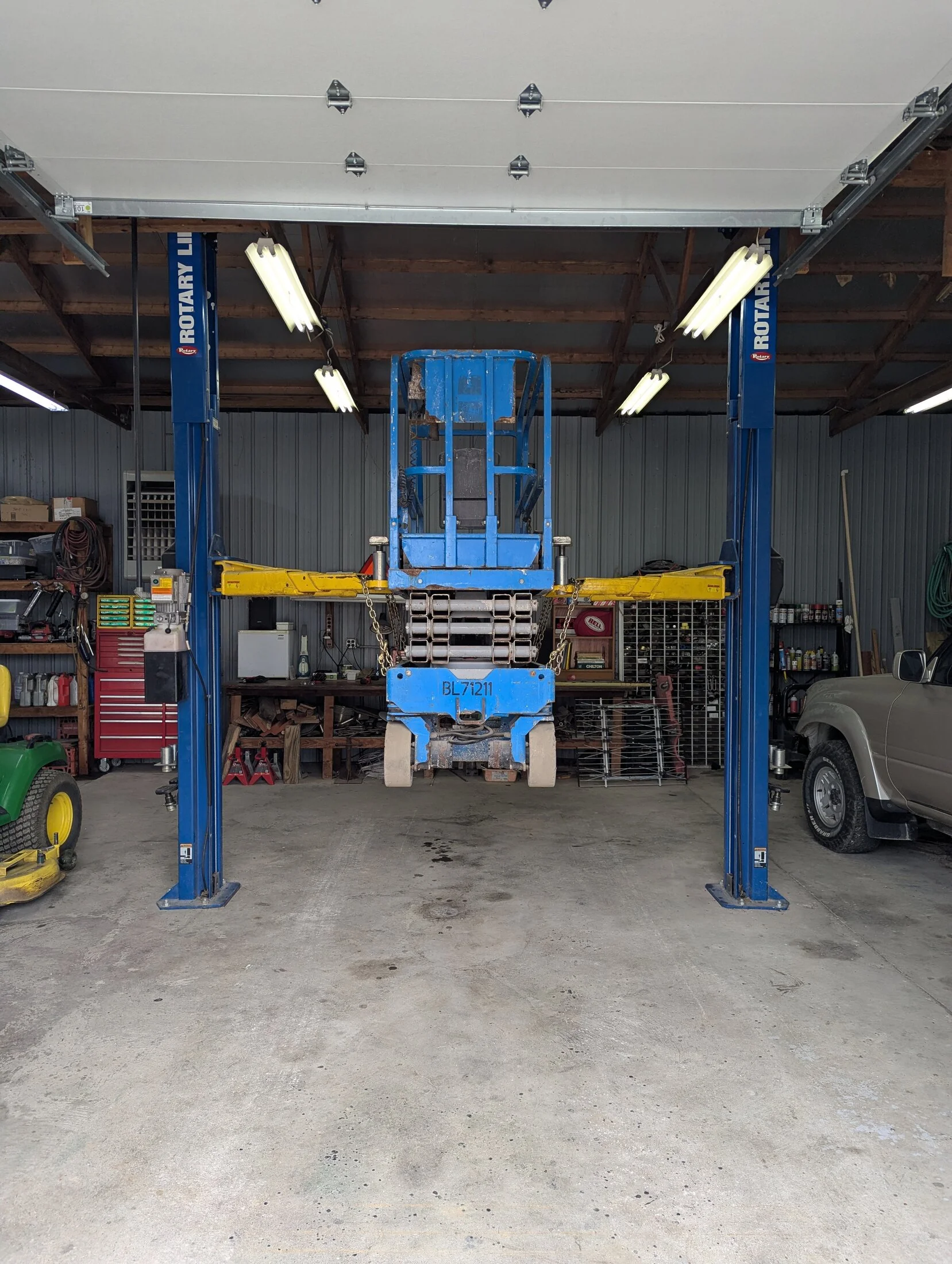

Manlift is a good addition to any shop with high ceilings. The non-motorized lifts are fairly cheap and show up often on the surplus sites. I'll never wrestle/climb a ladder to change a bulb again. Large one only has a 12' platform height but that's good enough to get you 18' working reach. Picked up the smaller one to use around outside of house. 30' reach but gets a little sketchy up that high.

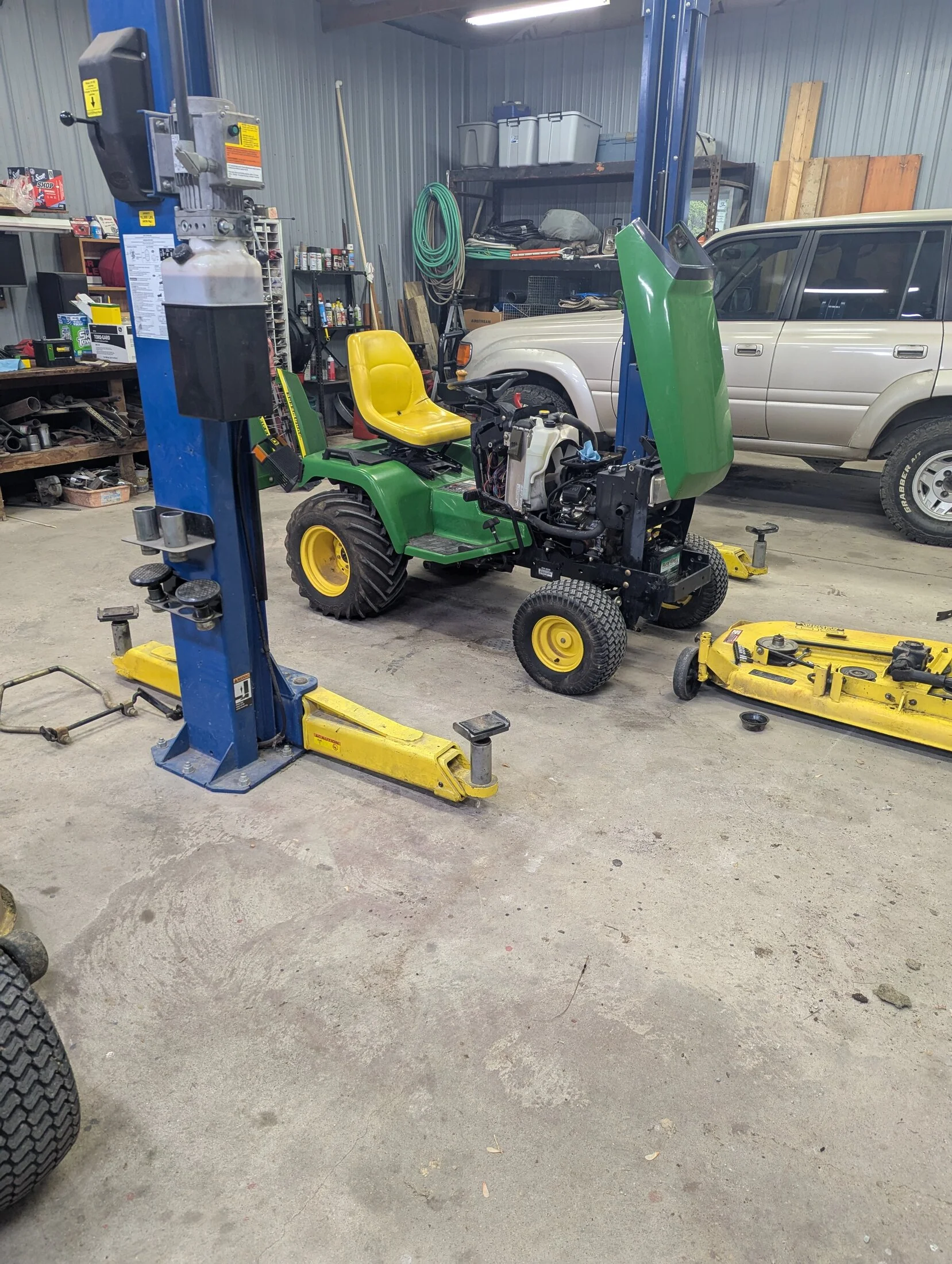

I would like to make some kind of attachment to my 2 post to lift up lawn mowers, golf carts etc. Thinking about something like saddles for the tires.
Any one adapted their lift for this purpose? What I have pictured are pipe stands salvaged from a water treatment job. Was also thinking about something like the Go Jack style tire dolly that goes around both sides of a tire. Make them adjustable.

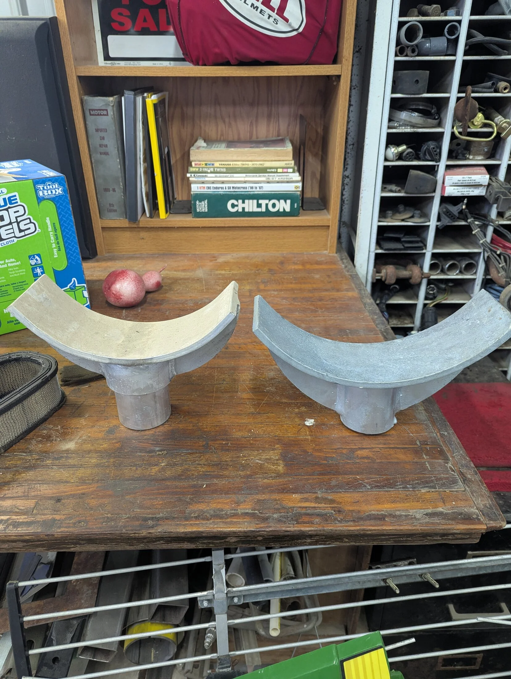

No pics but a friend has a 12k BendPak with long triple extension arms. He made some curved plates to plug in each arm and can lift a car with the tires just sitting on the plates. Seems a little sketchy to me but he works on high dollar resto mods so must be comfortable with it.

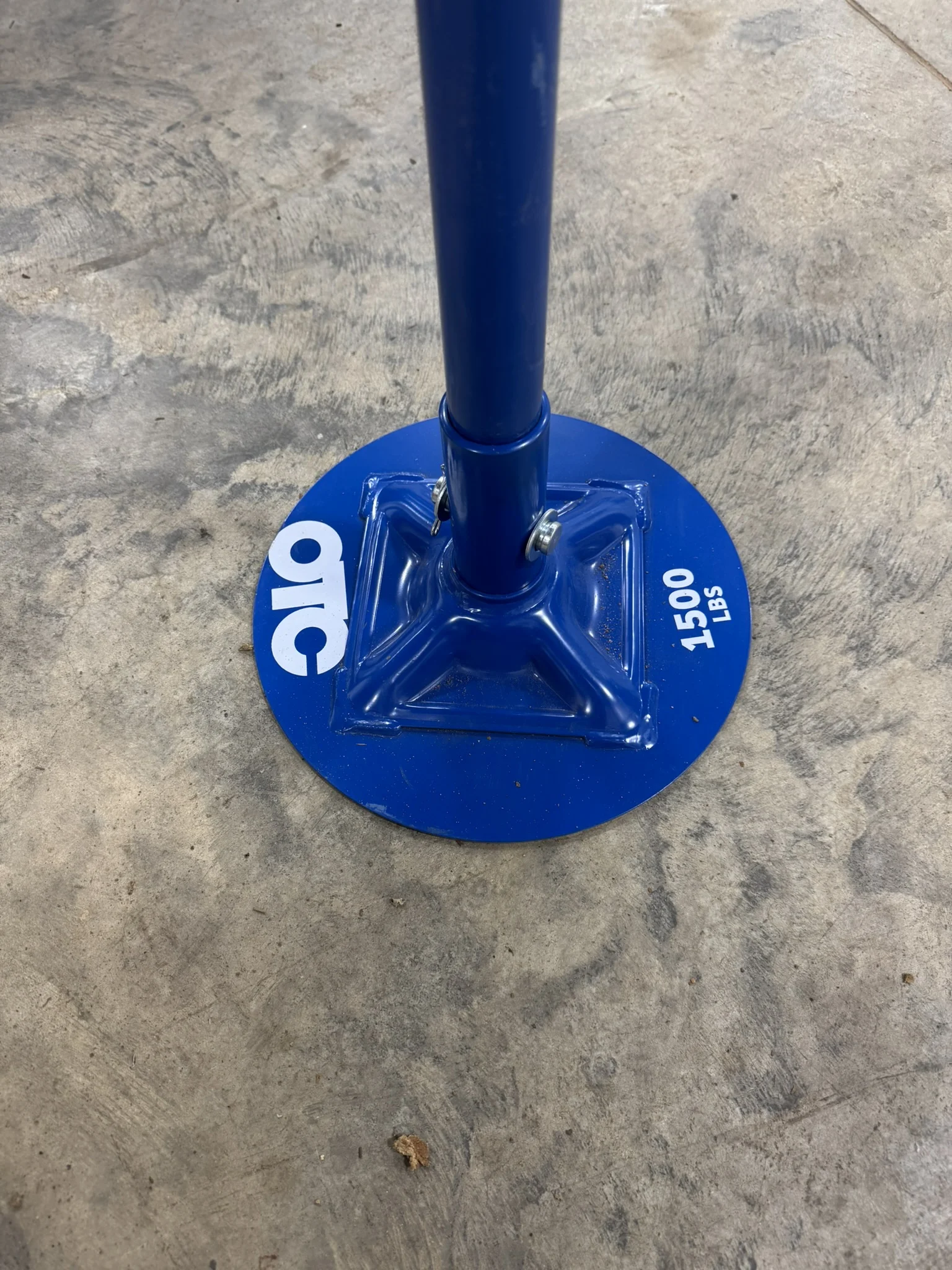

Apologies if this is a repost as I recall some discussion on pogo stick supports earlier in this thread. I bought this one a few days ago and can totally endorse its quality, especially for the price, if you need one. And anyone that has a 2 post lift needs at least one if not two of these.
