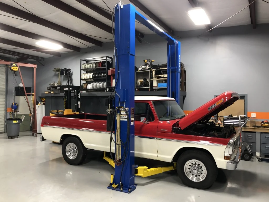

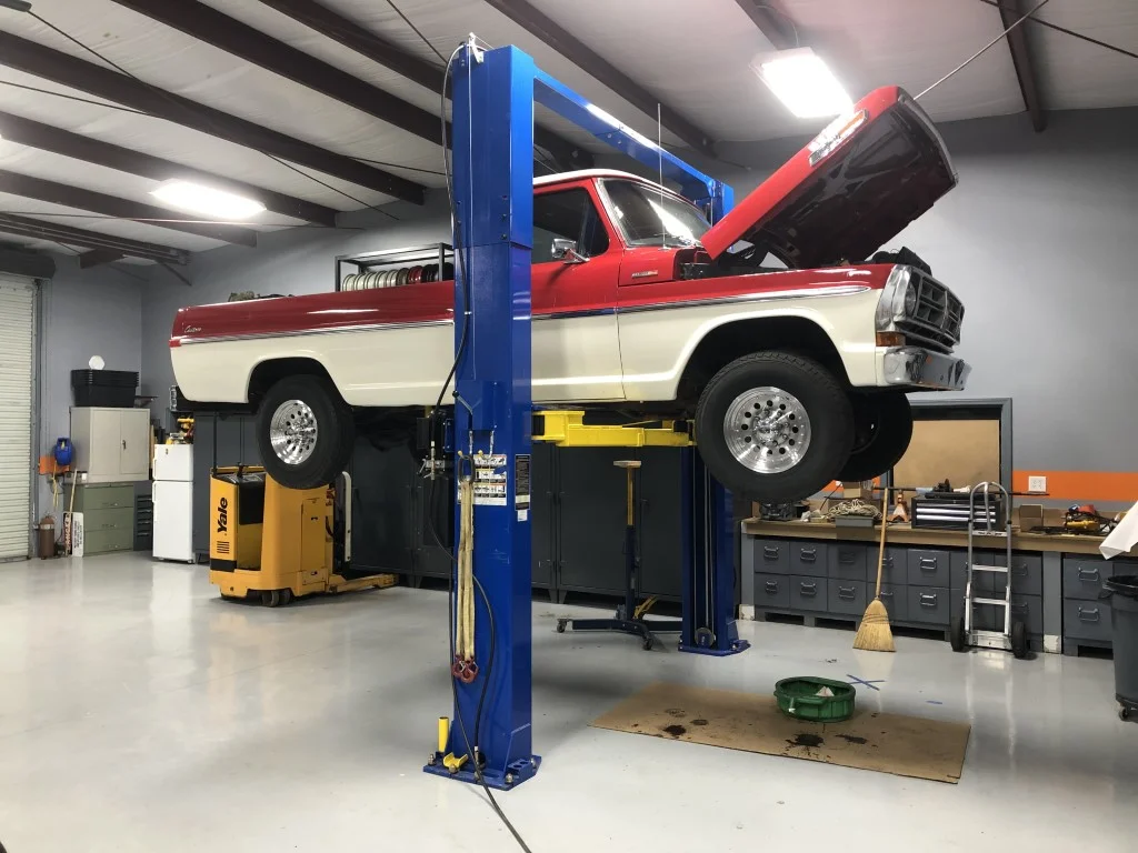

There's a lot of good lift info here but it seems to be scattered in various workshop threads. Would be nice if lift info was a little more consolidated so here goes. Post up your lift pics, info, questions, etc here and maybe this can become a good general resource for lift info. Bought import Atlas 10K probably 20+ yrs ago at Greg Smith Equipment in Atlanta, GA but never got installed in my old shop due to floor thickness issues. Finally installed at new place a couple of years ago. Did the installation myself, it wasn't that hard.
Would have preferred American made but easier said than done. May try to upgrade someday. Would also like a 4-post but not sure if that'll ever happen.
And you can use your lift for other things like lifting lawn mowers to change blades, lifting a motor into the back of a truck, etc. I made these hooks to take the place of the lift pads and use frequently.

Love the GMC. I fight width between posts and arm length on mine but I can usually figure something out. Also have trouble with real low vehicles but I guess most lifts do. Friend with a large restomod collection has an older Bend Pak that I really like almost enough to try to upgrade mine. But it's pushing 30yrs old so not sure if the new ones are as nice.
One request- When you share your lift information say whether it has rollers inside or plastic slides. That might help people looking at different brands decide if it's the right choice for them, or if it's priced correctly.
Rotary SPOA10 with Trio Arms and Flip-Up Adaptors. That's an asymmetric, 10k lb capacity lift. Rotary accommodates the controls on either post and I had them install mine on the driver's side as that is the "wall" side of the lift. Seemed more natural to me but most shops install the controls on the passenger side. I was very grateful to see that my shop (that I didn't build) has over 6" of concrete in the slab. The lift came with taller Truck Adaptors. These photos show me using them but lately I have just been using the tall side of the flip-ups without the extensions.
I've been very pleased with the lift. Operates very smoothly with no sense of unstableness. Of course I'm pretty careful about the lift points.

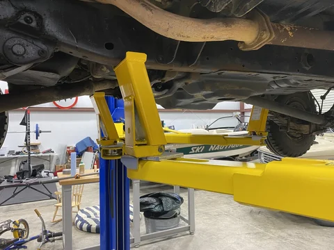

This is a pic of the minimum stack of adjuster that I needed to lift an F350.
As you can see the frame sweeps up towards the rear axle and the front lift point has hindered by the step.
The arms could not extend to where it was recommended to lift.
I only lifted 1 1/2" and a safety shake of the truck told me I was not taking it any higher.
I also work on a number of Model A's and lifting requires a lot of extensions to clear the mechanical brakes and running boards.
For these reasons a 4 poster would be my friend.
There are attachment's that will lift at the wheels, but 4 of them are very expensive.
Just some things to think about

That doesn’t look very stable. I think these slip on truck adapters would work much better.
