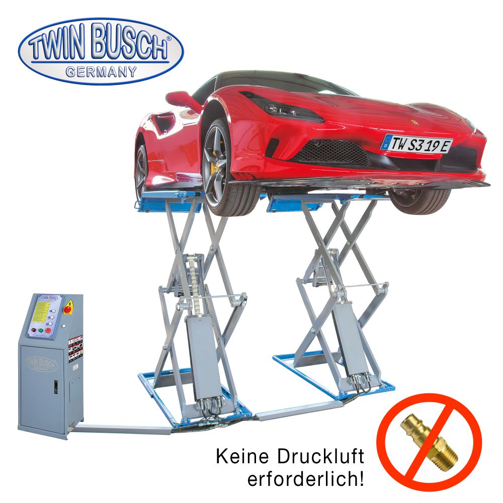

There is a high-lift quickjack design offered by Twin Bush.
I have no firsthand experience with it, but have discussed it on various auto forums as an interesting alternative to 2 post or shorty QJs.
