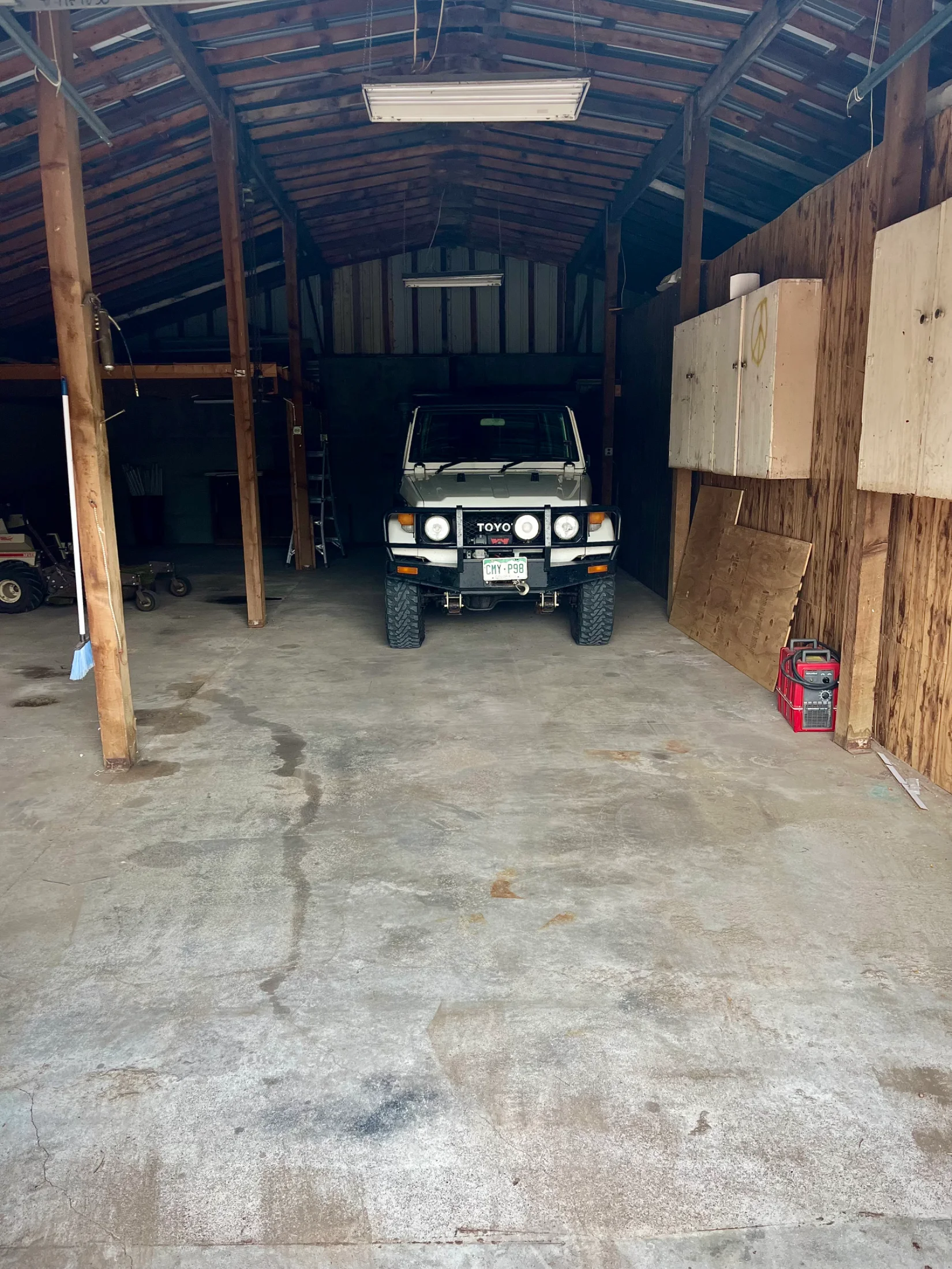

Here’s the shop.

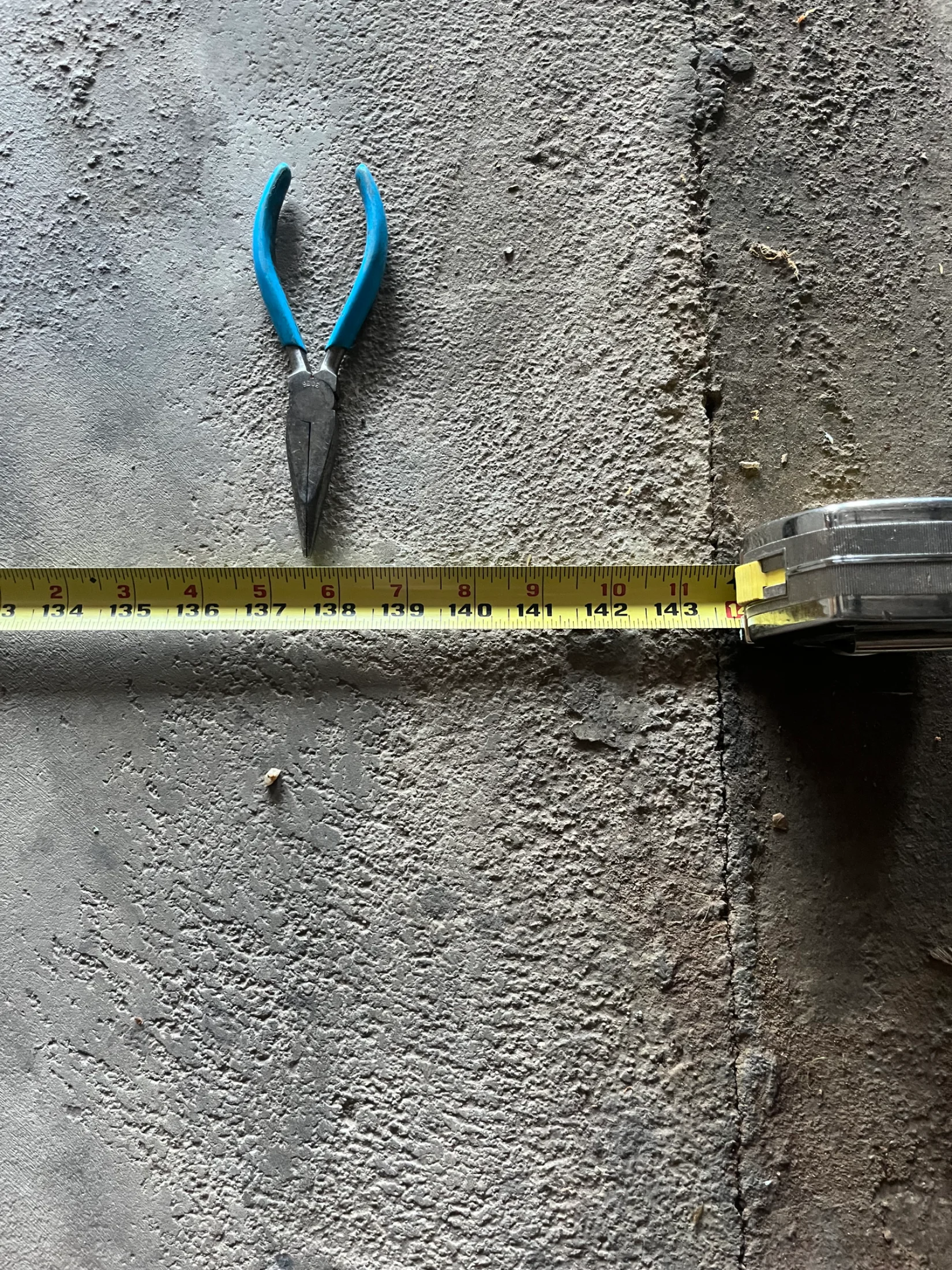

Slab thickness at front. Wil Probabaly need to drill a sample.
The middle slab. The lift would be 6” from the edge. Too close?
I don’t think I would install it that close to the edge of a cold joint. Rotary has specifications that you can access online covering all aspects of installation including minimum distance from edge. I assume Challenger has the same.
Rotary has this for the 7k and sp lifts.
Will look for challenger.
Edit: Challenger says 8” from expansion/crack/joint.
I know you know this, but on the off chance; those distances are from the closest anchor bolt. I am not sure if they are center line of the bolt or edge of the bolt. Also, if you didn't notice, you can get much closer to the edge by using an epoxy anchor instead of an expansion anchor. I used epoxy anchors for the 6 structural steel columns on my shop expansion. I think I used Simpson Strong-Tie. Hilti is great stuff but it's not really conducive to the small consumer/project. You will find Simpson or Sika much more user friendly and available (and equivalent strength-wise).
I honestly didn't think about the epoxy anchor possibility but you could use that for all the anchors if you wanted to. Very critical to clean the hole out though with a clean-out brush specifically made for the anchor system you are using. Blow/vacuum and use the brush multiple times before inserting the epoxy.
I think with that setup/epoxy I should be good to go then. Thanks for the info on Simpson vs Hilti
