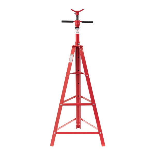

The Sunex tripod stands are pretty stout: 2 Ton Tripod Underhoist Stand - SUNEX Tools - https://sunextools.com/products/2-ton-tripod-underhoist-stand/
A guy I know has a pair and they're nice.
My only complaint is the bolt-together assembly for the legs - but I understand they do that for shipping or if you want to break it down for storage.
I think I'd be inclined to weld them together - or at least tack the bolts to guarantee nothing is loosening up.
I agree with @PIP - make sure (doubly sure) they've been removed before lowering... :oops:
Also that they're just braces - just enough to keep the vehicle from moving and not actually doing any supporting.
Thanks, I've looked at a lot of similar stands online. Problem is they all look like they're made in the same chinese factory with variations in color/labeling despite prices from $100-300. Agree welding would be good or at minimum replacing the crappy hardware that comes with it.

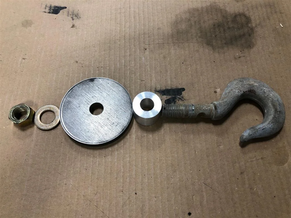

Lots of ways to rig lifting hooks but I had a pair of 5/8 threaded hooks I scrounged somewhere and added an aluminum bushing I made to fill the hole on the lift, a 4" steel round plate, washer and nut. Not sure if the hooks are lift rated but they're big enough to handle anything I'd put on them. Wouldn't recommend non-lift rated hardware store eyebolts.

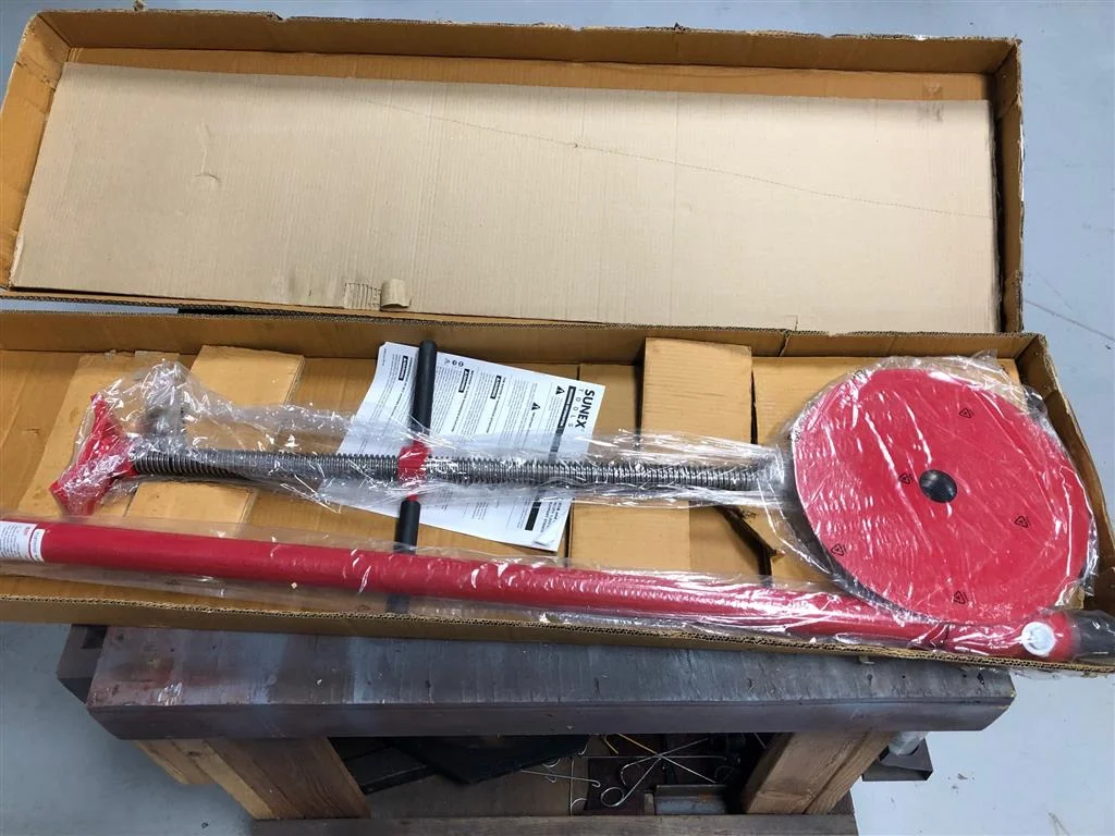

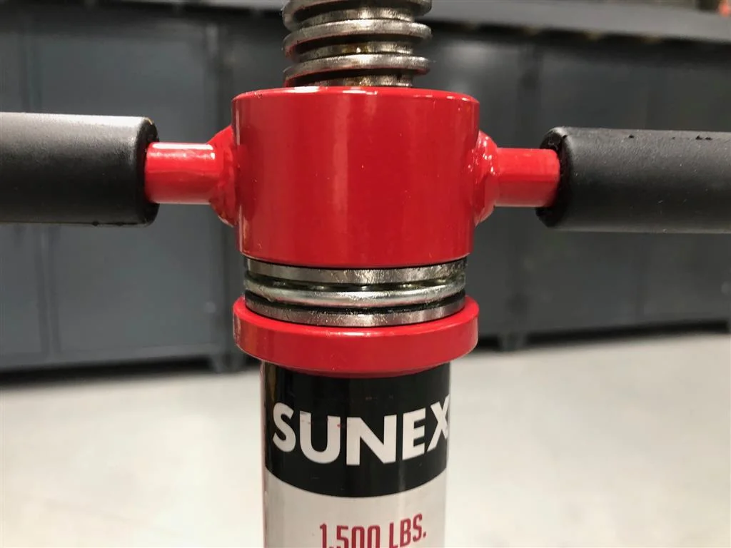

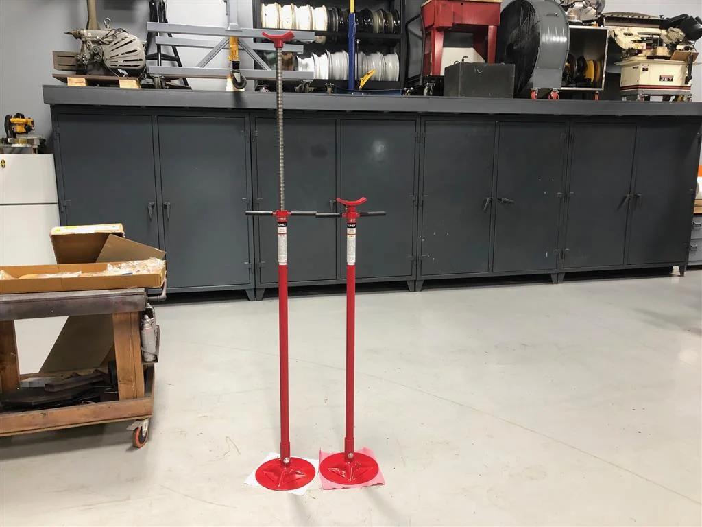

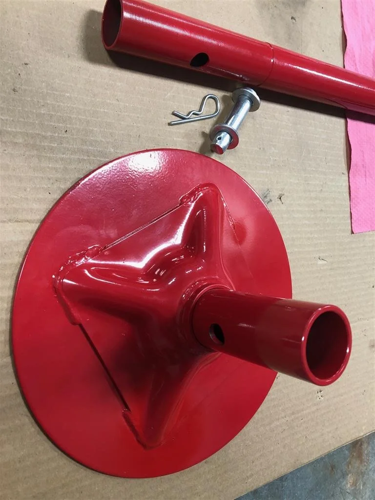

Got the Sunex underlift stands today. Typical import packaging (Amazon says China but boxes/stands say India) but nothing was missing. Base plate is 11 13/16" across and .165 thick with a stamped/threaded extension that a short tube screws into. Fine threads and goes together with no slop. I can see why some reviews mention cross threading but shouldn't be an issue if you're paying attention. Longer pole sits in base with a cross pin. Acme threaded rod is just over 1 1/8" diameter and turns easily (at least with no weight) on a simple thrust bearing. Lowered height is 53" and extended 82". Didn't weight but specs say 29 lbs which is probably about right.

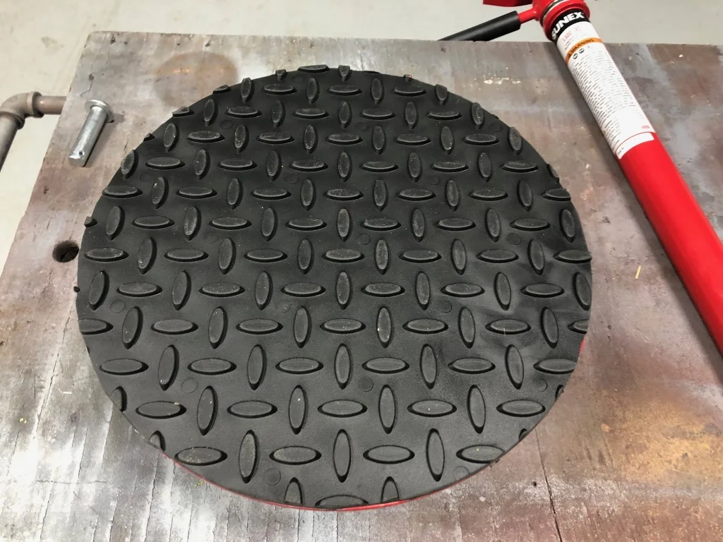

Probably won't have anything on the lift for a while to test out but at this point they look like they'll work just fine and I'm not planning on returning. They're a little wobbly given how the base attaches but I don't think it would be an issue under load. Not sure why I would need to take base off anyway so I may weld the long pole to the threaded tube. Threads are tight so I'd probably leave that part as is which would still allow the base to come off if ever need. I'll probably also put a sheet of adhesive rubber on base plate just for some grip. Only other thing I can think of might be a couple of different top plates vs the saddles but those are easy enough to make. All in all, I'm surprisingly impressed and give them a 👍, especially for $82ea + tax.
