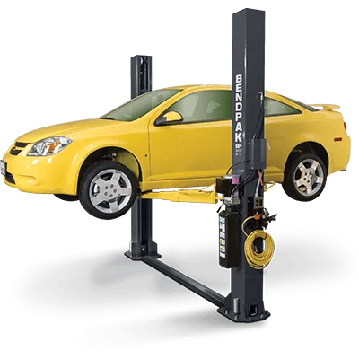

Most two-post lifts have uprights that are 12' and change. My Dannmar lift is under a 14' (apex) roof in my shop.
I'm in the process of selecting 2 post lifts as well. From the research I've done, you need just over 12' for most 10k lifts, and 14'+ for most 12k lifts. I was looking at both Bendpak and Rotary and will likely go with a set of Rotary SPO 12s. If I only had the cruisers, a 10k would be fine, but we plan on adding a HD diesel truck in the near future.
The top beam of the lift will be the limiting factor, not vehicle height, but the taller the lift can go, the easier it is to stand upright under a tall vehicle.

You're still limited by the height the lift will go up plus the vehicle height. And, of course, you don't have to lift the vehicle all the way to the top extent.
The Shop I'm at has three lifts. Two with top beams and one with the floor plate. I have to say that the floor plate does have its issues. First, trying to roll a non-powered vehicle onto the lift (over the floor plate) can be challenging at times. It's amazing how much that little bump can resist getting a vehicle across it - sort of like how creepers, floor jacks, and engine hoists get stuck on the smallest thing. Then, even if you can drive in over the floor plate, if you're working from a shop stool or creeper you're invariably going to hit that plate. I can't tell you how many times I've been on a stool, pushed myself backwards, and fell over that damn plate!
There are also the MaxJax portable lifts if headroom is really a concern. You can also unbolt the lift and move it out of the way if it is your standard suburban garage and space is at a premium.
But if you're designing a shop, I'd design around the lift that you want to accommodate unless there are other concerns like zoning ordinances limiting the height of your building or similar constraints.
