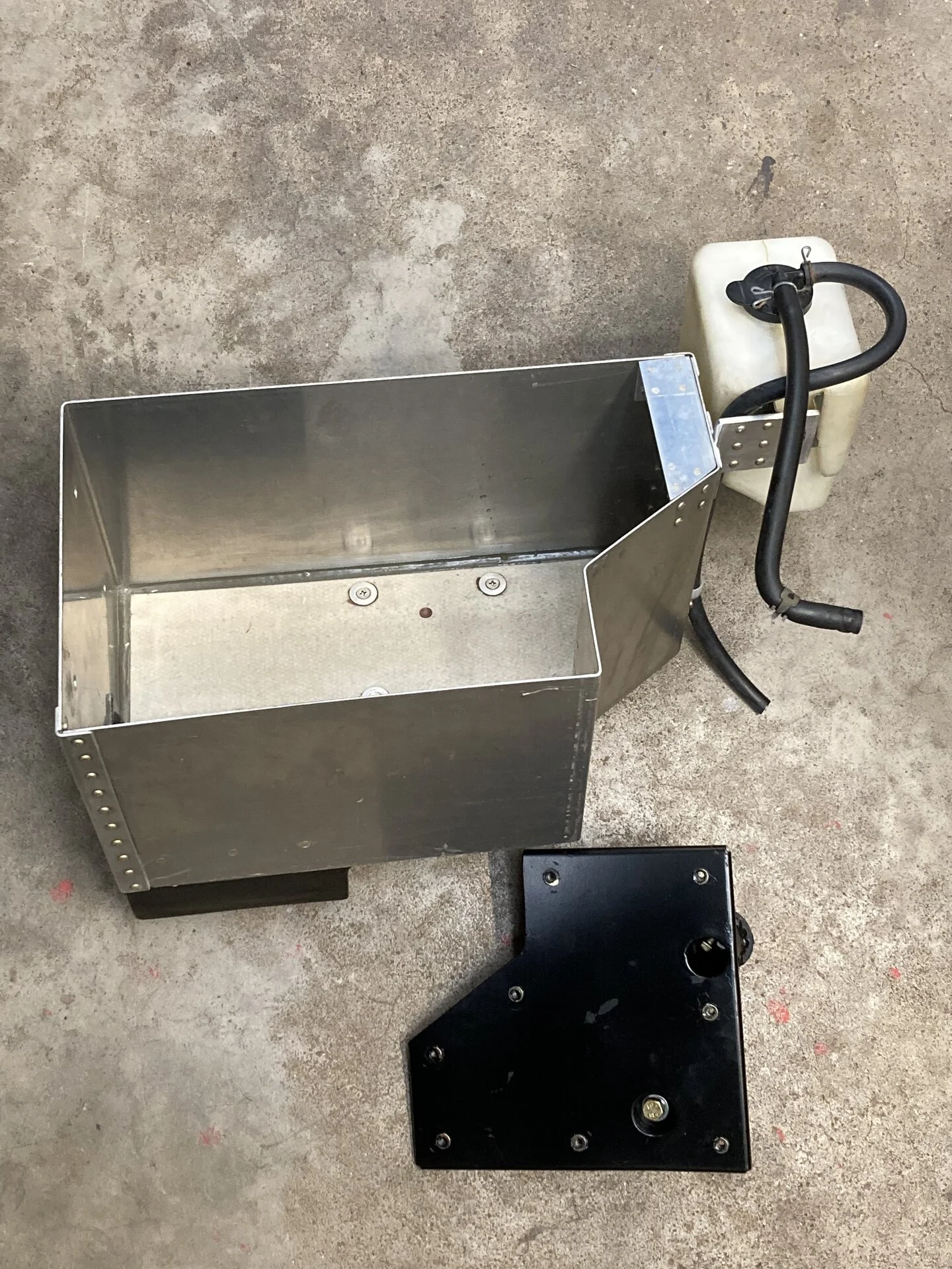

Here is the box removed(without inner fender mount)
