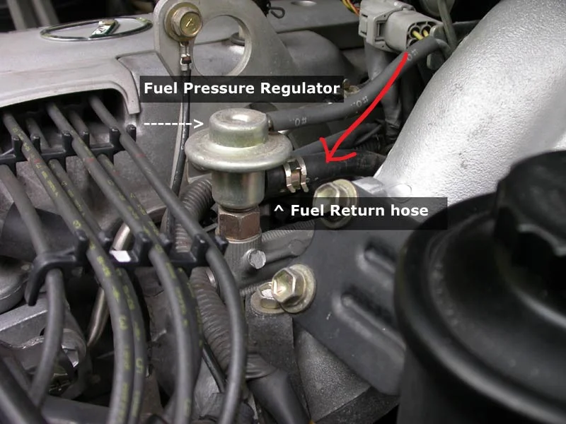

So I had another idea--- why not just install a gauge on the fuel return line-- after the regulator? It seems like you could just put a t-fitting on the return line (marked with the red arrow below). That way you are not messing with anything before the injectors. And you maybe even use a lower pressure gauge.
Now I don't think you would be able to tell your fuel pressure on a gauge installed there, but if the needle moved even just a bit you could at least tell that the fuel pump relay was working and the fuel pump was turning on, right? Wouldn't that be enough to move further down the trouble shooting list?
"Third" - Provided that you don't add restrictive fittings, adding the gauge is not going to lower the pressure to the injectors.
Pressure on the return line is meaningless. If you need to check fuel flow just briefly pull the return hose off.

Instead of putting a pressure gauge on the return line-- how about putting a clear fuel filter or even a just a small section of clear fuel line on the return line? Again, where that red arrow is pointed.
And again, I am just wanting to be able to see if fuel is being returned to confirm that the fuel relay/fuel pump are working.
This assumes that there is some clear filter or clear fuel line out there that could be safely installed under the hood like that.
Is that idea any better?
That would be better,... may be a "3"
I just question again, added complexity, more potential failure points. Is the juice worth the squeeze for the once in ten years it will be helpful?
You need a double length banjo bolt and appropriate fitting to install a fuel pressure gauge on the INLET side of the rail. Then you can install a gauge there. I've got a similar setup on my Supra that uses and electric sending unit to display fuel pressure on a gauge in the cabin. Useful for a boost-referenced fuel pressure regulator on a high performance setup. On a stock 80 series, its probably overkill.
Clear line on the return side won't tell you anything. There is ALWAYS fuel returning to the tank via the fuel pressure regulator. If there's no fuel in there, then you have bigger problems.
If you have fuel pressure/volume concerns, I'd baseline things with new factory Toyota parts as suggested above. New pump, sock, in-tank coupler hose, fuel filter, etc will get you sorted for the next 25 years usually. You can send the injectors out to have them cleaned/flow matched too.
