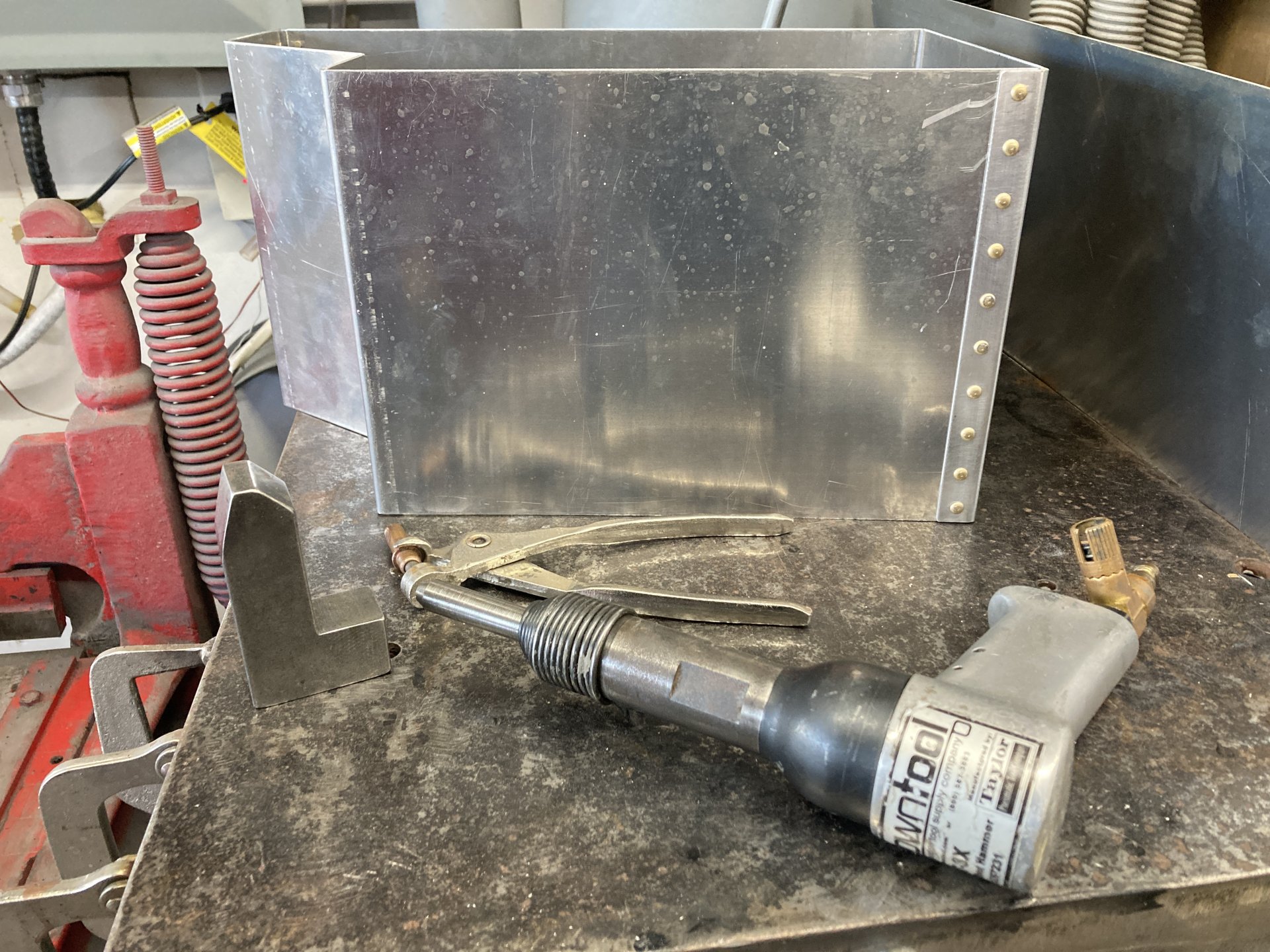

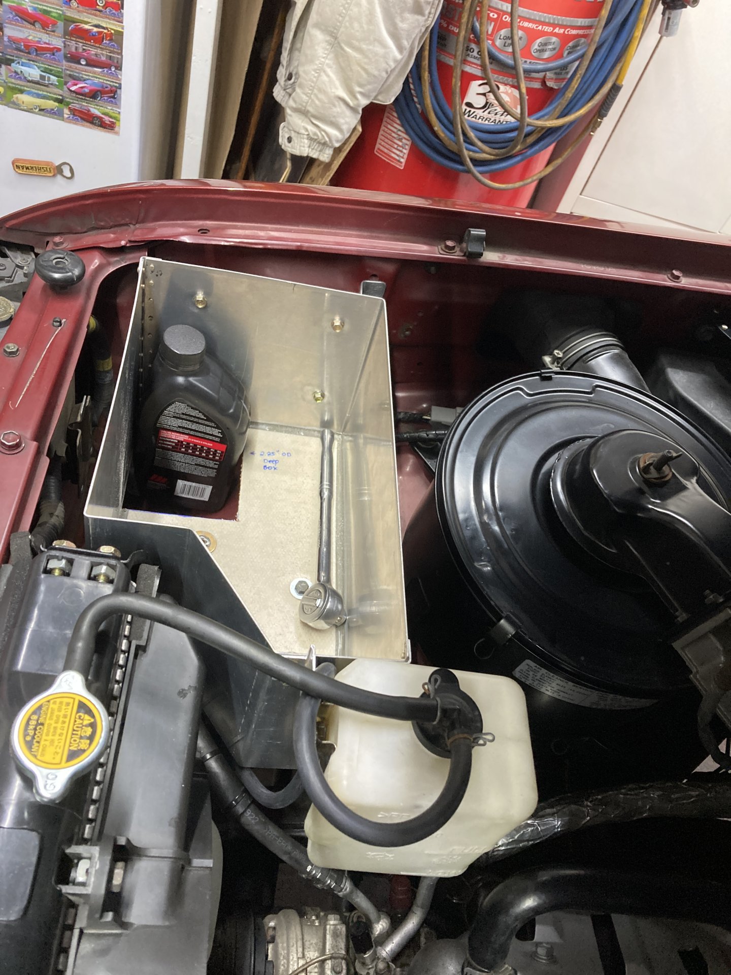

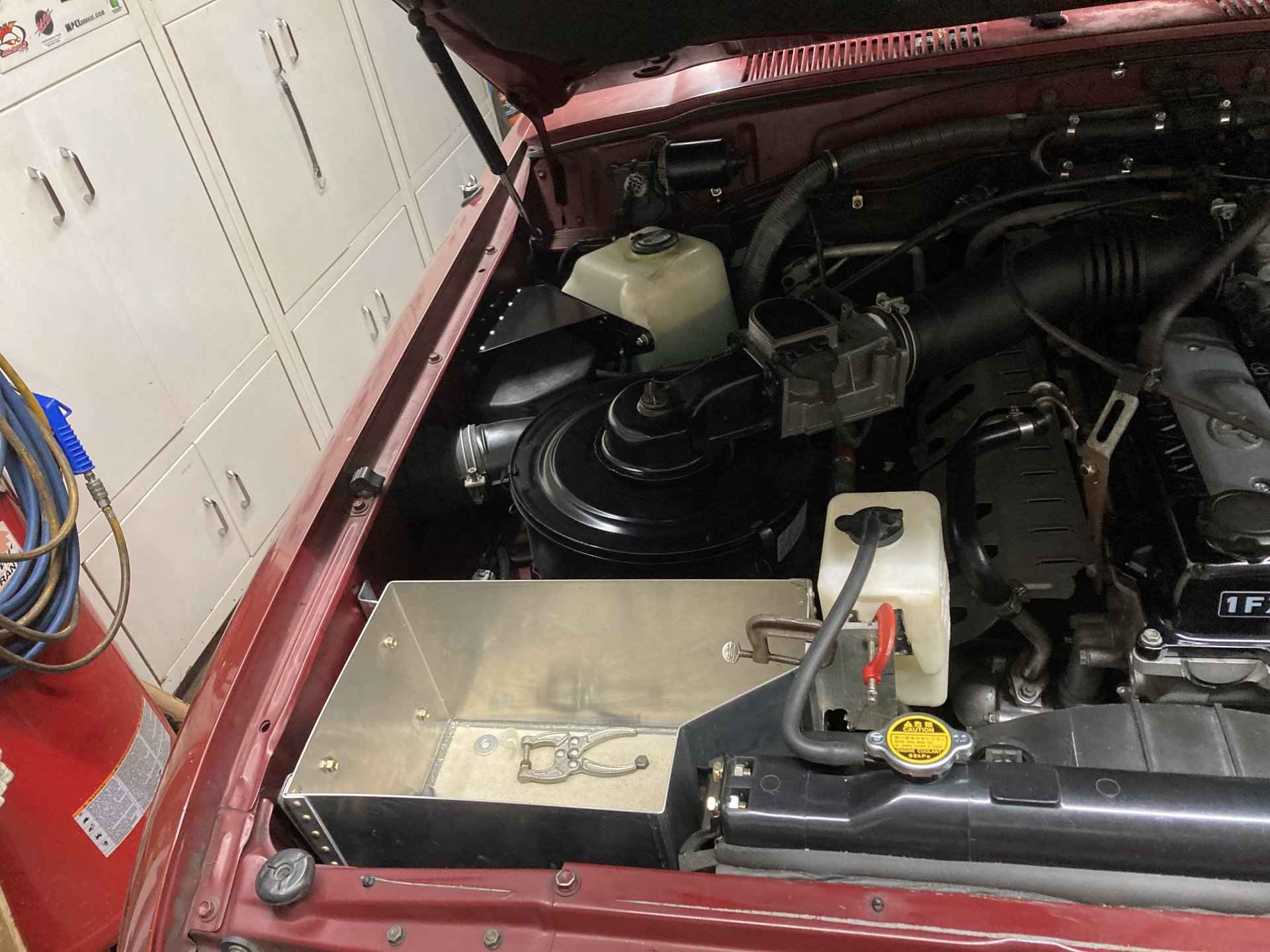

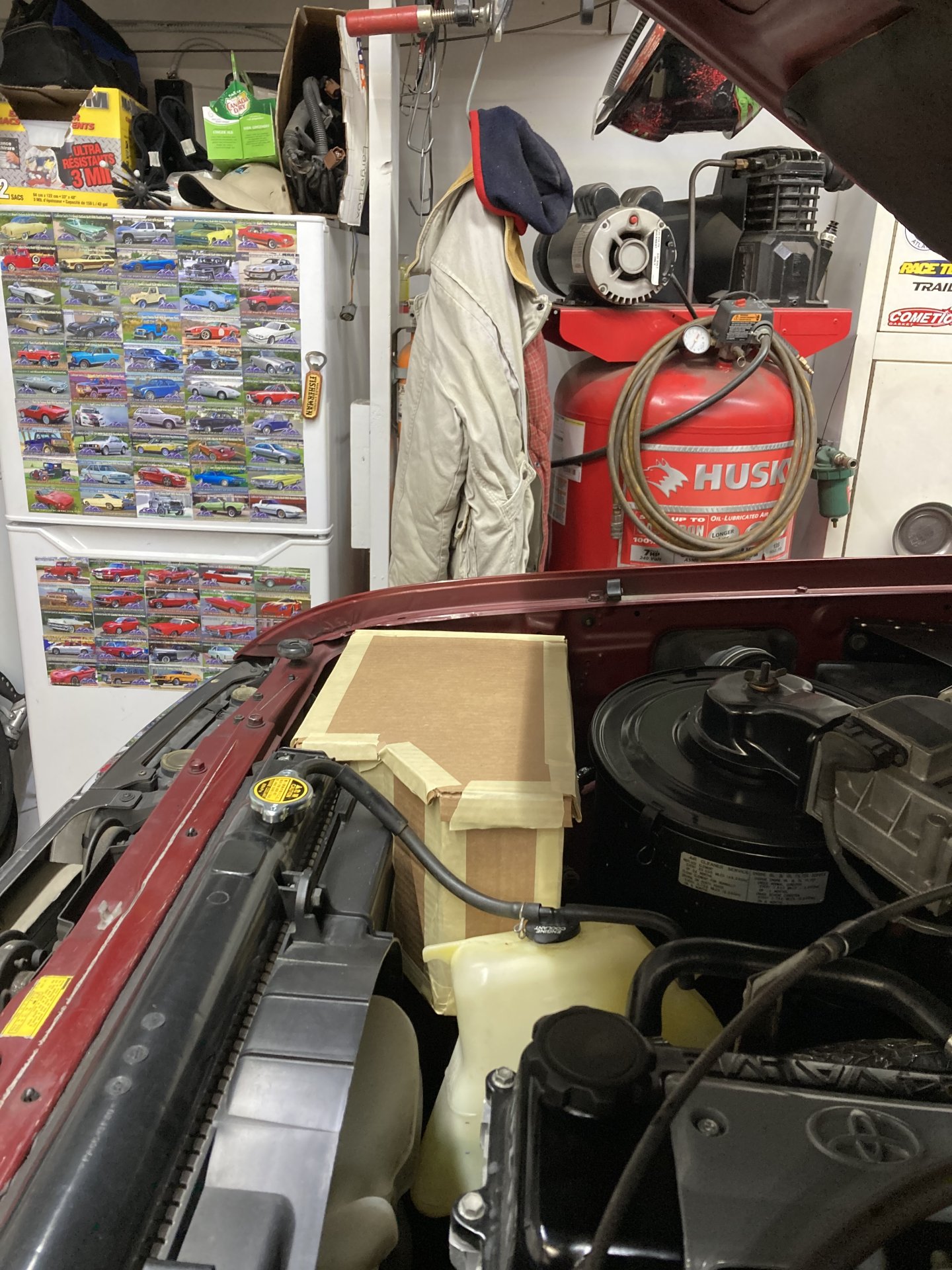

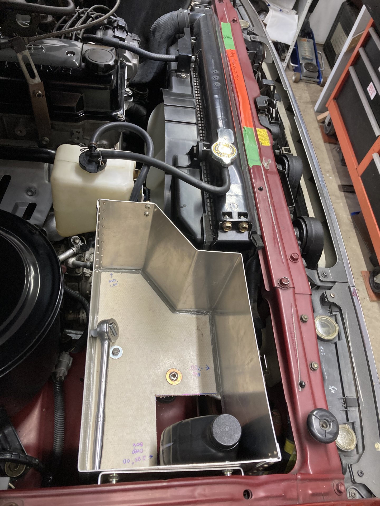

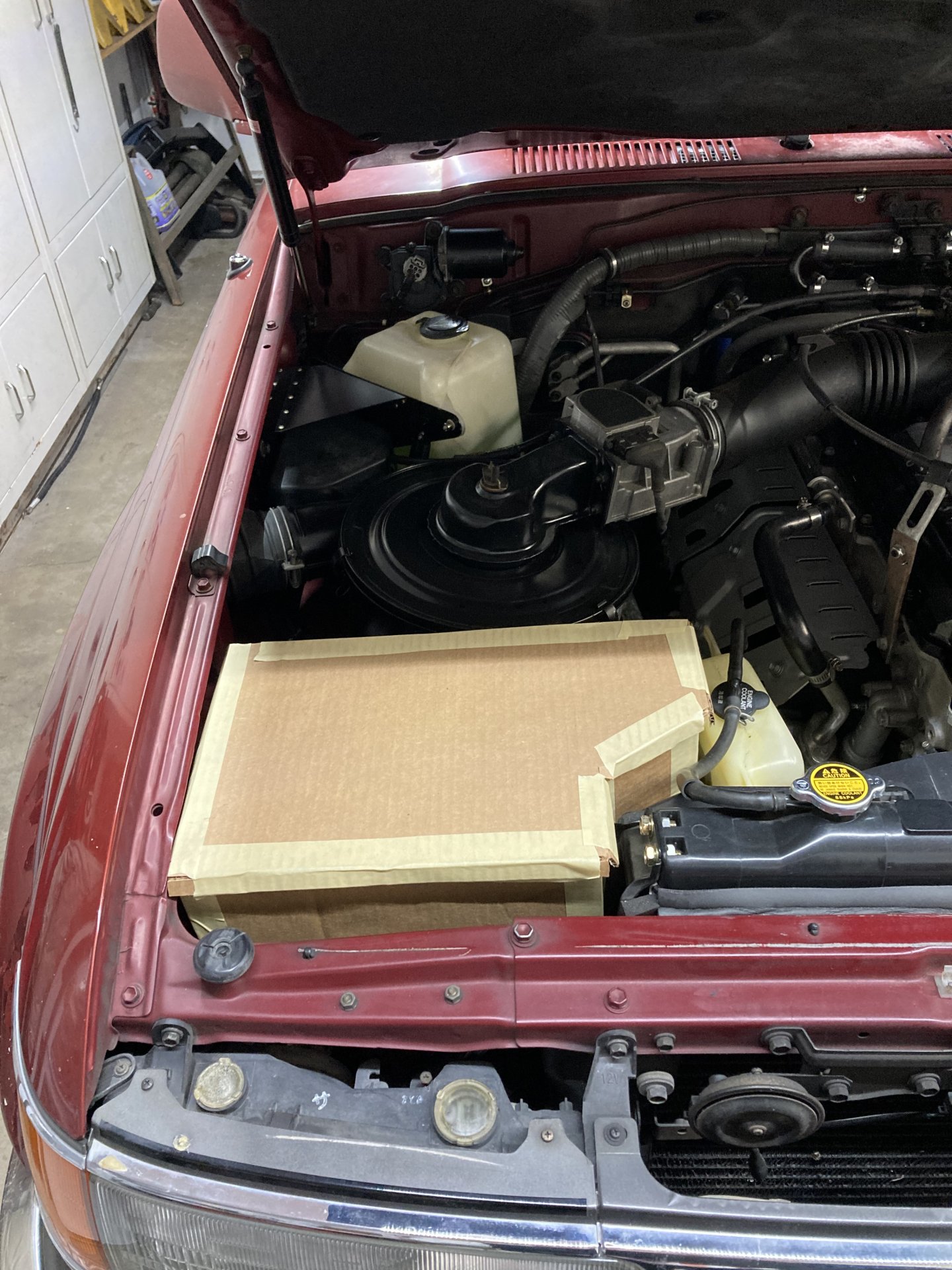

Under hood tool box/?
Good looking work but I am curious why not just use a battery tray. I got a 2nd battery tray in my rig and it holds fluids, a funnel, and rags really well.
I like fabricating things and I like having different things than the usual.😬
Just for the hell of it, love to see what that gear looks like, if you get the chance. :)

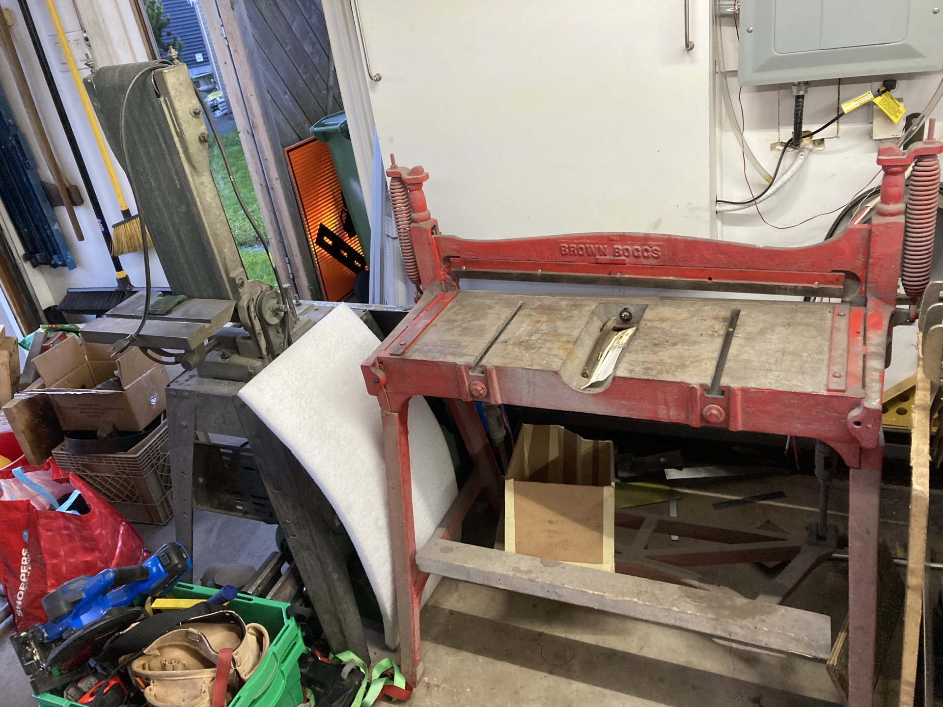

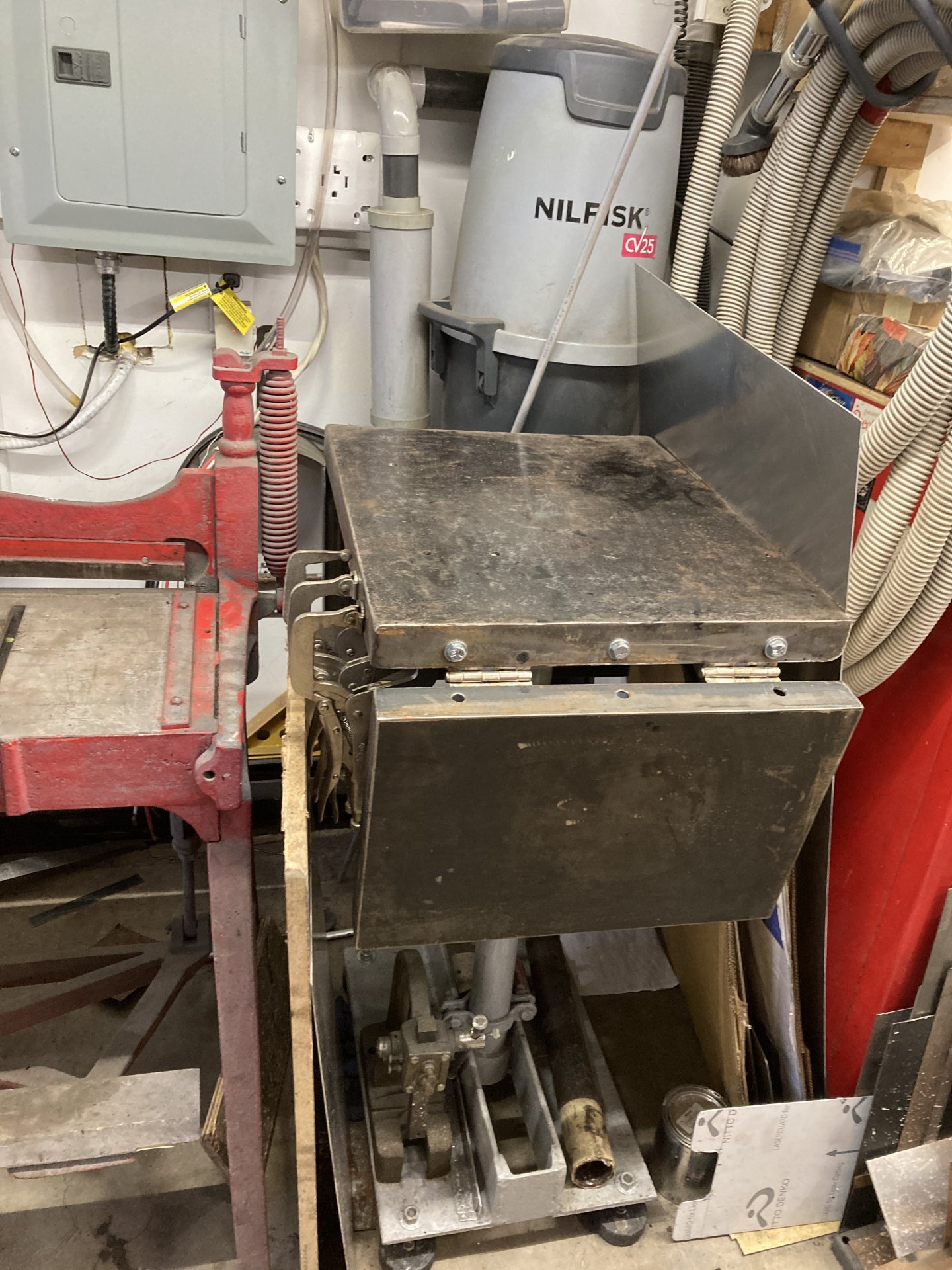

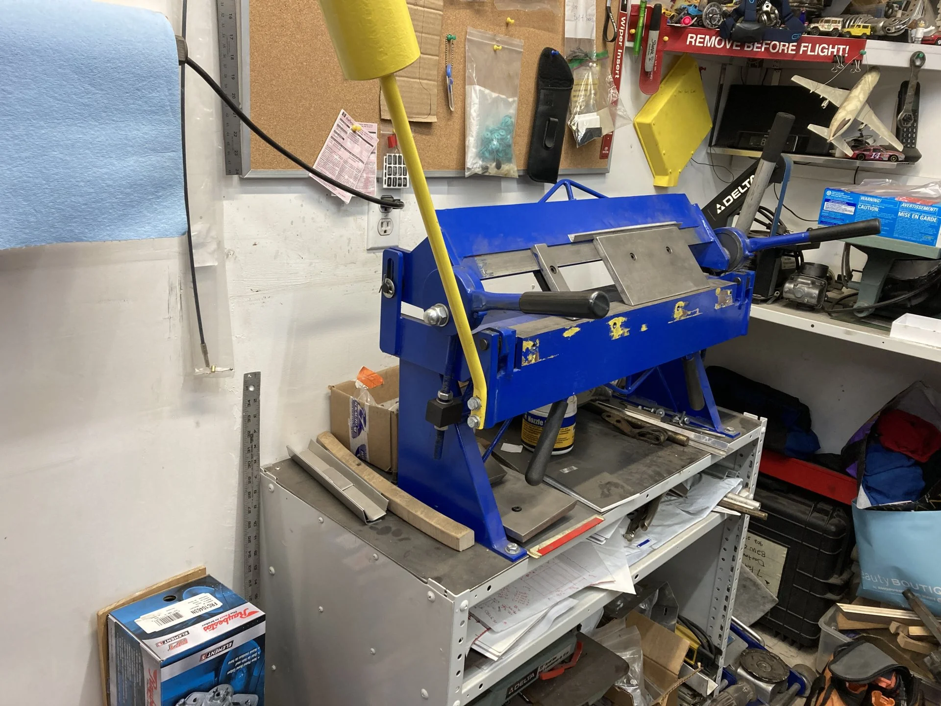

Here is the big equipment, lots of pneumatic and hand tools also. One pic is the welding table with flip up ends makes it 4’x21”
Having the tools and the know how - nice.

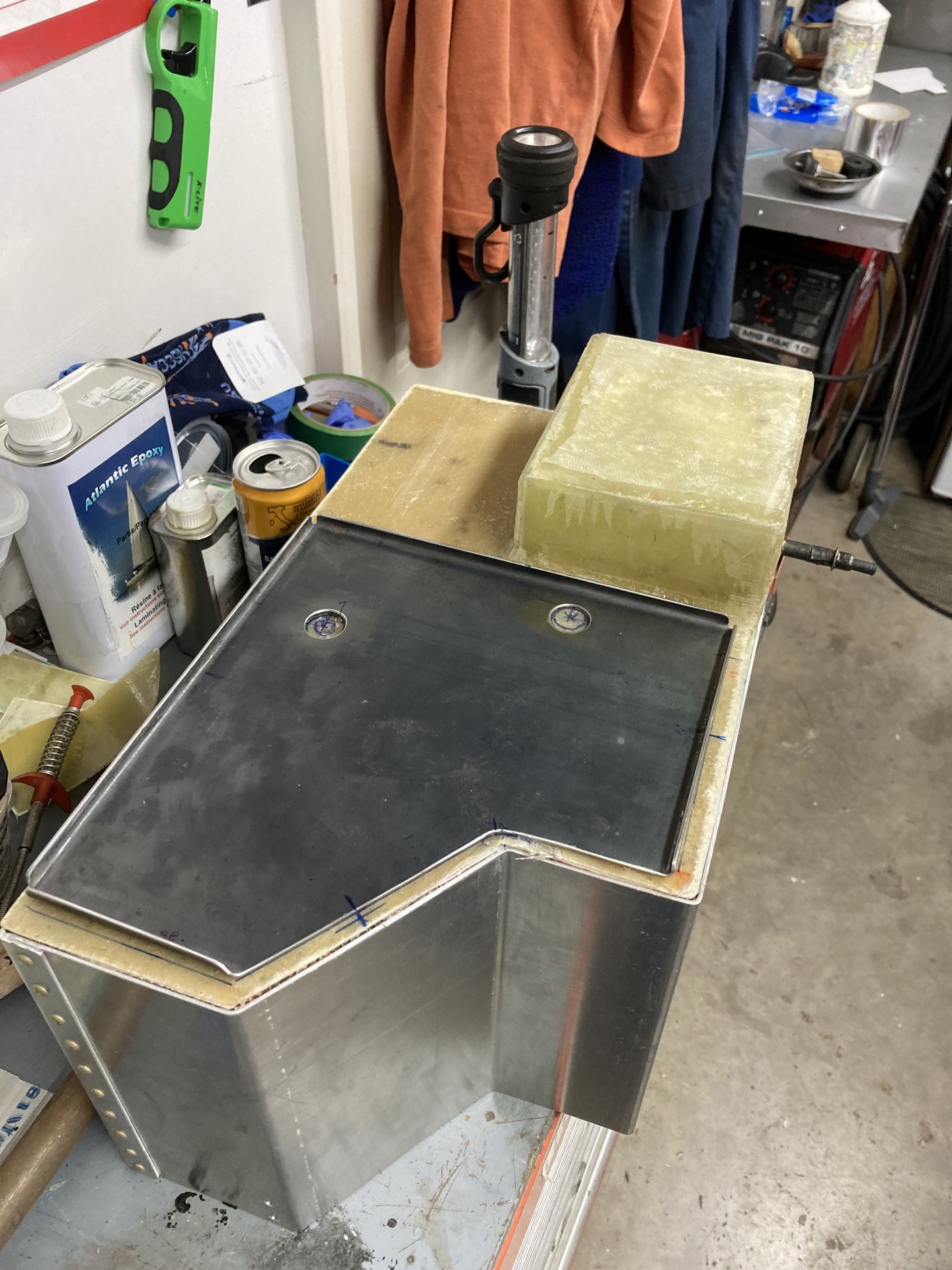

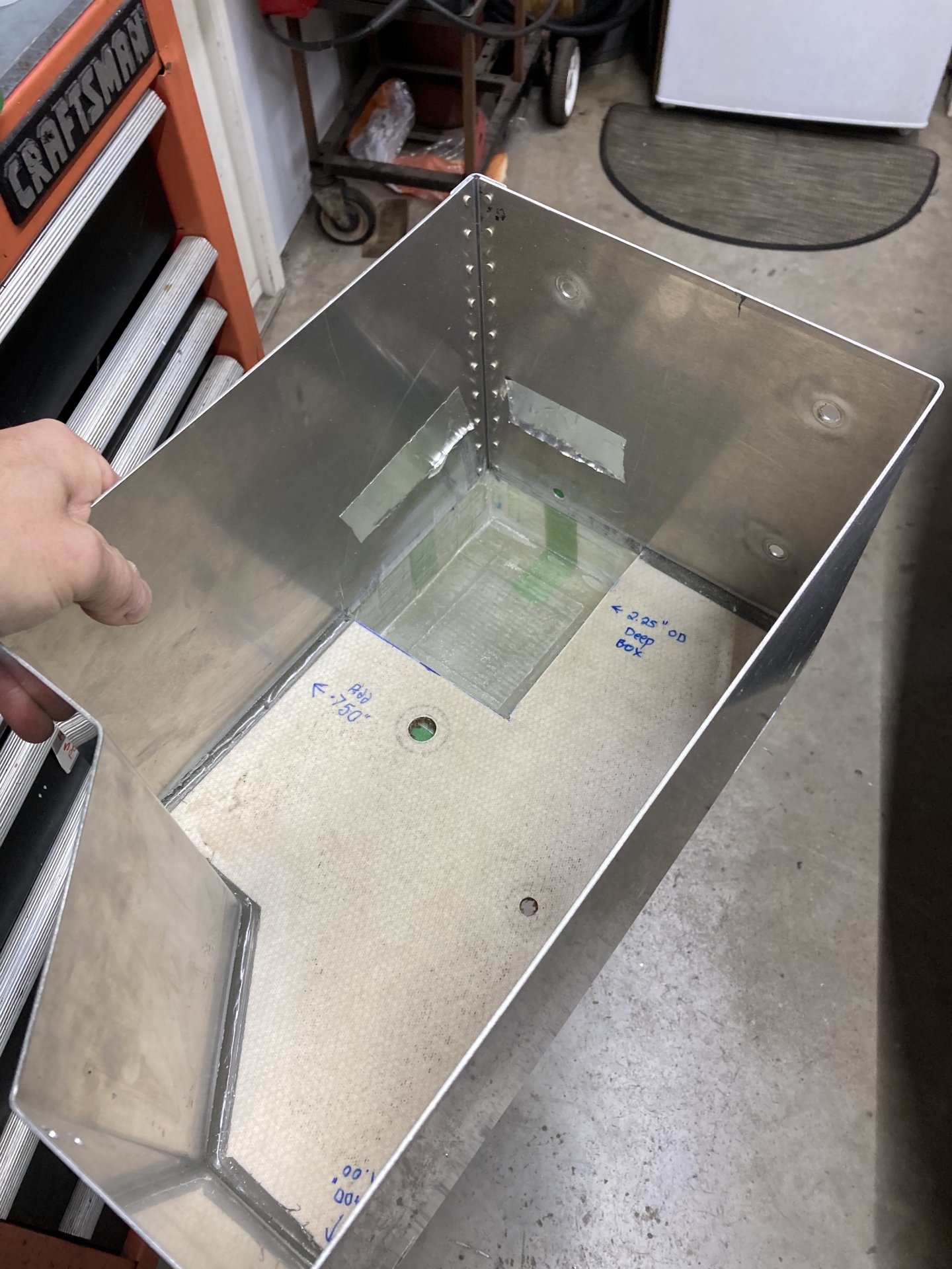

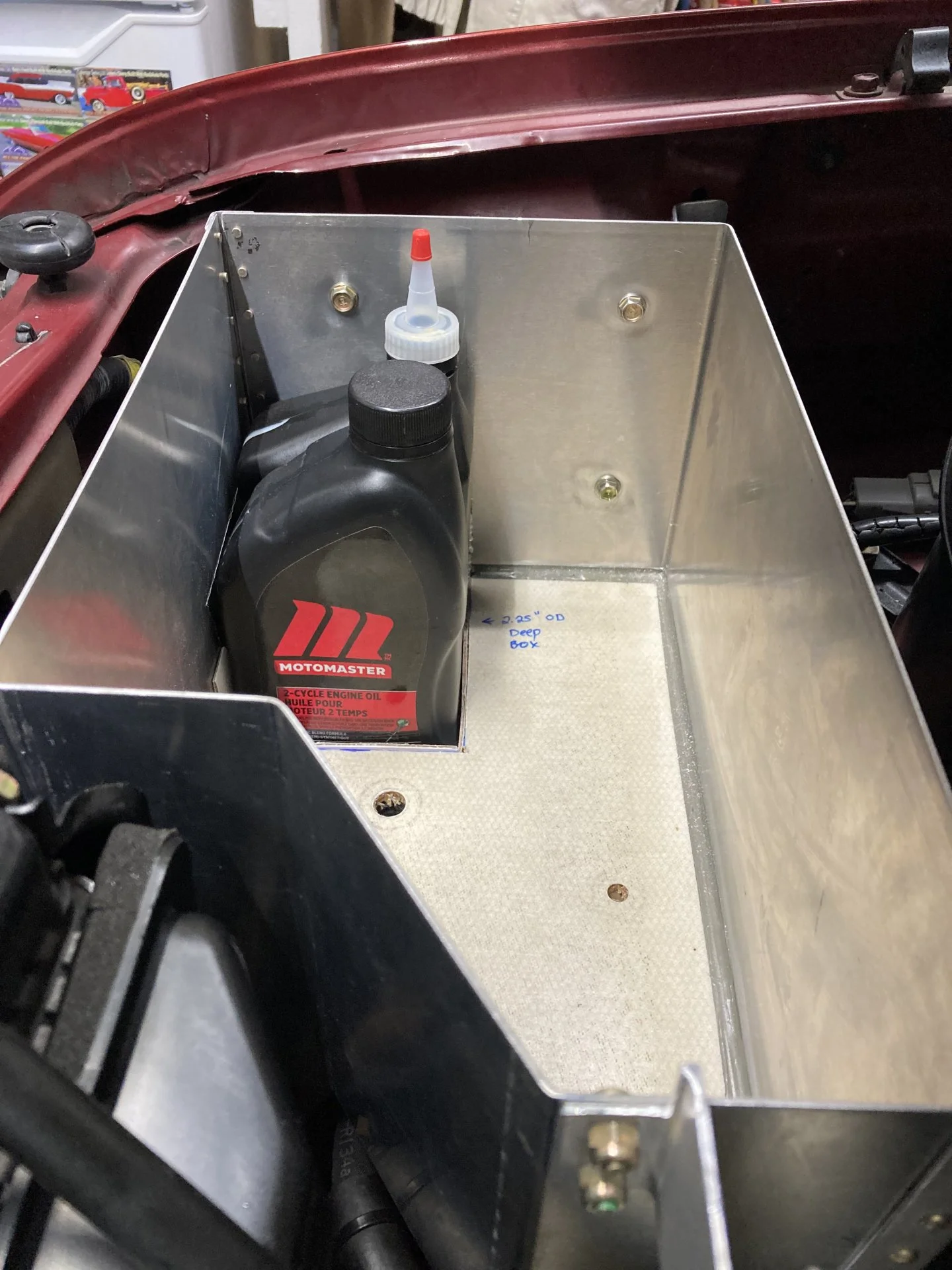

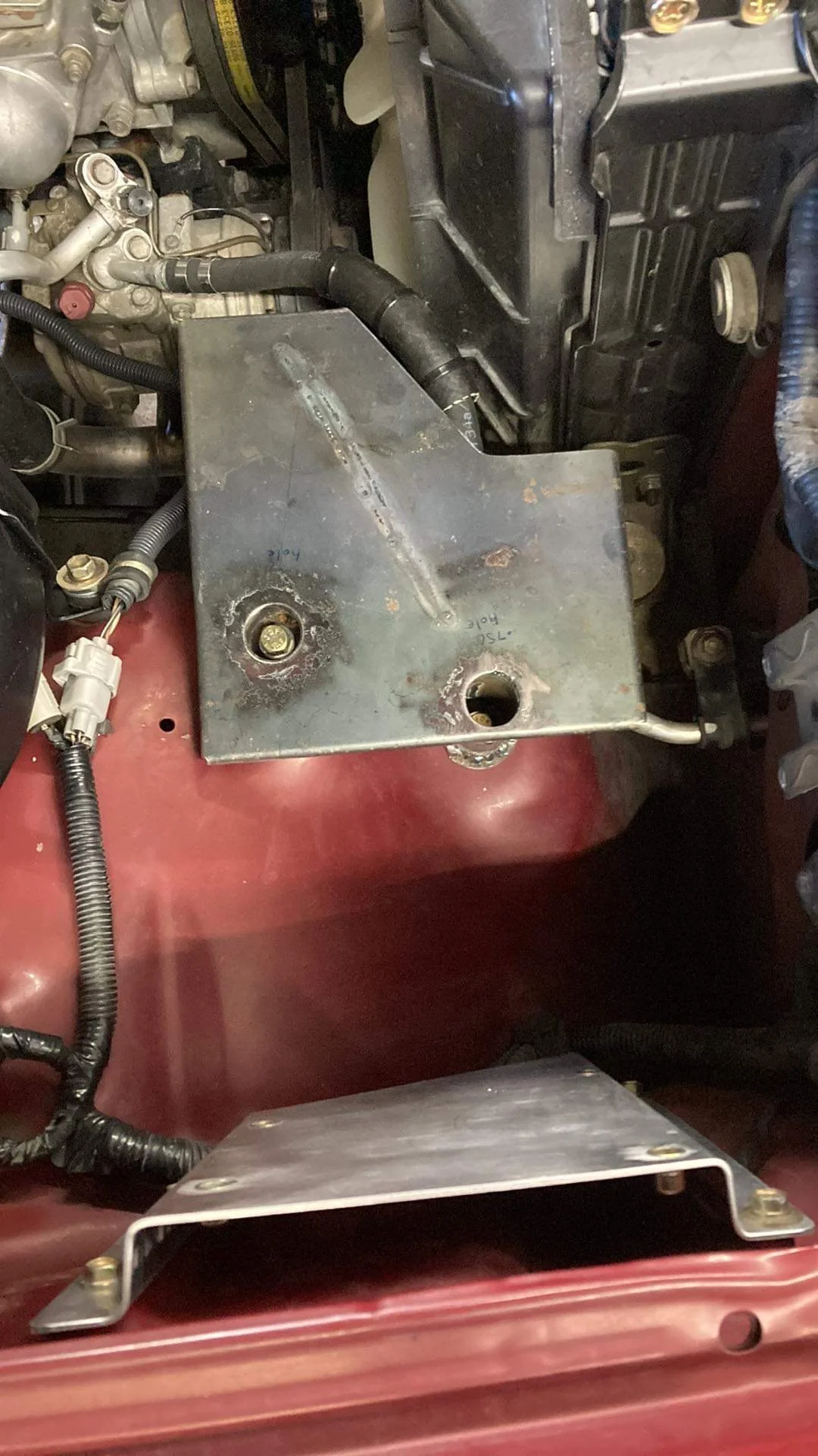

Bottom is installed.

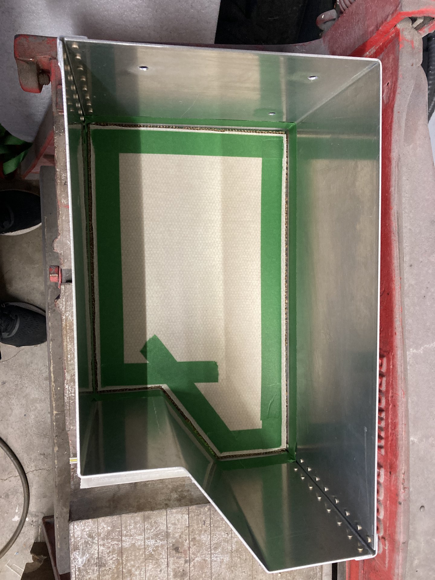

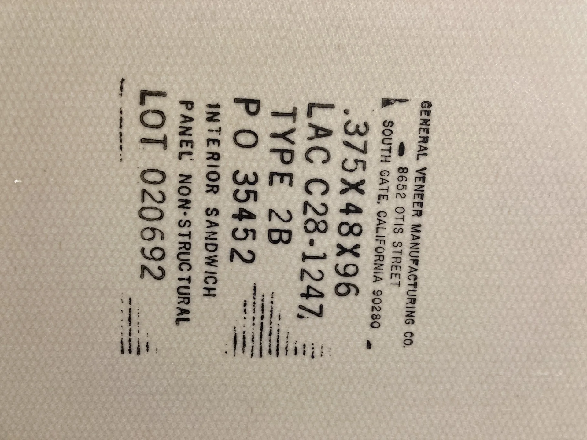

It’s a piece of fibreglass honeycomb, the material that a bathroom wall and non structural bulkheads for an aircraft are fabricated with.
Like I said, I’m slow 🤦‍♂️

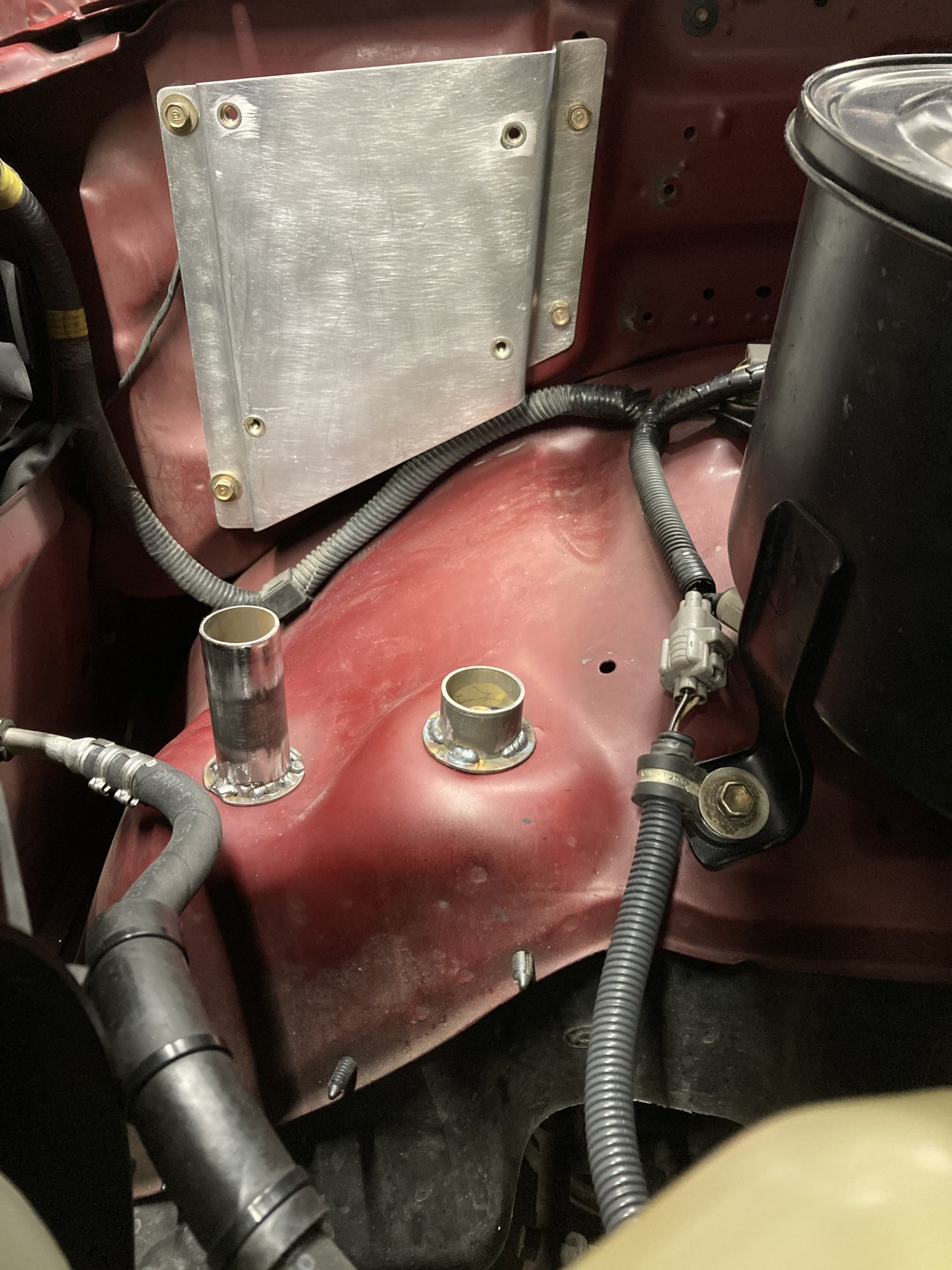

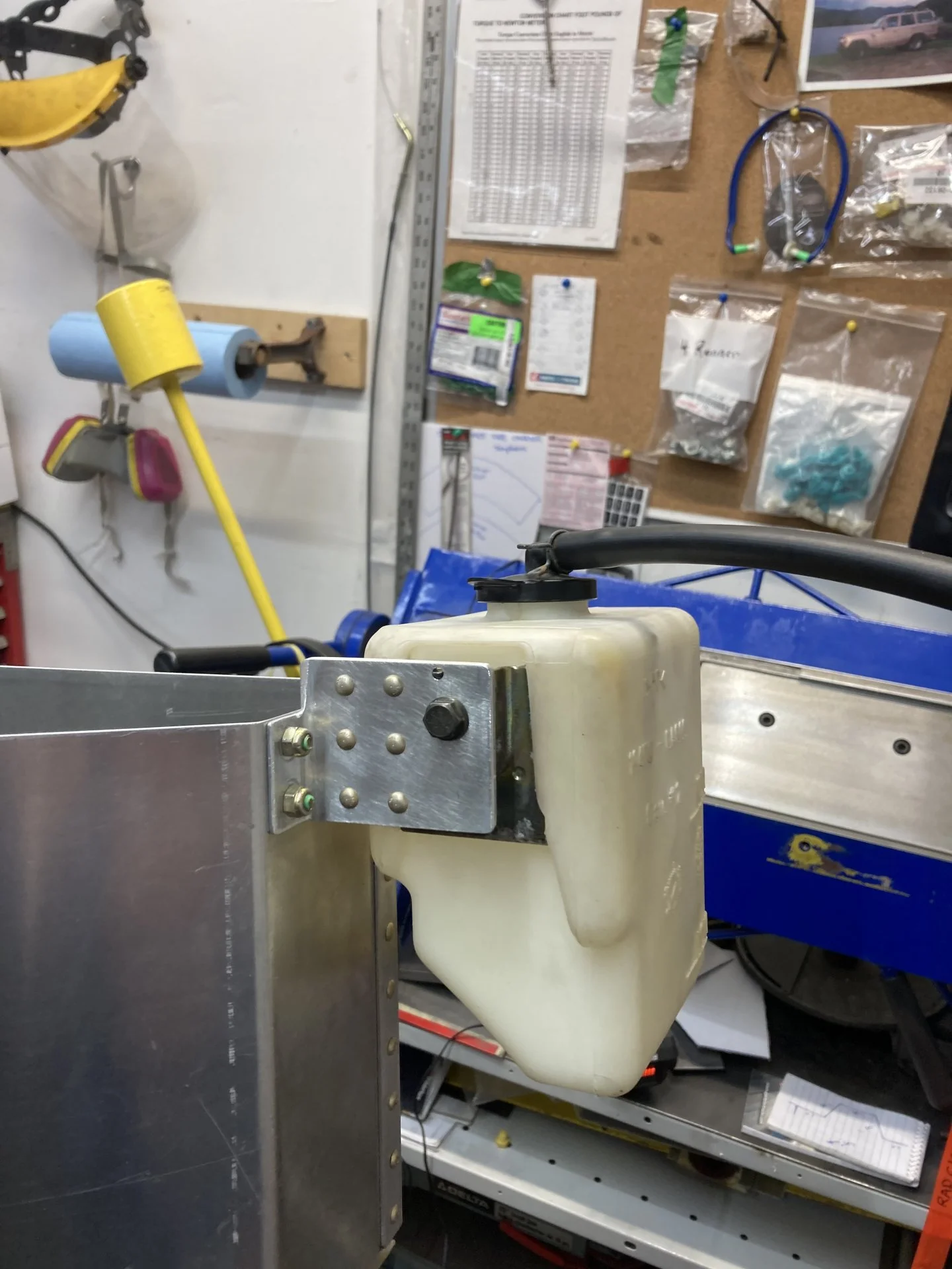

Anyways I picked at it again.

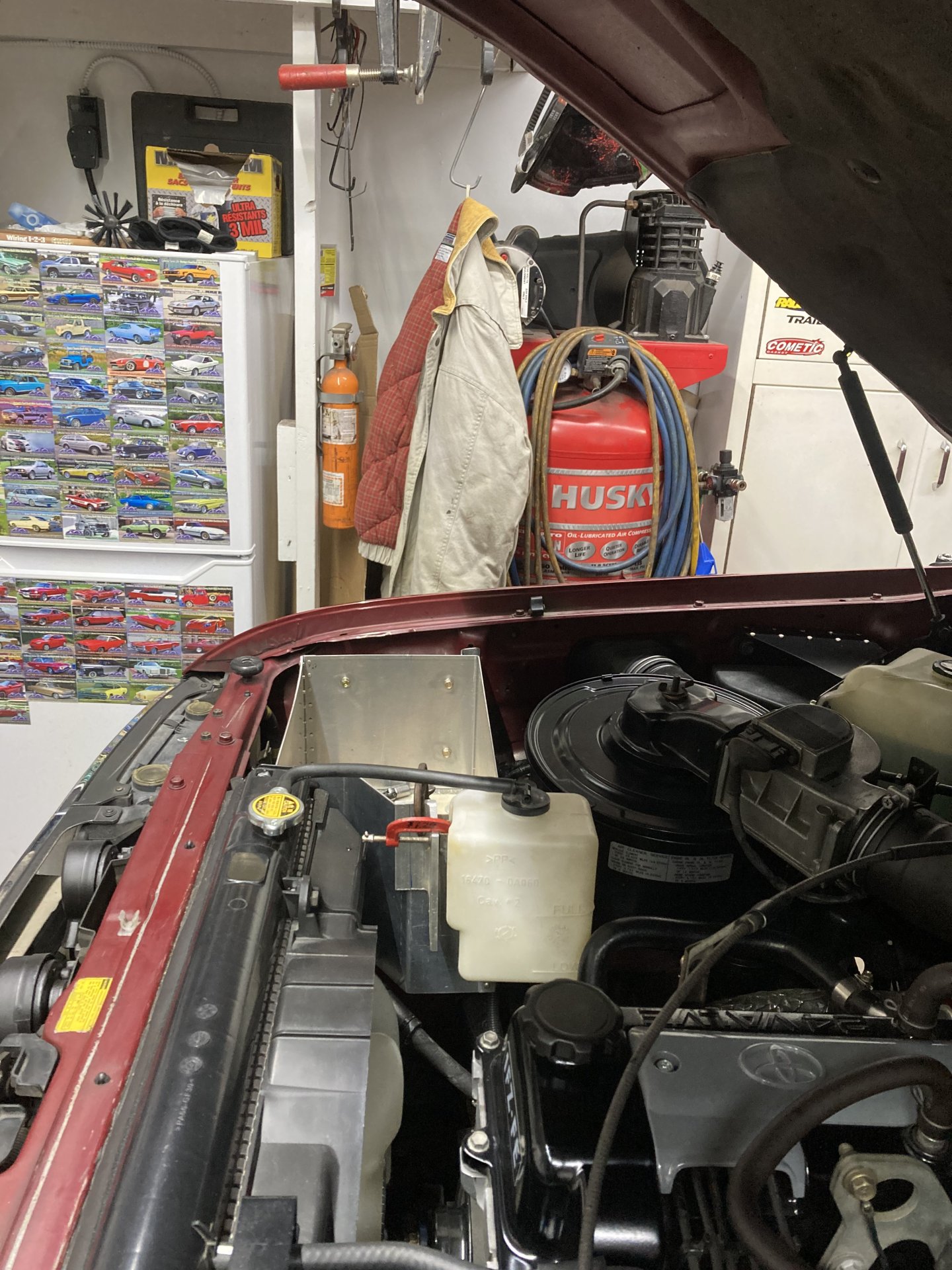

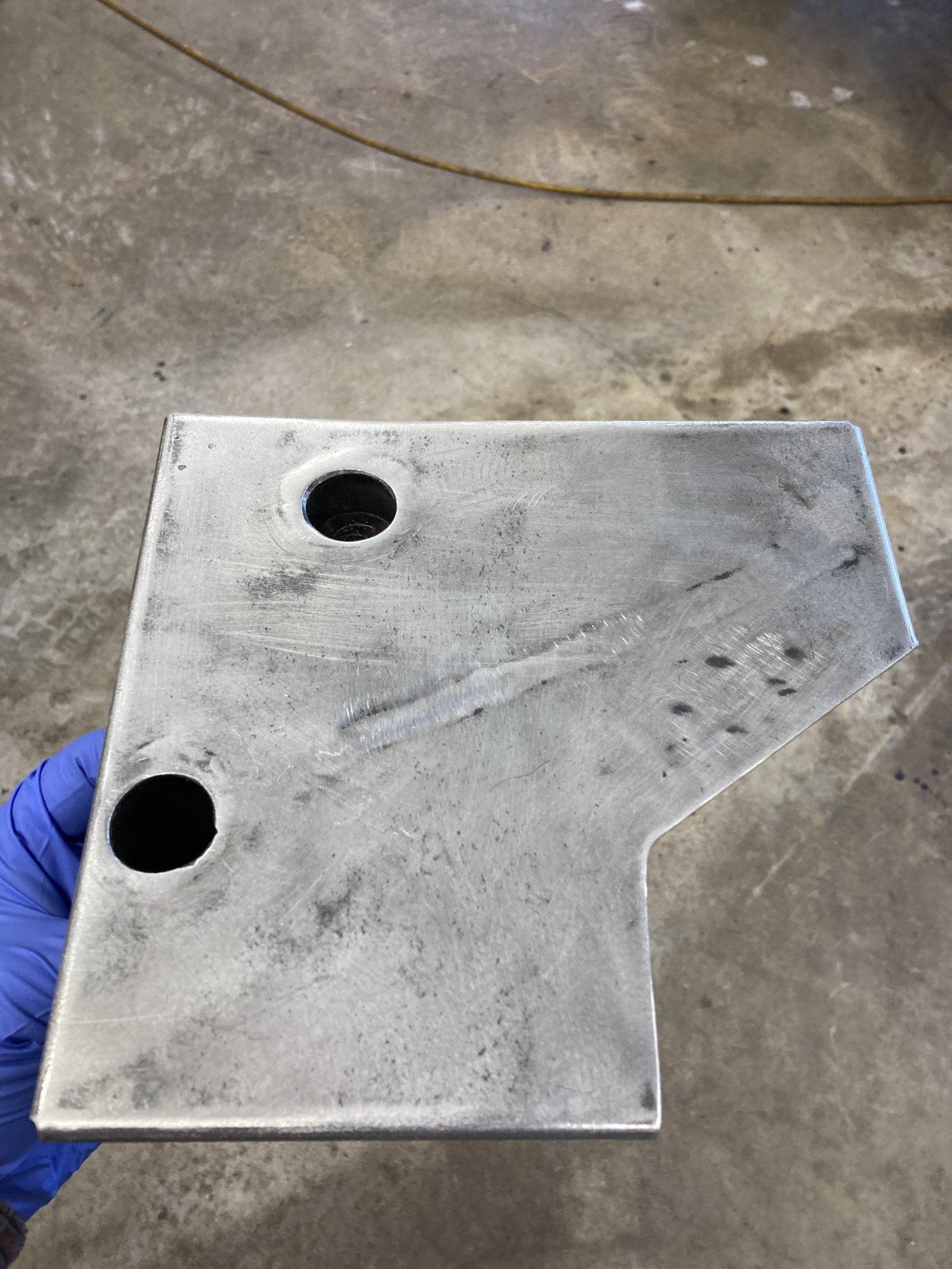

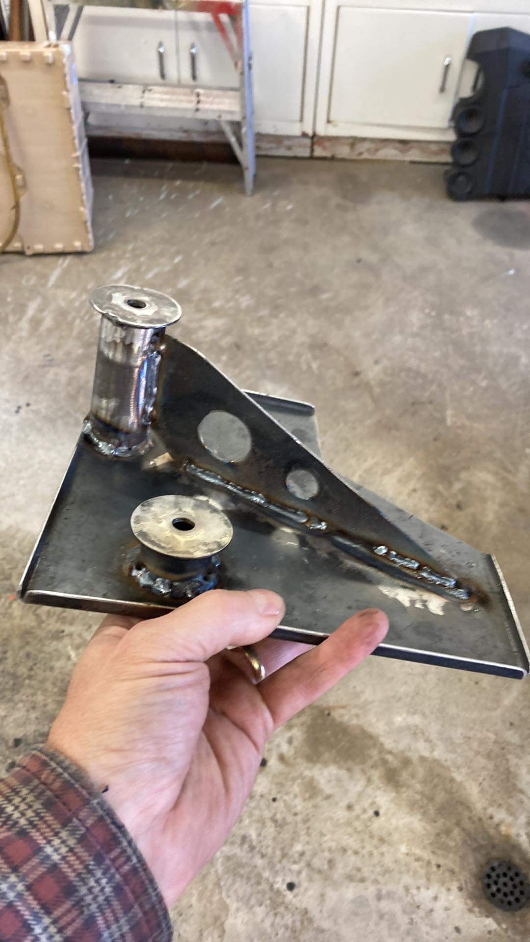

The reservoir is from a Corolla as is the mount. I’ll cut this overkill aluminum extrusion to tap and mount.
2 feet on the bottom, one cushion isolator and one a spacer.
At this point this is probably just a prototype. :rofl:

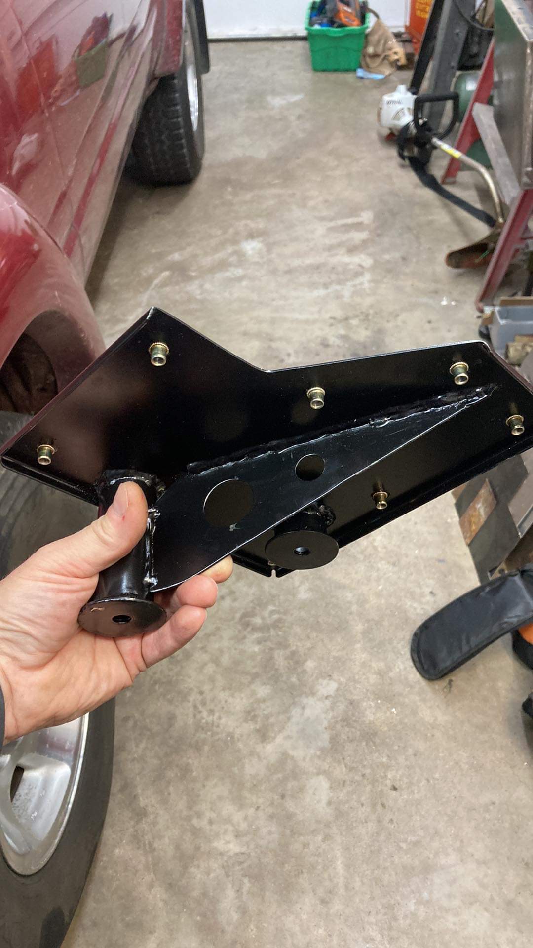

Little more progress, that’s a 10” L 1/2” drive
Currently not rigid enough, plans in action
More progress

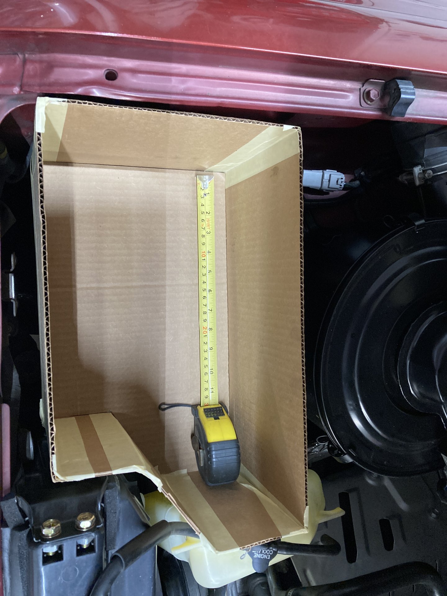

Haha! I know what it is like having 5 vehicles up until August.

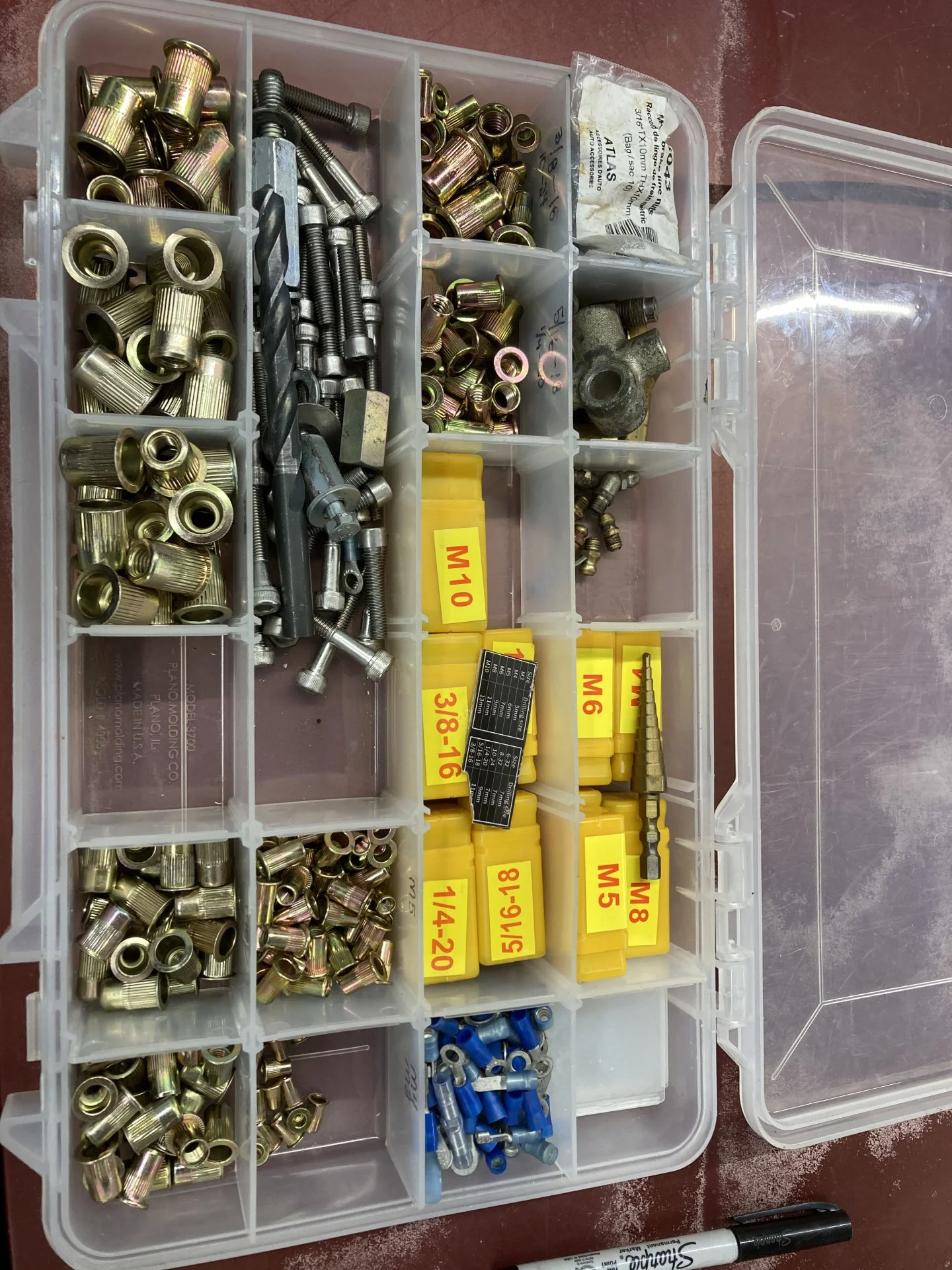

Looks great. I'm eager to see if dividers or straps will be needed to keep the stuff from bouncing around, or if it will be packed so tight with tools that straps won't be needed. A lot of guys like to carry around the big socket for the front end, that may be able to be secured on the outside of the tool box.

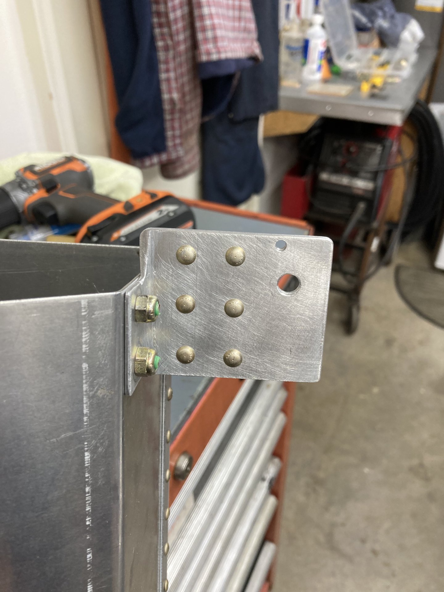

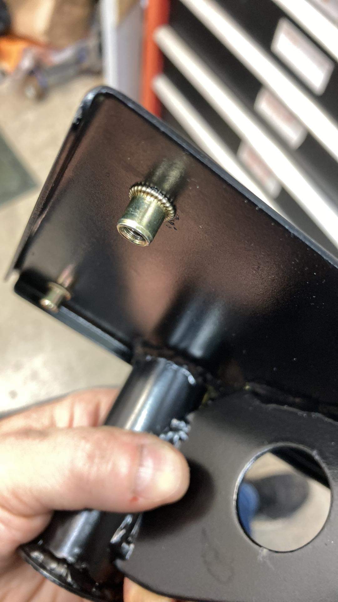

If you're ever concerned about nutserts slipping, put a small amount of epoxy on the crush area before installing them. I've seen them slip a few times and it's pretty frustrating. I'm not saying yours will slip, but the epoxy tip may help someone reading this later who has never used nutserts before.
I insert them with locktite after I clean them with isopropyl alcohol
