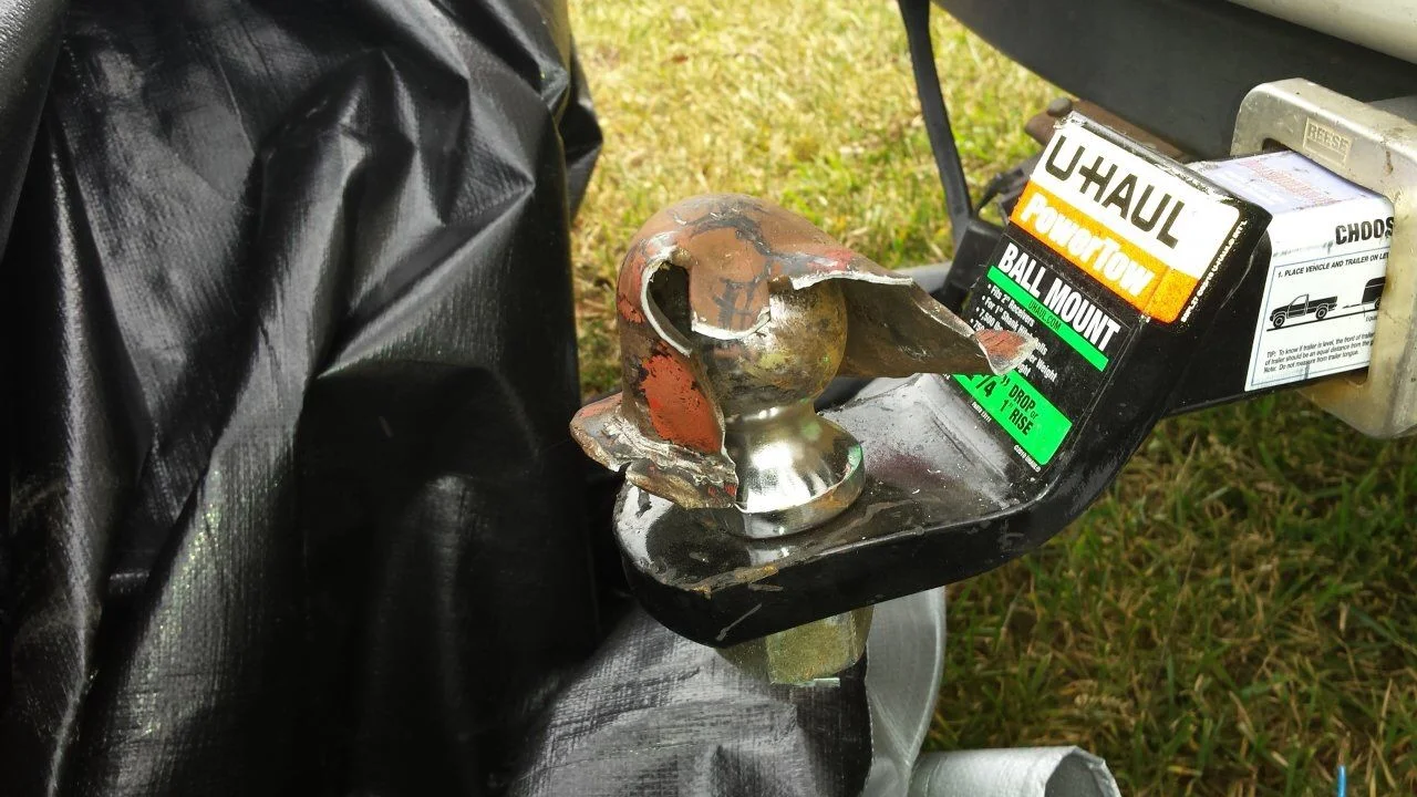

Based on the pic, I'd care to guess the load exceeded the GVWR of the trailer, tongue weight of both trailer and 100, and towing capacity of the 100. The tongue weight must've contributed to roll since the PS rear tire blowing shouldn't.

Delancy, The 99s had 6500lb towing weight. It should have been OK. A stock hard top 40 weighs in about 3500lbs add some for accessories etc.... maybe 4k max. The trailer looks to maybe had another 1000lbs of parts on it. Most tandem axles are at least 3500lb axles and that trailer looks really light maybe 11-1200lb. So it should have been below the trailer towing weight of the 100 and probably the trailer too. But loading, tire condition etc... are obviously unknown. But I think it could have been within the recommendations of both the trailer and Cruiser.
It is unfortunate. It does not seem like it should have happened as the second tire should have balanced the load to a stop.
That's a suggested weight used in commercials, not a tow rating, and best used to determine how big a boat can be safely hauled.
I bet there's more there than 1K, but irrelevant because the weight is on the tongue, which has a maximum rating of 750lbs listed.
Add half of the 4k of the 40, because the weight of the engine is in front of the front trailer axle, and it's like a giant, unpredictable lever pushing down on the ass and of the tow rig.
100 GVW 5k
100 GVWR 7.2k
Assume the trailer has an adjusted (down) 3,500lb capacity per axle, that's a 9,200lb payload capacity.
This load is far less than 9,200Lbs.... 9,200lbs is a lot more than the 6,500 tow capacity, but can guaran-damn-tee you'd have to be a seasoned hauler to safely travel at the limits of what's posted on the pillar.
Just because it says one thing, it isn't a blanket statement that covers all variables.
But loading....
Loading says it all, not only weight distribution and securing to the trailer, but a trailer that's structurally sound.
The other factor is braking, and the trailer doesn't have.
Especially a rear trailer tire, which assuming this had to be, because the other three in the pics aren't blown out.

Second, I have had 2 complete blowouts with my double axle trailer. I am unsure how that could have happened, that is the reason for a second axle/tire. Each time I have been afforded time to slow down and pull over. The only thing I can think of is the trailer was unevenly balanced/loaded which caused for immediate unevenness that caused the flippage.
The 100 has a large tow cap for what it is, the limiting factor is the brakes and rear suspension. The engine has no problems towing 6500. In this case, the trailer and truck were probably in the 5500-6000 range which is under the TC. But in the end, there are many variable- how it was loaded, does it have a brake controller, air bags, driver experience, tire condition, etc. Many variables.
All that said, my 100 will be the reserve TV for me. I tried to make it my main TV but after towing with our now sold diesel Excursion, the long wheelbase and diesel engine make the 100 mediocre at best.
