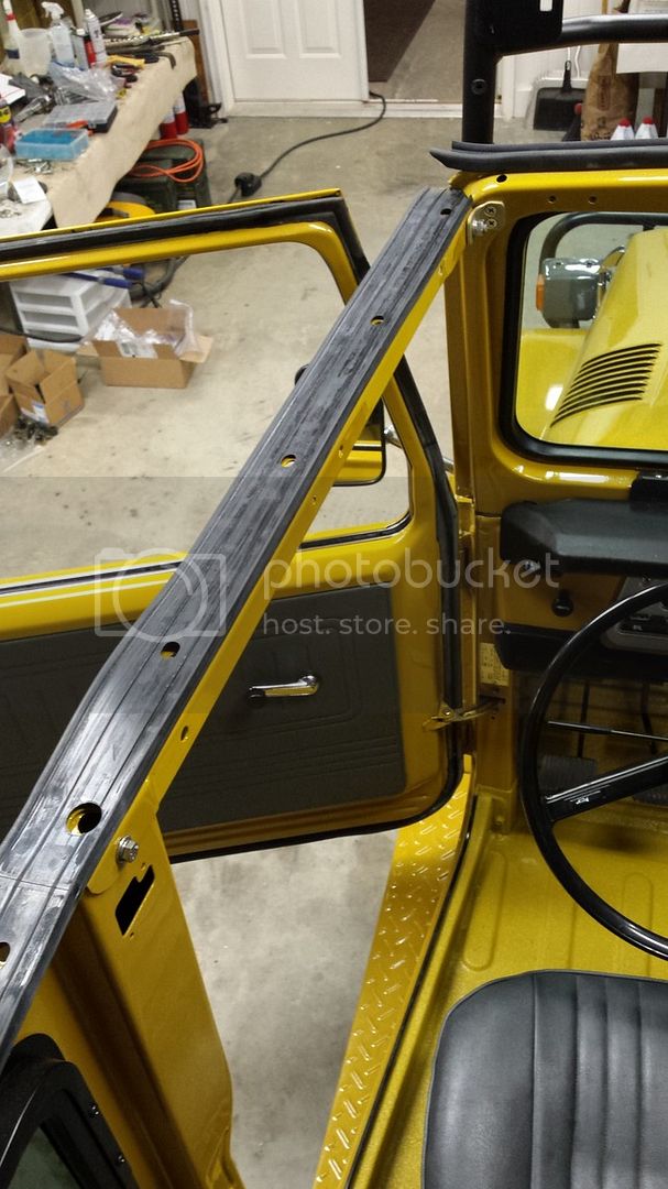

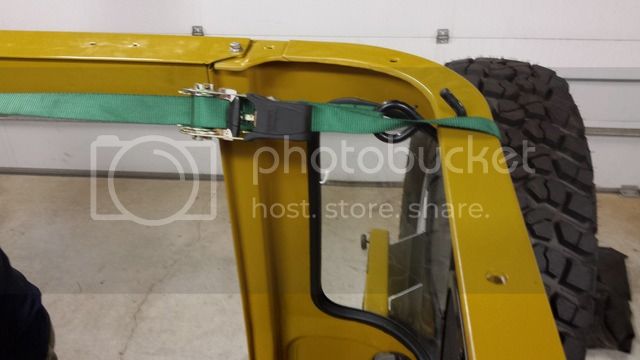

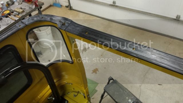

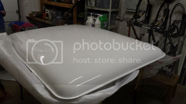

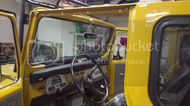

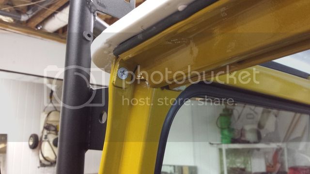

fiber glass cap was taken to linex prior to paint for their treatment to the interior. we did this for insulation and also as an additional moisture barrier so nothing can come in between the visor and the cap.

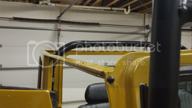

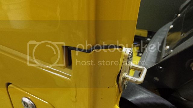

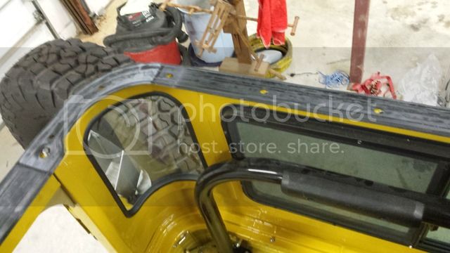

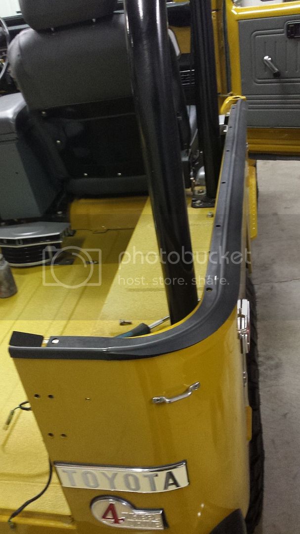

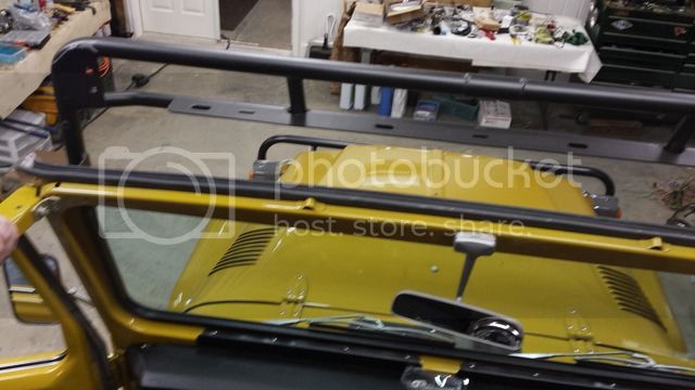

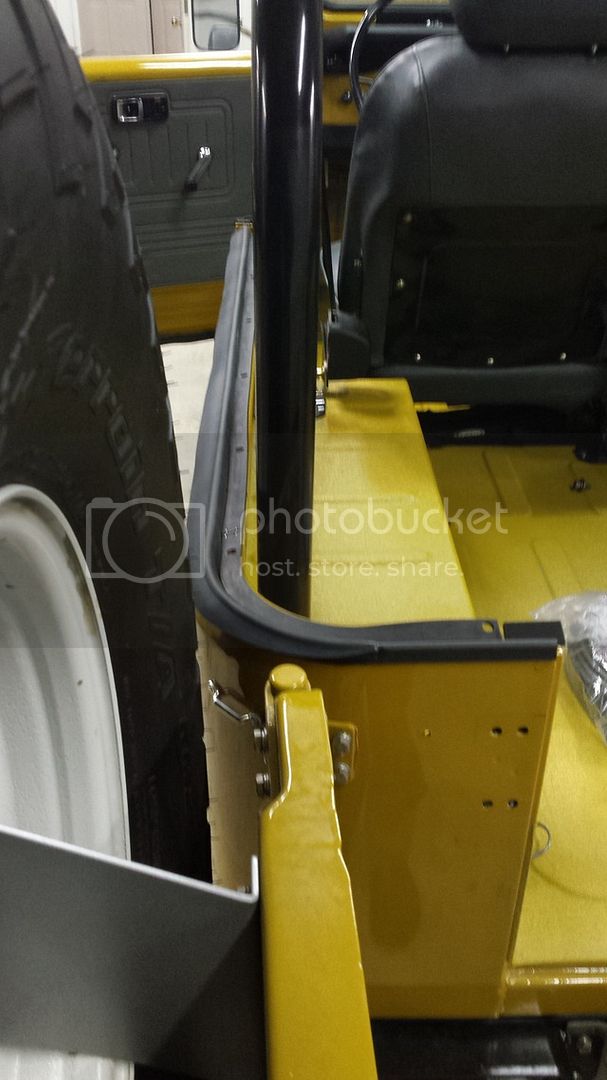

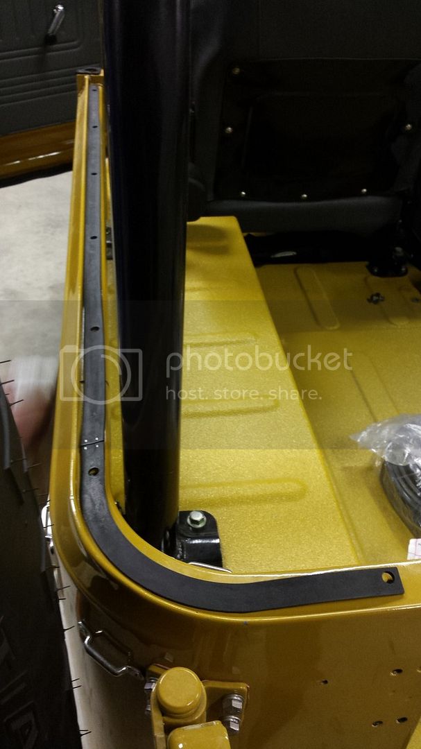

we used stainless hardware on the entire hardtop and applied a very generous amount of anti sieze. I was really impressed at how well the front doors line up with the body lines and feel excellent shutting and opening. On a negative note the SOR sliding windows look great but do not work with jump seats. We will need to space the jump seats away from the top rail roughly an inch to put them back in. ALSO the damn latch for the sliding window hits the factory roll bar! So at the moment they only open roughly a 1/4 of the way. Would have been nice to know this prior to purchase!

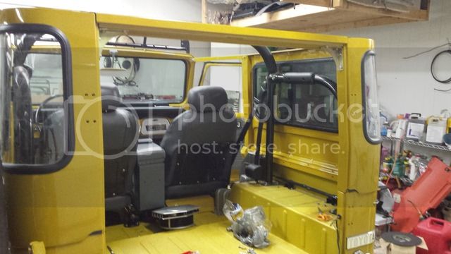

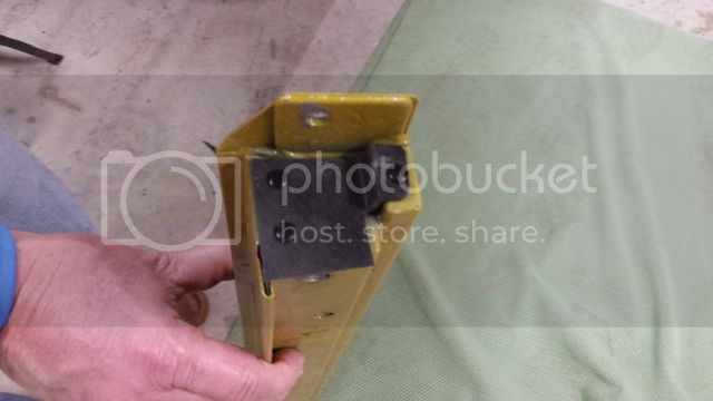

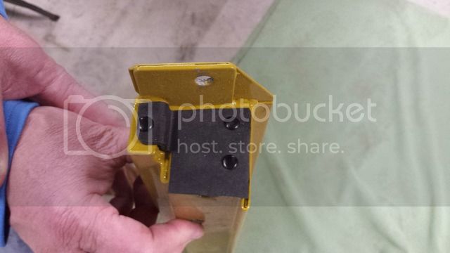

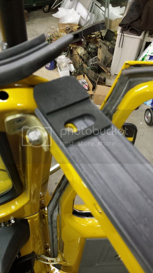

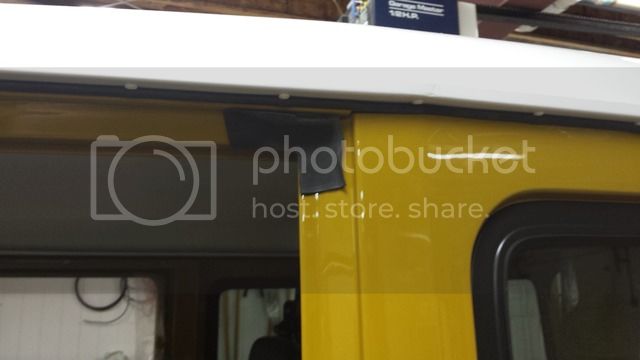

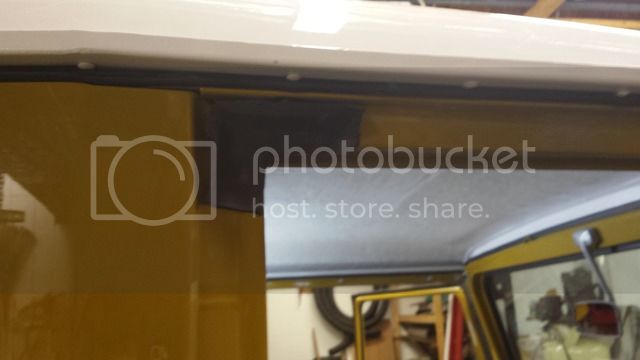

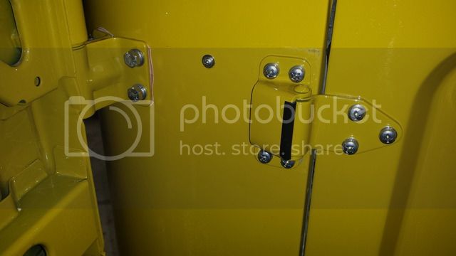

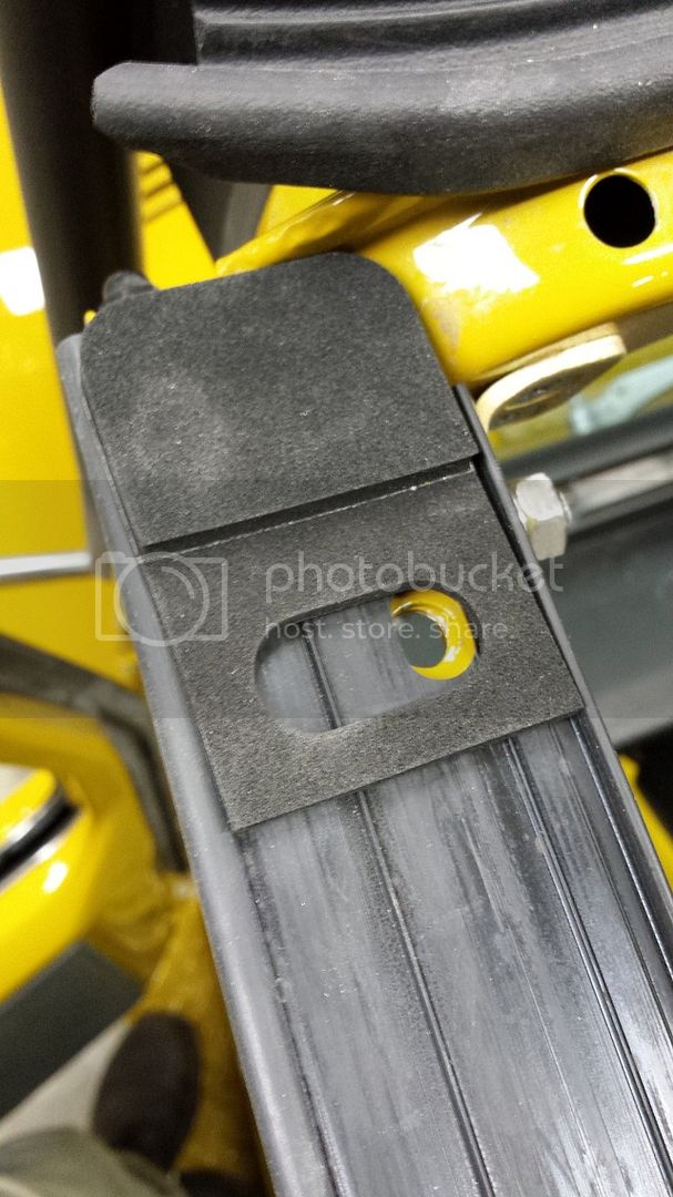

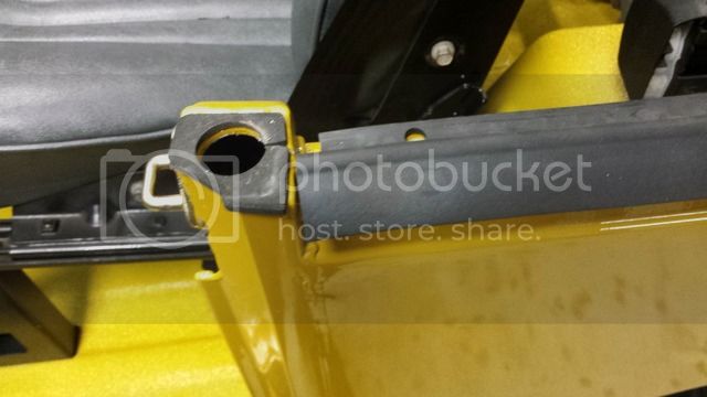

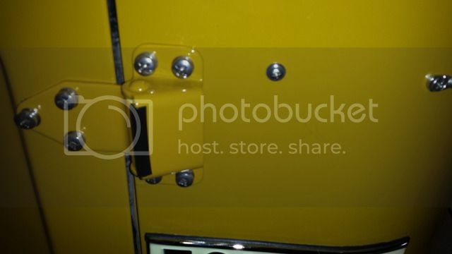

This brings us to the rear doors :) We made these gaskets for the ambulance door hinges.

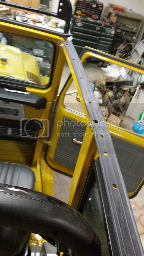

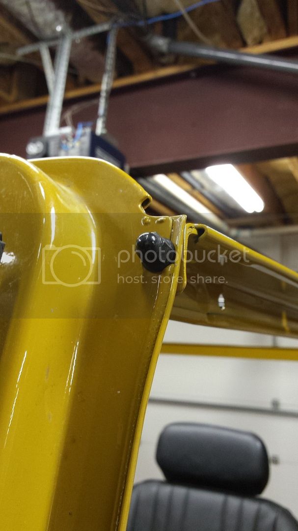

There is one small hole in the same spot on each quarter it is from the footman loop that is installed while the soft top is being utilized. The footman loop picks up that hole and an ambulance door captive nut. We simply stuck a small stainless screw and nut into it when we installed the hard top.

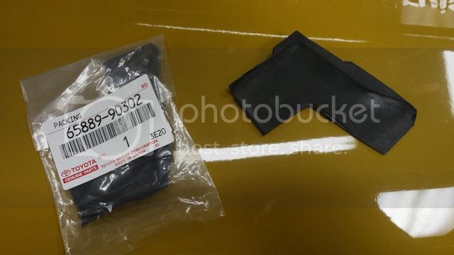

new Toyota grommets for the license plate light wires

What material did you make your gaskets from?
Thanks! Im not sure where tucker got the rubber but it is very thin and extremely pliable. I'll see if I can get him to chime in on where it came from.

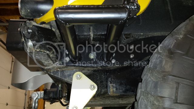

we also installed these little bumpers on the lower ambulance door to protect the paint when the door is opened all the way.

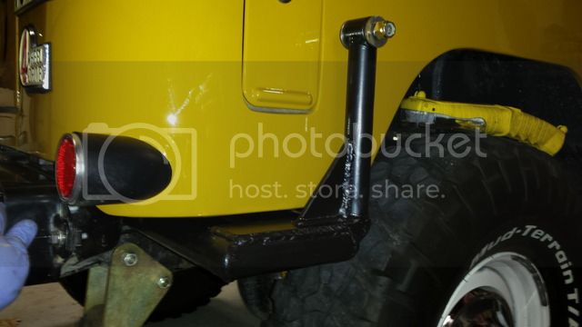

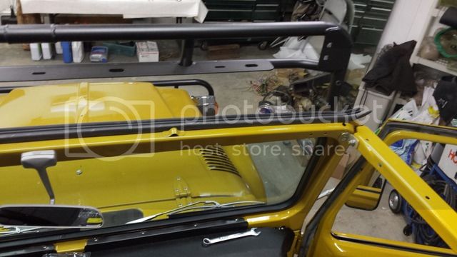

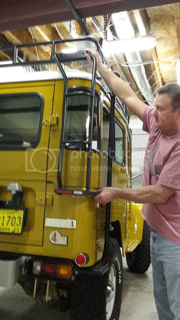

looks like we will need to modify one bracket to install the rear ladder.

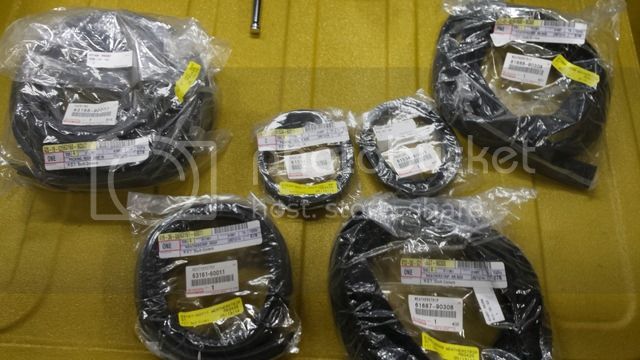

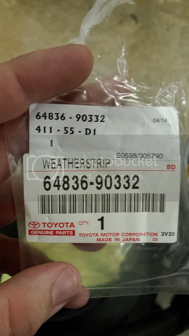

And thanks for all the pics of the various OEM weatherstripping and "packing". I'd wondered how some of those pieces worked out and your pics provide great visuals. I've got all the part numbers gathered up for when I do the disassembly and repaint... this thread will be a great reference to piece it together properly.

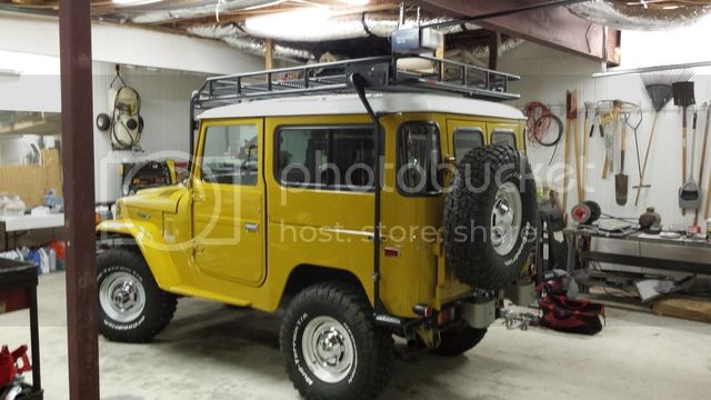

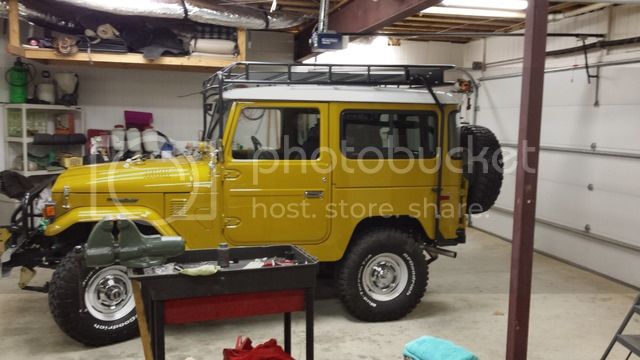

update from work done back during the summer. We made a bracket to make the ladder work with the revised roof rack. Also added 4 and 7 degree castor correction shims to correct the caster. Tucker reported the truck tracked much better after this.
Tucker also installed some led bulbs in the instrumentation illumination and dome light which were much brighter than the oem incadescents.

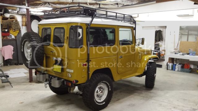

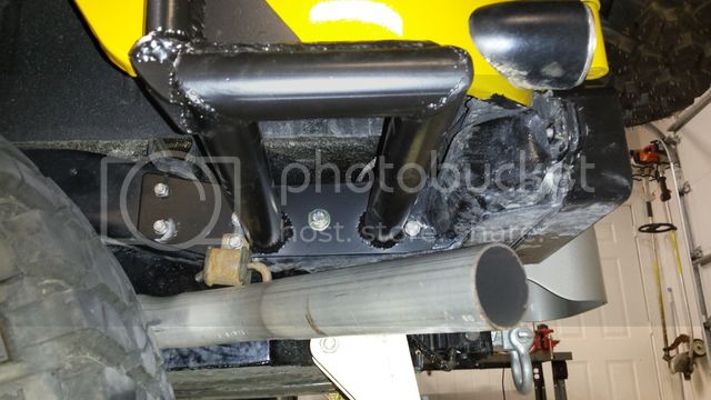

The 33'' tire was a bit too much for the factory tire carrier and we were having problems with the latch coming undone after welding additional material onto the latch so Tucker made the decision to procure the 4plus tire carrier swing out and 4plus tail light guards.
