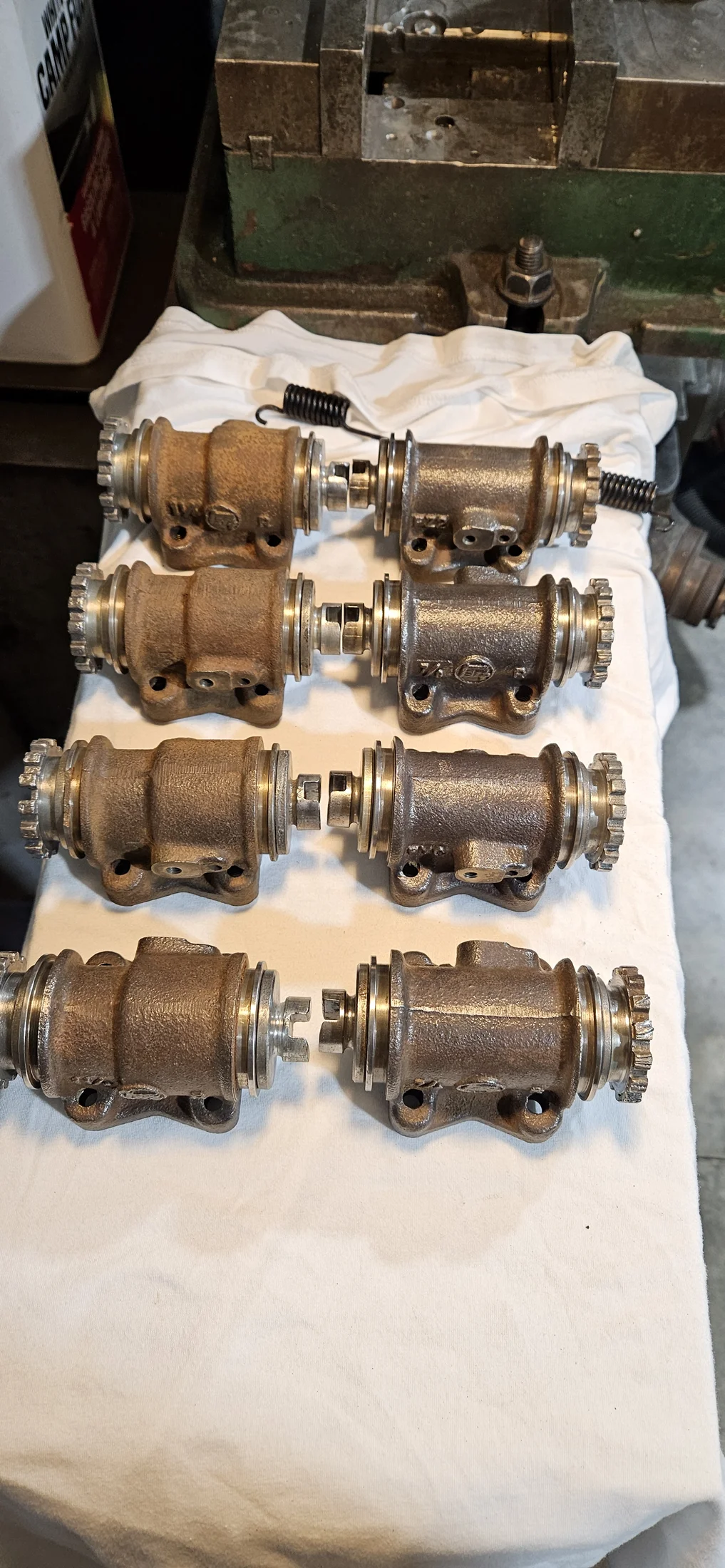

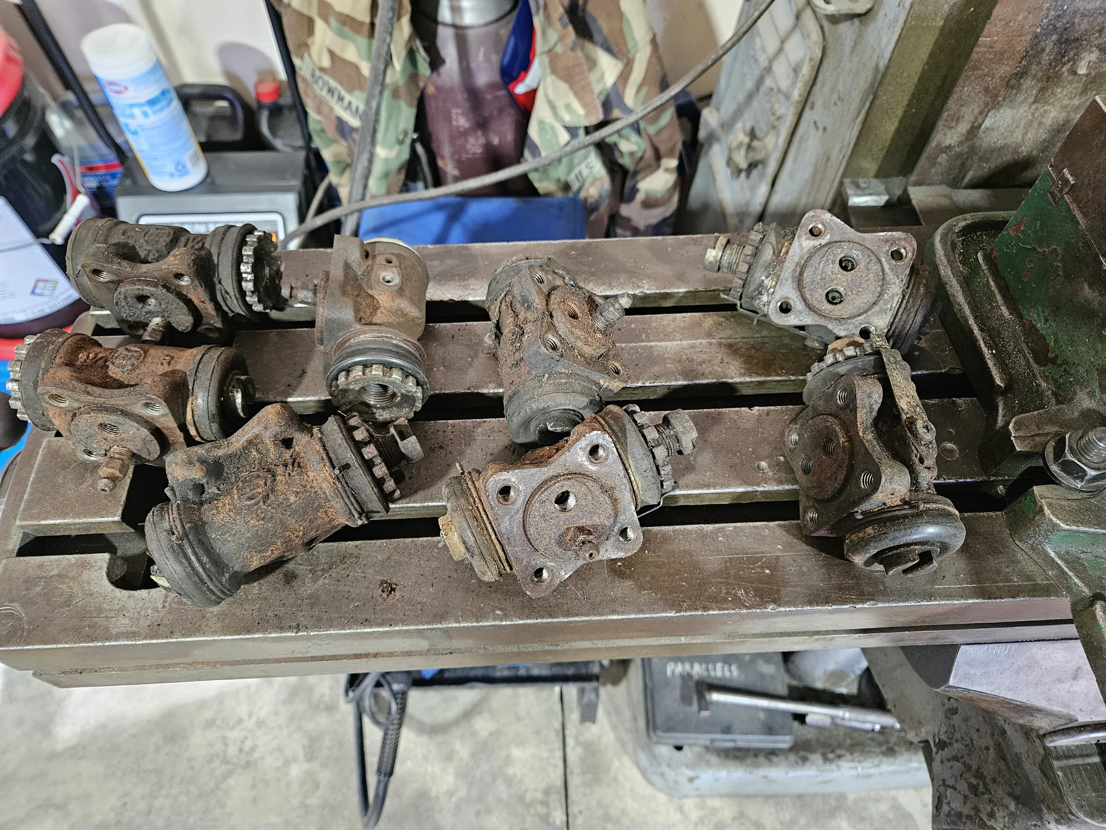

When I first took ownership of my 01/75' FJ40 I replaced the entirety of the hydraulics on the braking system. The parts were sourced by the previous owner through CCOT. This included wheel cylinders, master cylinder, hoses, hardlines, and additionally a full set of shoes. The drums and hardware were re-used. After less than 1,000 miles the brake shoes failed with a couple shoes suffering a complete separation of the friction material from the shoe backing. I replaced all the shoes with Beck Arnley shoes 081-0887. About the time I changed the shoes, the wheel cylinders started sticking and I noticed a substantial decrease in braking performance. Fed up with the poor quality parts I opted to start the process of rebuilding the original wheel cylinders in preparation for the trucks second complete brake job. To top it all off, the CCOT master cylinder began to weep from the fluid reservoirs and has been an eye sore in the engine bay since installed.

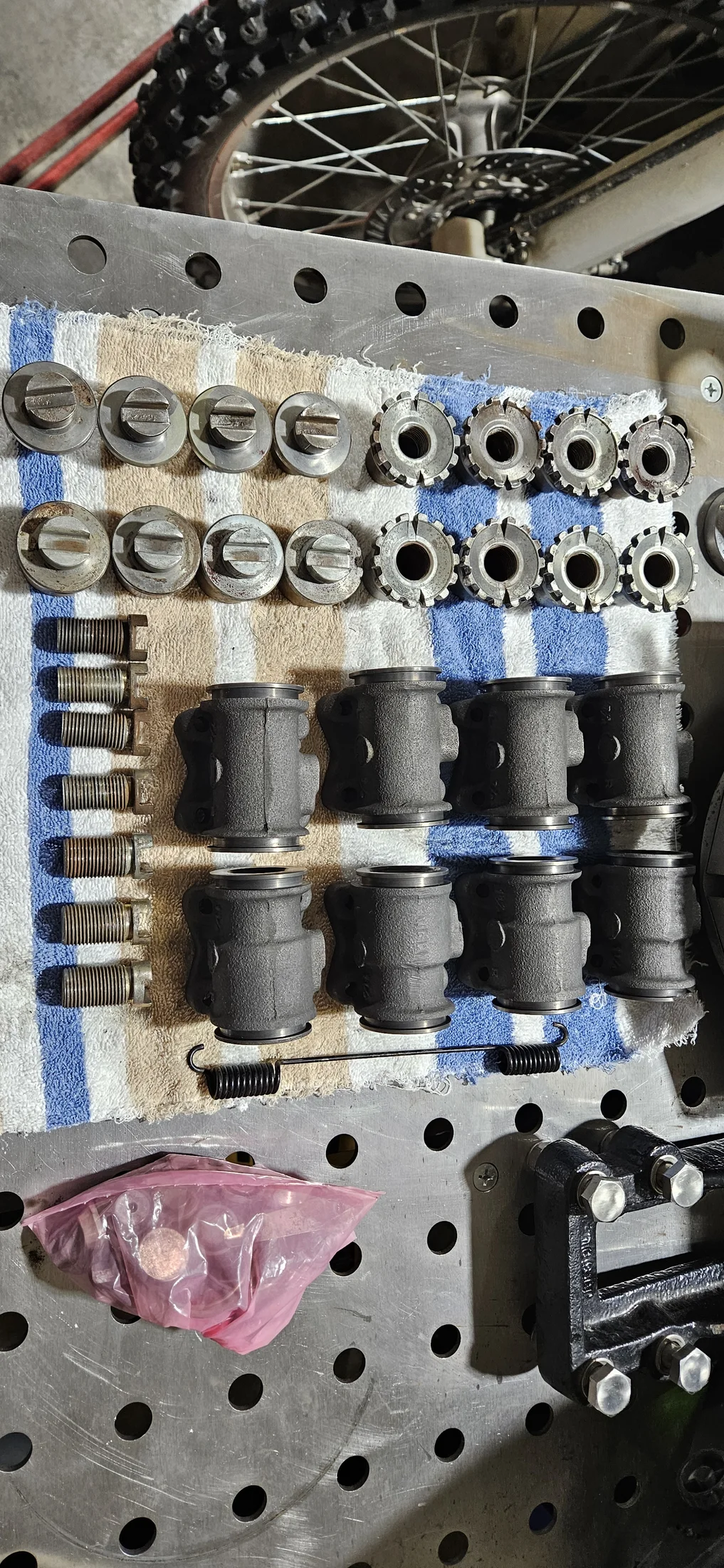

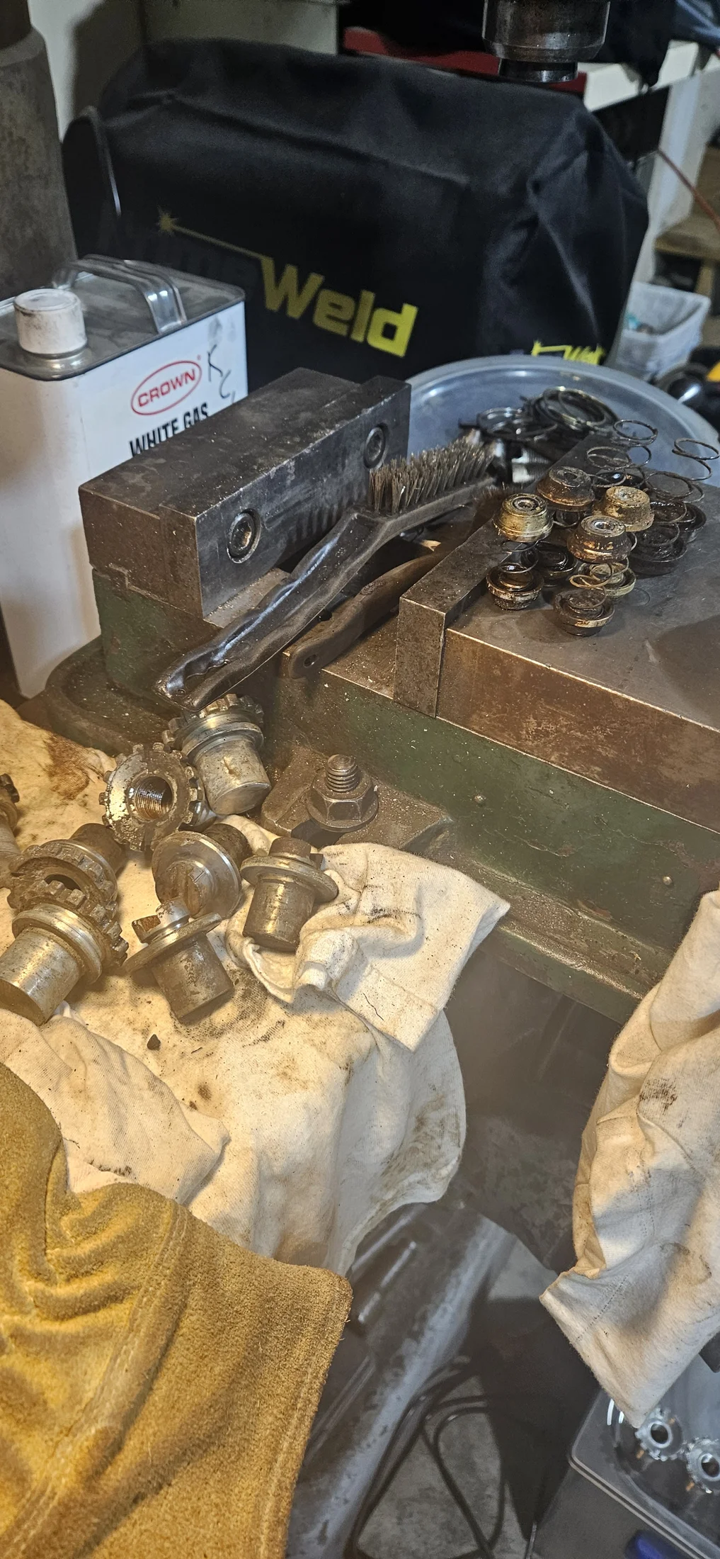

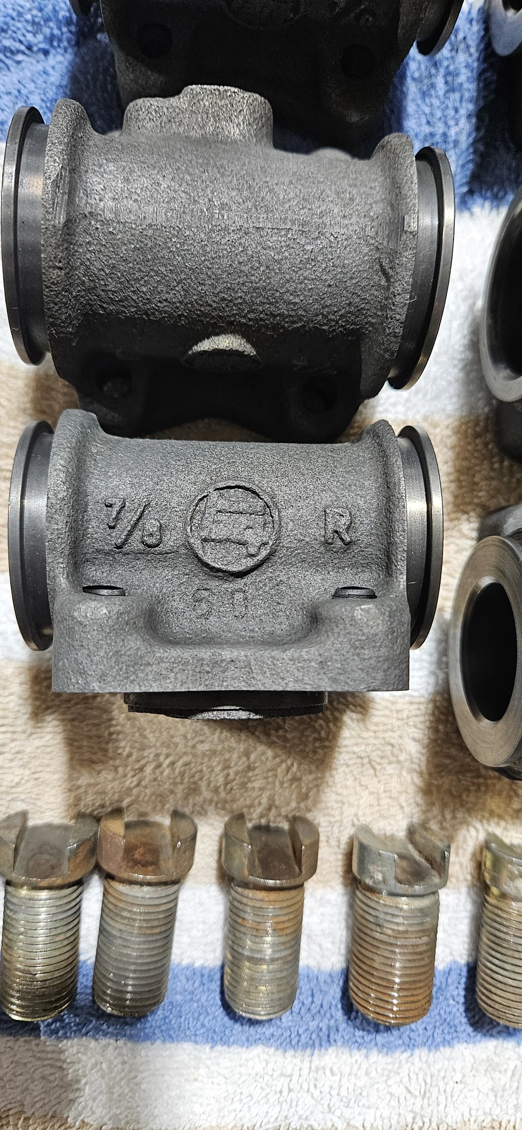

After a lot of patience, a bit of heat, and a lot of soaking I was able to get the original wheel cylinders disassembled, cleaned, de-rusted, and lightly honed. Now we just need some quality made in Japan OEM parts!
The first issue, which I have been aware of for some time, is the OEM master cylinder, 47201-60030. Discontinued by Aisin and therefore no longer available through Toyota or Rock Auto. I understand there are a few suppliers that still have a limited inventory of the "aftermarket" Aisin masters, but holy cannoli the price went from like $75 to $375. I get the whole "supply and demand" explanation, but from a customers point of view this increase is VERY hard to justify and extremely frustrating.
The second issue is the wheel cylinder rebuilds. After teardown and inspection, I dug through the catalog and got all of the part numbers for the parts I needed. Pretty much unavailable at the dealer so I went to Amayama. The total price for everything was $125 with shipping included. This included replacement of some of the aluminum cups, springs, and even the adjuster lock screws. Everything needed to make the originals function as new. Then I get an email stating that there is a supply restriction on the cup kits (rubbers) and that they can not be shipped to the USA. WTH, we can get failure prone garbage from China through CCOT but we can't get the original Japanese rubber parts through Toyota in Japan?!?!? I know there are stateside suppliers that offer a Japanese sourced cup kit but JUST the price of the rubbers is MORE than everything I needed through Amayama (a Japanese middleman).
On the surface it looks like the wheel cylinders can be ordered through Amayama for about $100 each but that's $800 just for wheel cylinders. Add in a $400 master cylinder and you could have bought a couple of nice guns. The original MSRP for the WHOLE truck was only about $5,000. I'm getting a little too long in the tooth for this nonsense.
So how do I approach this issue without selling my soul to the devil to pay for it? I need quality Japanese parts at a reasonable price. Is wanting to be able to stop my rig safely, dependably, and still be able to eat too much to ask for?
