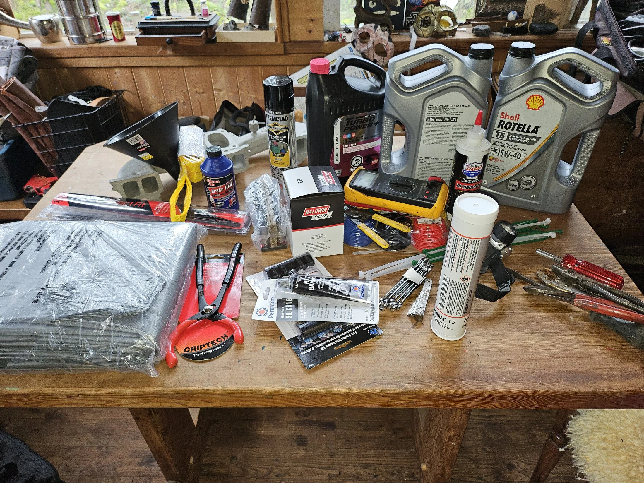

Well, that was fun! Oil change went easy, though I was shocked how thin and black the old oil was. Would have thought it had been done recently, and I'm glad I didn't take any chances. The ground clearance and top mount filter make it a breeze. All engine bay fluids checked and topped.
I used a chunk of tyvek to keep from becoming one with my mud driveway, and it's now a part of my kit.
Speaking of kit, it's coming together thanks to suggestions frome the hive mind. I'll see what I can fit under the seats, then add a tub of spare parts for boonies when the time comes.
In terms of driving, it's getting even more fun. I'm learning to trust the torque and not over rev when rev matching. Oh the sounds! She sure lets me know when I get it right.
So, even with my busted rib, it's great. All the fluids are happy for now, though I'm wondering if I should re and re the gear oil. Tomorrow I beg buy borrow or steal a grease gun and hit the chassis, now that I know my old body can crawl around under without drama.
