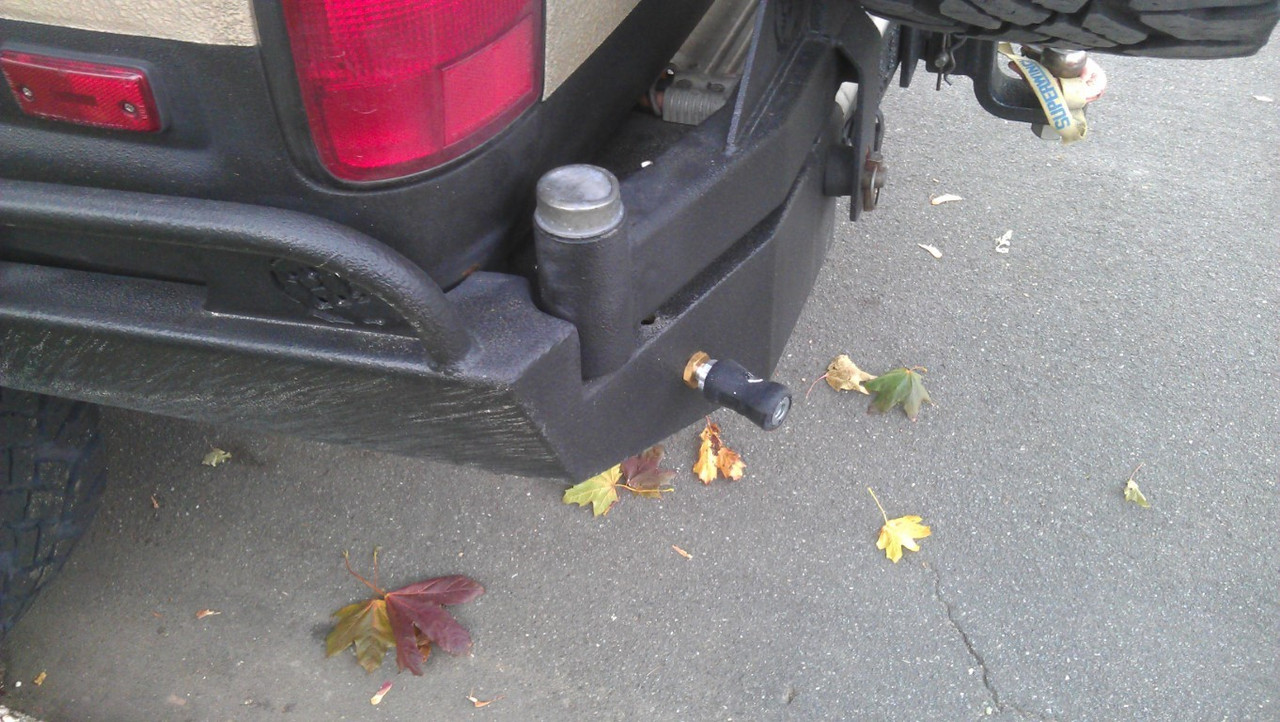

Divorce my puma from the tank and put it in a 2nd battery tray under the hood, controlled with a switch on the dash. Run hose from compressor to tank mounted under truck somewhere. From tank, 4-way manifold running out to each corner of the truck with a quick disconnect mounted to each bumper corner. Then 4 small straight sections of hose to run from the bumper corner to the tire.
Everything is hard mounted except the 4 small hose sections that go to each tire (36" lengths or something like that). Minimal stuff to pack up.

Not a bad thought, but a LOT of threaded connections to maintain and with a truck that flexes and moves and lots of thermal changed, the hard lines will leak. You don't want that on the trail.
I would consider it with hose, covered for high wear areas, but it must be well secured. Hoses made to length for each location.
Make sure to have valves near the distribution block for each line so you can isolate one line if necessary, especially if you depend on air for lockers.

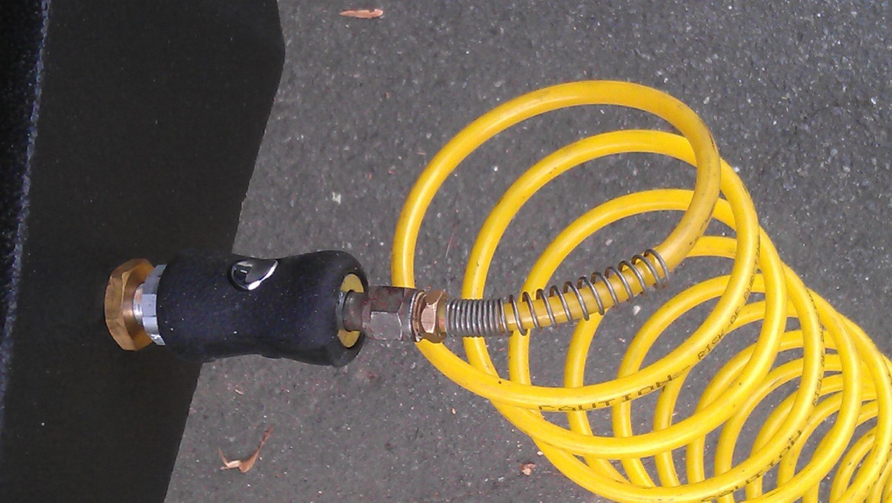

Maybe a kit like this would work well. Harder lines for durability but still flexible.
Alright it's been tested. Let me say, it's really easy to walk around and clip all (4) on then dump the air and stop to check pressure.
Filling with 1 connection point is also ez. Compressor seemed to like it / not having to turn on and off to check pressure and add to get all (4) tires same psi.
Set the hand throttle/ lock it then fill to the desired pressure, in my case 35psi.
The coiled hoses do take up additional room but the coil is nice since it stays off the ground and I didn't have to recoil it. Upon finishing, it semi auto coils back to compact. Went into the storage bag which fit nicely in the same wing'd compartment (robinsons drawer system) as the compressor. *It was too big to fit in the tailgate storage with the recovery gear.

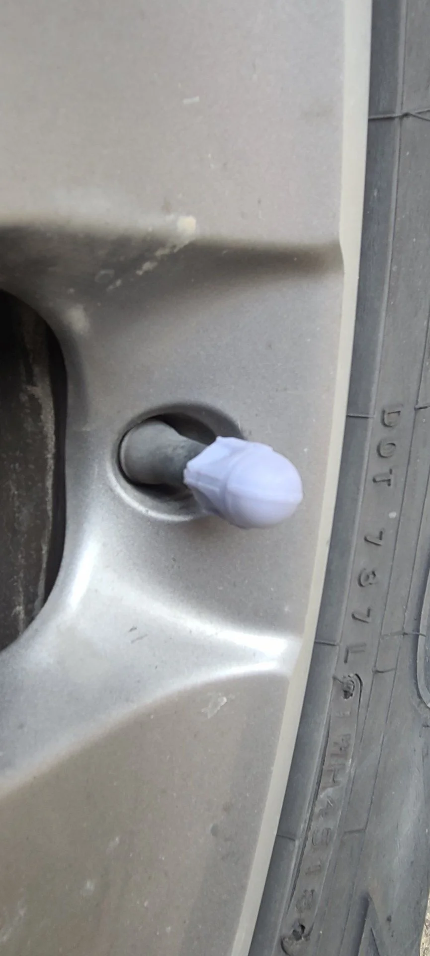

Speaking of valve caps.
I find that i don't loose these caps as often.
Plus when I get lost he knows the way.

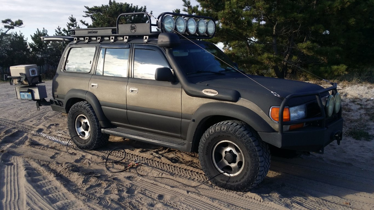

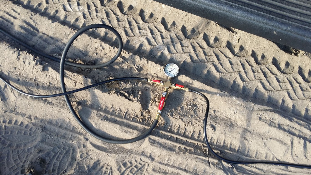

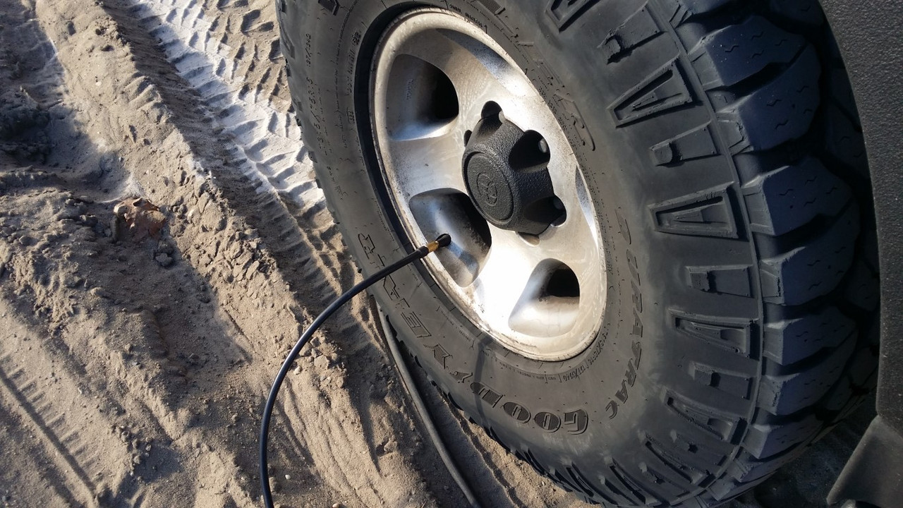

I have been using a home-made version of that ....
Basically a tapped aluminum manifold, a ball valve, an air chuck, and I sprang for a nice fluid filled gauge.
Locking tire chucks and some Home Depot air line. If you don't use the plastic coiled crap, it just wraps up to a nice neat bundle.
All parts are available through Amazon now.
Air up and down all 4 at the same time and all tires equalize through the manifold.
Ditto...
3/8" OD hose and some brass pieces (a brass 1/4" NPT T and a ball valve) from Home Depot, 0-60psi gauge from Grainger, push-in T fittings from MacMaster Carr.
The trick seem to be the air chucks from NAPA - they have two edges to grab onto the valve stem, most others have only one. And I like these for connecting the air chucks to the hose:

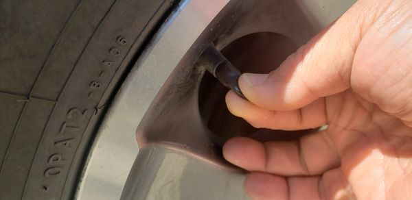

I still air down one wheel at a time by taking out the valve cores; I'm too lazy to unpack & pack the hose system.
