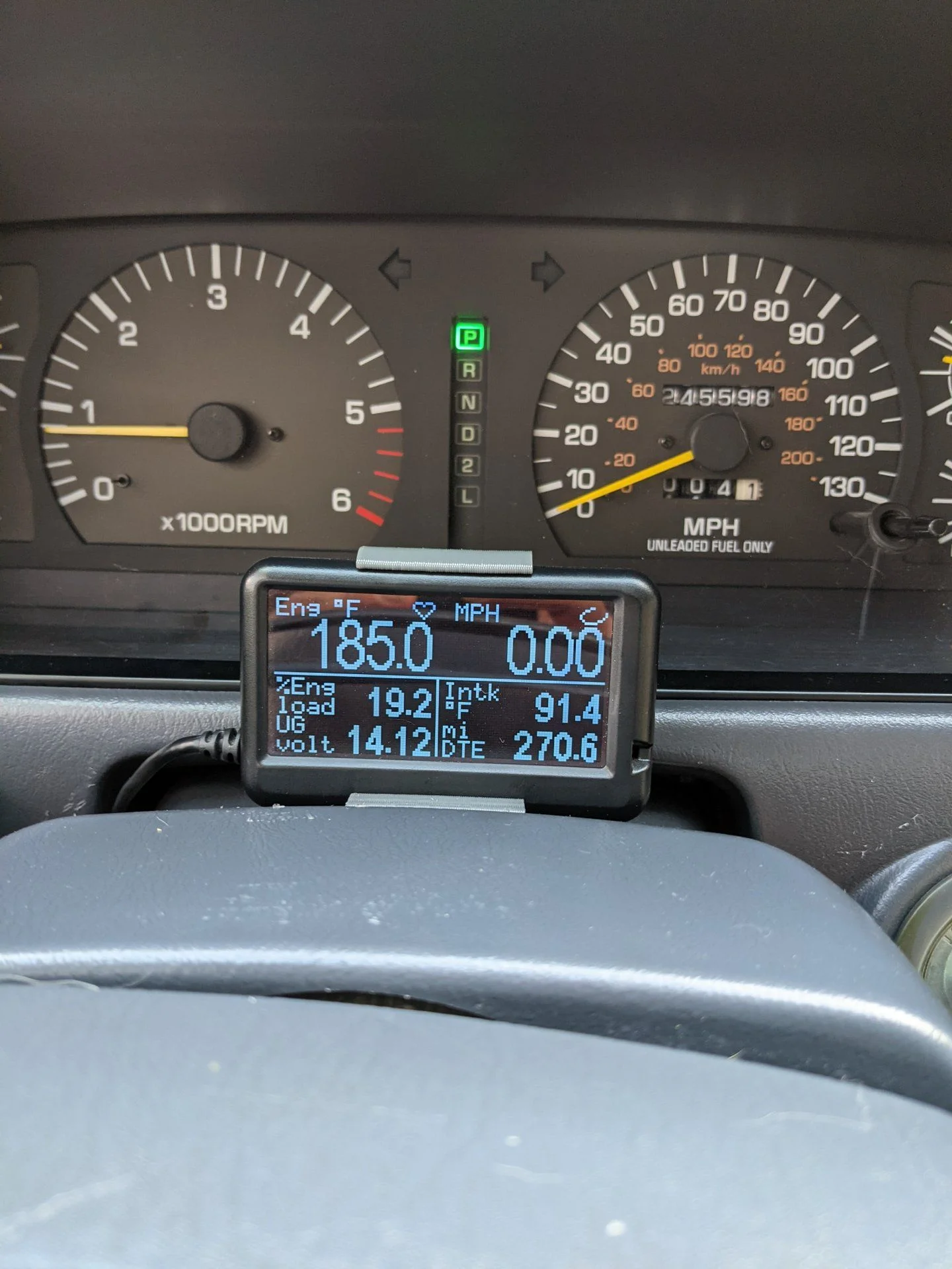

Ultra-gauge

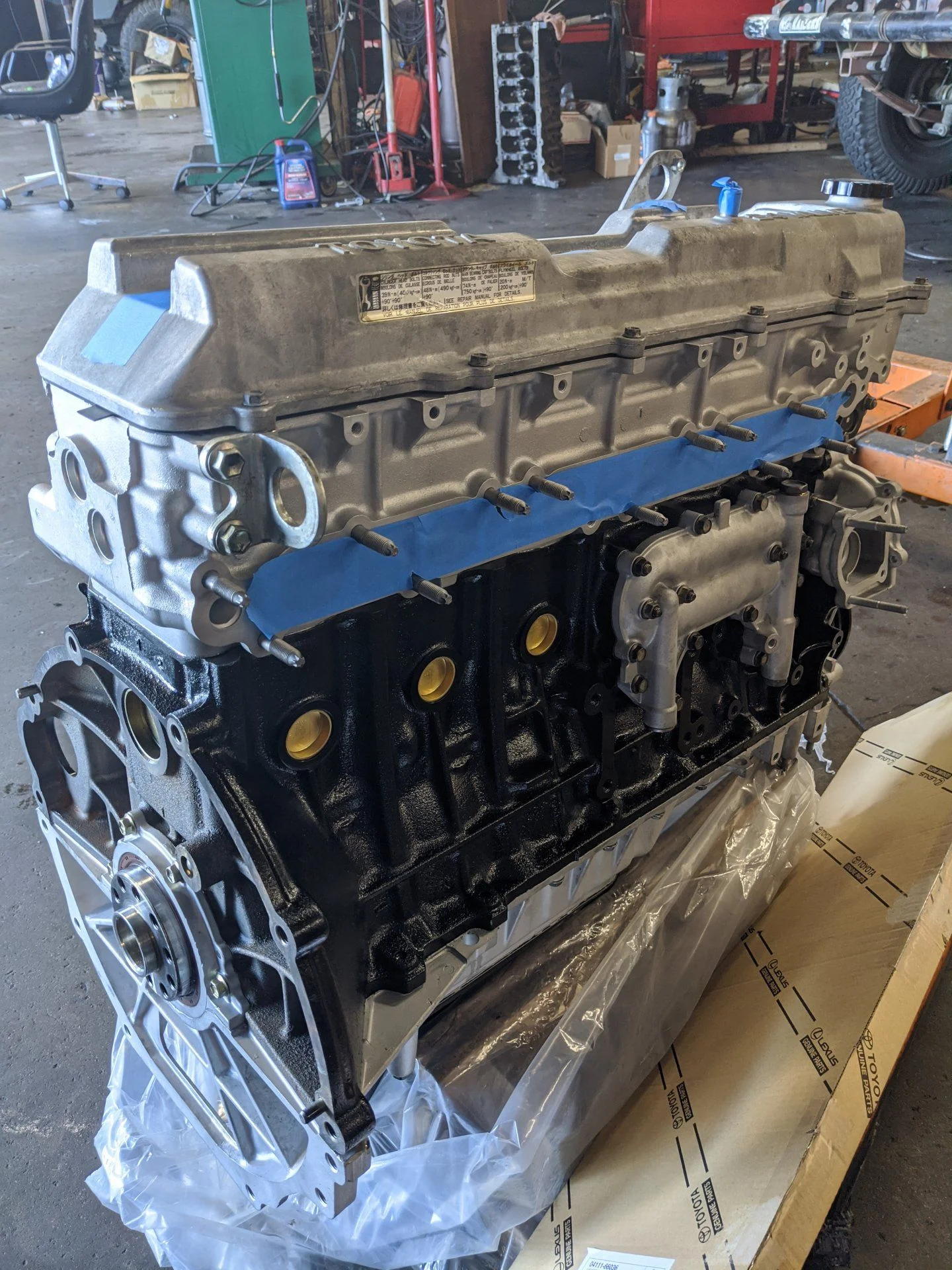

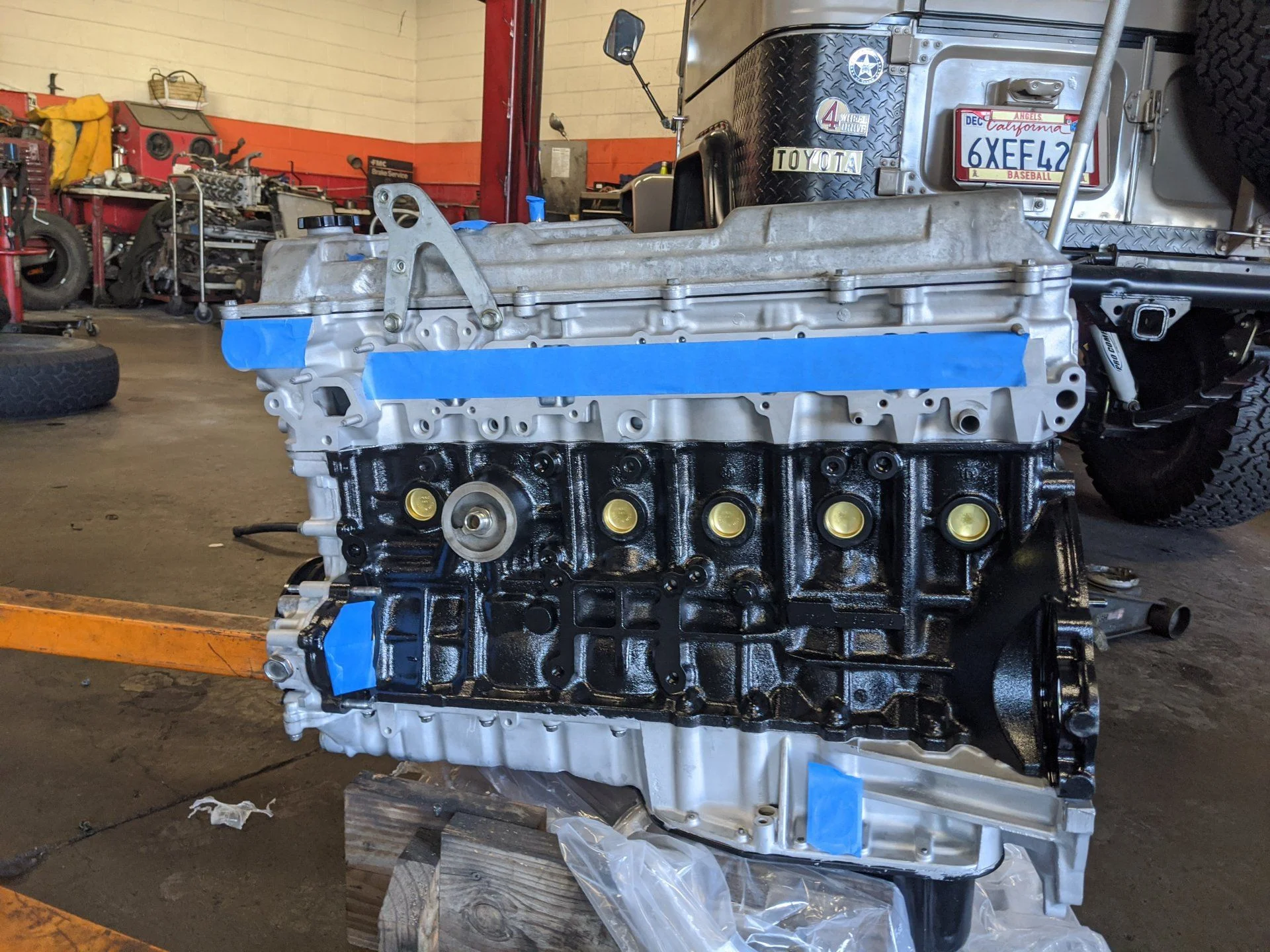

complete engine rebuild at 240k - photos below

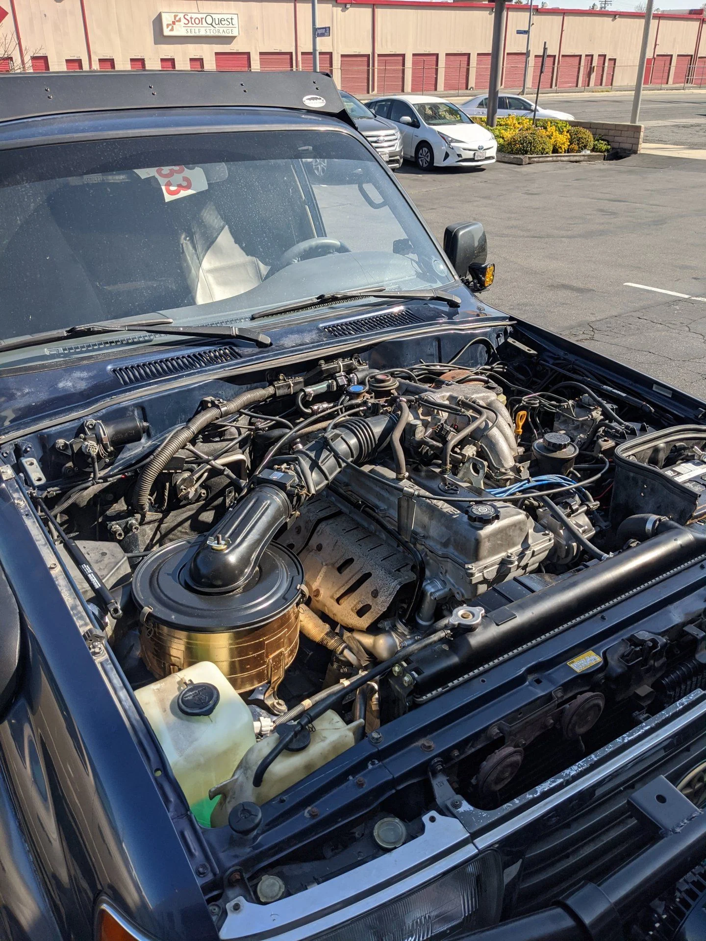

all new hoses, cables replaced heater valve

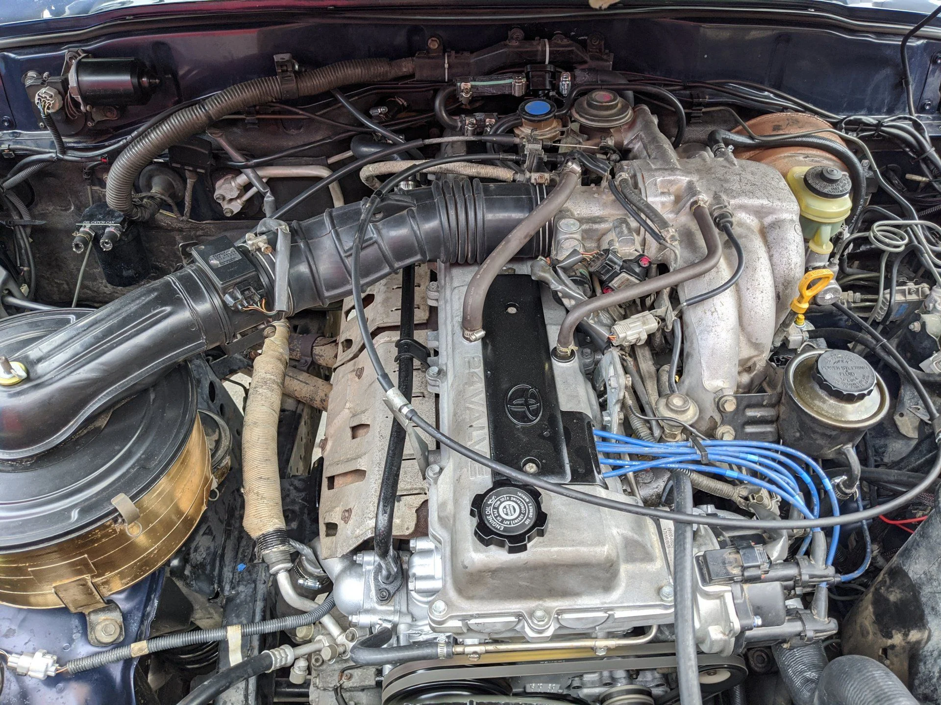

hudd expo EGR bypass kit
wrapped EGR loom with heat shield
oem distributor
oem coil pack
oem air cleaner hose
PHH done
thermostat & radiator
OEM dash light bulbs
VC 120 charcoal canister
oem fuel pump & filters
blue fan clutch with mod

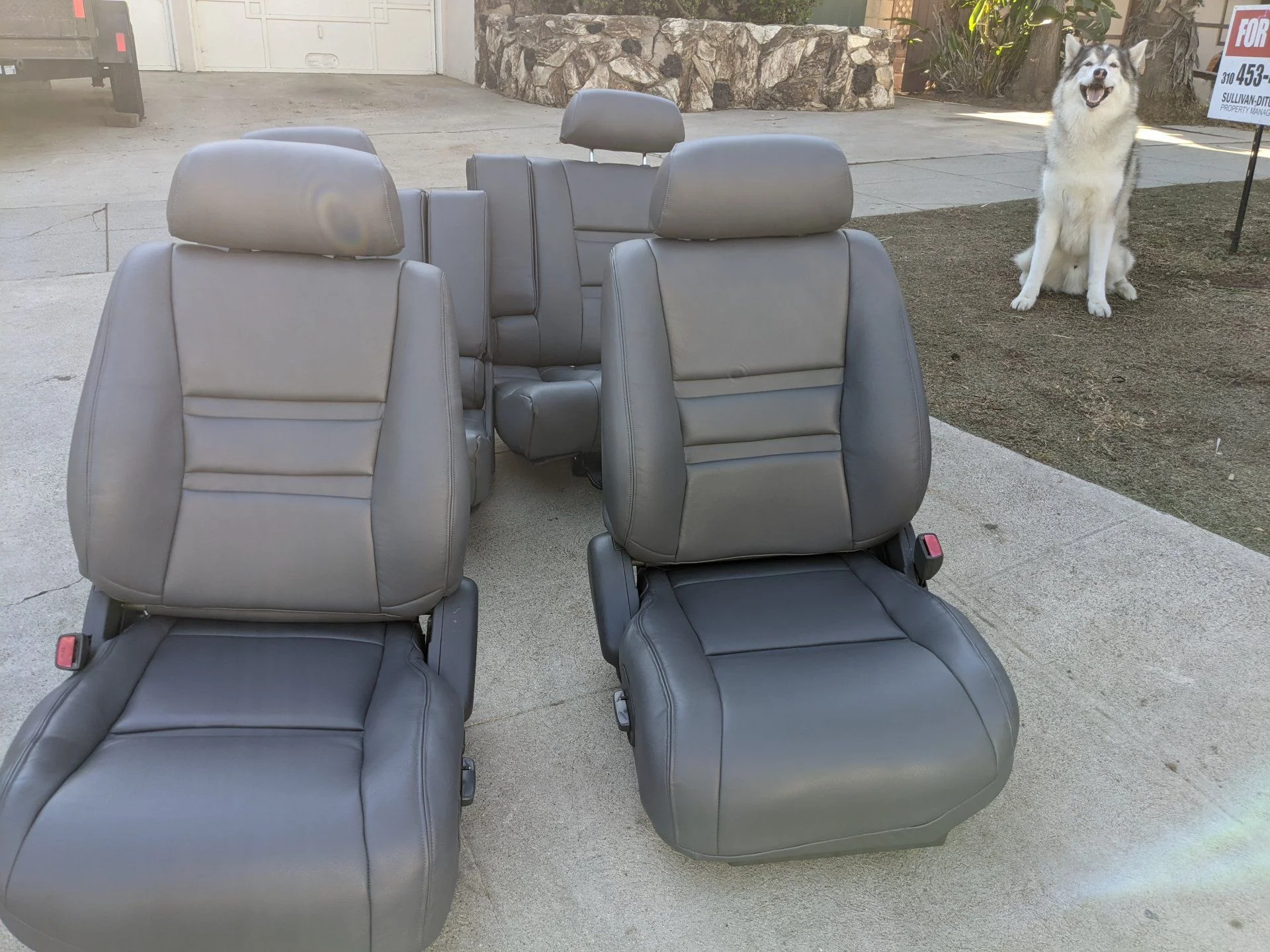

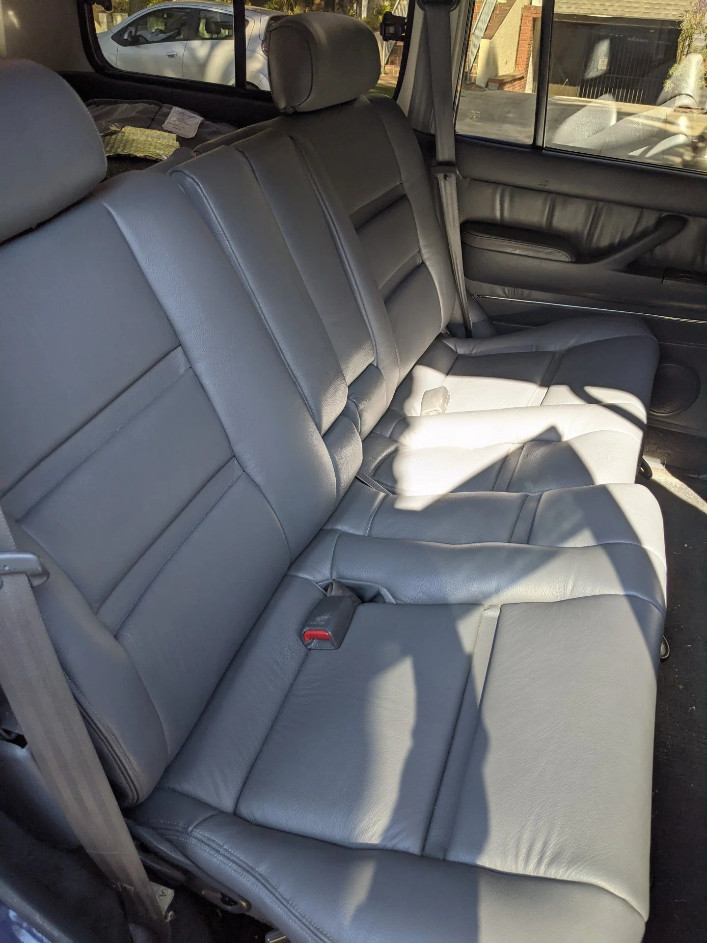

new seat foam and leather by vendor in san diego. + steering wheel wrap

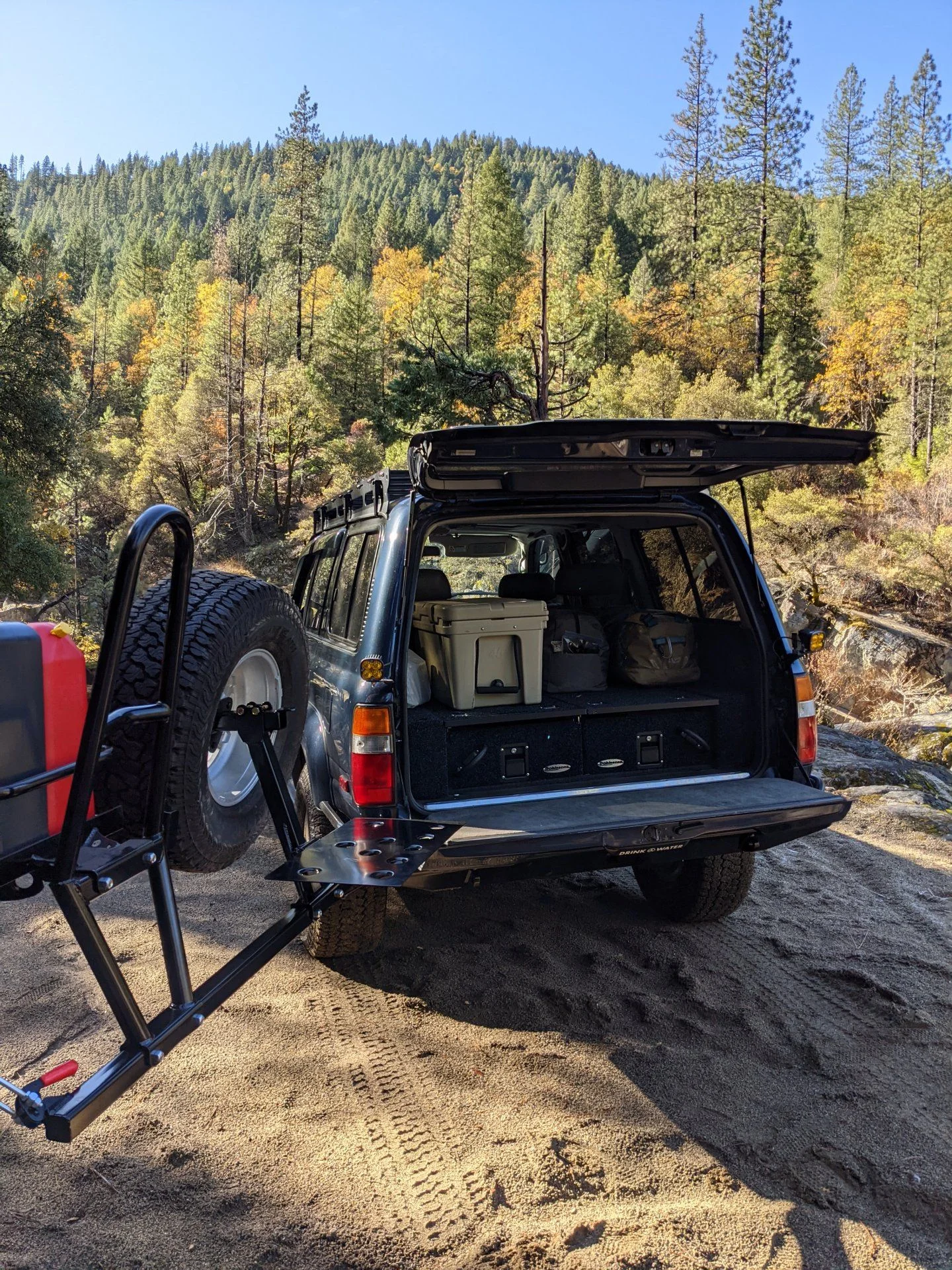

dobinsons drawer system with fridge slide
4x4 labs rear bumper

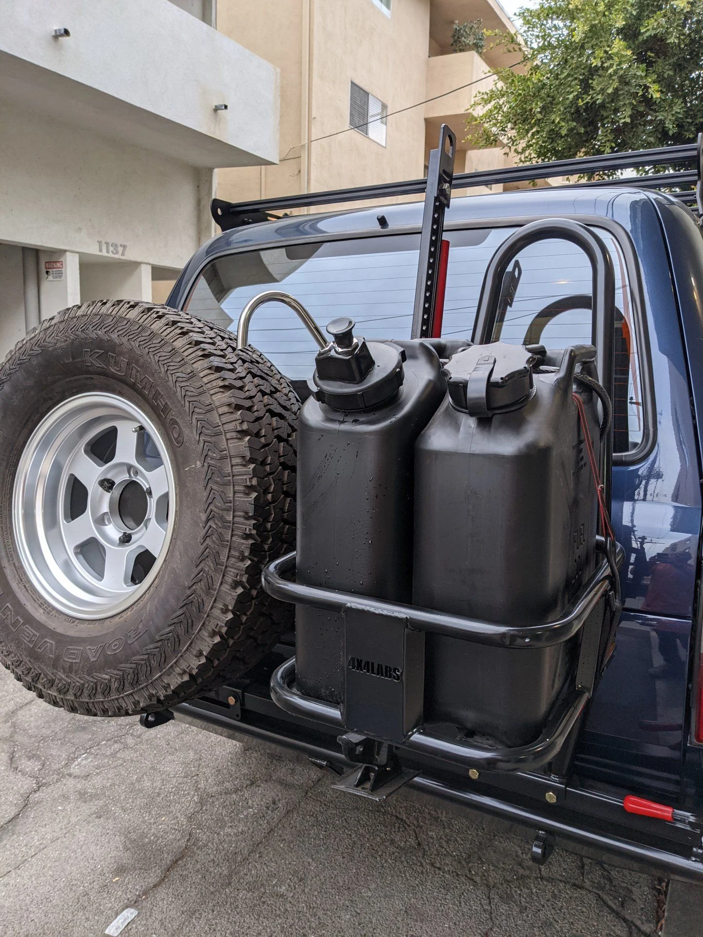

huracan fabrication tailgate storage

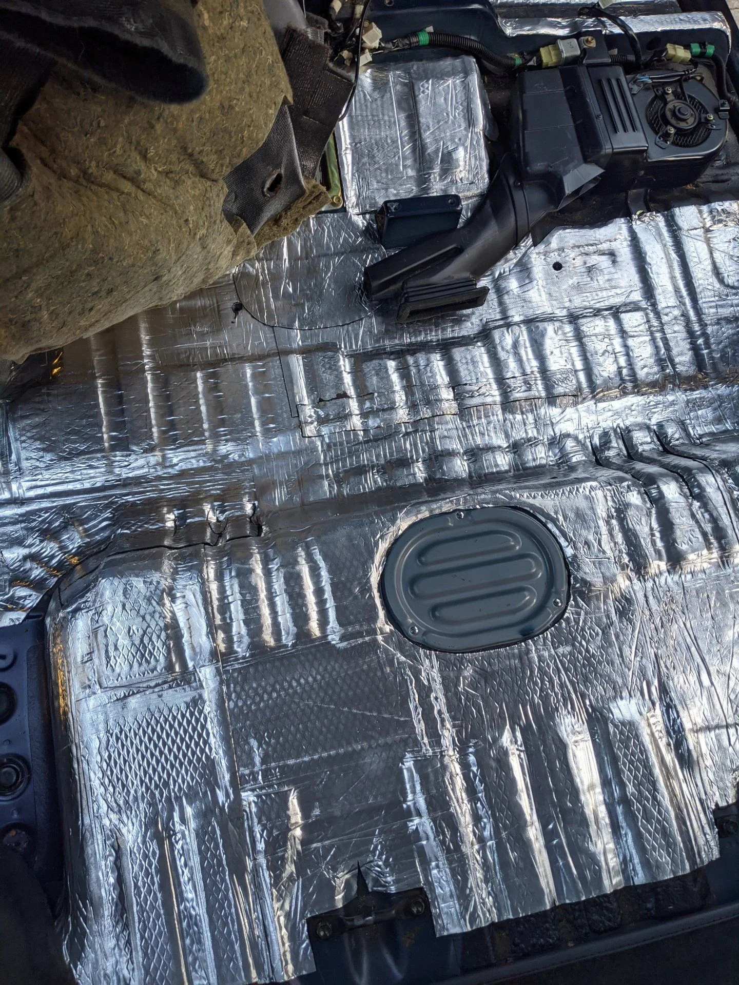

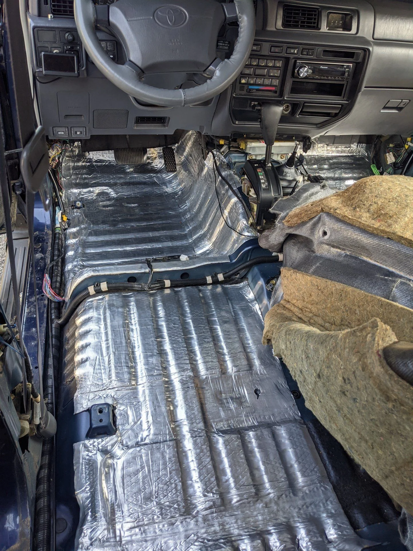

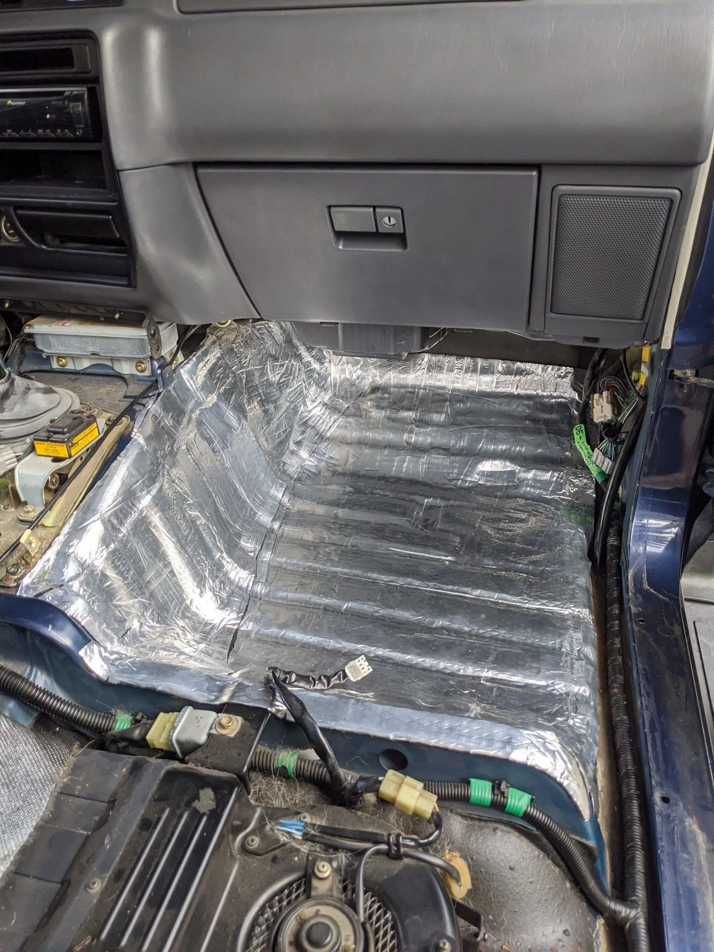

Heat/ sound insulation on all door panels and entire floorboard

Looks great. Did you do the motor rebuild yourself or farm it out...if sent out, who did it?
Nice looking truck and upgrade list.

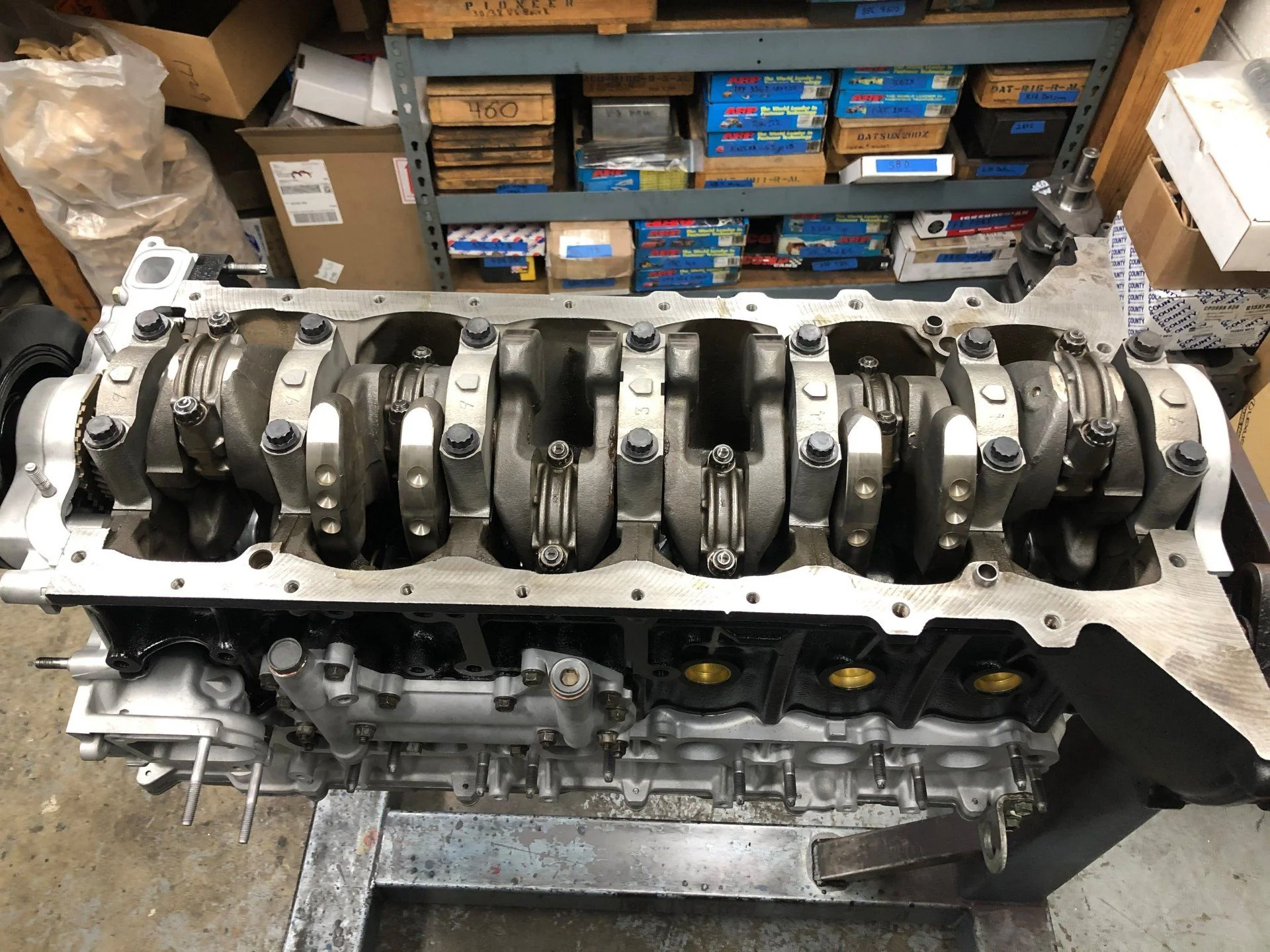

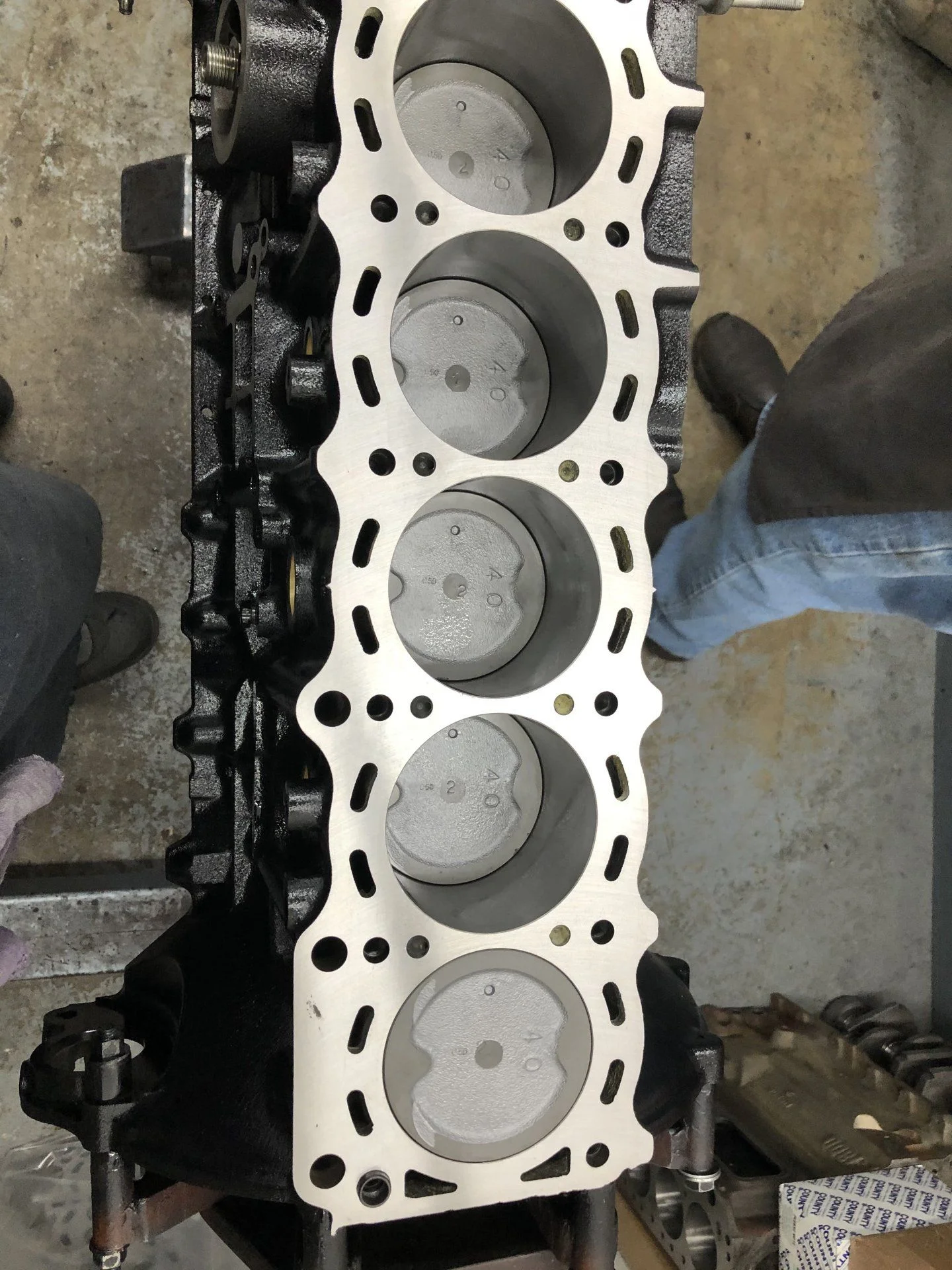

The engine rebuild looks good. Can you give some details on what you did to the motor? Did you balance and blue print? Over-sized pistons? Port and polish? Thx
Great looking rig, nice work.

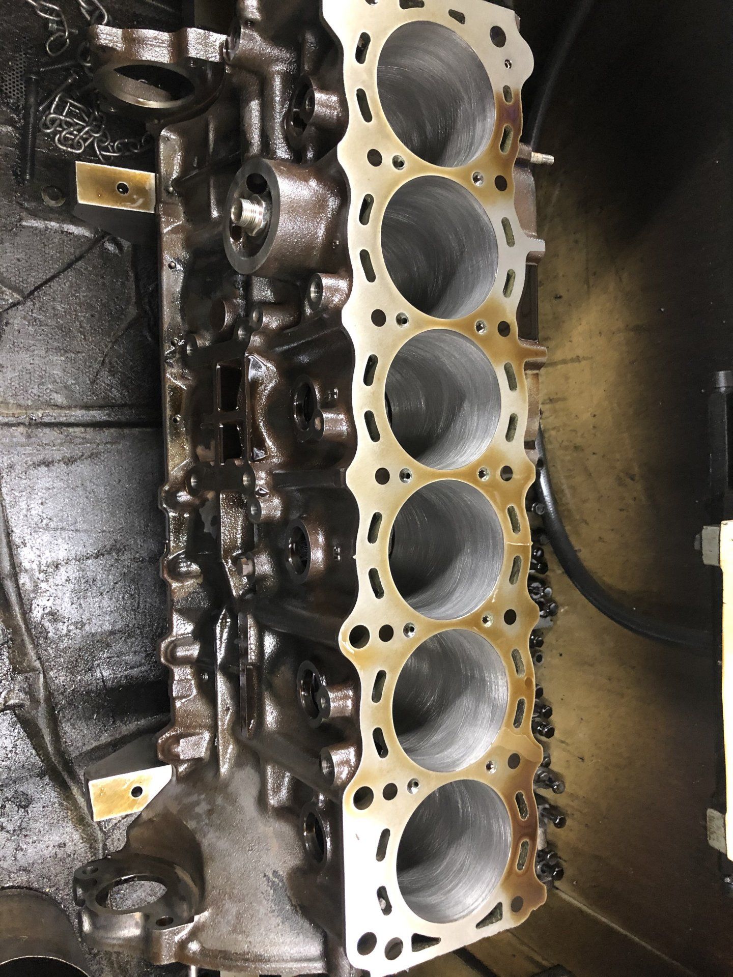

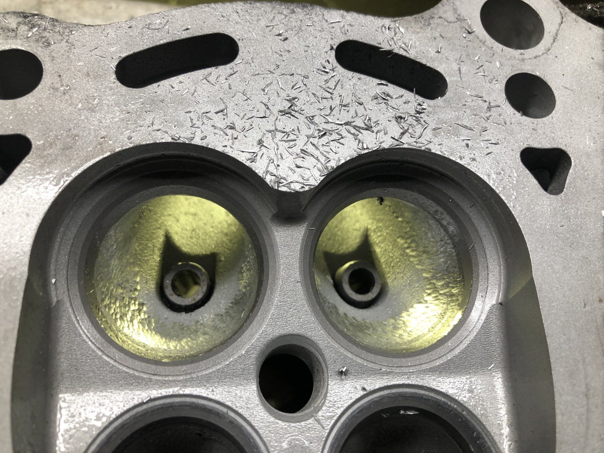

heres the motor info @lasoundguy & @Road Apple *edited to reflect that K&H imports did the work (they sub the motor rebuild out to their local guy)
part list;
complete timing component kit
safety pistons with rings
safety main bearings
toyota rod bearings
safety thrust washers
ACL pin bushings
iron exhaust valve guides
misc parts and plugs..
work;
clean and mag block
deck block - .010
bore and hone .020
clean inspect and polish crankshaft
resize 6rods
R and R pin bushings and hone to fit pin
balance rotating assembly

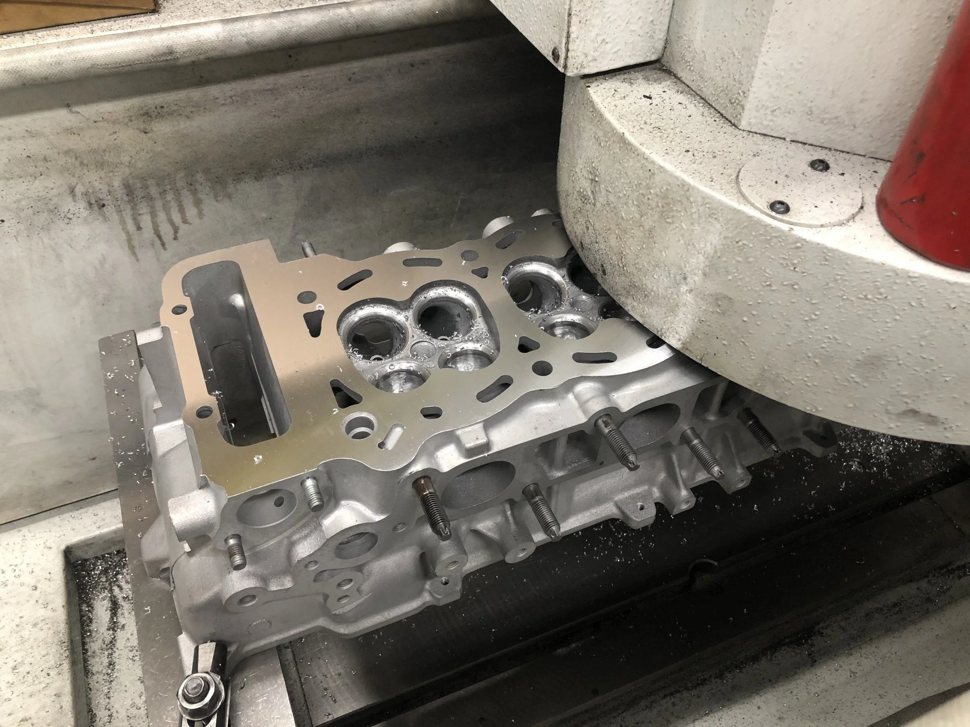

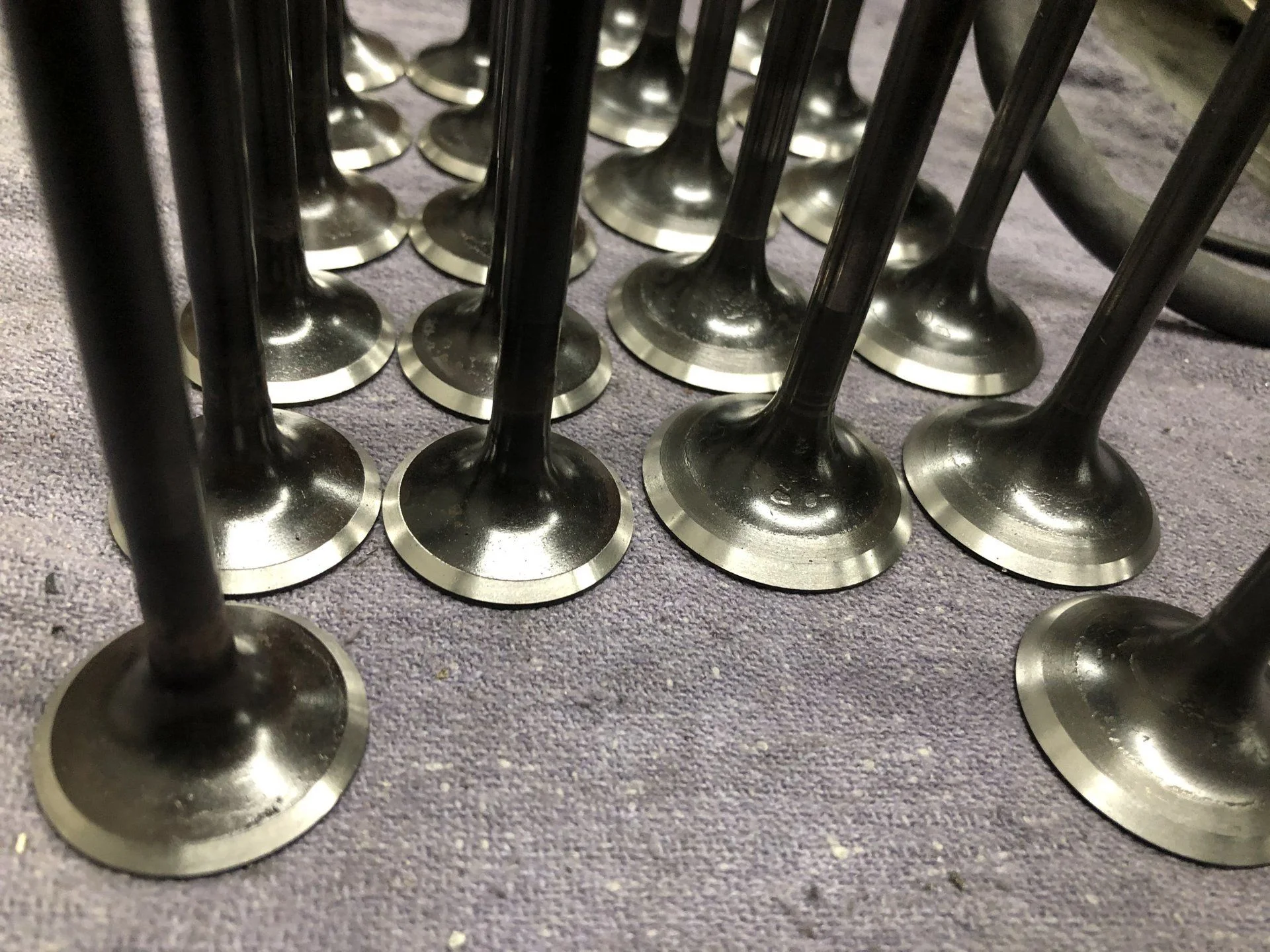

valve job
pressure test head
remove and reinstall valve guides and hone to fit
surface head .008
solid followers R and R cams and trim valves to adjust valves
mild porting on intake and exhaust bowls

phh done along with throttle cable, kickdown cable, every vacuum hose and more misc under the hood components....

It significantly reduced outside noise and also keeps the center console from getting as hot.
Looks good. Good motivation to do this project. Read an old thread yesterday about heat becoming an issue on long trips. Their answer was to problem was to,
“Order heat insulation to cover the transmission tunnel to hold the temps down.”
“Put some adhesive heat shielding on the oem heat shields above the downpipe, and both cats. I also put some in the passenger side footwell & transmission tunnel. works very well...much more comfortable”
They also mentioned that sound deadening along did help their heat soaking through into the cabin much. The heat shielding was a big improvement.
Might be overkill, but I am thinking of adding heat insulation to the sound deadening.
Yes so I used Noico 80mil, the transmission tunnel I went with 3 layers overlapping and driver/ passenger floorboards 2 layers overlapping.
Inside doors, rear floorboard, quarter panels and inside the tailgate 1 layer.
It really helped with temps and of course noise. there's a "thud" when the doors close now...
