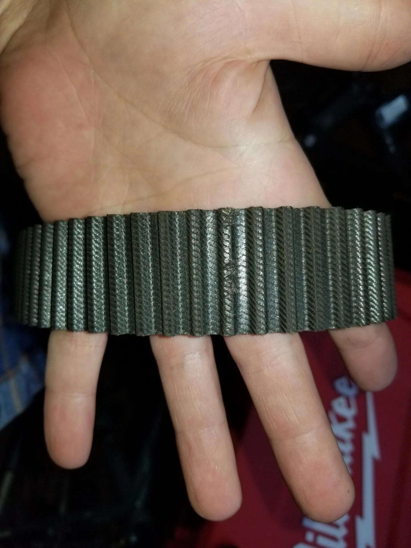

I helped a buddy but a belt on his '02 Tundra at 135K, in 2022 (20 year old belt - which was original). The belt had some rips in the fibers in two separate spots. The rips were on the underside of the belt, and not something you'd catch easily by removing one of the inspection covers and giving it a quick look. You'd need to look at the underside of the belt and spin the engine through it's entire 4-cycle rotation to find these spots.
Interestingly, the truck ran way better after the belt change! Power was improved and it sounded better as well. The belt was a bit on the loose slide when we removed it, so I think it had stretched beyond what the tensioner could easily handle and allowed for some slop in the cam timing. I'd personally replace the belt at no more than 15 years or 100K. It's an easy and cheap enough job to to, especially given Aisin kits are only $250 or so on Rock Auto. Any competent mechanic or DIYer can do this job.
Was this belt at the risk of immediate failure? Probably not. Would I want it running in my rig? Under no circumstances.

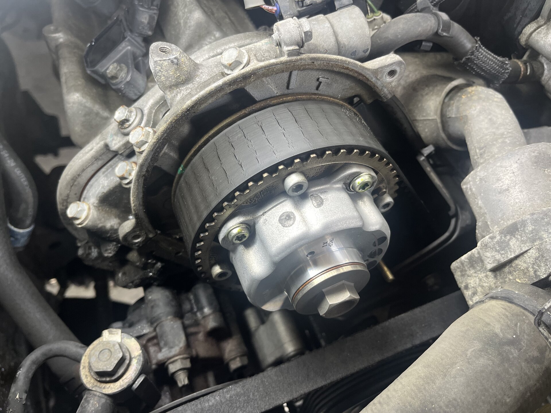

This is the original 237k mile belt in my ‘05 Tundra. It’s getting changed next weekend even though the truck runs perfectly, no leaks, etc. It’s not worth risking.

Yikes. I'll be curious as to what the bottom of that belt looks like being that it's cracked at all of the ribs. Based on the 135K example, perhaps the fibers start to break, leading to eventual progression towards your 237K example. From my 135K example. I would also be surprised if yours does not run quite a bit better given all the cracking has likely stretched the belt beyond what the tensioner can accommodate.
