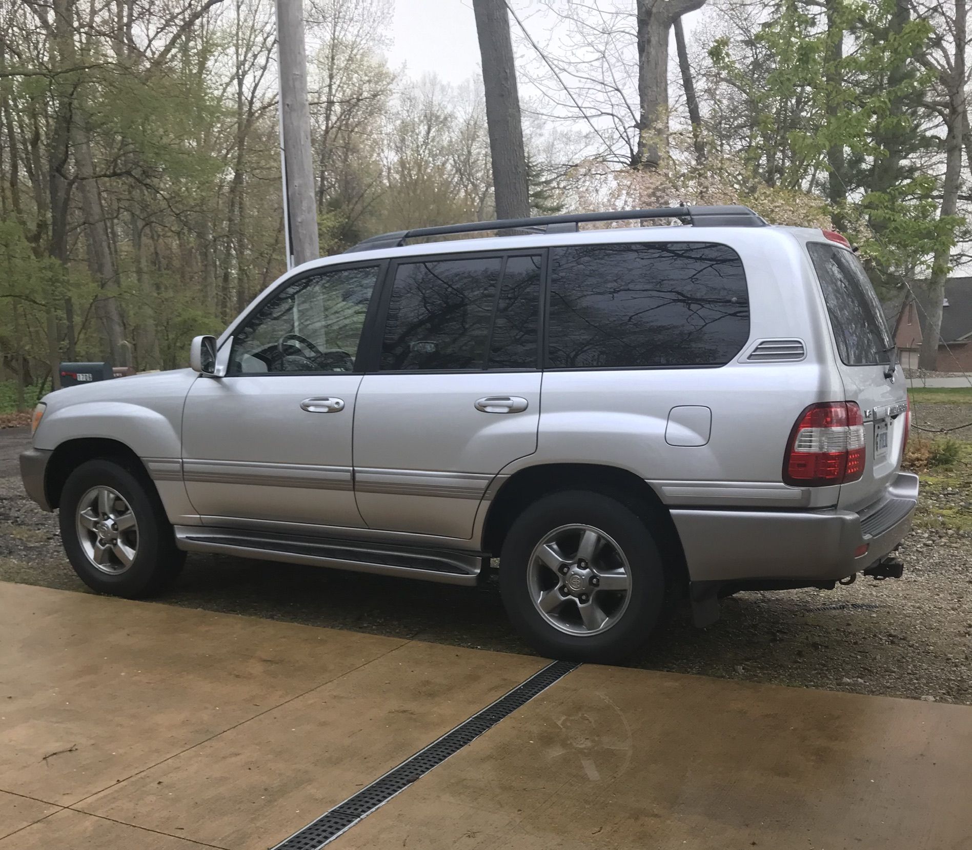

Hey y'all, I’m Zach. Long story short I started my Toyota journey in 2005 with a Tundra, then a Sequoia, and now I’m here. I type this from SeaTac on my way to Detroit to pick up my cruiser aka, The Unicorn. Luckily my aunt and uncle live near the PO so they were able to handle the transaction for me and hold on to it for the last two months. I’ve been waiting for the current situation to clear up enough to road trip/camp my way home to Seattle. My aunt only sent one crappy pic so unfortunately this is all I’ve got right now.

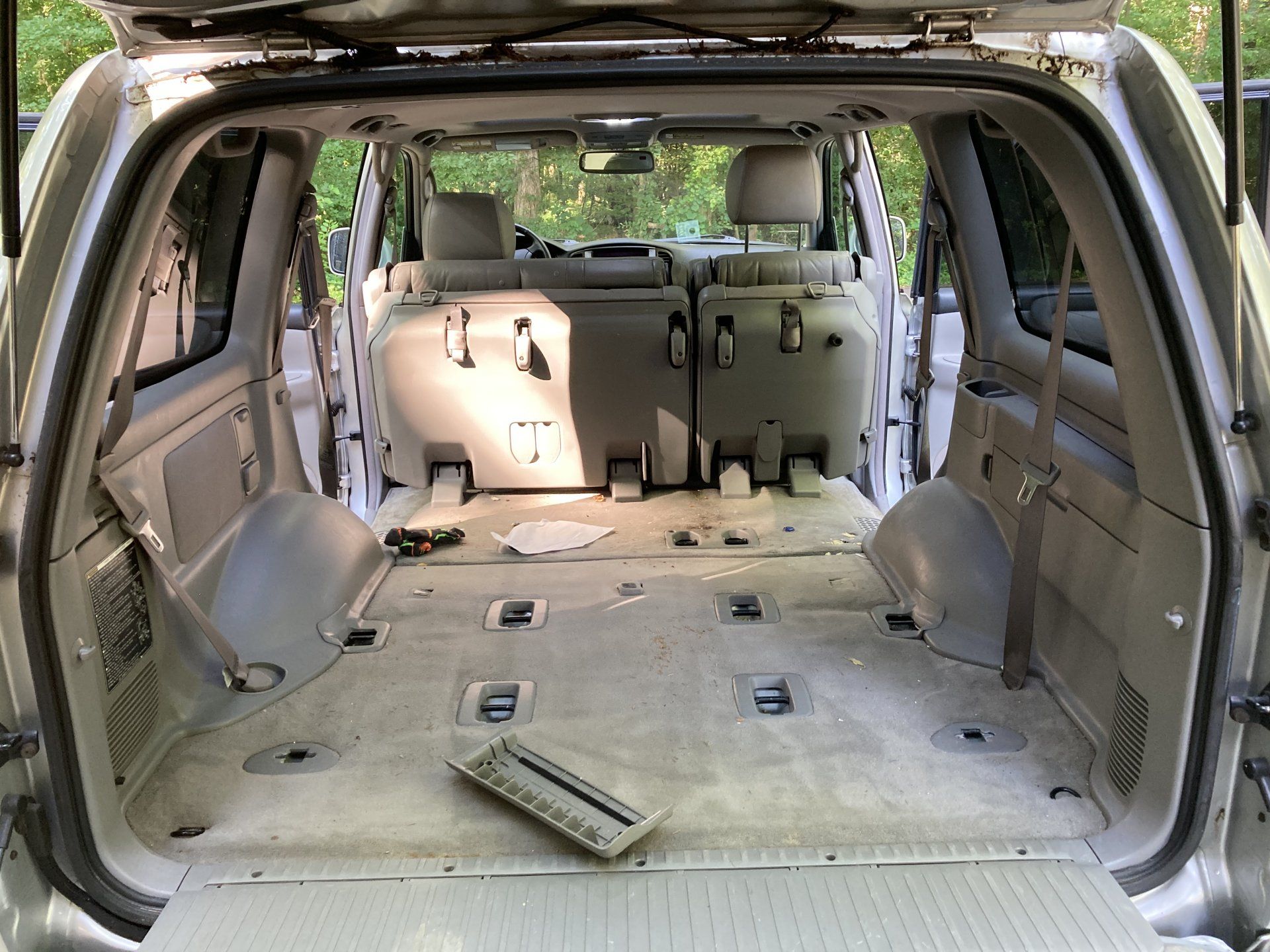

This was of course after I removed the rear seats (which were thrown in the back), rolled the 2nd row forward, tucked the straps away and removed the mat. Those aren’t my dirty socks. Judging by the quantity of filth above the rear hatch this thing hasn’t seen a night inside a garage since Paul owned it.

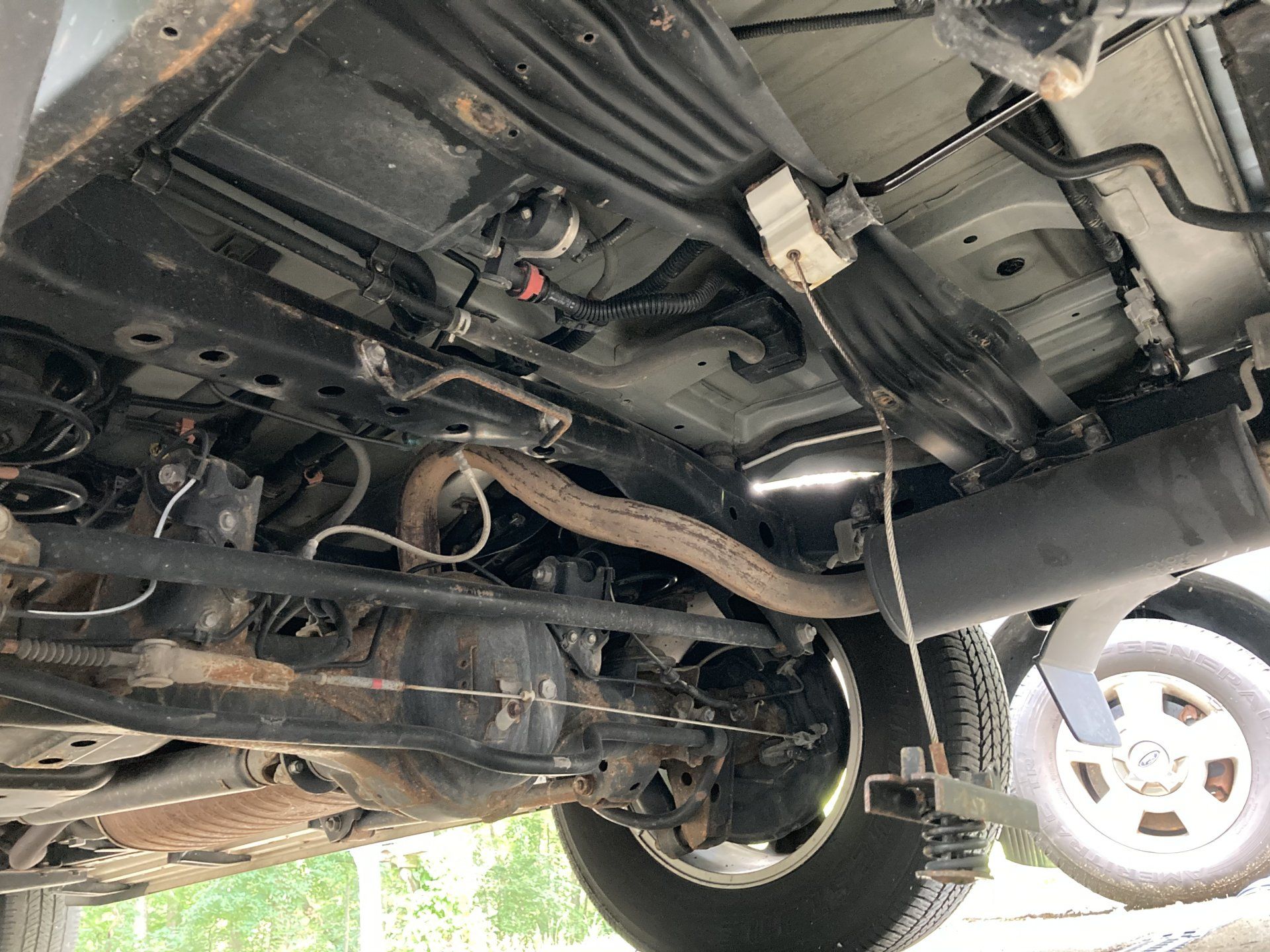

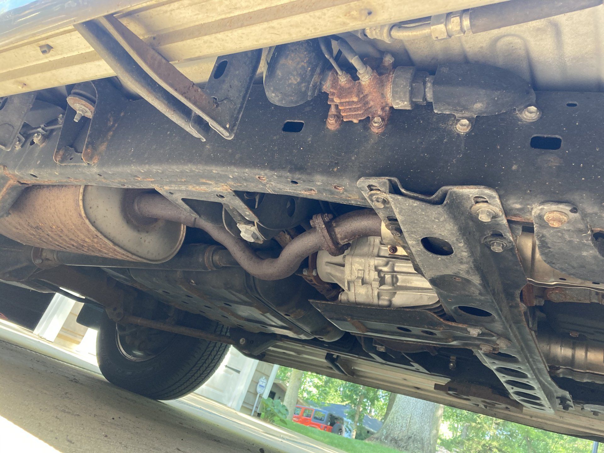

Since I had to drop the spare I had to access the tool roll, which was forced back into its cubby incorrectly so the cover was bowed out. Luckily the undercarriage from here looks great.
The rest of it also looks good. Not Arizona dry but nice.

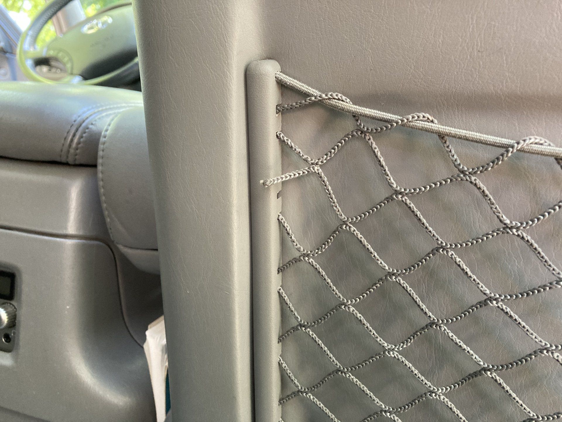

Broken 3rd row belt clip.

Amp cover was thrown in the back. Found one of the retaining screws, maybe I’ll find the other when I pull the carpets.

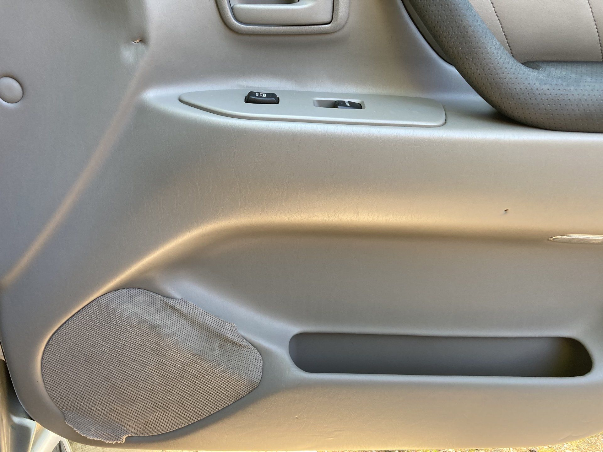

I really wish he would have mentioned the condition of this door panel. It’s totally jacked.

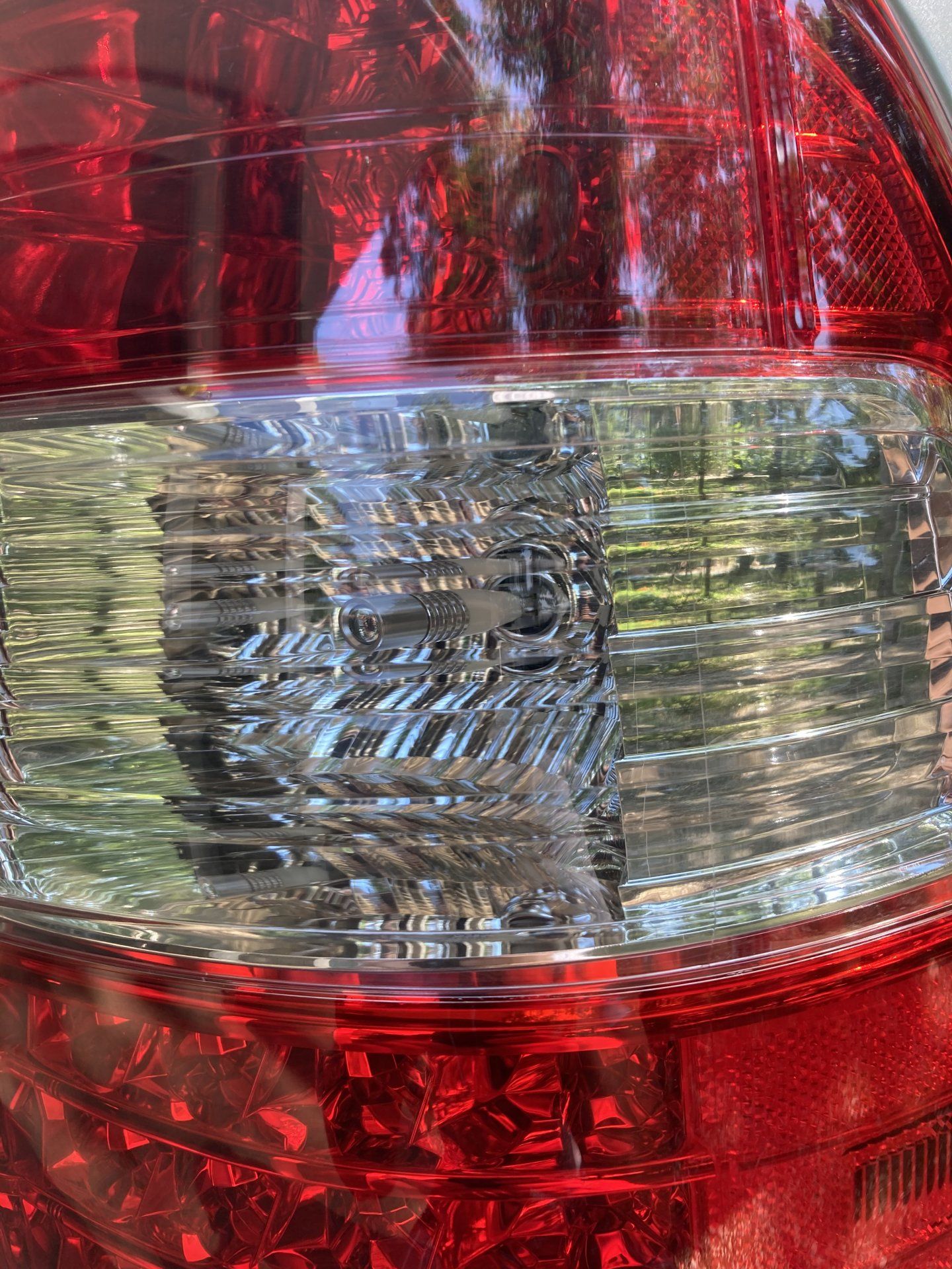

LED reverse bulbs?

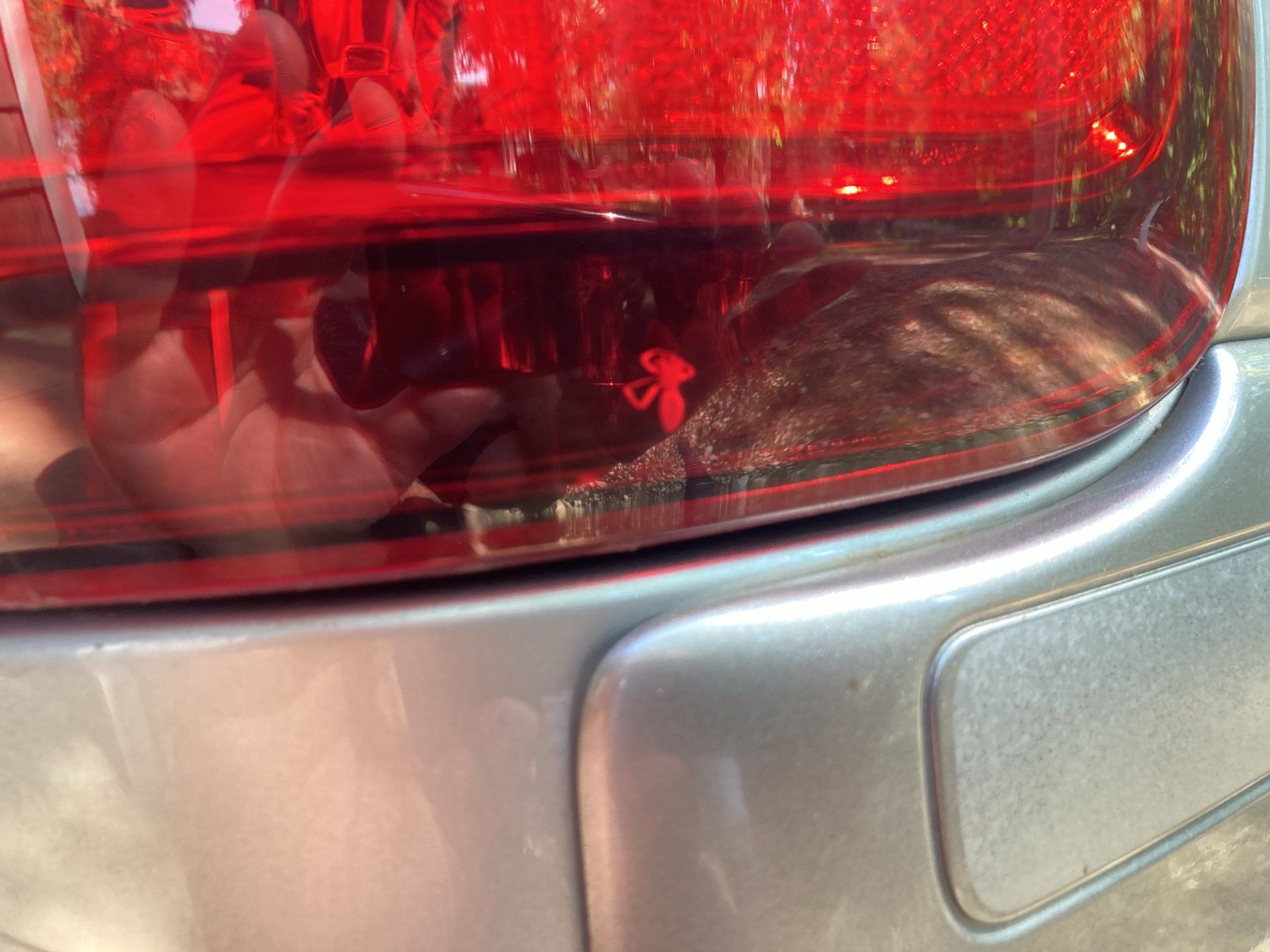

Found a new dead friend inside the right tail light.

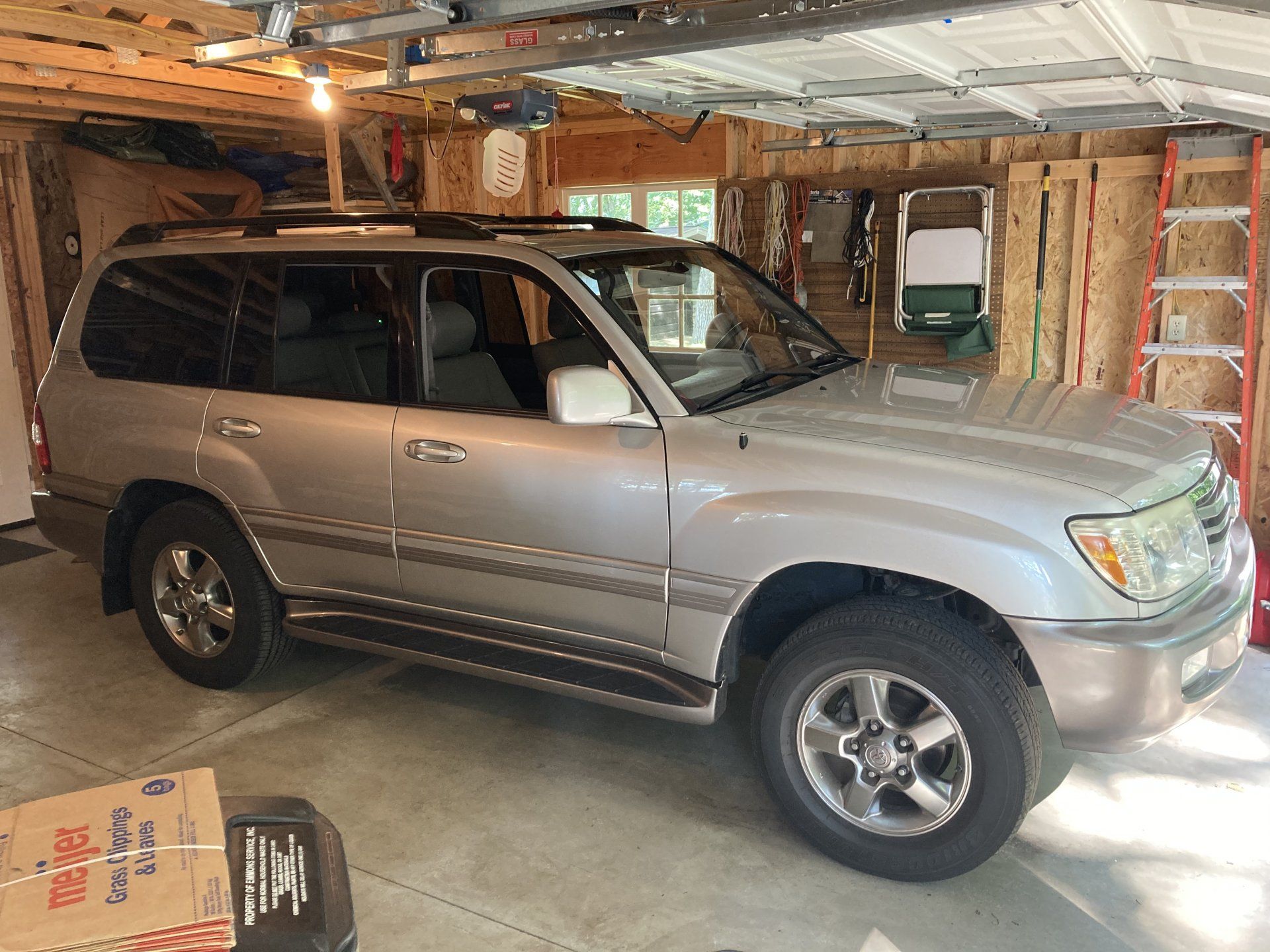

After a day of work it is finally to a place that I would call “sellable”
I’ve currently got it sitting in my uncles garage with the windows down attempting to air it out.

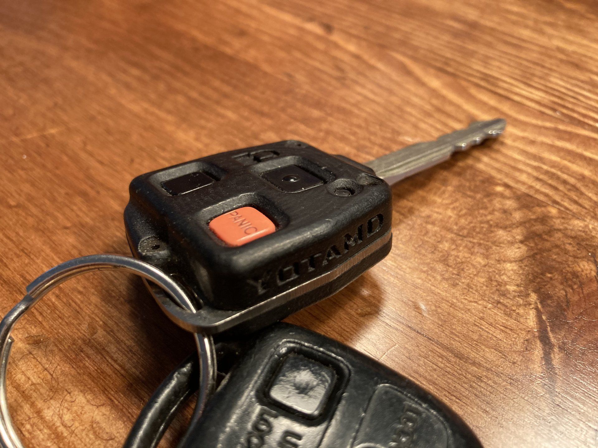

One YotaMD key fob, missing a screw and nut though.
