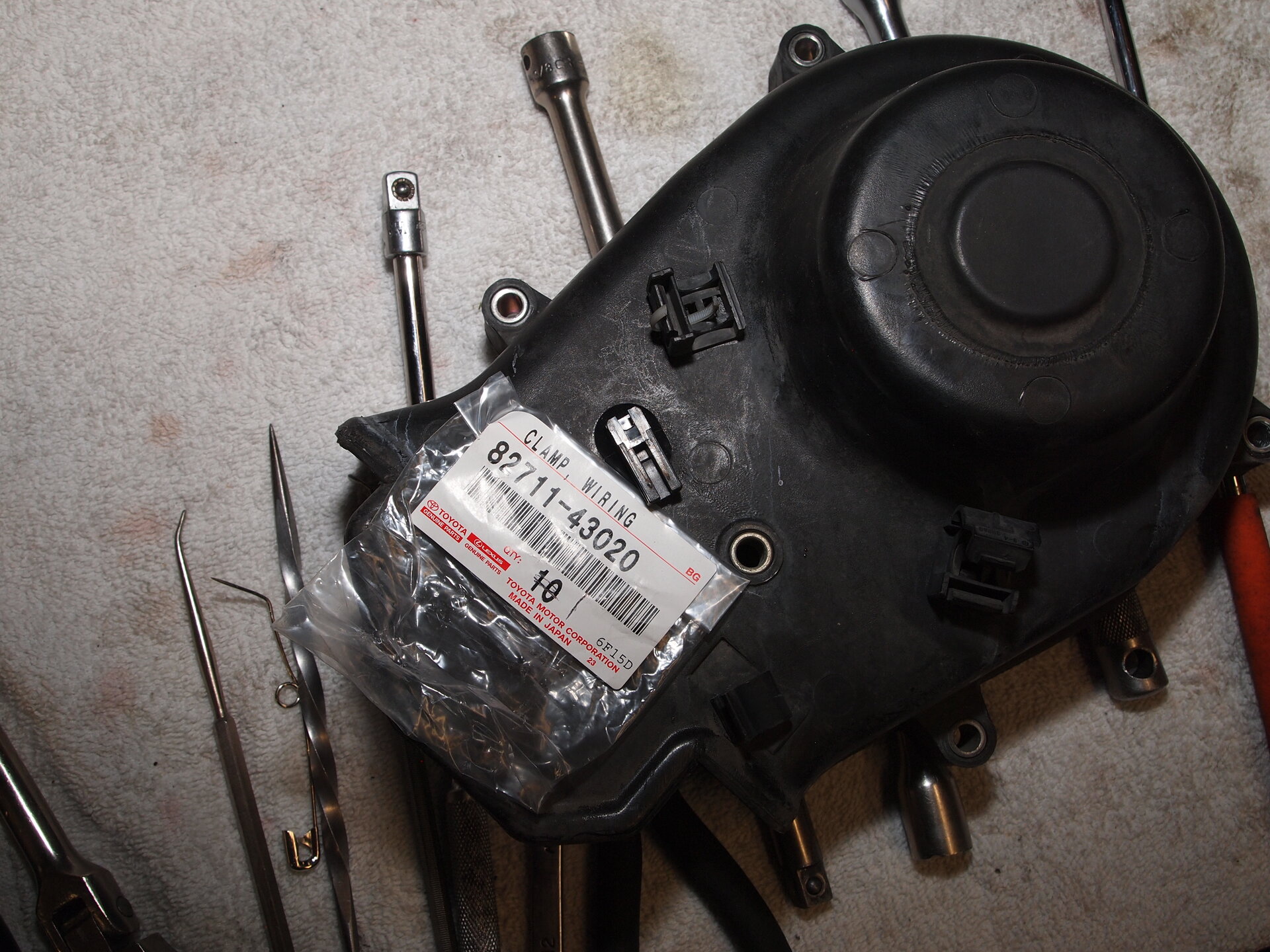

I very often find opening from missing bracket for wire hangers. Number one missing, is hanger for cam sensor wire. Shops in a hurry, just rip them out, busting them. They do not take the time to replace and install. This one and others missing, leave opens into belt area.

The hanger as I called it. Keep in mind. On most wire housing blocks and brackets. Look hard and you'll find 5 numbers (suffix). It's the last five of P/N. Wire Housings all have same first five numbers (prefix) 90980-*****. Brackets, clamps, hangers most ae 82711-

Added to my cart, they are proud of that thing!
