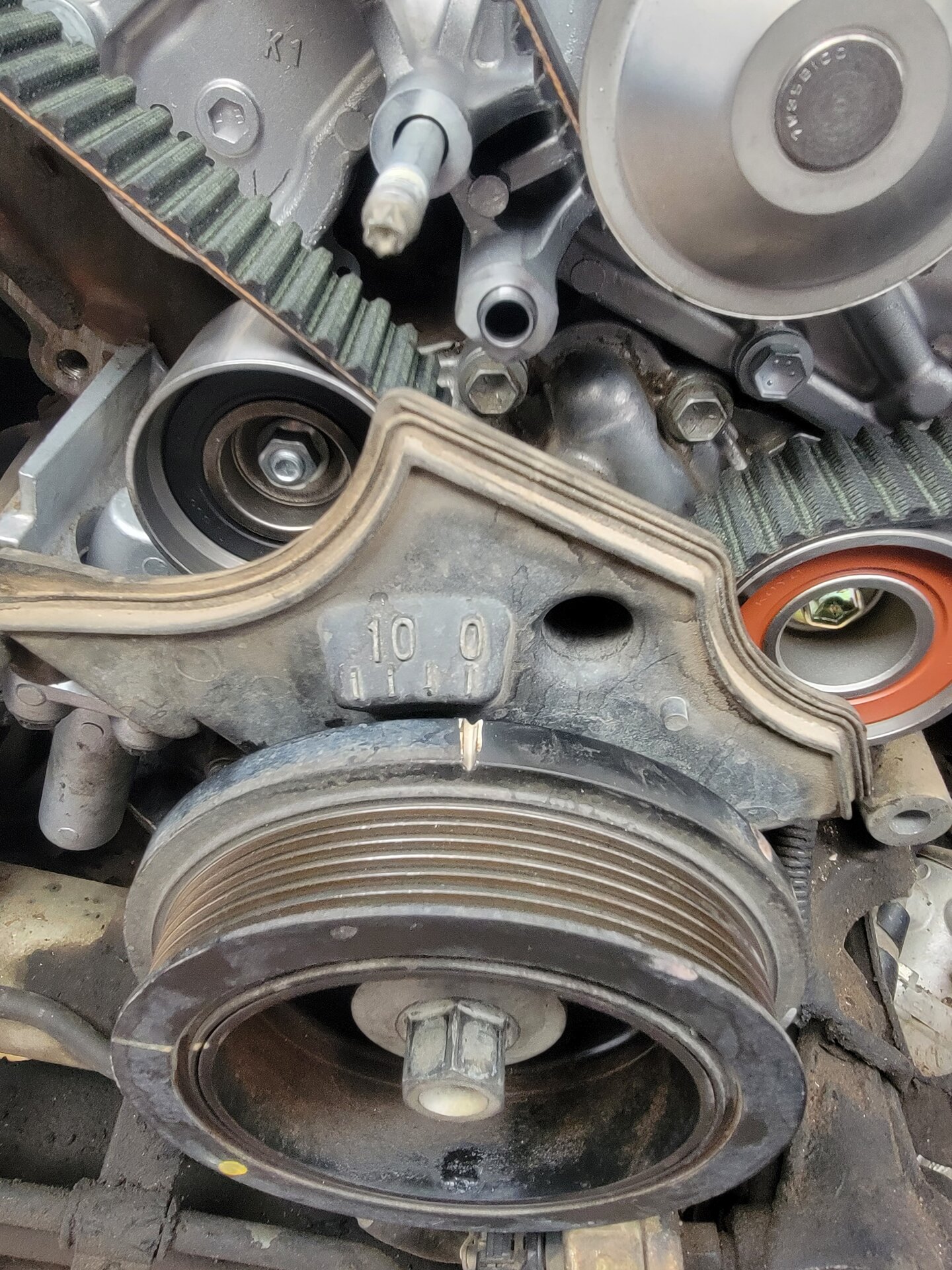

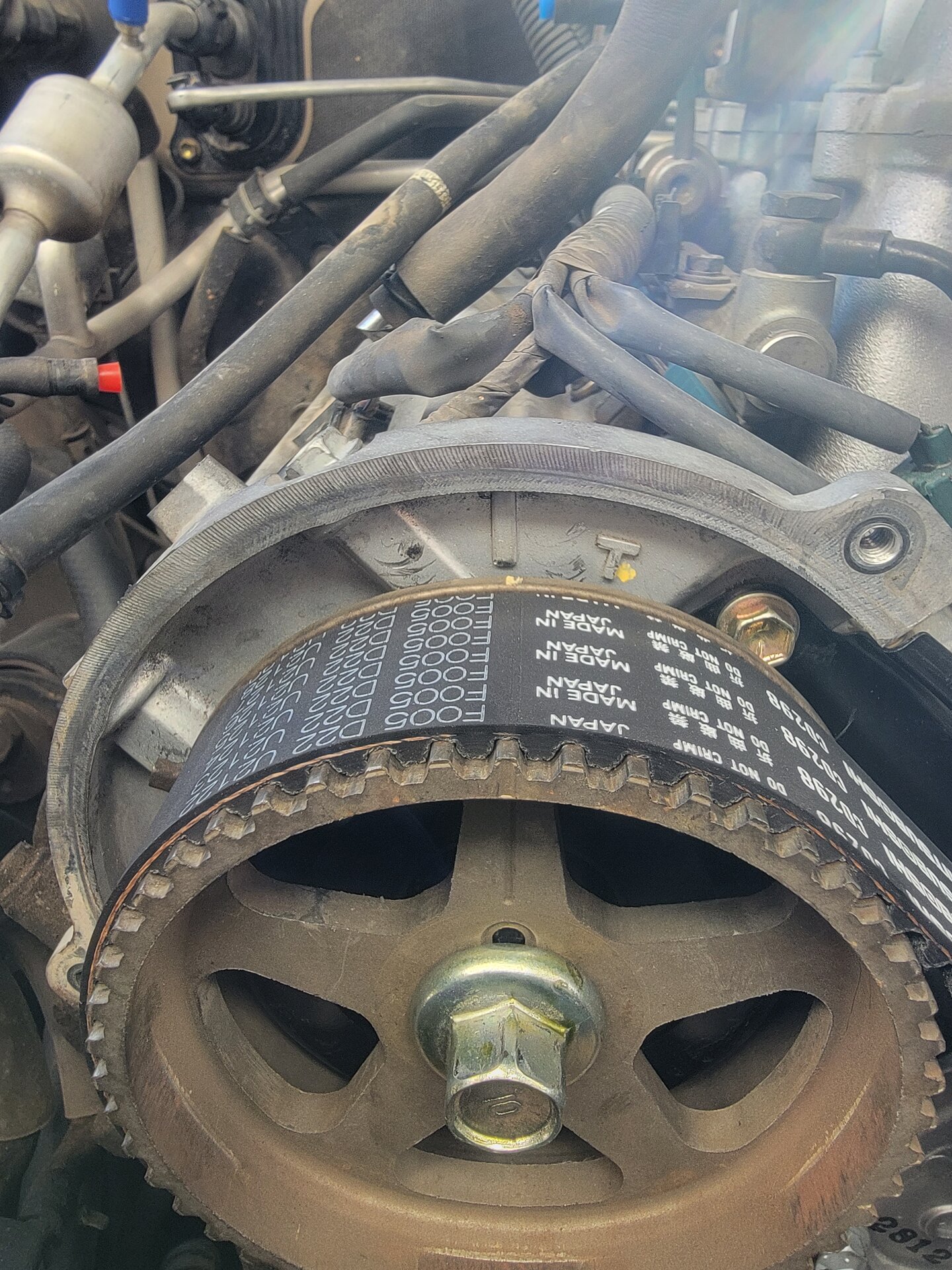

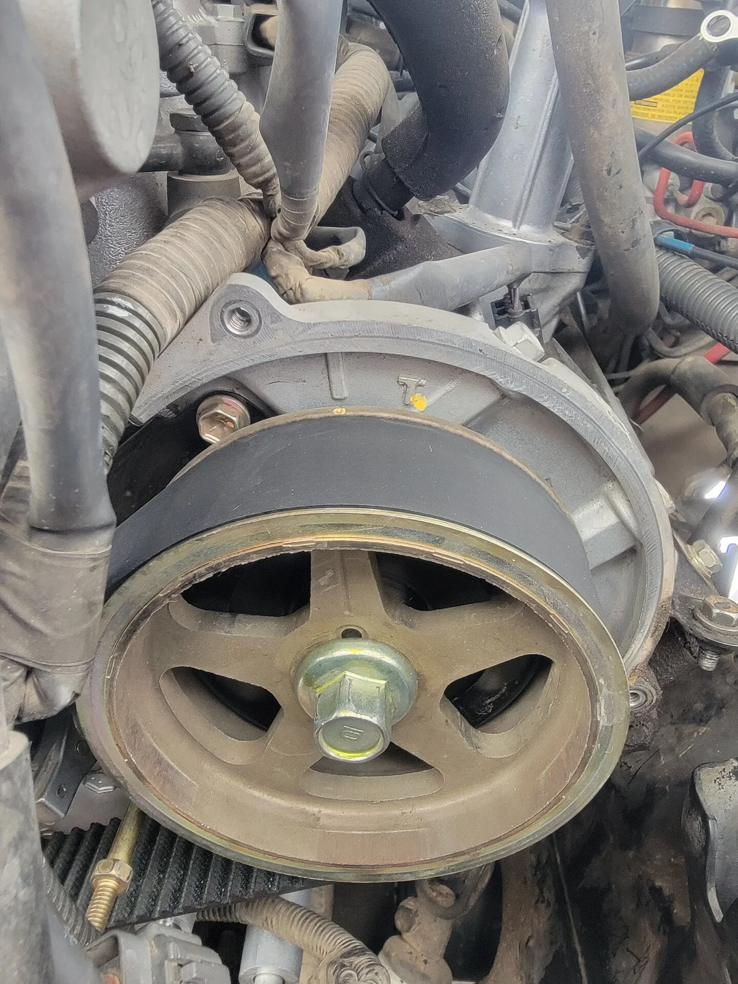

My right cam does not line up perfectly. It is very close but not right on. Will this be ok?OK? Note the pictures.
Spin the engine by HAND (wrench) and check for any resistance BEFORE you start the engine.
Also make sure you route the AC compressor/oil pressure sensor wires BEHIND the AC bracket. I missed it so I had to use cable ties.
I say two thumbs up, it's good.
