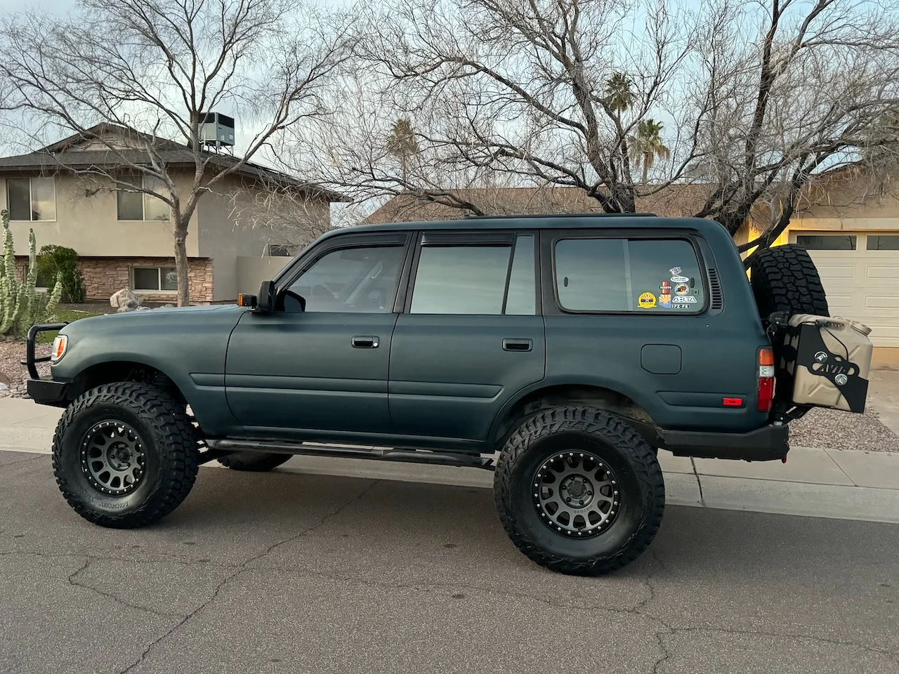

One quick question for the peanut gallery. Being new to the 80 series I didn't even notice until two days ago that my truck has no rear sway bar. It drives fine. I don't notice any excessive body roll around town or on the highway. Is this something I should solve for or just run it as is? Doing some searching, it doesn't seem like something people delete, and instead it seems a lot of folks upgrade it. Thats the main reason I ask.
This is a photo from a few days after I bought it. Now its on 37s with 1.5" spidertrax spacers and timbren bumpstops, if that matters.
This a photo from a few day after I bought it. Now its on 37s with 1.5" spidertrax spacers and timbren bumpstops, if that matters.

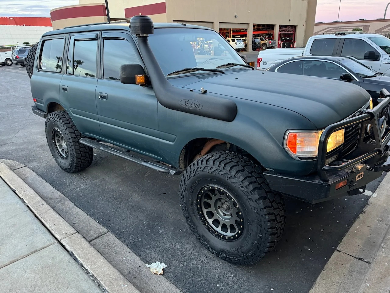

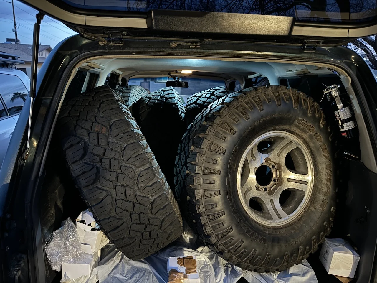

There were 4 dudes at the tire shop working on my truck today. They were more excited about the new wheels and rubber than I was.
No rubbing on the street at full lock forward or reverse.
Gotta admit I'm a fan. Thanks to a lot of folks for helping decide where to land on this journey. Specifically, @Cruiserhiggs @Somebodyelse5 @baldilocks @GW Nugget @JunkCrzr89 @landtank @rmgarage @mudgudgeon for their input, active or passive, into the setup for the 37s. Love the way the truck came out. Also let me tell you... replacing all the steering linkages and installing a rebuilt upgraded steering box all at once is like getting a brand new showroom vehicle steering feel. Its tight AF.

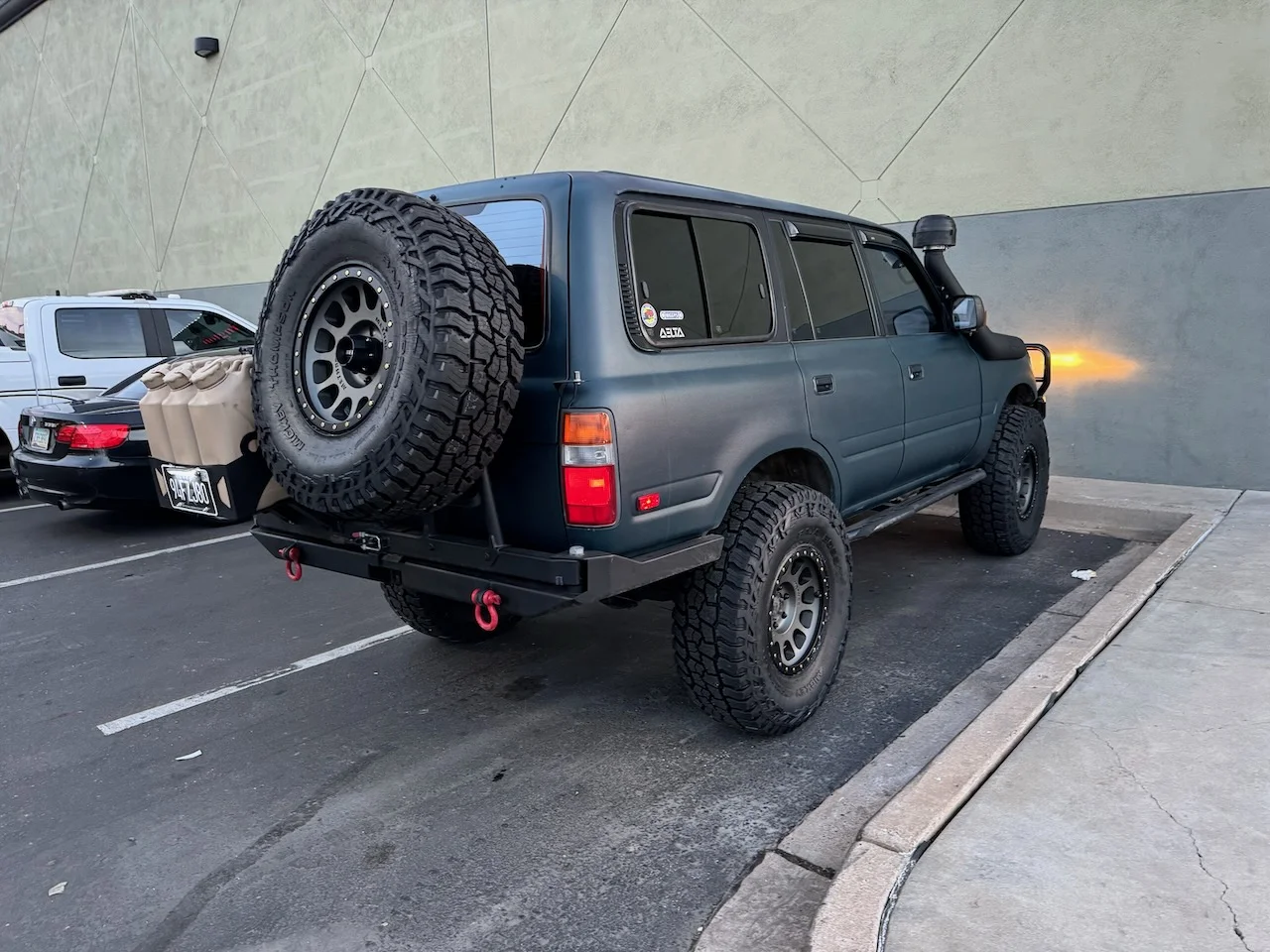

Before:
After:

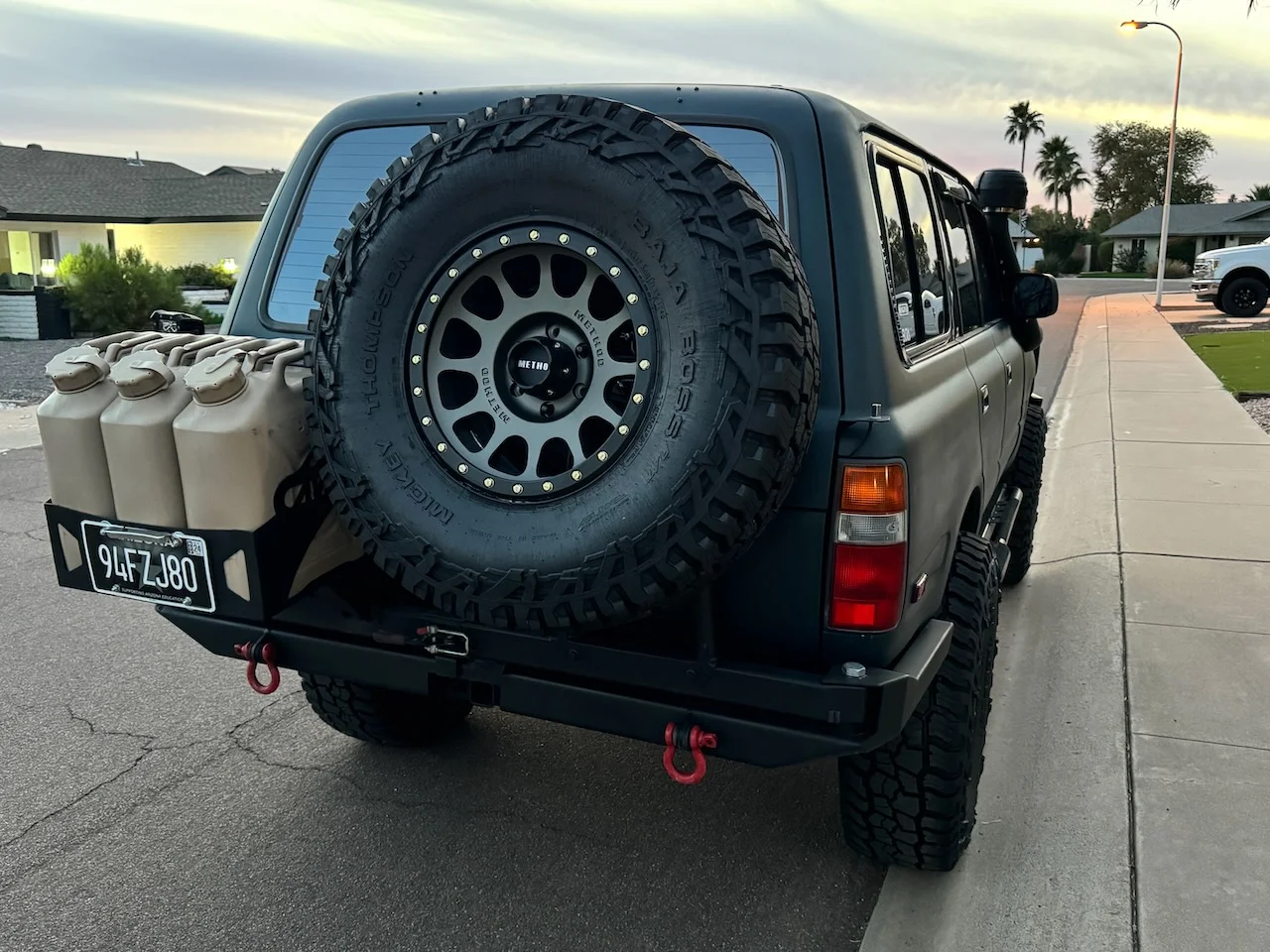

They even crammed all 5 of the 35s in the back:

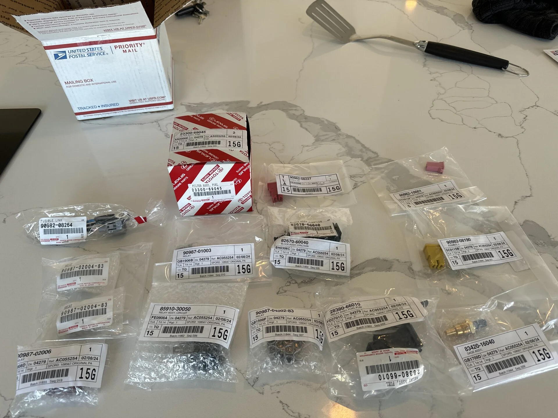

Anything I’m missing in terms of spares?
I’m into spatula’s as well. Looks like you are covered. I replaced all these type parts that could strand an 80 then carried the old ones as spares but these parts aren’t really what we could consider undependable.
The Whiteline sway bar will keep sway away but it’s still down low. I bent one stock bar and ended up hacking the next one off while on the trail because the driver side link broke and the bar end got caught on an immovable rock and twisted rearward jamming into the earth so hard that cutting it was the only solution. Yeah, you can buy HD links but the bar still takes a beating plus those flimsy U-clamps that hold it to the bottom of the axle get deformed and there goes the bushings. Or are you building this 80 for frequent trips to Macy’s? Then none of what I posted here matters.
I’m into spatula’s as well. Looks like you are covered. I replaced all these type parts that could strand an 80 then carried the old ones as spares but these parts aren’t really what we could consider in dependable.
I guess I distinguish between things I broke and things that failed. I’ll carry spares of either, but mostly focus on things that fail. When it comes to things I broke, mostly just known weak points. On my 200 I carried a CV on wheeling trips because I have a front locker. Generally my approach to my rigs is “used, but not abused”. I try to take good care of them and don’t tend to try and break them.

How did you decide on these items? I guess I have seen several threads talking about what spares people carry, but I am curious how you came up with your list.
Jared
Was going through various fuel and ignition system threads and making note of various parts, then looking around at the fuse boxes and making note of the various fuses and relays that were readily accessible/visible.
I also have all the various sizes of tube and hose clamps. I’m weird like that.
I’m also very aware that it’s all overkill. My simple minded thinking though is:
  • I have a new engine.
  • I have a new transfer case
  • New starter, coil, igniter
  • New fuel pump
  • New O2 sensors
  • New radiator
  • New VAF
  • New-ish alternator
  • Newish water pump
  • New battery
  • All new hoses and vacuum lines
So it’d be a real kick to the balls if some fuse or relay that takes a week to track down is what stranded me 10 miles outside of Mexican Hat on my way to/from Moab.
Like I said. I’m weird like that.
The A442f takes a dump? We’ll have a wake. Just can’t handle getting beat by the little things.

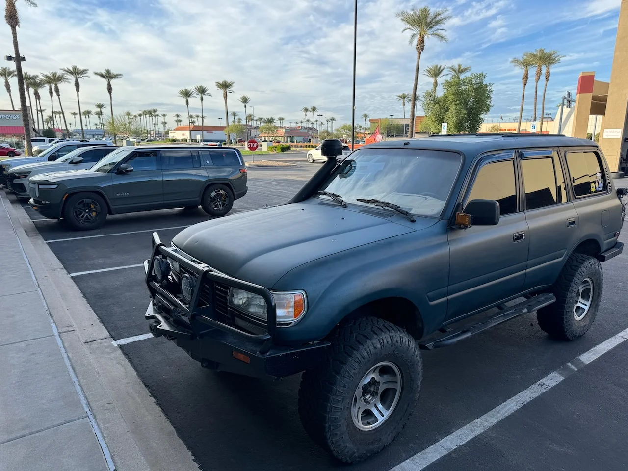

I’m Looking very hard at Higgy’s front bumper for my currently ongoing build. Never heard of Higgy’s until I saw their ad in a copy of Toyota Trails. It’s expensive but I like it. I’m surprised you aren’t running one of theirs rather than the ARB.
I’m Loki t very hard at Higgy’s front bumper for my currently ongoing build. Never heard of Higgy’s until I saw their ad in a copy of Toyota Trails. It’s expensive but I like it. I’m surprised you aren’t running one of theirs rather than the ARB.
I was just at the shop this afternoon dropping off my 200, and the front bumpers were looking good.
