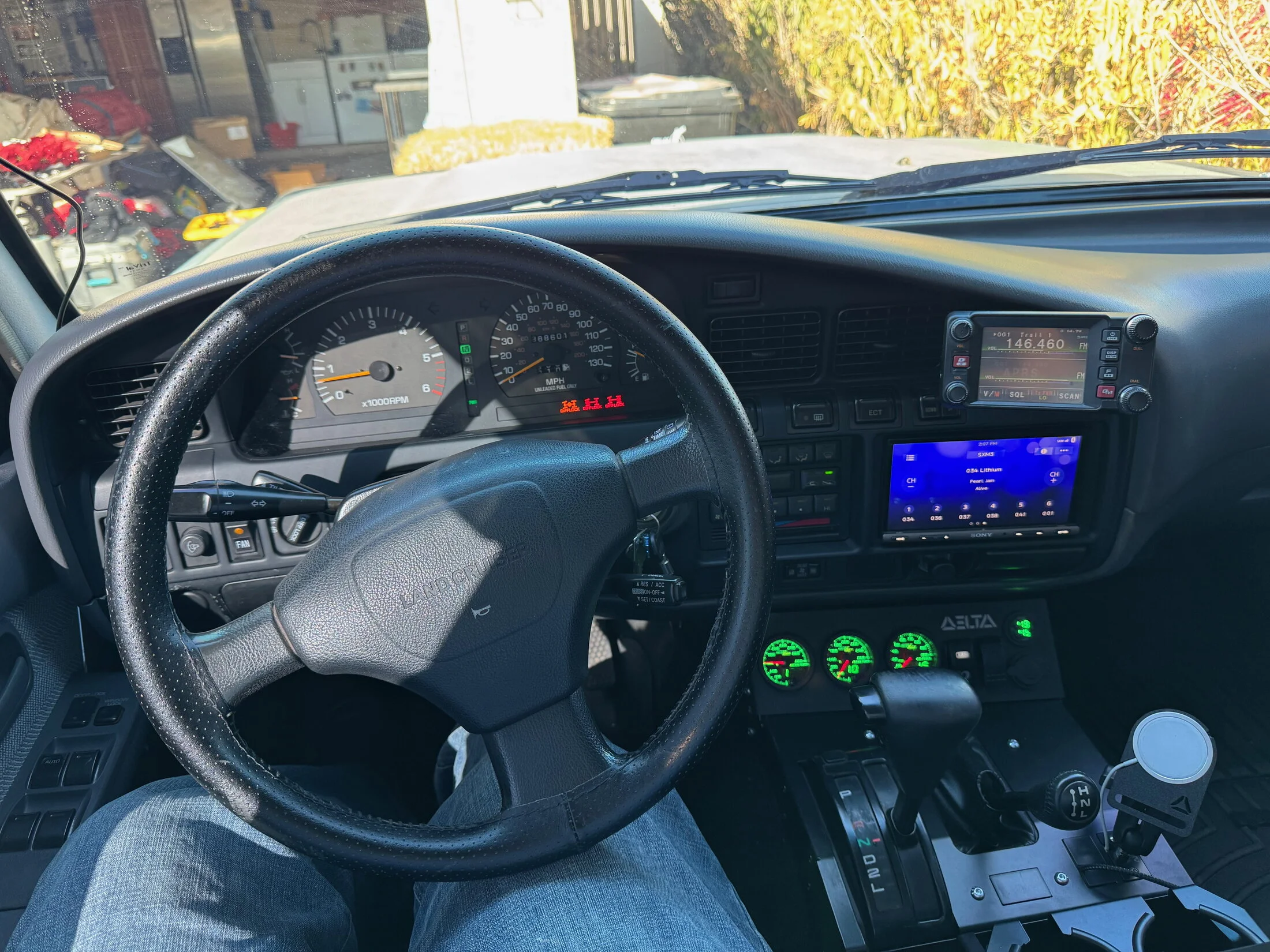

  • Dash removed, cleaned and replaced all components that could be sourced new from Toyota including all dash trim, instrument gauge cluster housing, buttons, switches and vents.
  • OEM locker dial switch wired into OEM harness and bulbs added to instrument cluster.
  • ARB twin refreshed and wired to both a rocker switch and can be triggered by the locker dial.

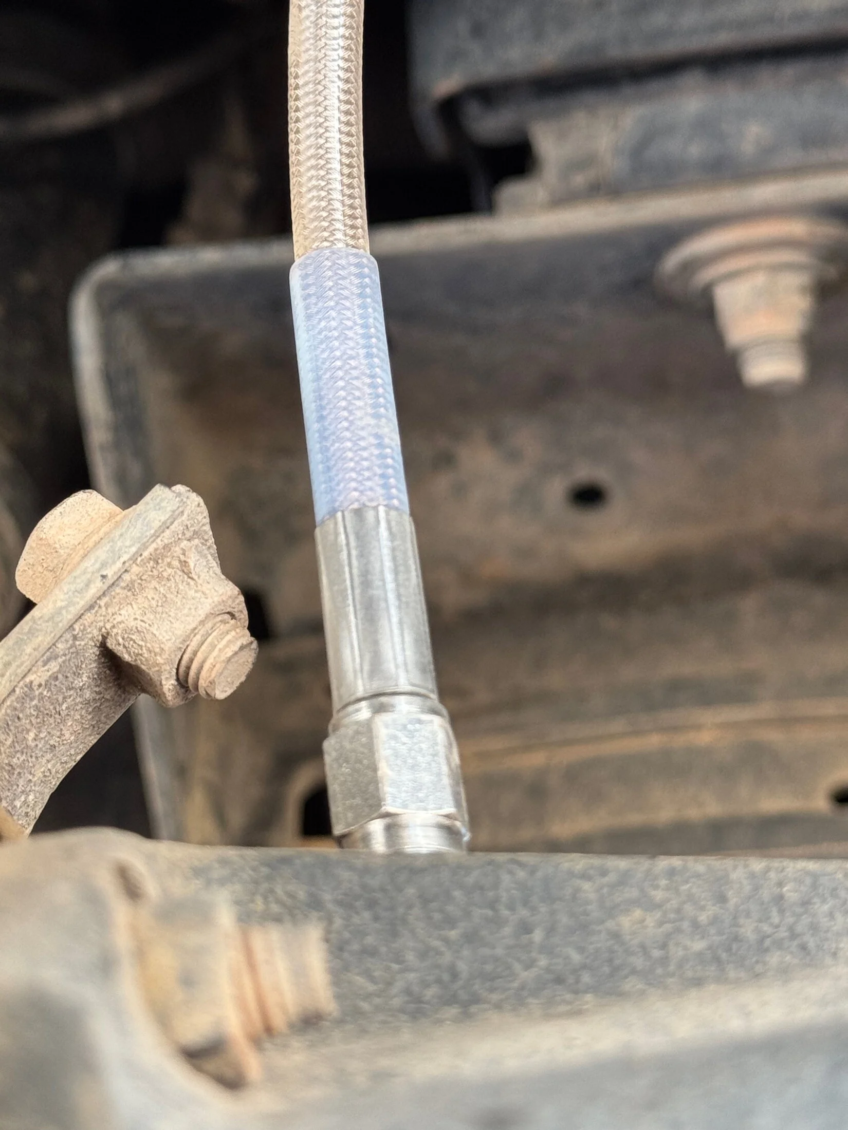

  • All new braided stainless air lines for locker and all new air lines for quick-connect on front bumper.

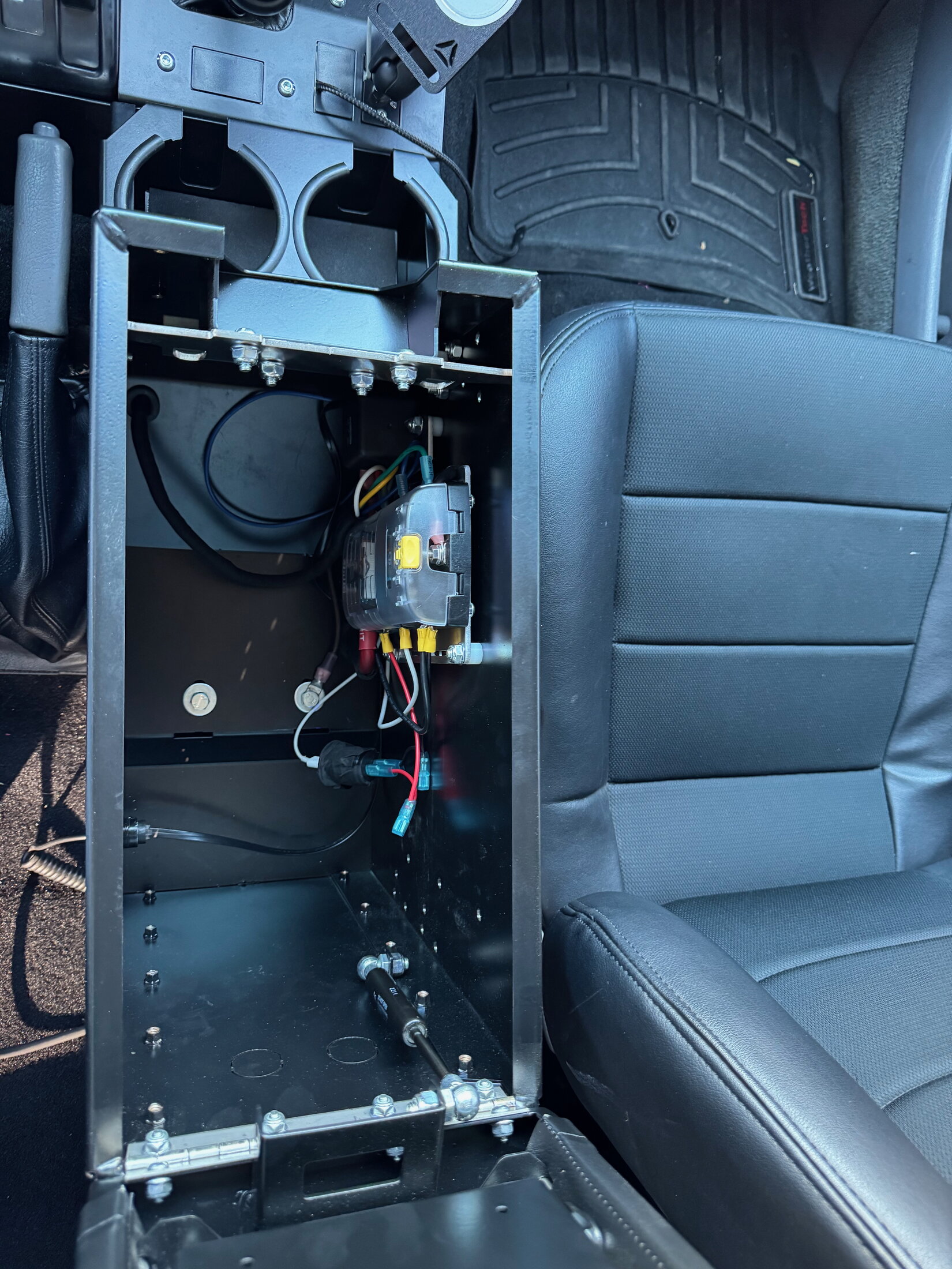

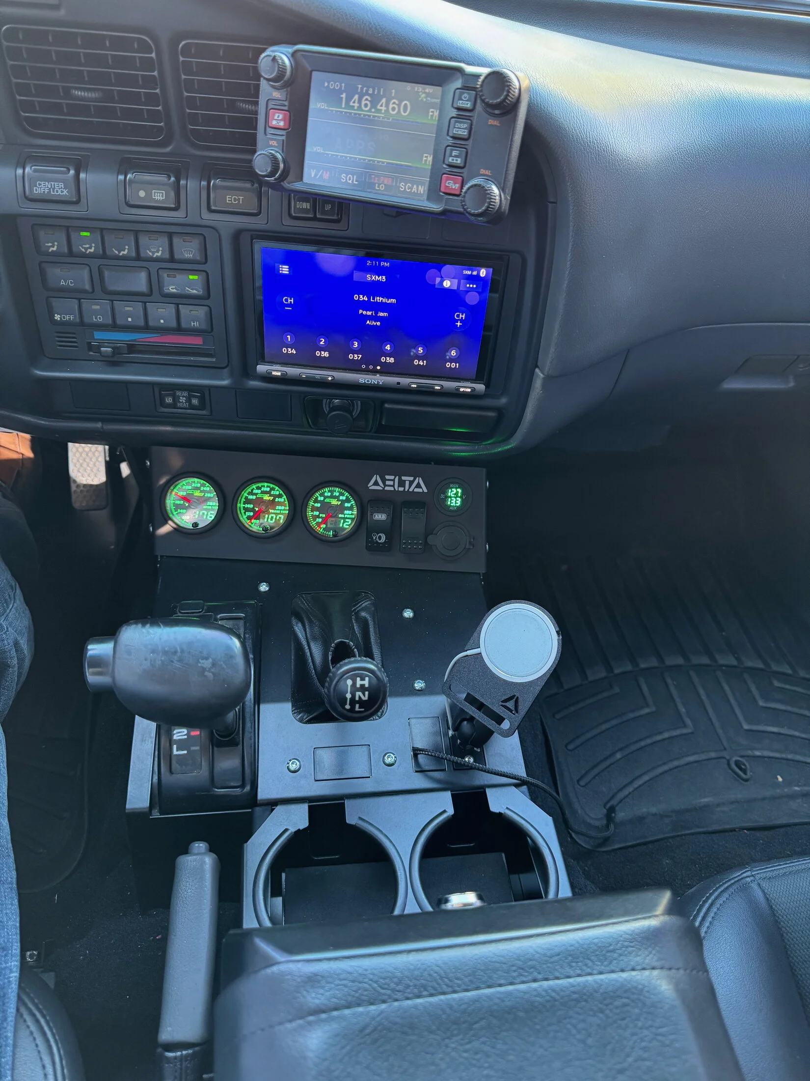

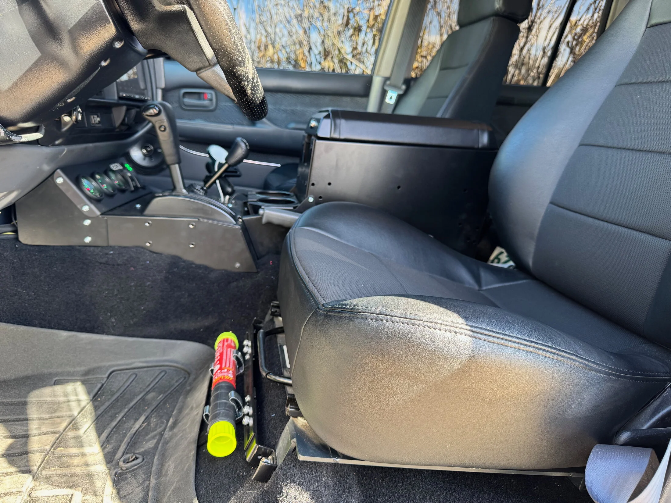

  • Replaced Tuffy center console and OEM shift console with Delta Shift Console and Delta Center Console. (I love this setup)
  • Replaced both shift boots for the transfer case shifter and replaced parking brake boot

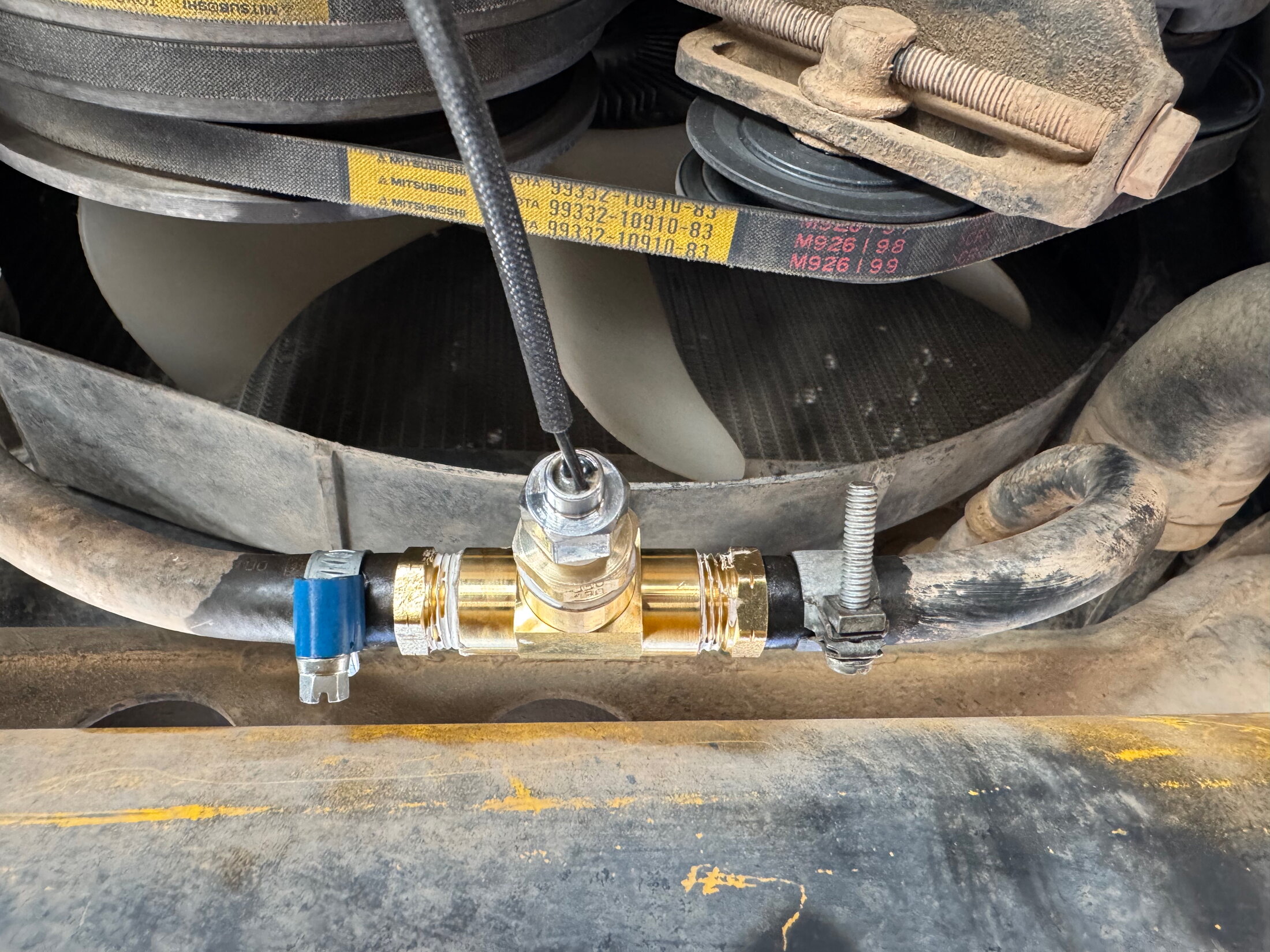

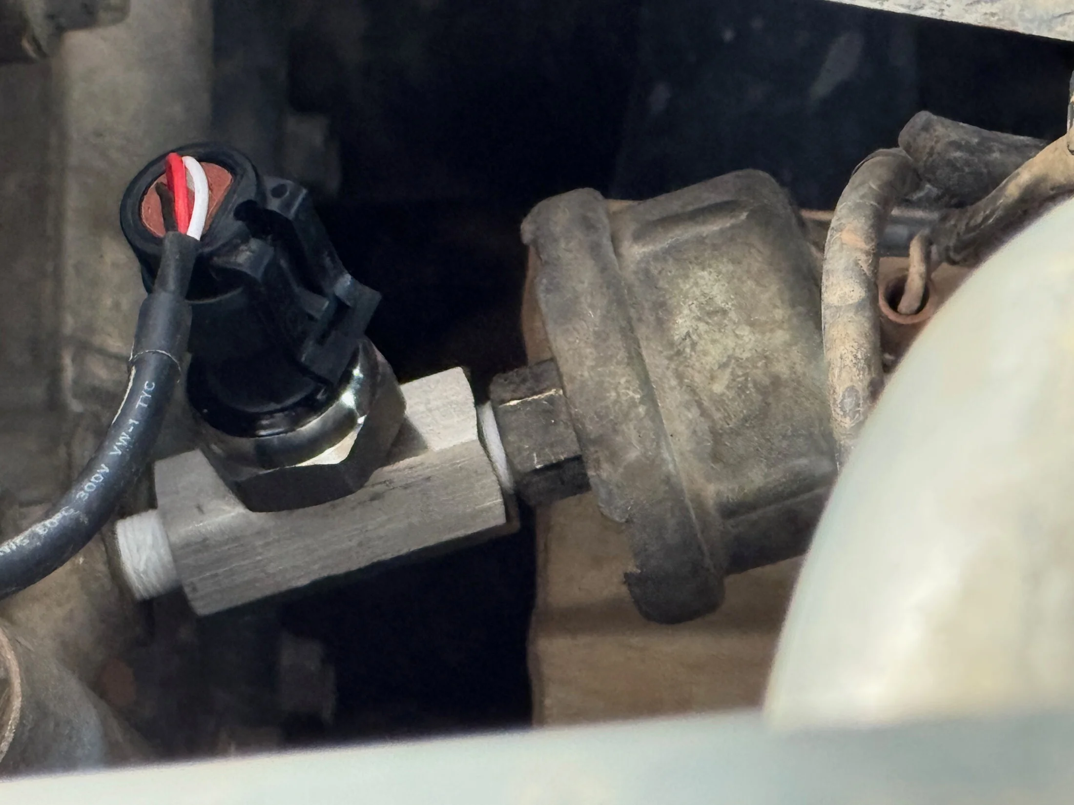

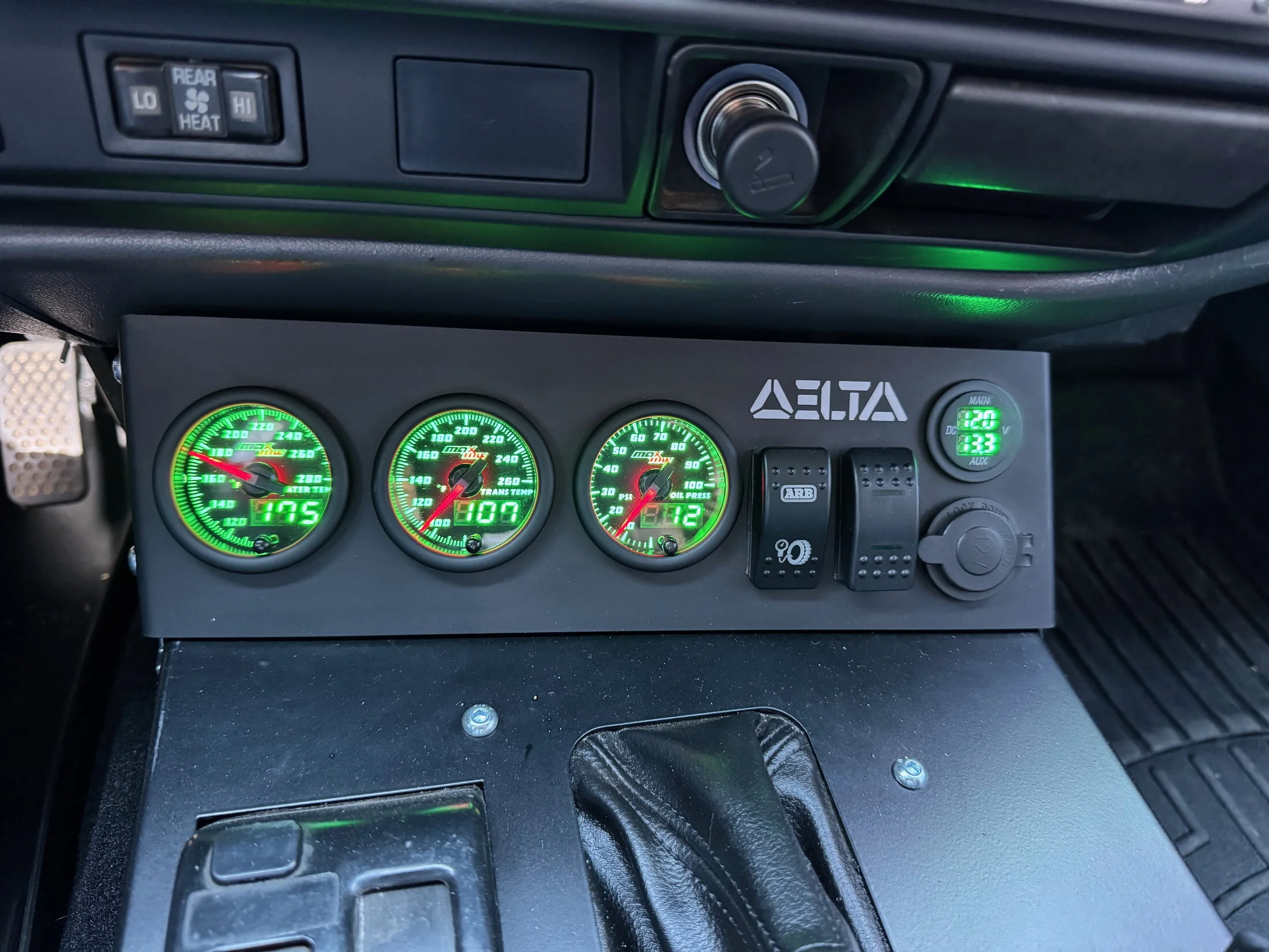

  • Added Water Temp, Trans Temp and Oil Pressure gauges to the shift console.
  • Wired dual zone fuse block with ignition relay into center console.
  • Rewired and mounted Yaesu FTM400 onto the QPM, added Delta clock location ram mount for the Yaesu head unit and installed a port in the side of the center console to plug in the mic.
Engine temps top out around 195f but mostly stay in the 183f - 189f range. During dead of summer I saw it get up to 209f at a stop light coming off the highway.
Trans Temps I've only been able to monitor for a few days, but seems like they never get over like 150f around town and mostly stay in the 120f to 140f range, which was surprisingly low to me.

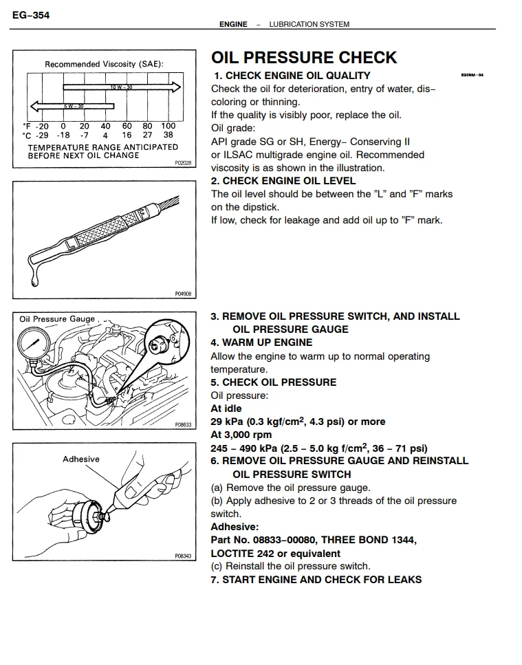

Oil pressure surprised me a bit particularly at hot idle. On cold start its up towards 50 psi, but once up to temp will idle at 9-12 psi, run in the 30-45psi around town and max out around 61psi under the heaviest of load. This is with Mobil1 Full Synthetic 5w-30.

Oil pressure should be 4.3psi or more at idle, and somewhere between 36-71psi at 3000 RPMs according to the FSM. So your numbers are fine according to Toyota. (BTW the 200-series is 10.1psi or more at idle and 32psi or more at 2500 rpms). It's always possible depending on where you installed the gauge that the pressure is slightly different than what the rings and bearings are seeing, too.

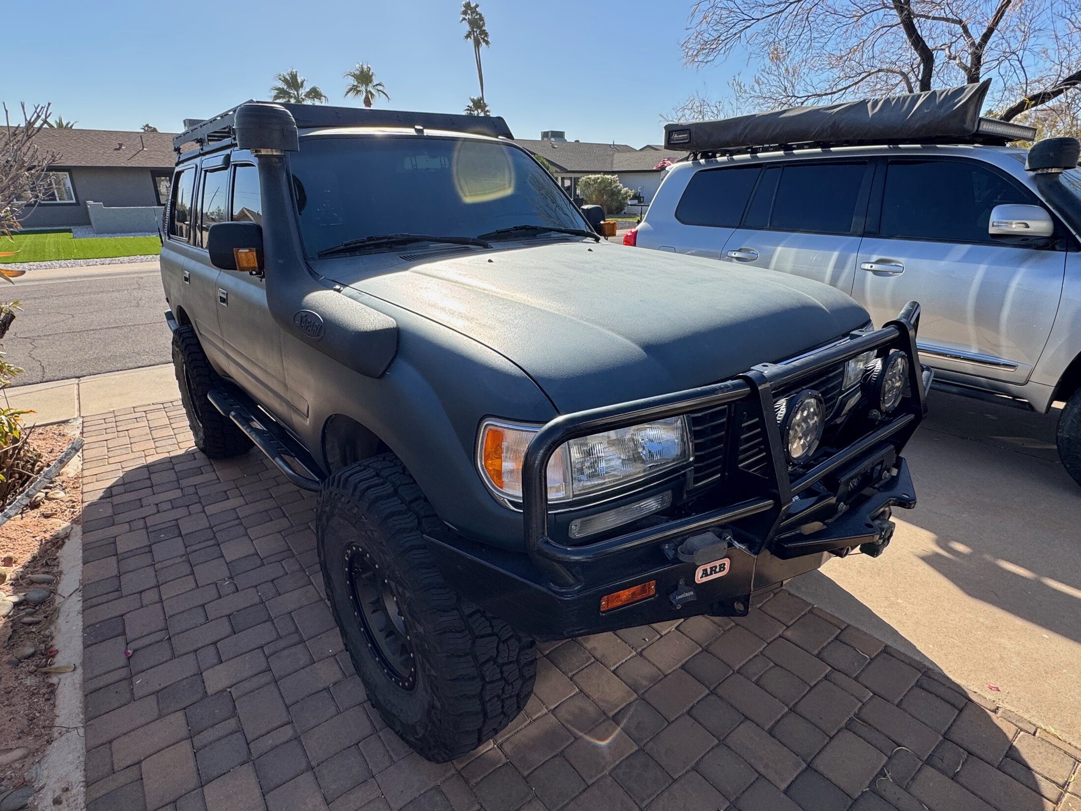

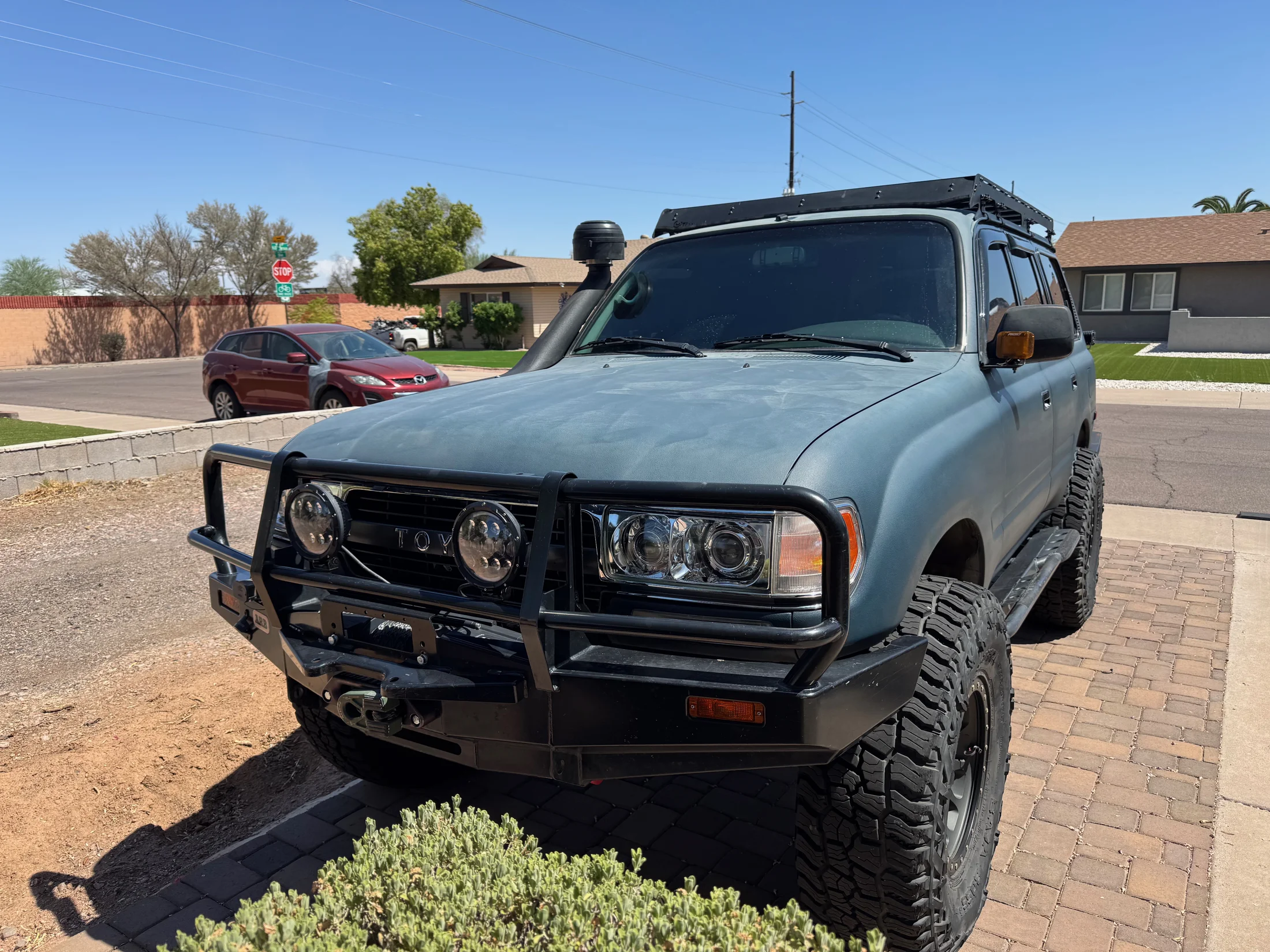

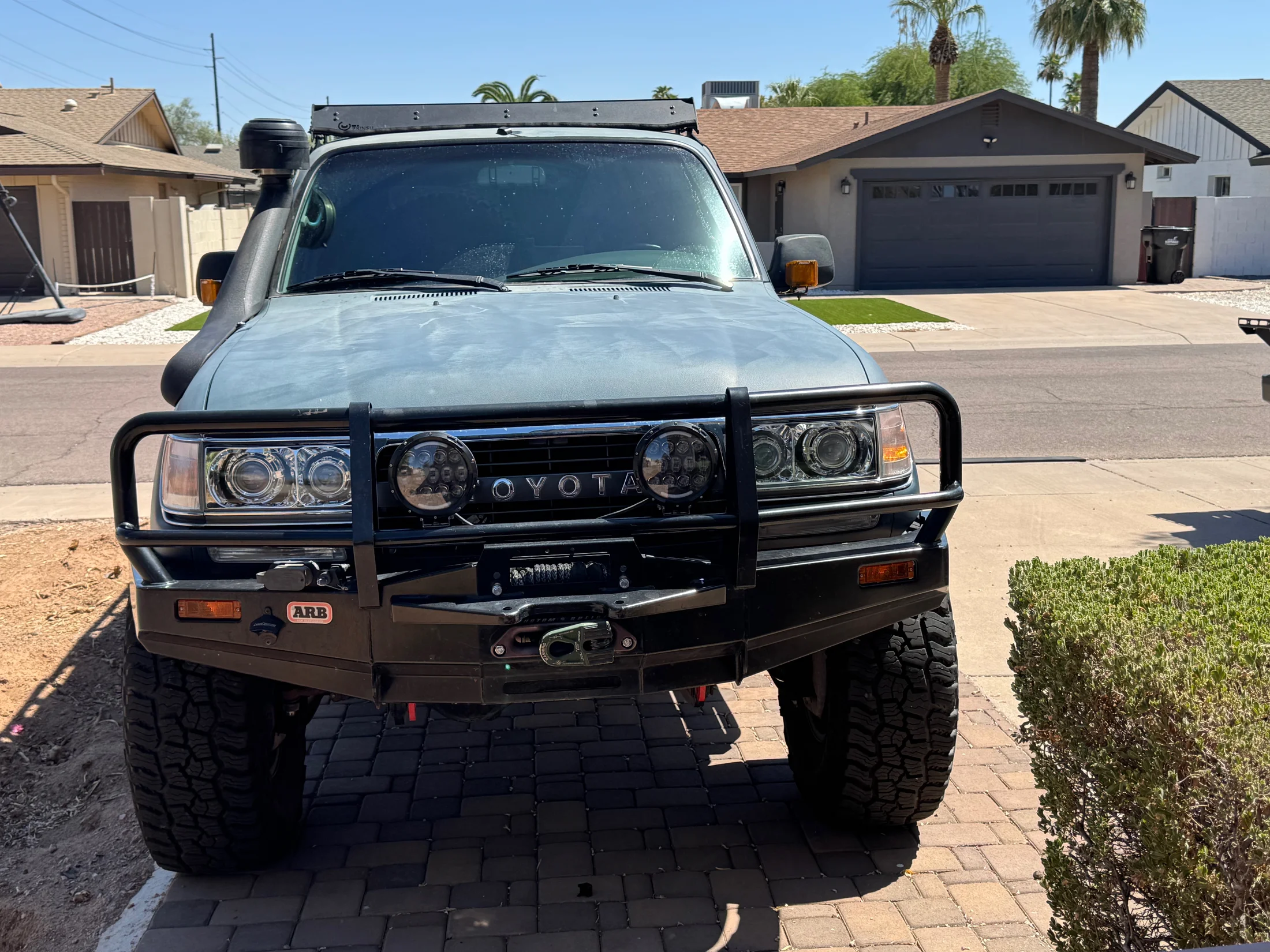

Added TEQ Customs headlights and a new OEM grill. Absurd light output, easy installation and CRISP horizontal light cutoff lines that allow for really precise adjustments, Truck continue to run, ride and handle like new. Other than the raptor liner on the hood not holding up well to having no heat insulation for the few years before I bought it and the Arizona sun... this truck is now better than new. Sure some of the original interior trim panels are showing their age, but other than that, I can't think of anything that isn't better than I expected.
Considering a respray with raptor liner including a UV protectant add-in if I can find one. Maybe the early formulations weren't as UV stable as later ones. Weird that its only the hood that has issues, but as I said before, when I bought the truck there was no insulation pad installed, so engine heat was probably a factor as well.
