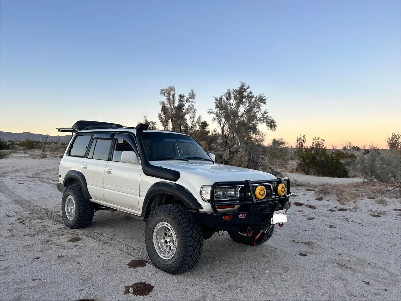

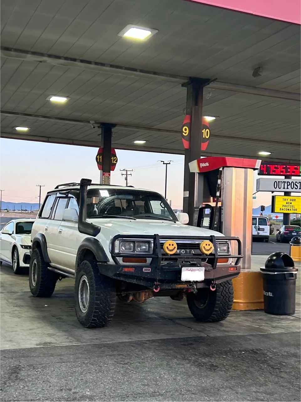

I have a 2013 second gen Tacoma trd off-road that I've spent too much money on over the years and built it to a great little all around truck. Couldn't shake the dream of owning an 80's series Land Cruiser the more i learned about them. Ended up selling my practical daily driver sedan to purchase another 4x4 project after i found a deal i couldn't pass up. I wish I had a cheaper autistic special interest. Had this for two years now, another money pit/ poor financial decision, but **** I love both of these trucks. Picking one is like choosing a favorite kid. 1994 fzj80 tripple locked (Eaton front and rear, factory mounted selector) Picked it up for a good deal, mostly modified already and had a lot of maintenance and records. Just had a top end rebuild and refresh with no leaks. Drove from San Diego to San Francisco to pick it up. Brakes were really mushy and the ac didn’t work at all so it was a long drive back home. Truck has a salvage title But only from being stolen and recovered, no damage anywhere. Helped with the price, but didn’t help with getting insurance. Previous owner had already done alot of tasteful mods and took great care of it. He loved it and was only getting rid of it because he had another baby on the way. Favorite mod he did was the Australian quad headlights and clear corner lights. All I’ve done to it is sliders, jdm style rear spoiler, kc lights , expensive ass/ heavy/ non street legal kmc wheels ( I love them, favorite wheels ever) and lots of maintenance. Truck is 30 years old so even if you get a good one you better like to tinker. I did an ac compressor and belt tensioner, plus leak check and recharge and filter drier ( I work in hvac). Leak was thankfully only in the high side schrader valve, compressor was shot and pulley was seized. Put in a new oem Toyota radiator, alternator, new air intake hose as the old one had a crack, load sensing proportioning valve, brake master cylinder and brake booster, fusable link, and got the knuckles rebuilt by a shop because I didn’t want to do them in the street. Did all the fluids, still need to go back and do all my small coolant hoses and the rear heater bypass, and fuel filter. Any other common baseline things to check let me know. Originally bought it with dreams of doing Rubicon and the harder trails that I don’t think my mid travel ifs would survive. Spent about as much as I would’ve on a MCRCLT kit. Gonna be a lot more money to get everything together to properly fit 37s so for now I’m just enjoying the cheap ome 2 inch lift and 35s which it clears effortlessly. I could chop the body and make things fit like i did with the Tacoma, but its nice having an intact truck and i would feel bad cutting up a classic. Thing is capable as hell and super comfy, really nice sleeping inside too out of the wind or rain. Drives straight and feels like a tank. 4.88 gears move the truck well, doesn’t feel underpowered, but I live at sea level and don’t have a lot of extra heavy s*** on it. Biggest con is constant work to baseline an old truck and 10mpg, but other than that I think it’s the most practical vehicle there is and peak Toyota.

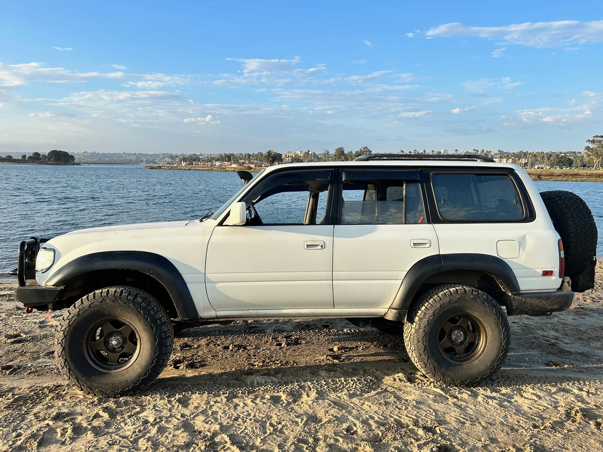

Fender flares are off for now. Trying to decide if i'll leave them off or repaint them white. I was ripping off the rear door ones, until i got bump stop extensions, but i was'nt too crazy for the rattle can black on them before.

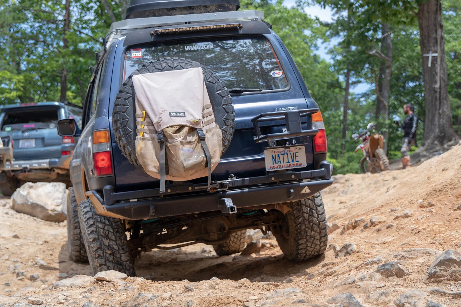

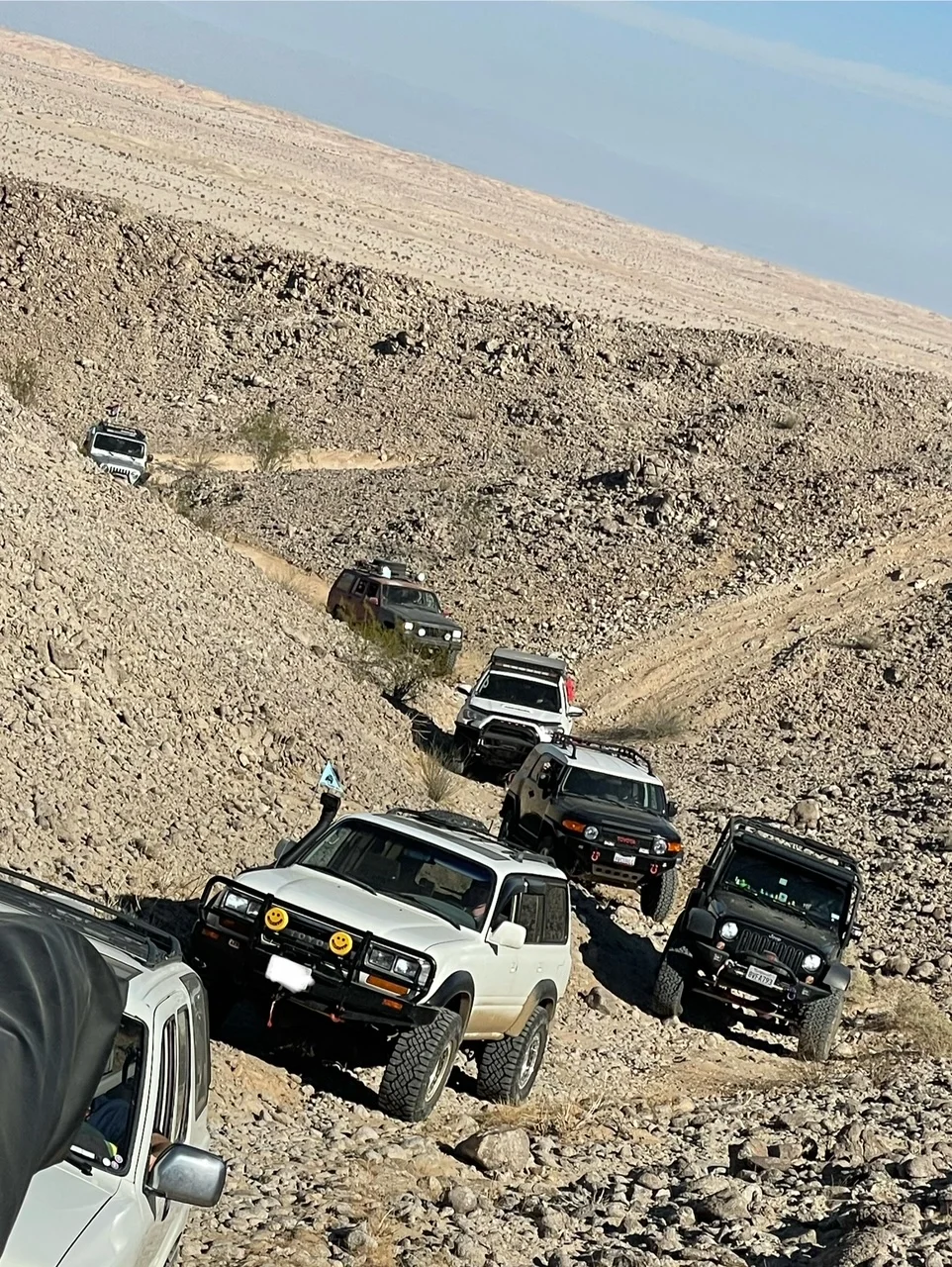

Give it a shot, you may be surprised the shenanigans you can get up to with 35s and a couple if inches of lift with lockers. I haven't found the obstacle that stops mine and it is similar: 2-1/2" Icon, 35" STT Pros. , ARB lockers. I'm more limited by driver skill than anything else.

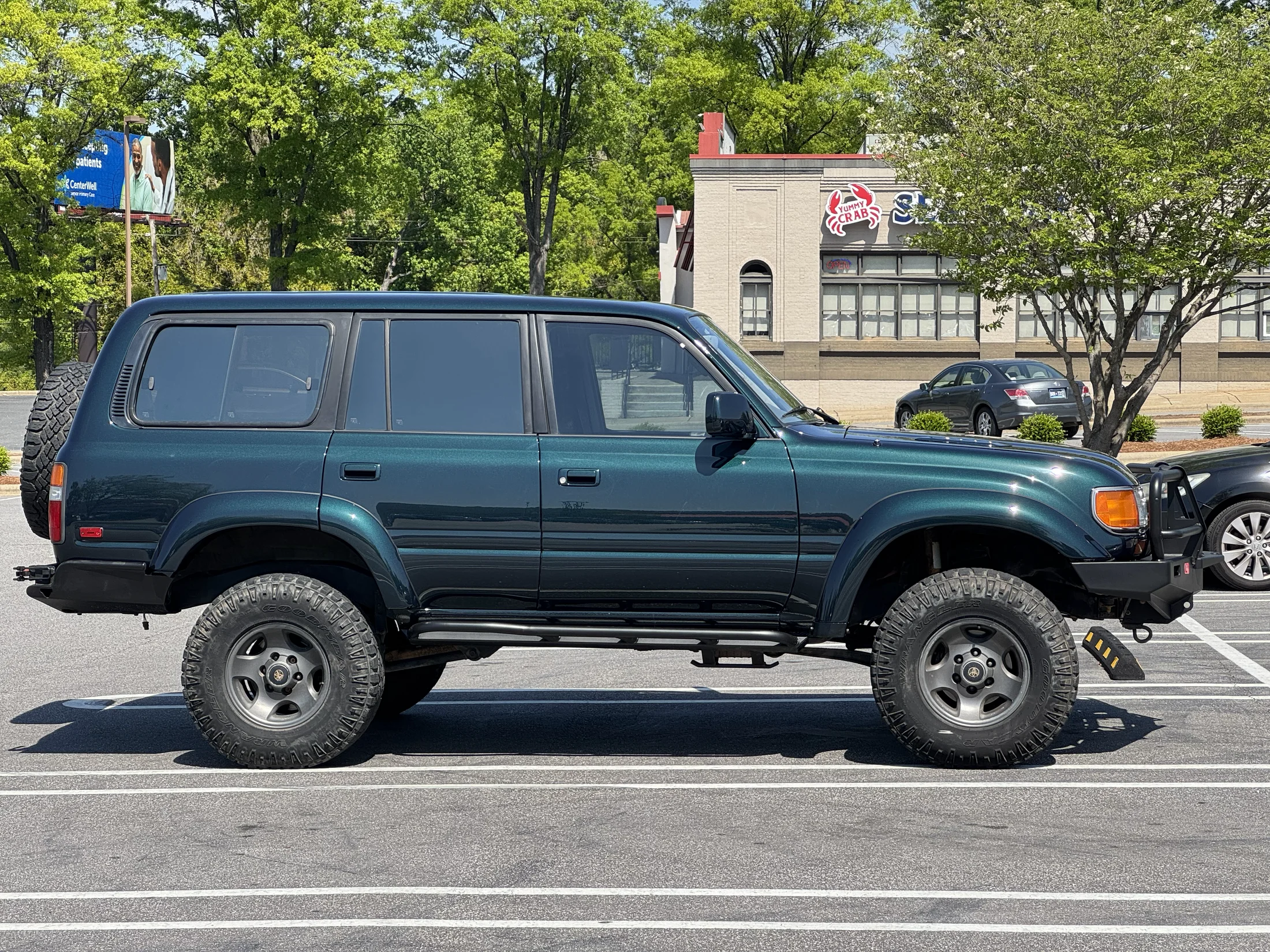

Second best financial decision I made was buying a 200 in 2017 when nobody wanted them. Worth as much now as it was then.
Nice 80.

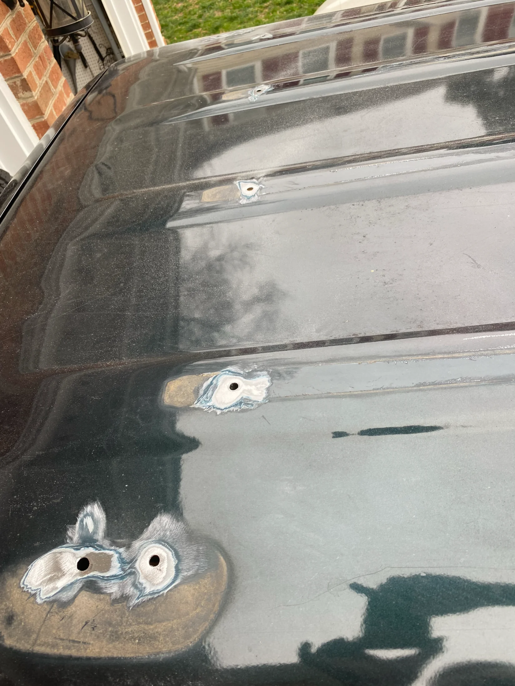

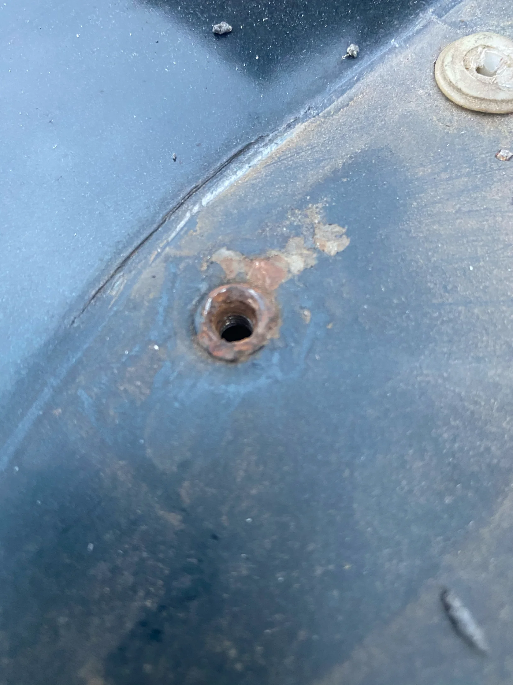

Looks like I’ll be needing a welder. If you have an oem roof rack check for rust.
Be aware that the process for dropping the headliner on a pre-95 is a lenghty process and you essentially have to remove everything on the inside beltline up. Some people find a 95+ setup and convert to make it easier later on.
There is another thread about repairing rust from factory roof rack and IIRC there were some "interesting" solution given.
Great advise thank you

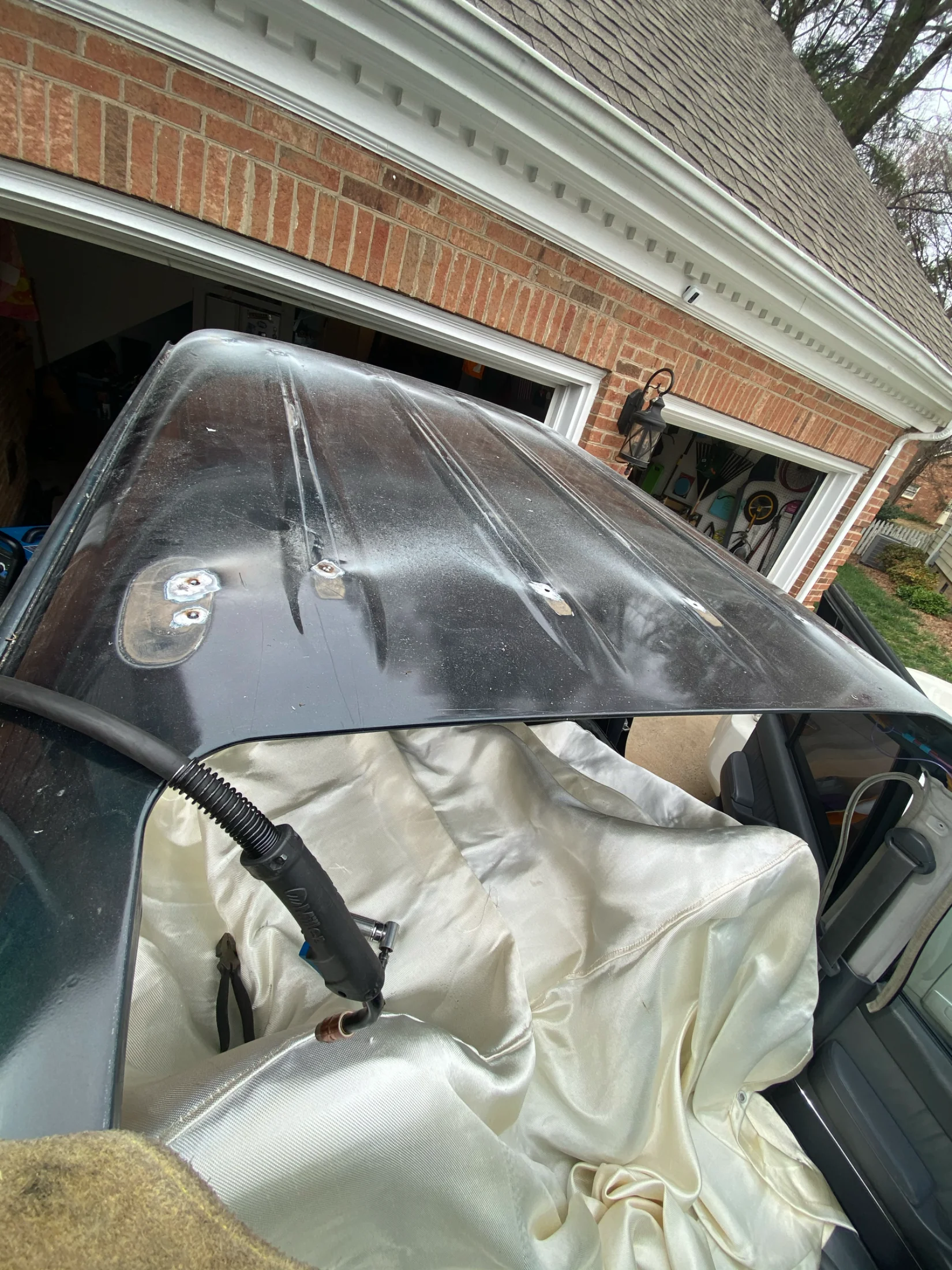

Been there done that. I would advise you get an 95 or newer one piece headliner to put back in. Getting the older style back in is pretty much impossible after removing it and it's not worth putting a new one back in. My rust wasn't quite as bad as yours, but still a PITA. Only rust i have ever found ANYWHERE on my truck. It didnt look bad, but it was spreading under the paint and worse than i thought.

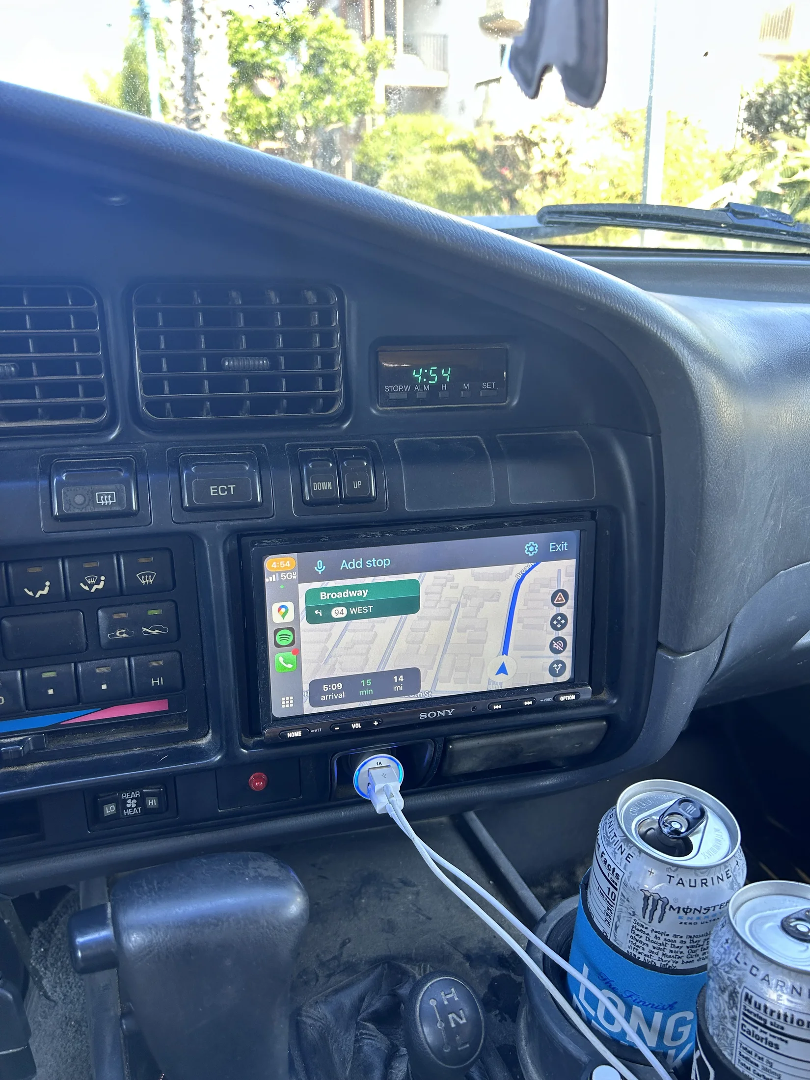

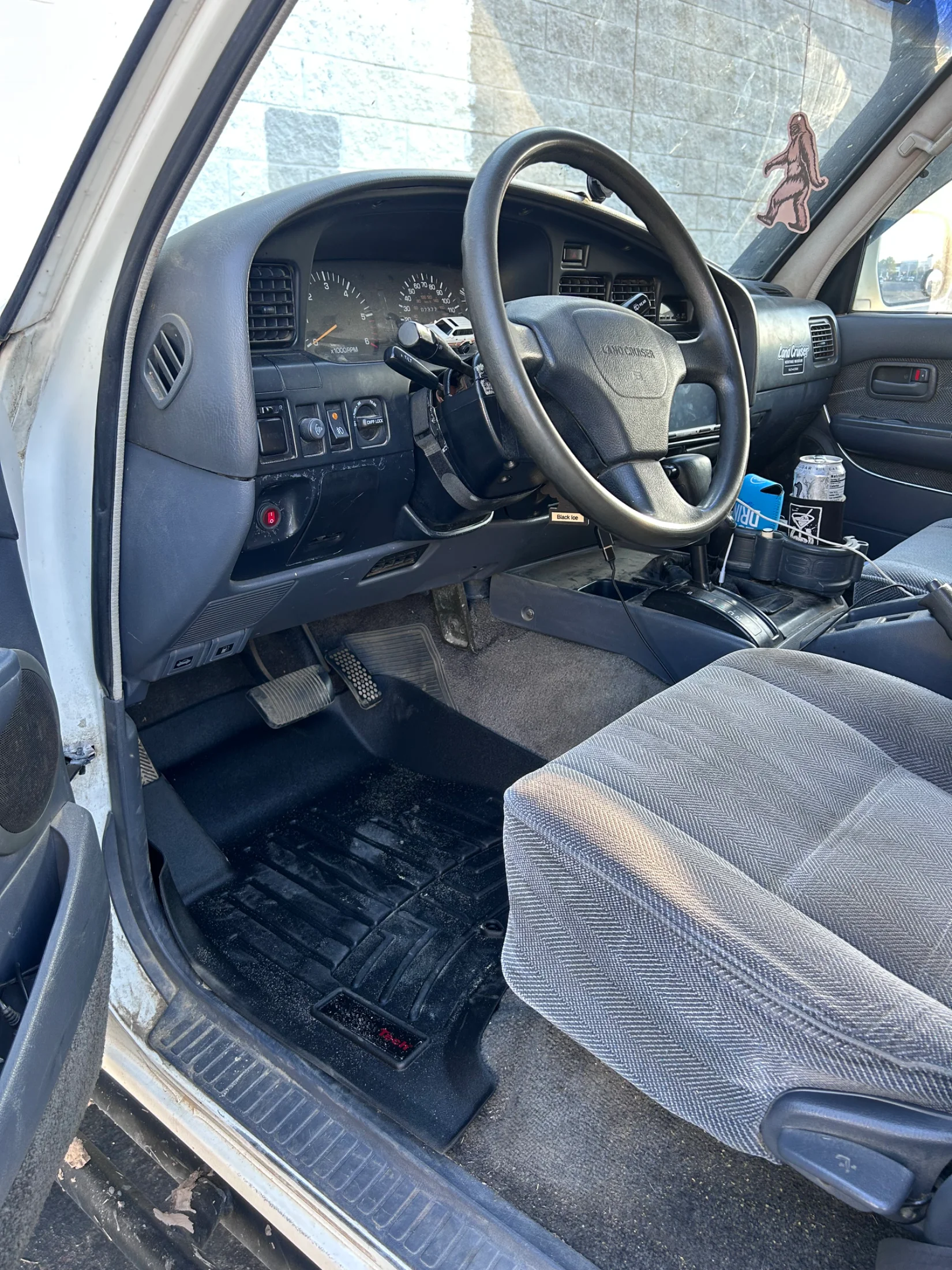

Couple interior mods before I attempt to drop the headliner and while I’m waiting for my welder. CarPlay and some weather tech mats up front. Both nice to have.
I did a roof rack delete on my 94 and used fiberglass impregnated Bondo.
I did the same with the flare delete
Not one issue with anything falling out.
I think it’s better because you’re not burning the paint off the inside and you don’t have to remove the headliner.
Welding sheet metal is an art in itself.
I have be welding for decades and I struggled with sheet metal.

My rust is pretty significant on the roof. Not insane but I’m gonna have to cut some decent holes out. I’m sure I’ll need to do a lot of practice runs but imma give it a shot. My girlfriend’s dad does auto body paint so he offered a cheap single stage respray if I help prep. Might as well just weld it up.
I taught myself the basics of welding on my 80. I don't have a roof rack from the factory but, I was "blessed" with the rusted out second row seat belt mounts. A friend of me had a parts 3rd gen 4Runner. He gave me a wrecked door from it, and I did all my practice welds on it. I would cut out a shape from it and then try to put it back in. After 4-5 times you really learn a lot and how wire speed and voltage effect the welds. I wish I would have bought a welder years ago! Good luck
Lots of good videos on YouTube, and go with .023 wire to weld sheet metal 😜

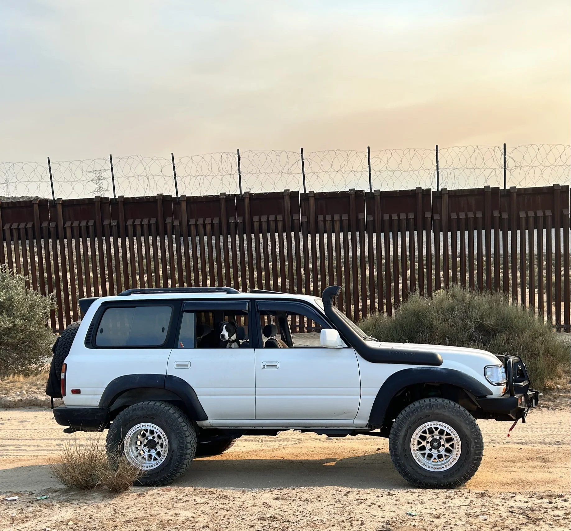

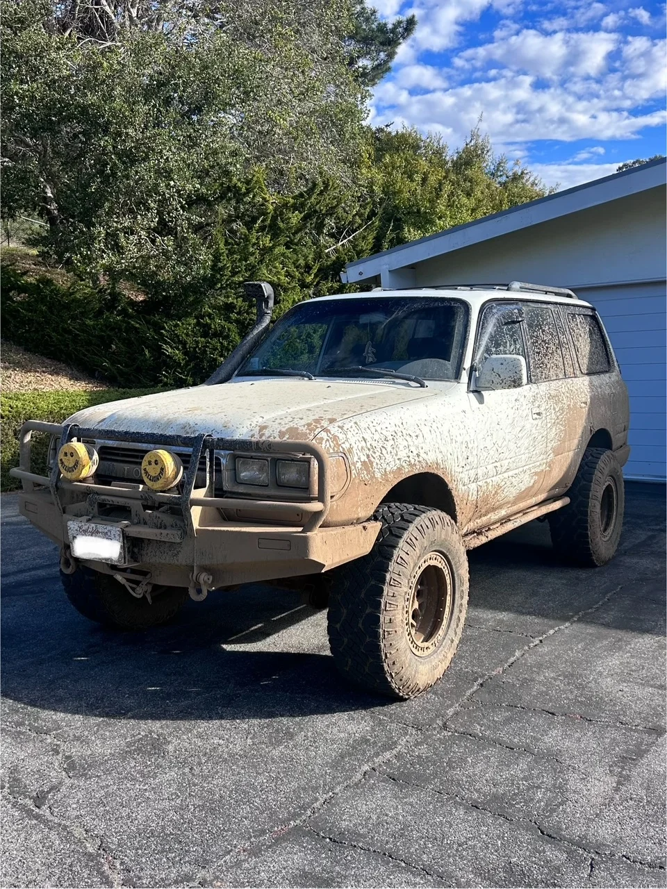

I've always thought I wanted bigger tires for that killer offroad look. Ideally 35's is the max I should install for the type of driving I do. However, this picture proves that a clean Cruiser with 33's and a lift still looks absolutely badazz.
I literally bought a welder and a 4x4 Labs kit and learned how to weld by building it.
No this Cruiser looks Bad A**

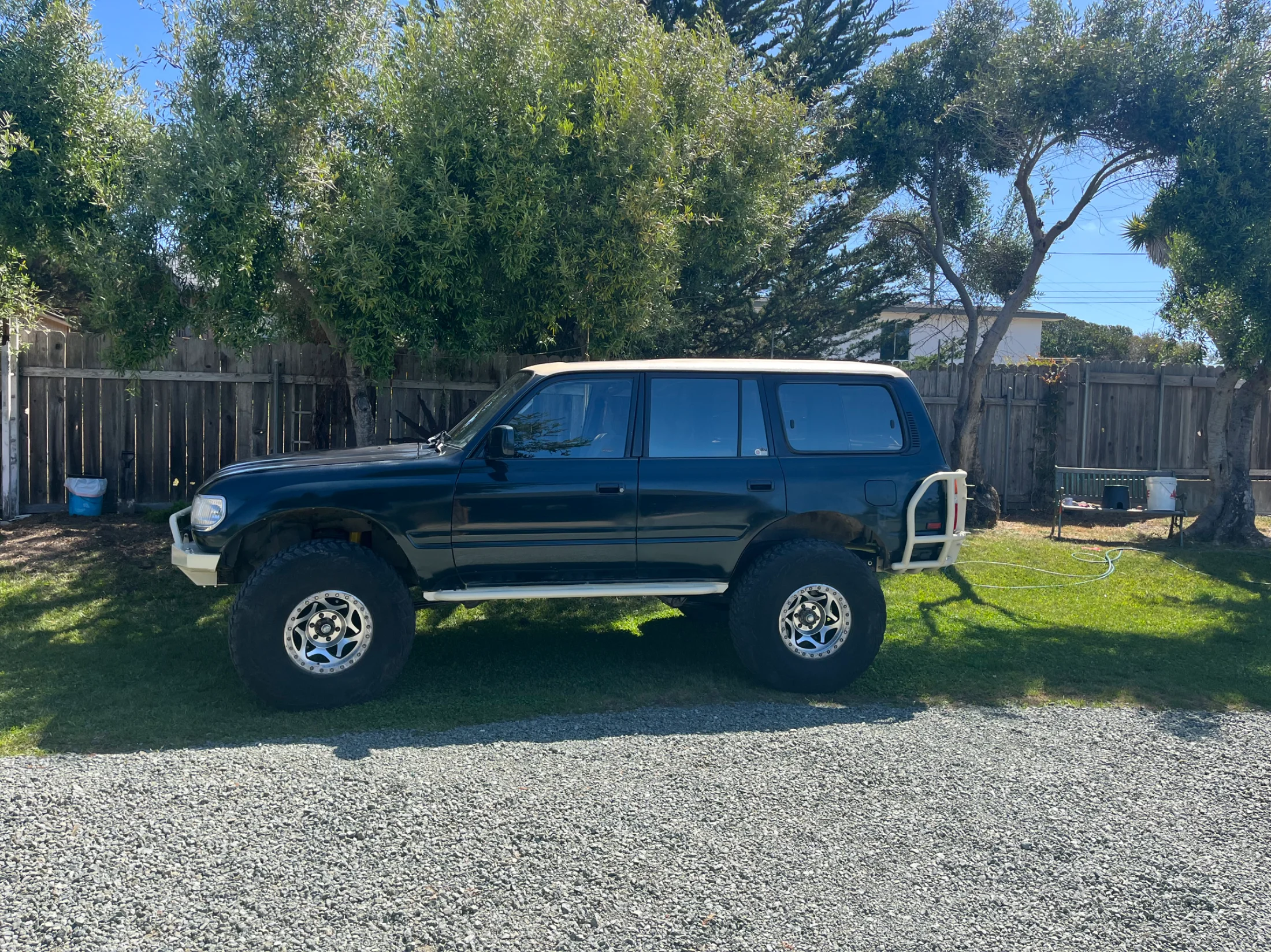

39s on a 2.5” lift. 😎
Really it’s all a matter of preference
I don’t care for the big lift small tire look
33” tires look great on a none lifted 80 IMO 😉
