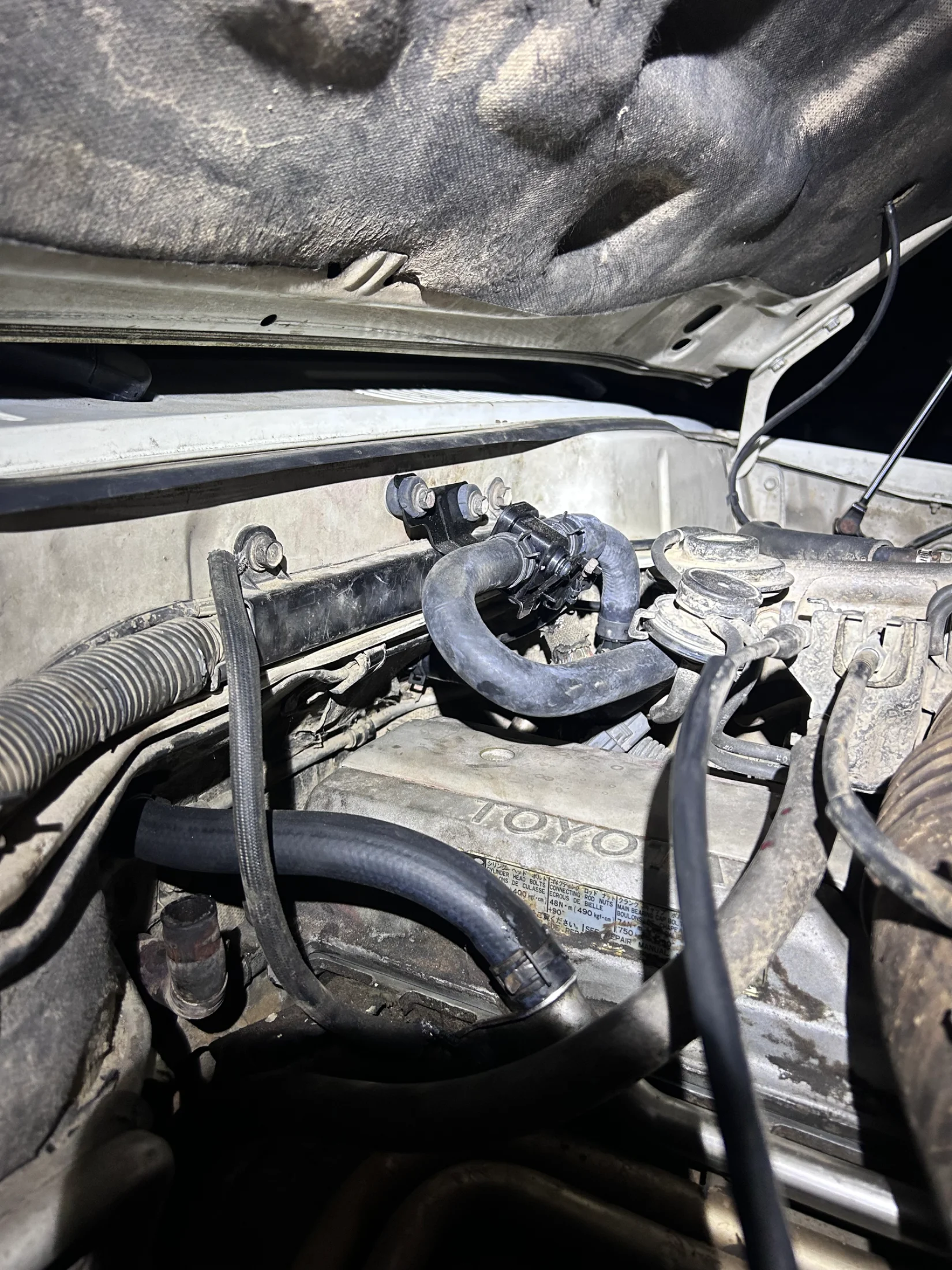

Still haven’t done my roof yet, but I did finally knock out the rest of the radiator and coolant bypass hoses / rear heater bypass. New heater valve, throttle body clean and gasket, fresh valve cover gasket / spark plug gaskets. That lower bracket bolt on the metal pesky heater hose tube is a nightmare, ended up breaking the bracket and cut it off the new one.

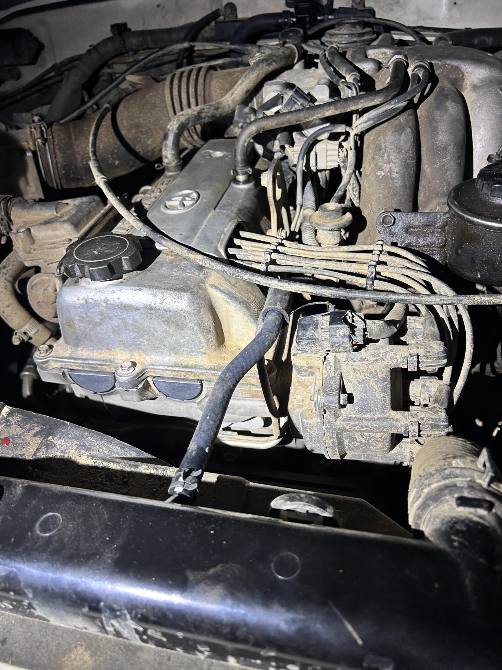

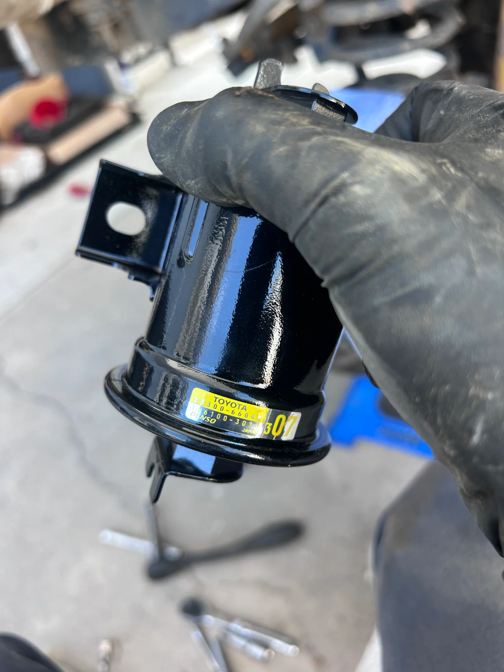

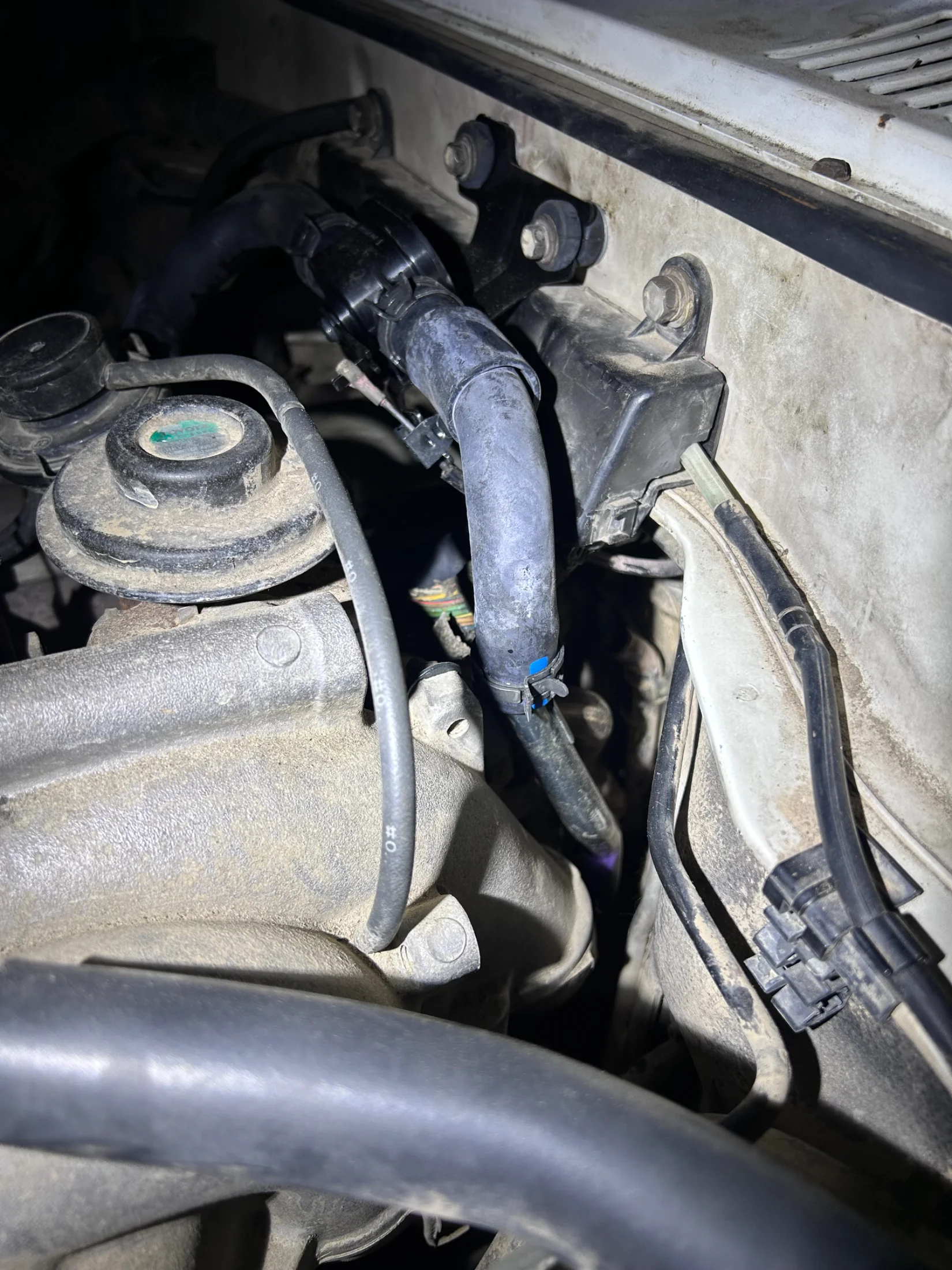

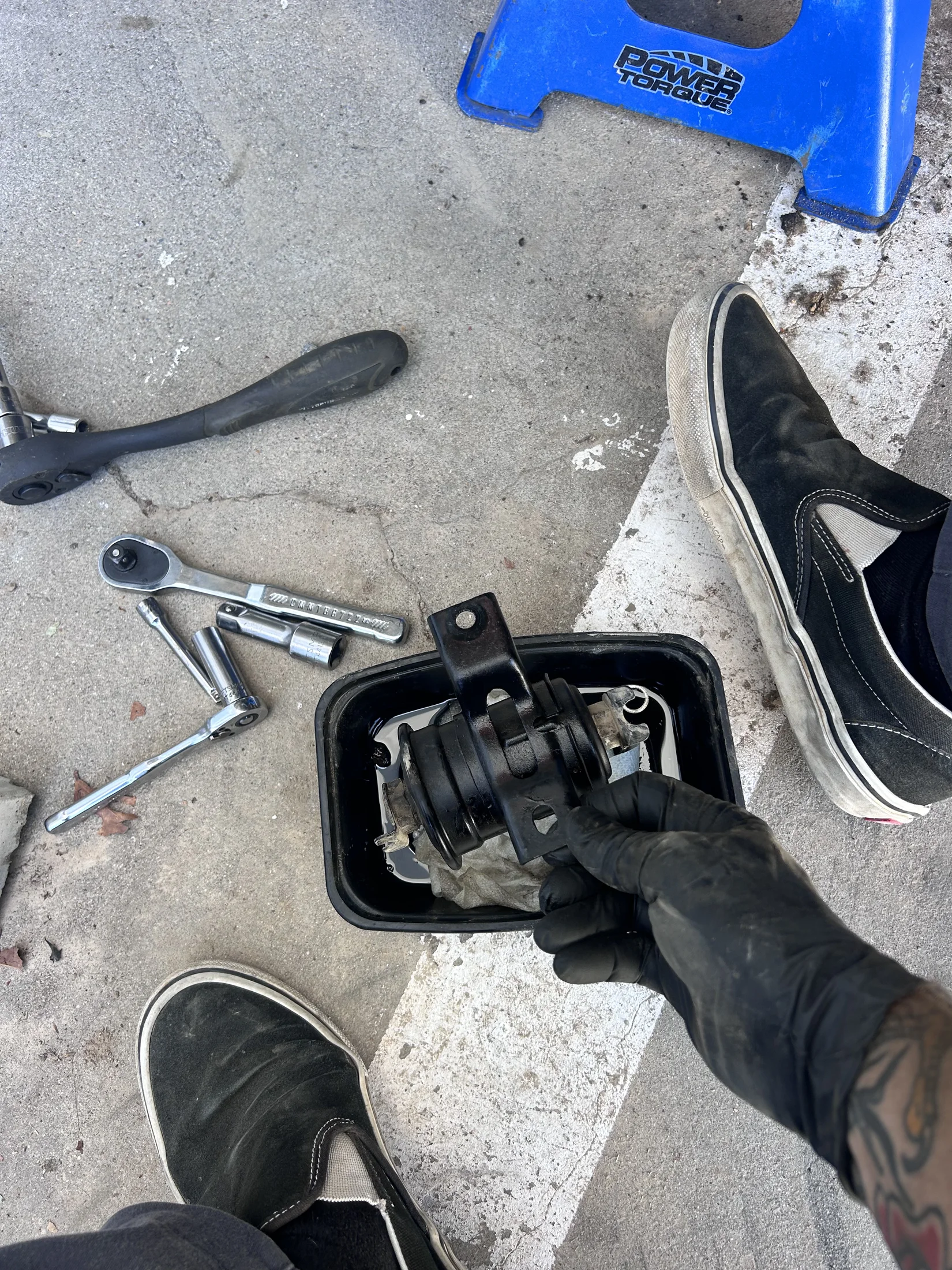

Got fresh pcv hoses and clamps, new charcoal canister hoses and most of the vaccum lines knocked out. Finally got around to both front and rear pinion seals. Put in the marlin crawler eco seals, Hope they hold up. Rear diff had a concerning amount of sparkles in the oil, no chunks but I’m not sure what to do.
You rebuild the charcoal canister or went aftermarket ?
