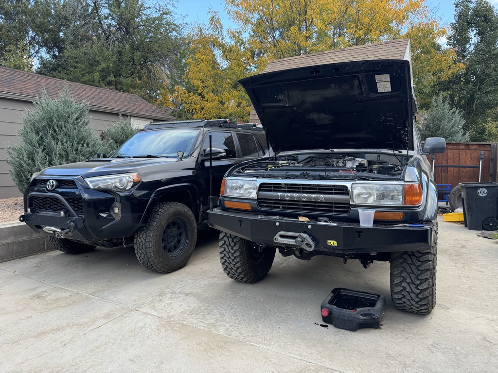

Here's how she looks now
Well, technically here's how she looks right now:
Took her to Medicine Bow WY, started to do Libby Flats and the low pressure power steering line blew up, spraying ATF all over the engine bay.
I was able to use a Glue Tred tire repair patch to patch up the leak and get her home. Glad I always carry some extra ATF when offroading.

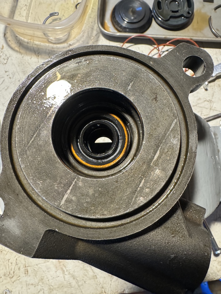

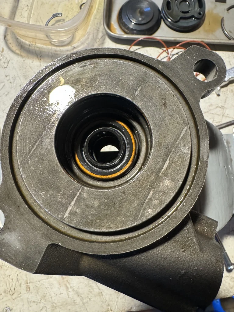

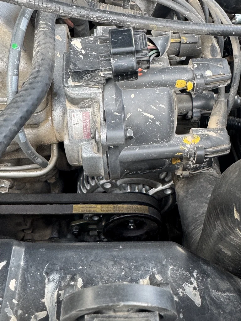

I figured while replacing the low pressure power steering hoses, I might as well do the high pressure and a pump rebuild at the same time. I was following @gnob thread when I realized that some things on the pump weren't adding up. The O-rings were orange, and the oil seal did not match the oil seal in the rebuild kit. Turns out this is an aftermarket pump and it was just replaced by PO in June :bang:
Lesson learned: Check the POs maintenance records before replacing things. Decided to just order a new OEM PS pump rather than rebuilding an offbrand auto-zone pump.

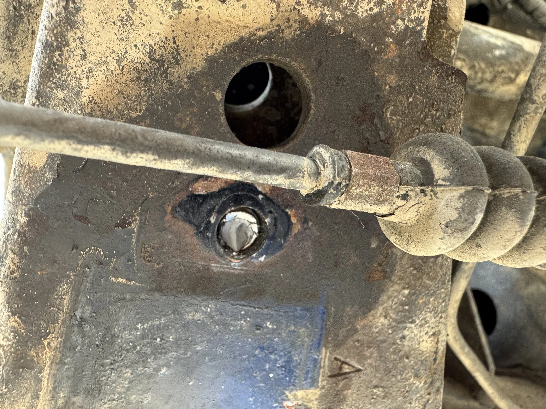

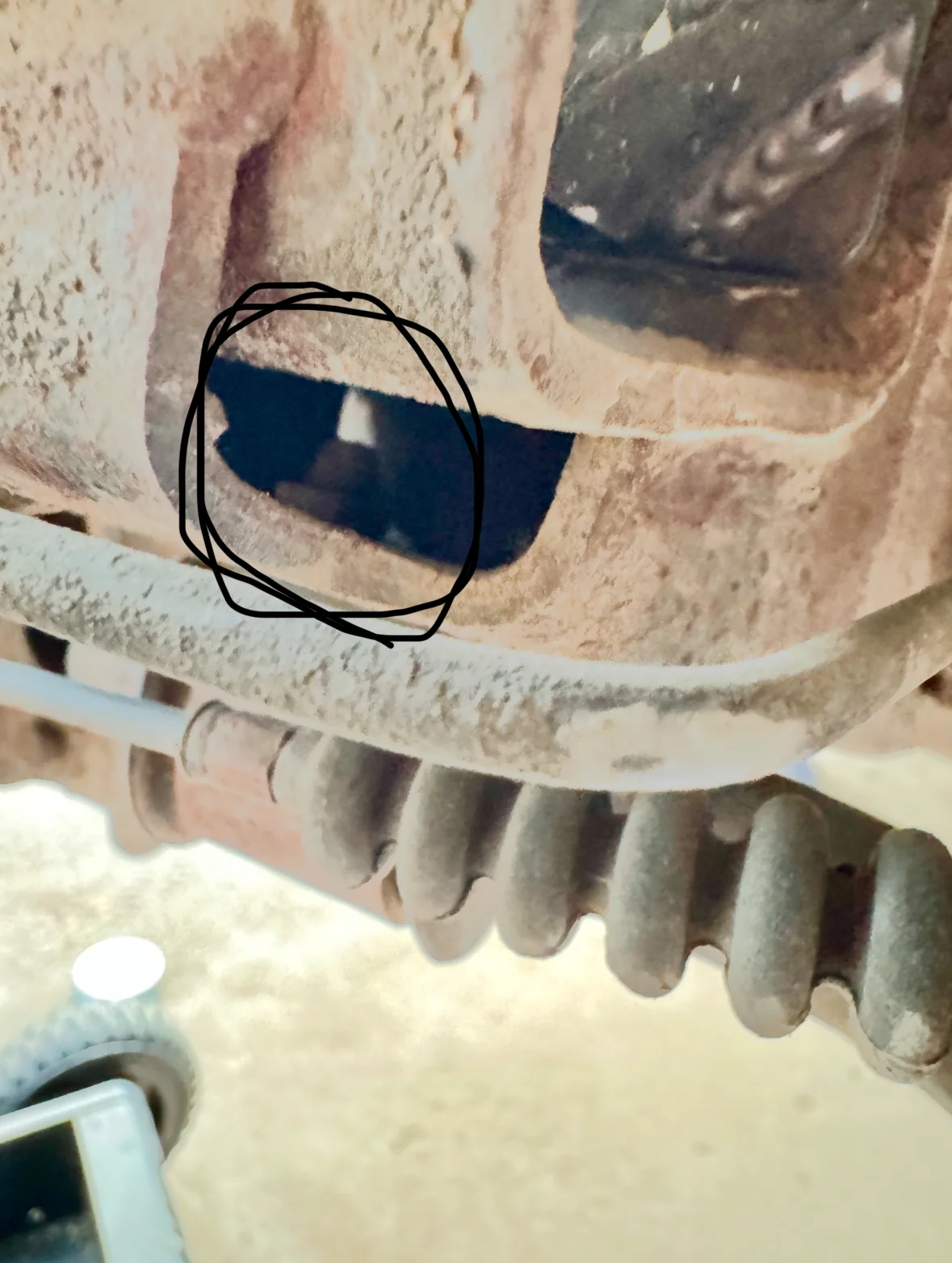

Was starting to remove the sway bar mounts to swap out the bushings but broke a bolt off. Other half is still stuck inside. Will try a bolt extractor and see how it works. Any other tips?
I would definitely try and drill it out but I would fix soak it in some penetrating oil especially from the inside to clean up the threads that are still exposed. My reasoning is due to fear of breaking off the welded nut inside.
Thanks! It was between the nomads and the SSW raptors but I liked the retro look a bit more.
Exactly same reason I went with the Arvo too...has the reto look that goes well with our 80s and doesn't look out of pace like Fuels and other newer wheels.
Well, think I might be f**ked here. Soaked in PB blaster overnight, got it nice and hot with a torch and tried to remove it. Thought it was starting to move and then snapped the bolt extractor right inside it. Not sure what to do next on this one. No way to reach it from above, nothing to grab on to below.
Yes, your are screwed. A drill isn't going to do anything because that easy-out is hardened streel. Grinding is difficult. Welding another nut through the center of the nut may be your only choice because of the location,
Normally if you get some movement then you tighten the bolt backup and retry. Each time you will get more movement.
I had a similar deal last weekend with a M8 weld nut and broken extractor- I was able to drill a couple small diameter holes next to the extractor and used a hammer and punch to knock the broken bit all the way through. Then I drilled out and re-tapped the hole for M10. Fortunately the weld nut stayed in place.
