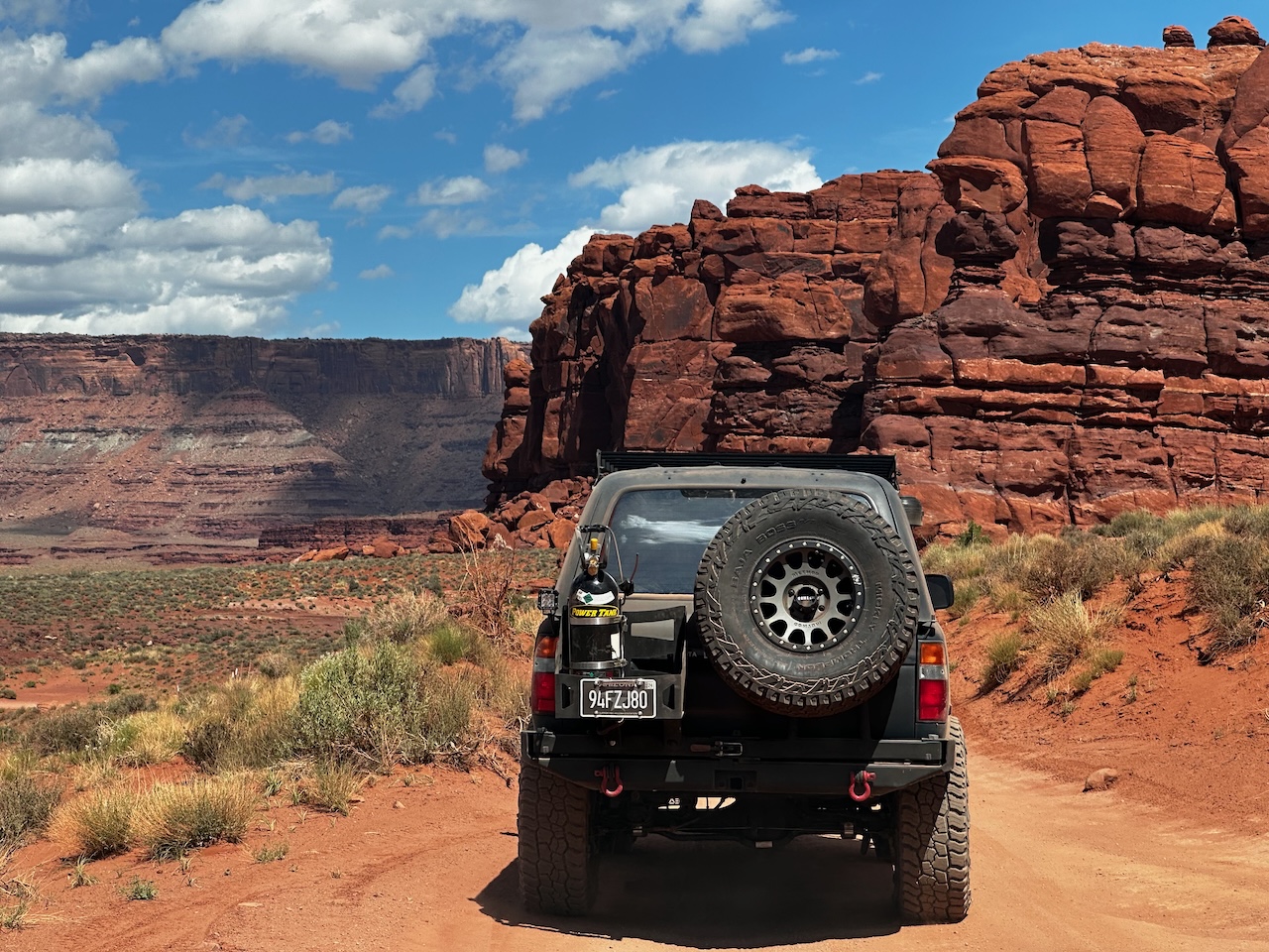

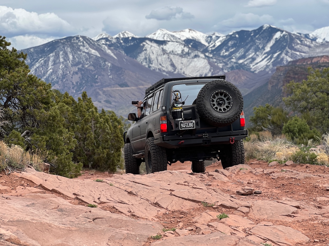

Leaving for Cruise Moab on Wednesday morning and pretty excited to get this rig out in the rocks.

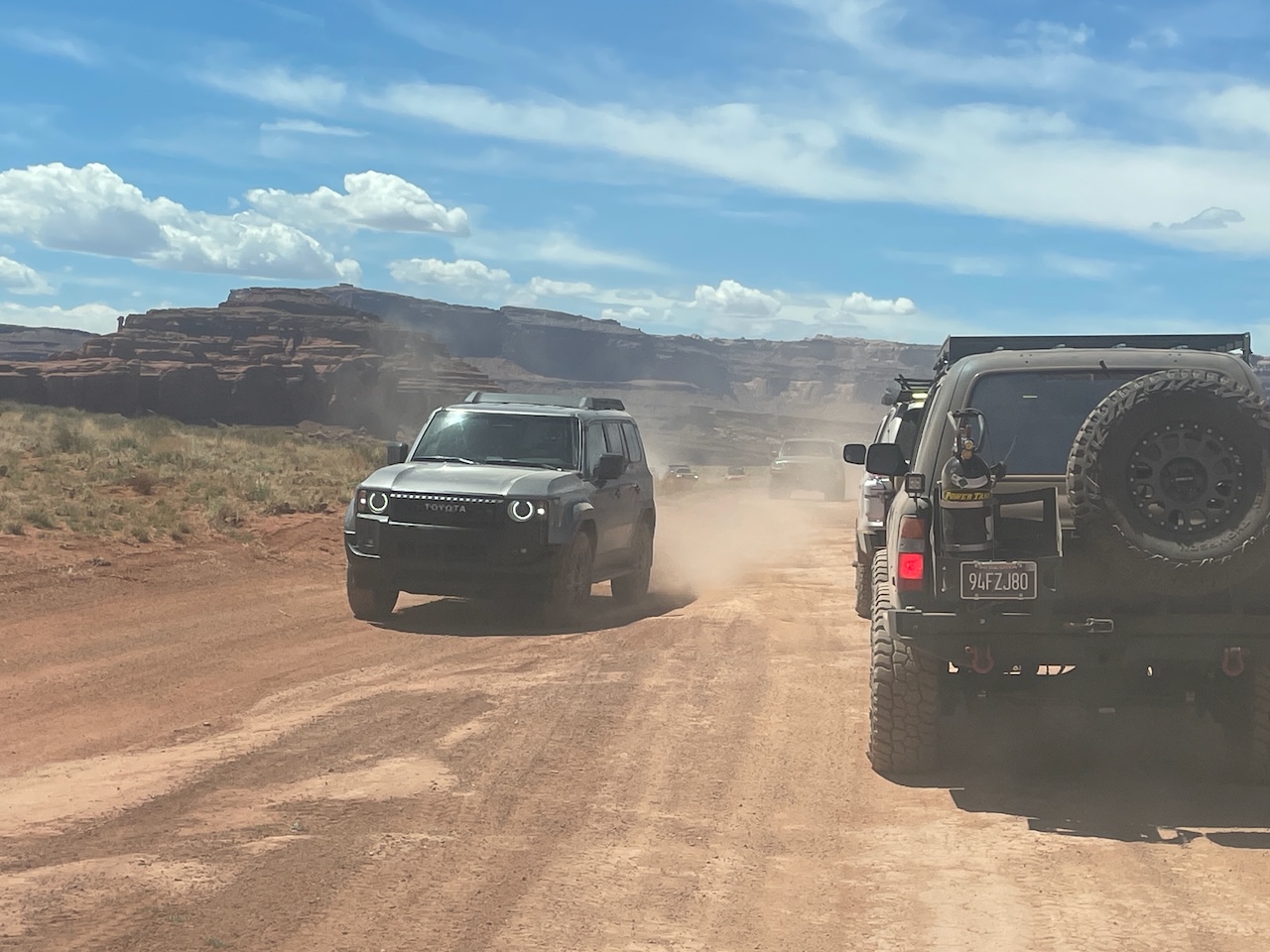

Some photos from Cruise Moab 2024. The Notorious Big Green Egg did great and also ended up with a new nickname: "Beefknuckle" which I can't begin to explain.
Photo credits to some combination of: @linuxgod @mcgaskins @JohnJB @Gregtoy144 and Richard.

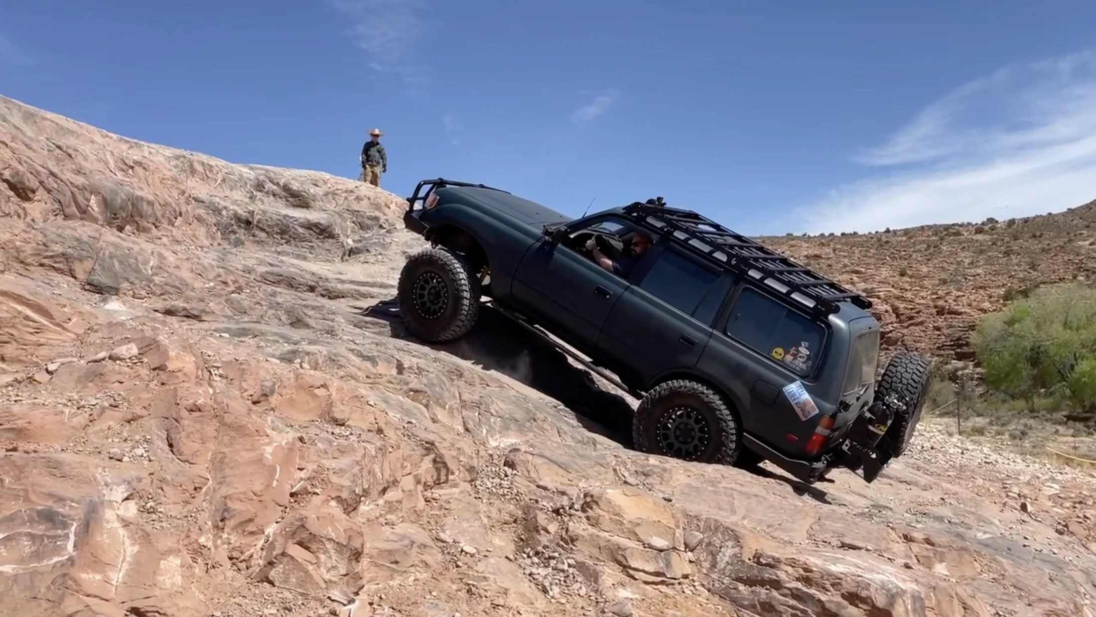

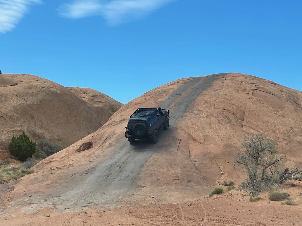

Big Green Egg roll
37” Mickey’s on, what, a 3” lift? What springs are you on? Up travel inches? The fenders appear to be uncut as well. Nice looking rig.

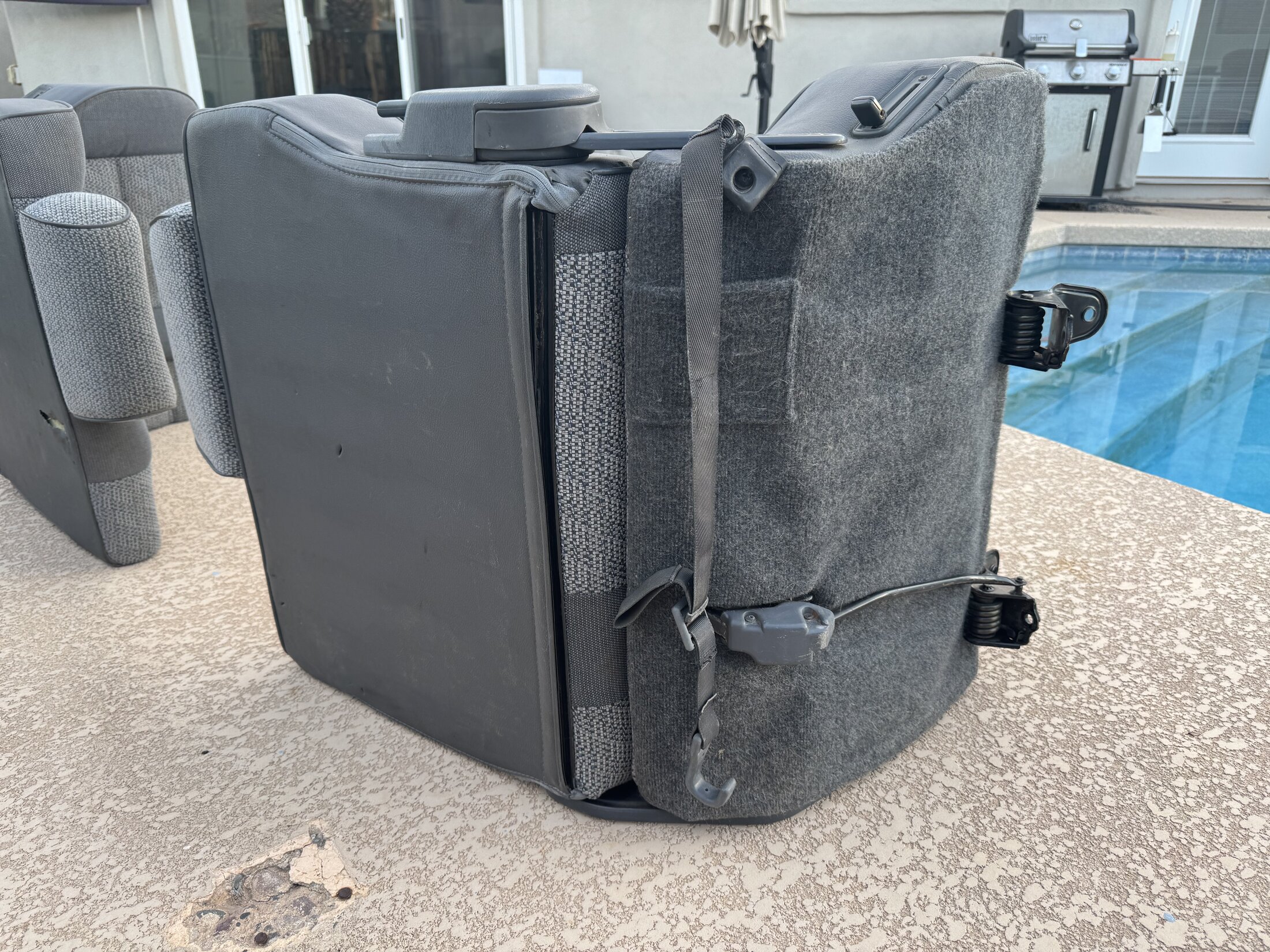

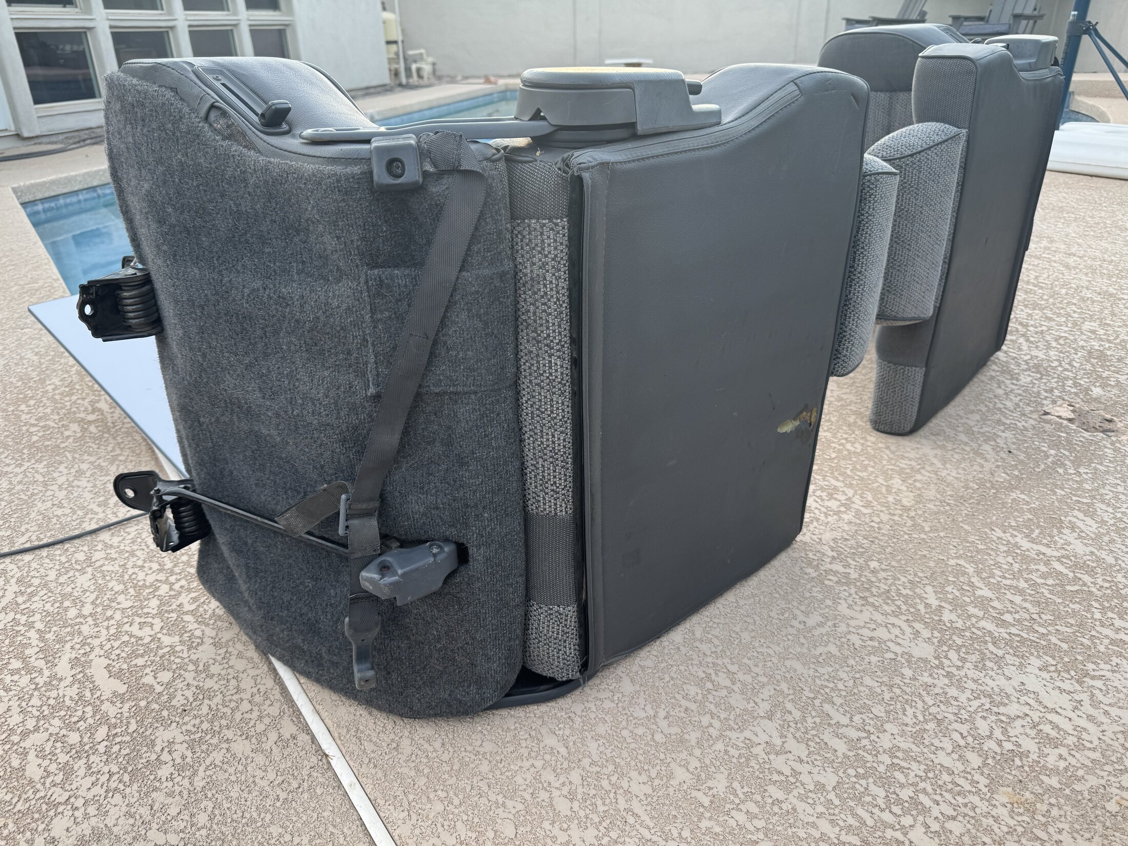

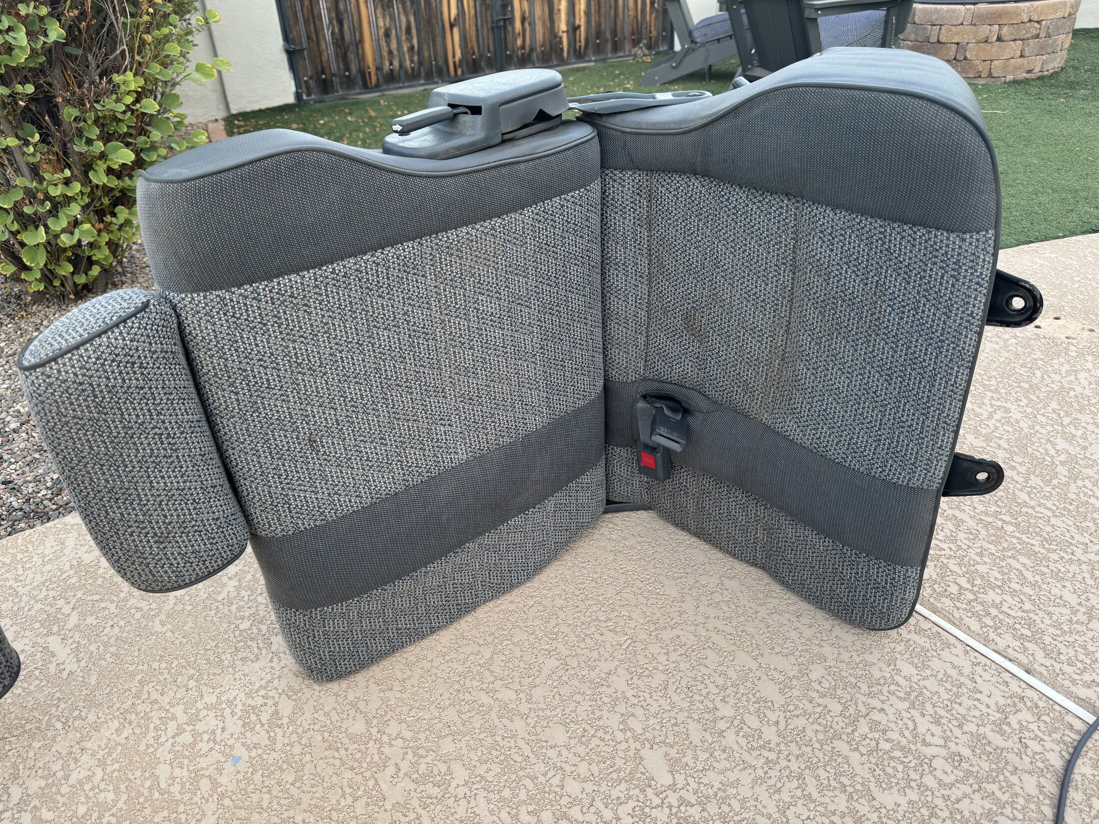

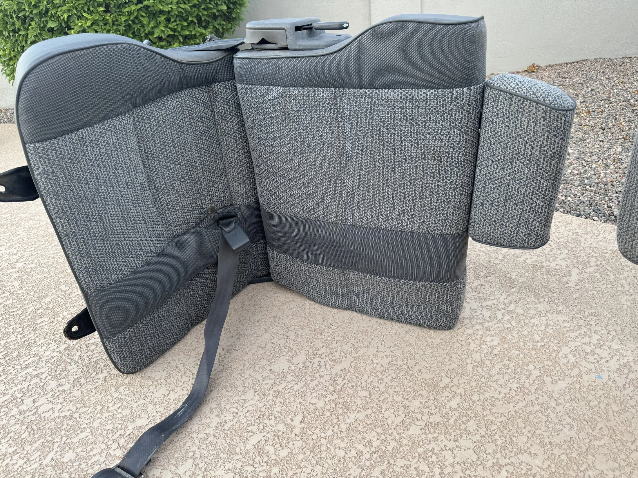

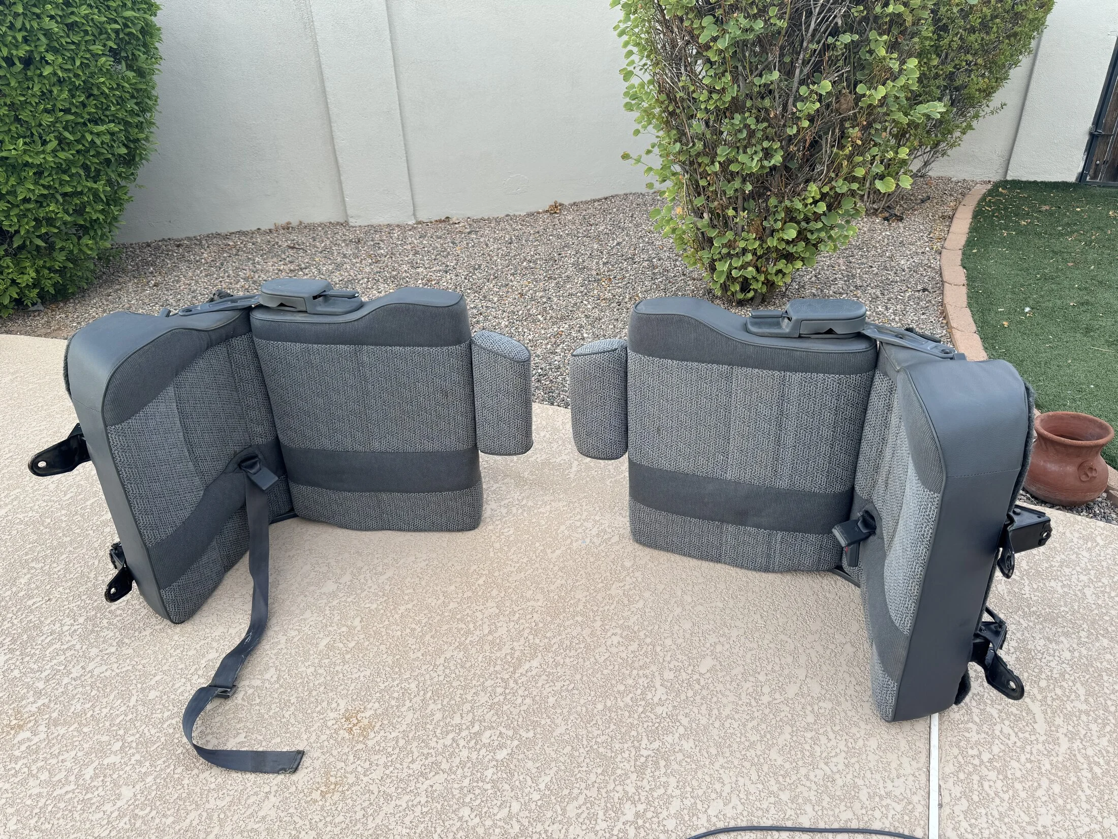

Pulled the smelly 2nd row seats out and it’s the first time I’ve given them a close look. I have the 3rd row as well, but have no plans to use them. I believe they are all out of a ‘91 or ‘92 maybe? Actually in much better condition than I thought. I may end up seeing if I can get the smell out and just throwing a set of Escape Gear covers on all 4 seats. Although my front seats are Corbeau, so they may not fit. Anyway, tackling the seats this week one way or another. Open to suggestions.
Go talk to an upholstery shop. Theres a bunch in mesa. Itll be cheaper than you expect
If you keep them, you should get a wet dry vac and shampoo them. I know people love cloth for some reason, but they catch and hold a lot of farts and butt sweat
Febreeze the sh*t out of them. Seriously. I had a gas can fall over in the back of my 4Runner and it dumped probably a quart or more of gas all over before I could stop and right it. I mopped it up, steam cleaned, shampooed, took it to a detailed, ran an ozone machine for 2 days, and in the end it still smelled so bad with the windows up I’d feel sick. As a last resort before dumping it in a lake someone suggested Febreeze. I used half a bottle over two of three days and the smell was completely gone. Kept the truck probably 4 or 5 more years.
