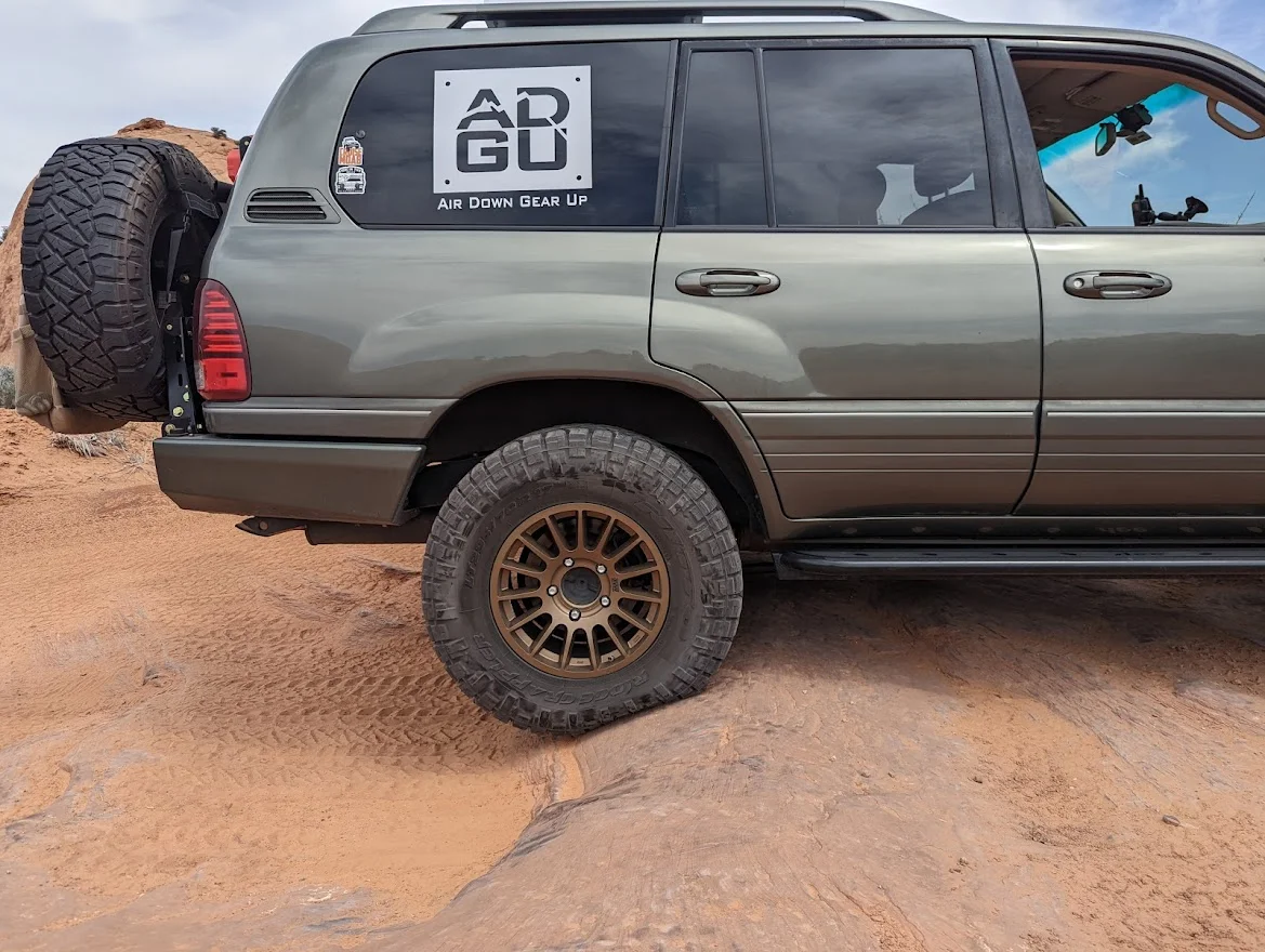

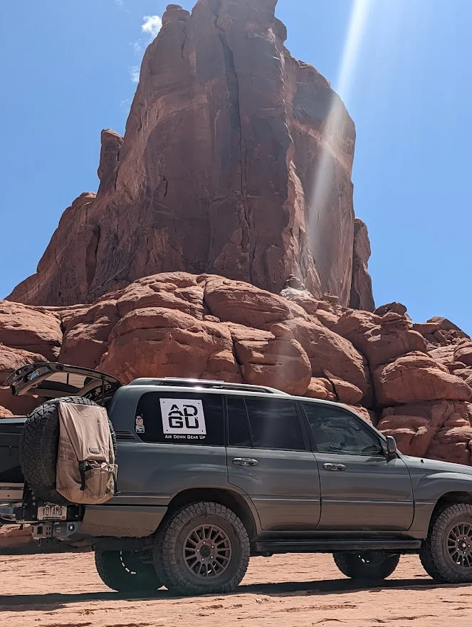

A few more Moab pics of this Cypress build finally seeing some good action. I didn't get any good obstacle shots (since I'm driving...), but I'll post up here if I manage to get any from other folks that were on the trail.
The optional stairs on Sevenmile Rim were awesome. Perfect difficulty level for this car (and me). Hard enough that you need careful placement to get up and over, but not so precarious that I felt the fear of rolling.
Having full armor made this trip a blast. 10/10 would recommend armor over lift. Armor it up and drag it over everything.
