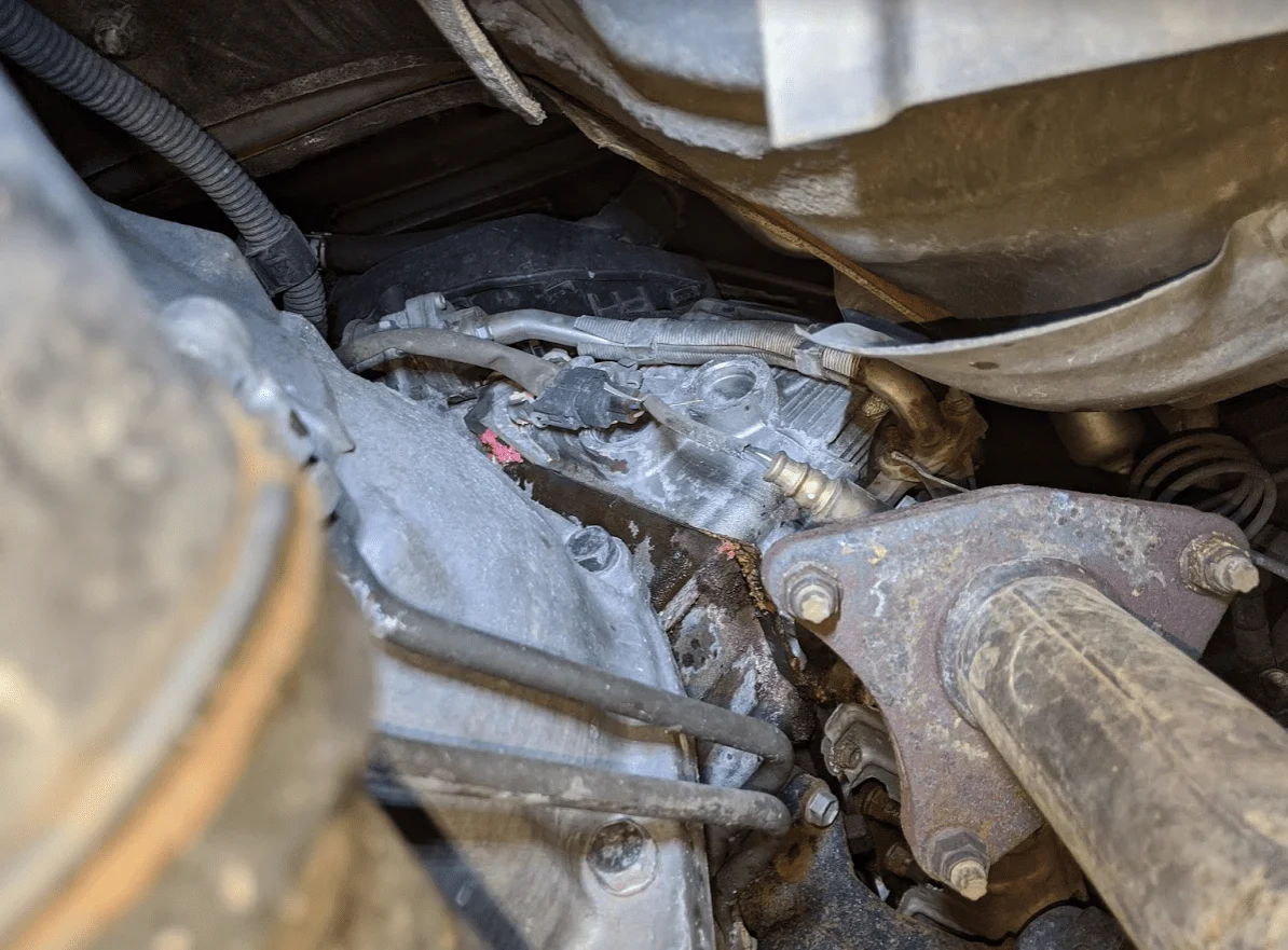

Appears to be the rear water bypass. Takes some labor, but overall should be a cheap fix.

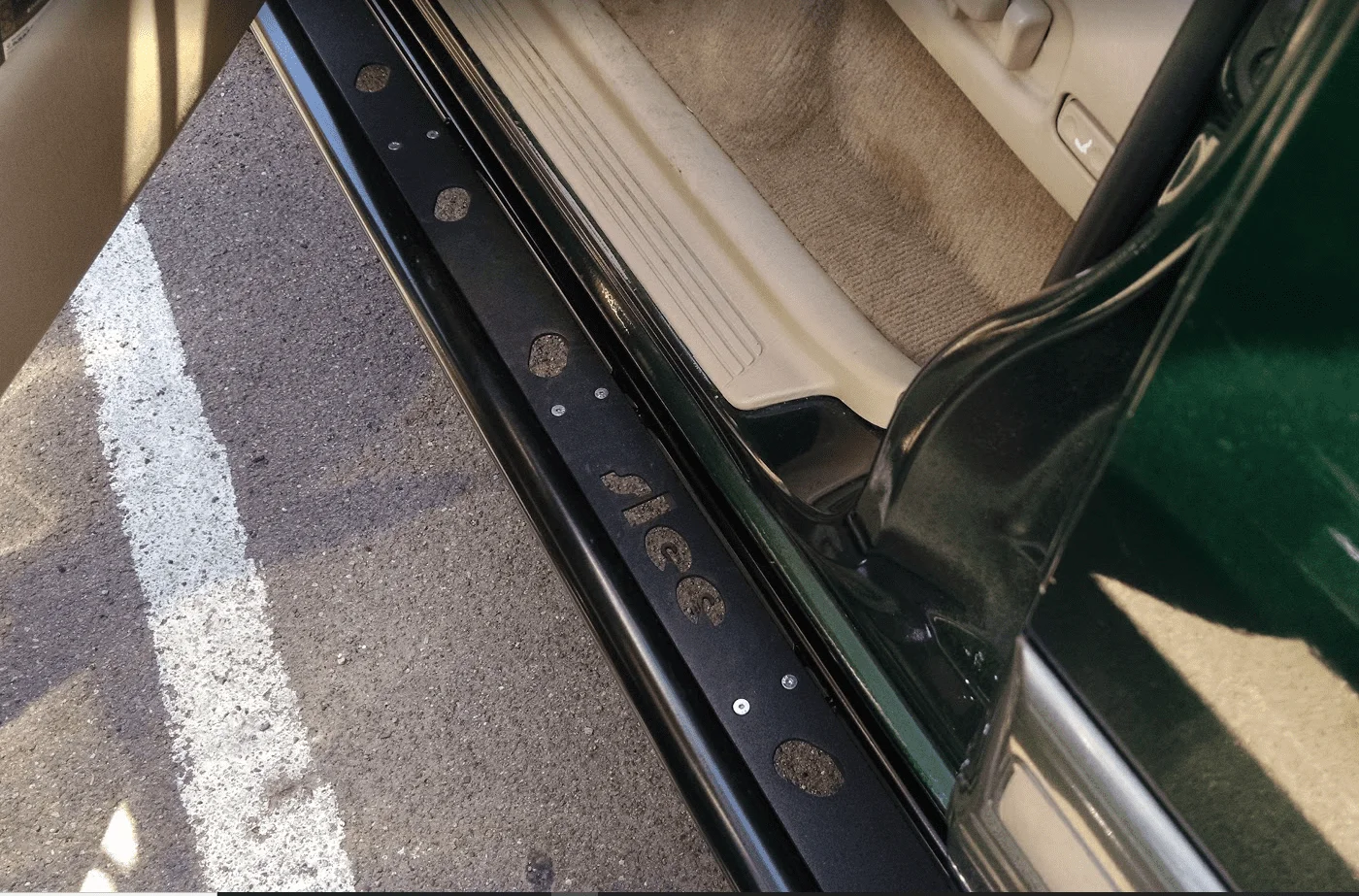

Slee Slider Steps are wonderful. I have them on my 99 and plan to add them to this LX.

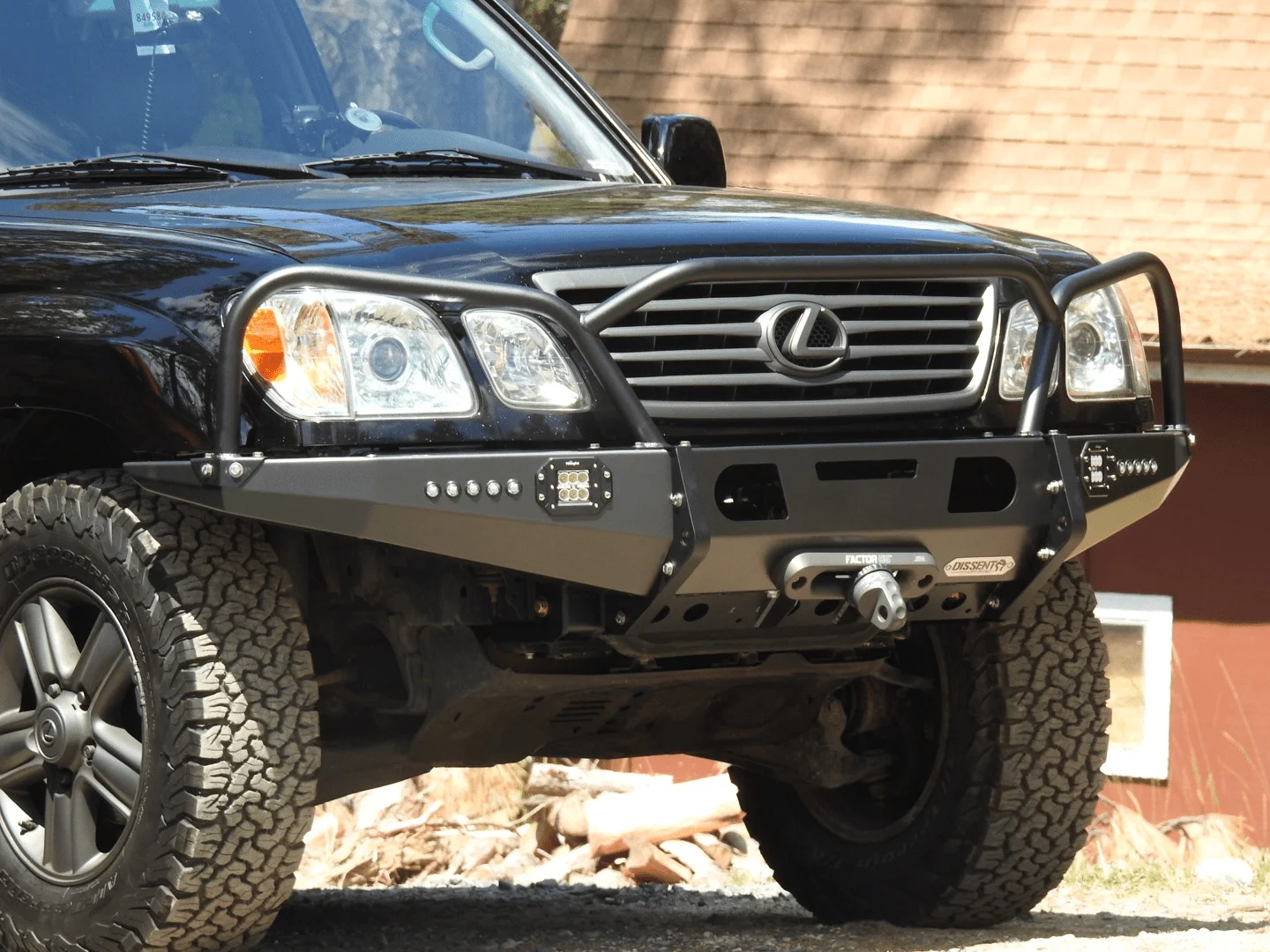

I like the Dissent bumpers/skids quite a bit. I wonder if @benc will offer up a deal if I go all out on aluminum Dissent gear at once?

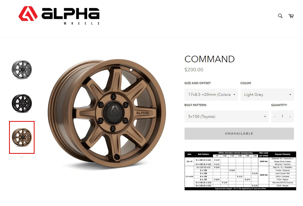

The rig comes with fresh Cooper AT3 tires, but they're 32". I like 33's for summer highway and trail driving. 17" wheels would also be better for trails. I'm not in love with the Lexus wheel's style and would prefer something with a slightly more flush offset. The Alpha Command wheels have my eye and come in a variety of offsets.

Those Alpha wheels have a fitment issue in the ideal +35 offset. For now you can do +35 or +15 but both need a spacer to work. They’re planning to reissue a 100 series wheel second quarter this year with +25 offset, you’ll notice 100 has disappeared from the page you showed above.

Great to know about the Alpha wheels, thank you. I thought previously they had 100 series listed, but didn't give it much of a second thought when it wasn't showing now. Brake caliper clearance issues or what? Just read your link. Hub clearance issues, got it. I'm hoping they can correct it early Q2. I need to get all geared up before HIH in July.

Excited to follow along. You've got the best year, best color, and best version (LX) so this should end up pretty epic. It just looks so pedestrian with the running boards and stock wheels. Where is the auxiliary battery in your truck? with the AHC I have not found a good spot for a 2nd battery yet. Are you going whole-hog on the Dissent front bumper and getting the bull bar too? Good choice on aluminum!
