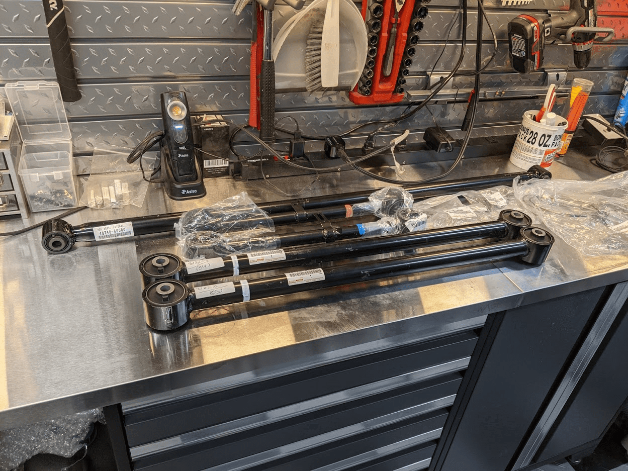

Rear control arms install complete! Took somewhere around 2 hours total with a significant portion of that fighting the new lower arms back into place. Lateral arm and uppers were real straightforward. I did the swap with AHC in L - unsure if that helped or hurt. I did not lift the vehicle off it's own weight. Service manual says to do so for the lower and uppers, but I didn't find it helpful.
Will report back soon on how the ride feels.
New rear bushings ride report: Meh.
It feels more supple and solid pulling out of/off of my driveway curb, but on the road the differences are minimal. I had hoped for more. Some of the bushings coming out were showing large cracks, but none were obviously loose on the bench. I've replaced truly "dead" bushings and these were definitely not dead, but they were showing their age. Less old rubber is always a good thing so I'm glad I made the swap, but I'll continue to hunt down opportunities to reduce harshness at 25-45 mph. I suspect my E-rated KO2's might be the majority of the harshness I feel.
Here's some eye-candy of the new arms:

Those new arms are gonna look super crisp. What was in the decision for doing the entire arms vs pressing the bushings?
Mine had 7+ years, and +30k miles, on yours, but the biggest difference that I noticed was that I lost a little rear “wiggle” or “slop” in (20mph+) curves. Before the change, there was a feel of a slight delay in the rear following the front, followed by a light thump/thunk.
It also smoothed/quieted low speed bumps a bit, but to a lesser degree.
Yeah, I think that's a good way to describe the difference in feeling. A little mellowed and less tail wag.
In a word, time. I got all 5 carefully replaced in about 2 hours. Had I done the bushings alone, you'd probably have to triple that figure.
Also, the Toyota bushings are quite expensive. It's not a huge jump to just buy the arms. Plus now I can screw around with the old arms on my own time and perhaps sell those to recoup costs.

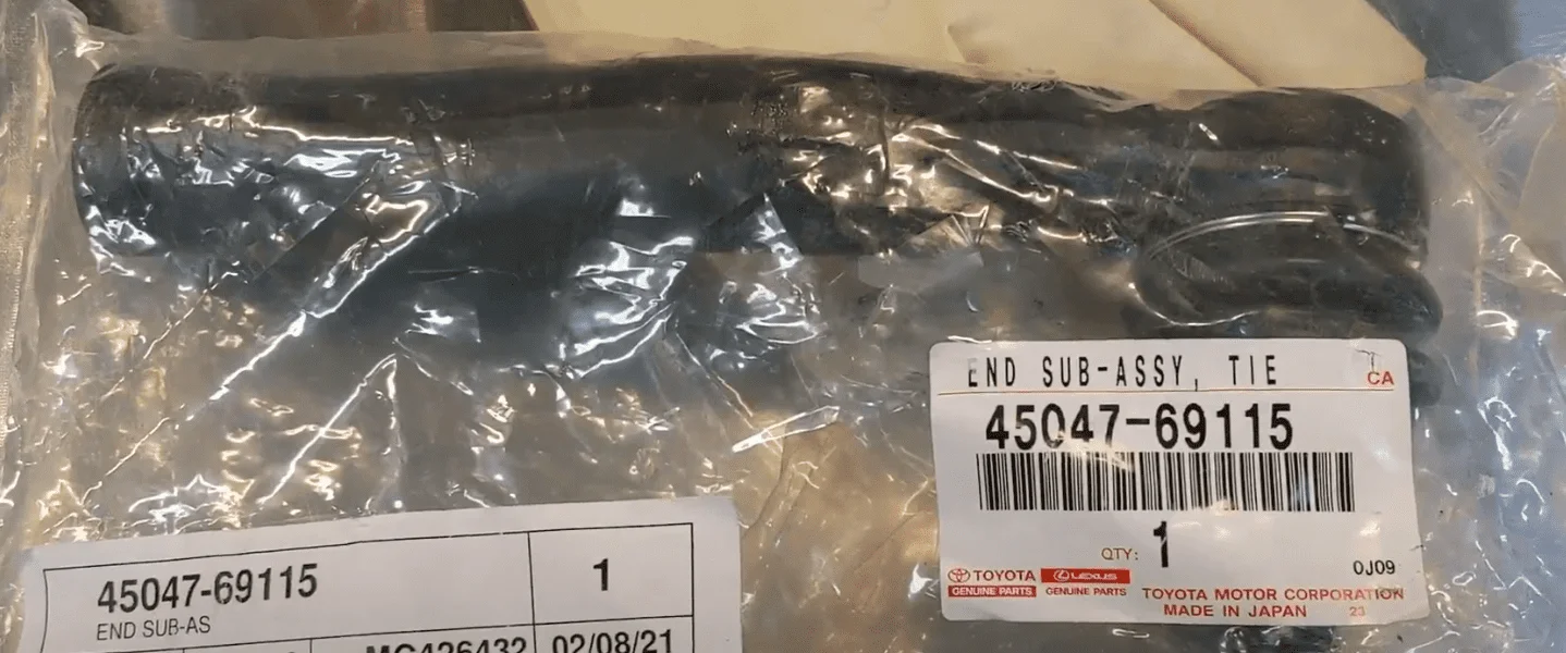

Replaced driver's side tie rod today. Quick job. 60-90 mins start to finish I think. Old one had some play. Hoping this will tighten up the on center play in the steering.

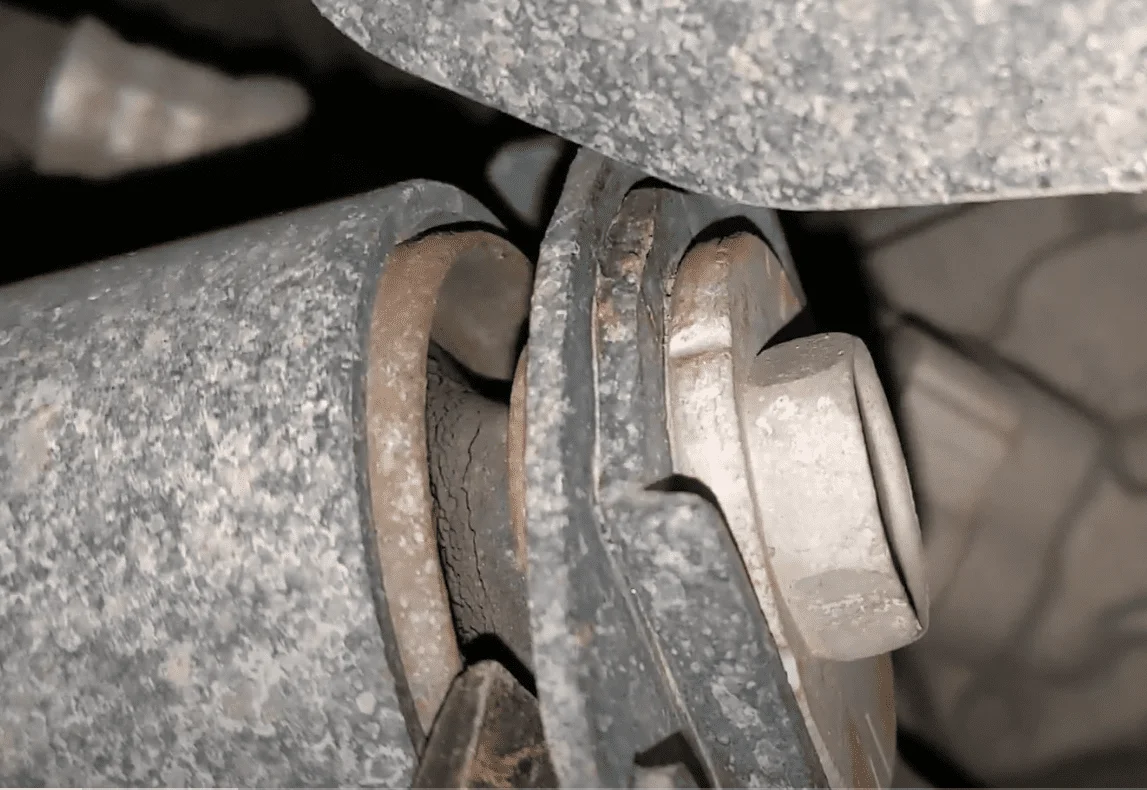

Also took a good look into the UCA bushings up front and they're dry and cracked. I'll likely order up new arms from Impex for the UCAs. Maybe LCAs and that lower bushing as well. Trying to freshen up all the rubber bits I can to really maximize the comfort level on this thing. It's good (better than my 99 with stock conventional Toyota shocks), but I know it can be better.

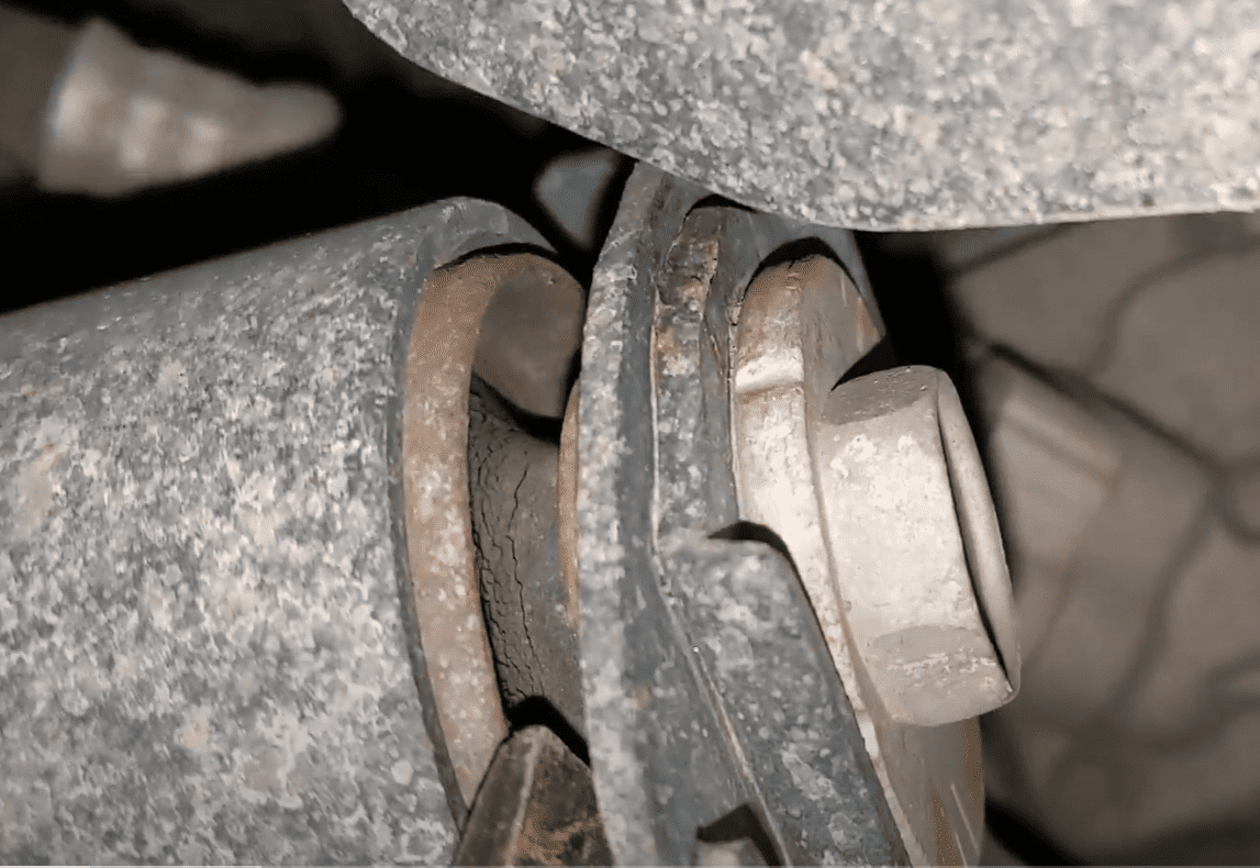

Wow! That's good to hear. I was surprised how worn those bushings were. Here's a still from a video I took. What do you think? Noticeable difference expected if I replace that?
Absolutely! These bushings together with BJs filter all the feedback from road imperfections, way before the shocks and springs can do anything about it!
I mistakenly went with Nitro UCAs with the poly bushings and uniball type bjs. While I liked the extra caster and the tight front end, they just transmitted too much feedback to the cabin. I understand Nitro has changed their design since then.
Once I installed the OEM UCAs, even with 2"+ lift the ride has been way better!

That's great to hear. My conclusion after seeing those UCA bushings was that new ones would help quite a bit.
Agreed on poly bushings. That's a silly thing to add to a 100. Or really any non-race car. Not even Ferrari, Lamborghini, Porsche use anything other than rubber in those bushings - on their $250k super cars. The exceptions being the cars they sell as..... you guessed it: racecars (Ferrari Challenge, motorsport versions of the Porsche GT line, etc...)
Poly is popular in the aftermarket because they're really cheap to make and can be made at home (or in an industrial setting with very little tooling investment. It's an easy item to sell as an "upgrade" and sell at a high margin. I'd like to see poly bushings marketed more truthfully as "Harsh Plastic Bushings". :) I suspect they'd sell far fewer.
At any rate, I'll put the UCAs at the top of my future buy list. I've been spending like a sailor on this thing so I may have to wait a month or two before dropping another big parts order.
