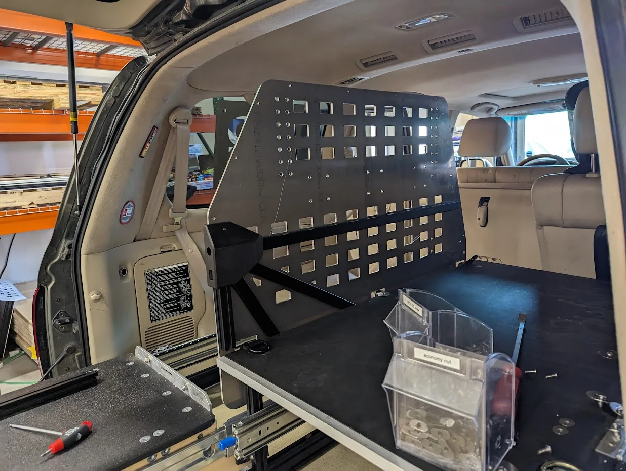

Anyways, here's a live update of the cargo area. Top Secret ADGU Kitchen Prototyping underway. Solid Aluminum is sooooo satisfying to machine....
Looking very COOL!

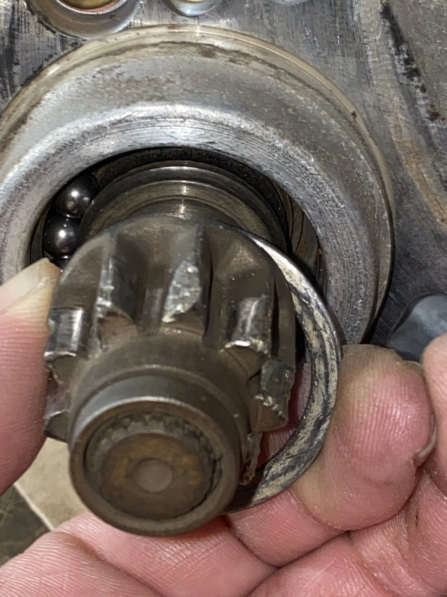

With below bad starter. We could hear a sound, like plunger! But sometimes it start others it would not.
This was from a 98LC w/250k, that had intermittent no starter issues for 2 years, before I replaced the starter. It had a remote start installed, before no start issue began. I suspected the remote starter had sometimes to do issue. Conclusion after pulling starter, was; Starter being engaging after engine was running. But will never know for sure. As it could have just been, a failure of the Bendix drive from age.
