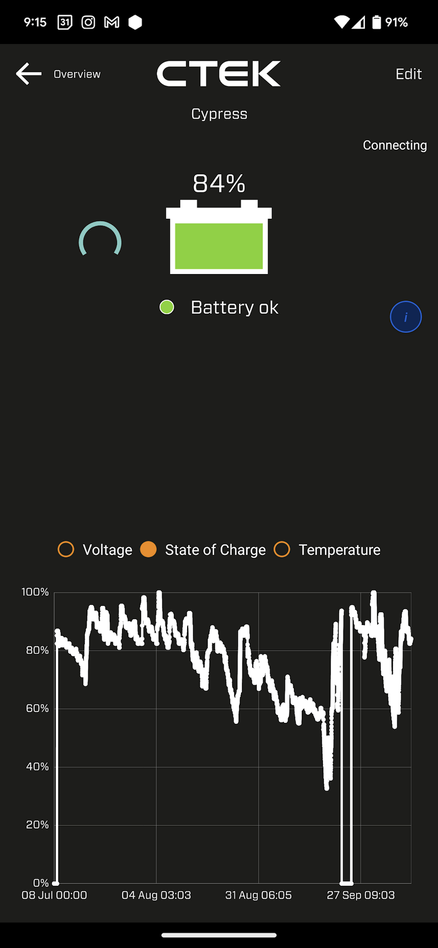

I have a CTEK battery monitor on the battery so I have constant data logs of State of Charge. The battery SOC was near 100% during many of the non-crank incidents so it seems unlikely the battery is somehow bad. I also was unable to watch the battery voltage drop so again, seems the battery is likely good.
Sounds like starter contacts, right? I'm thinking it's just barely good enough given perfect conditions. Since that's a big annoying job, I haven't dug in just yet.

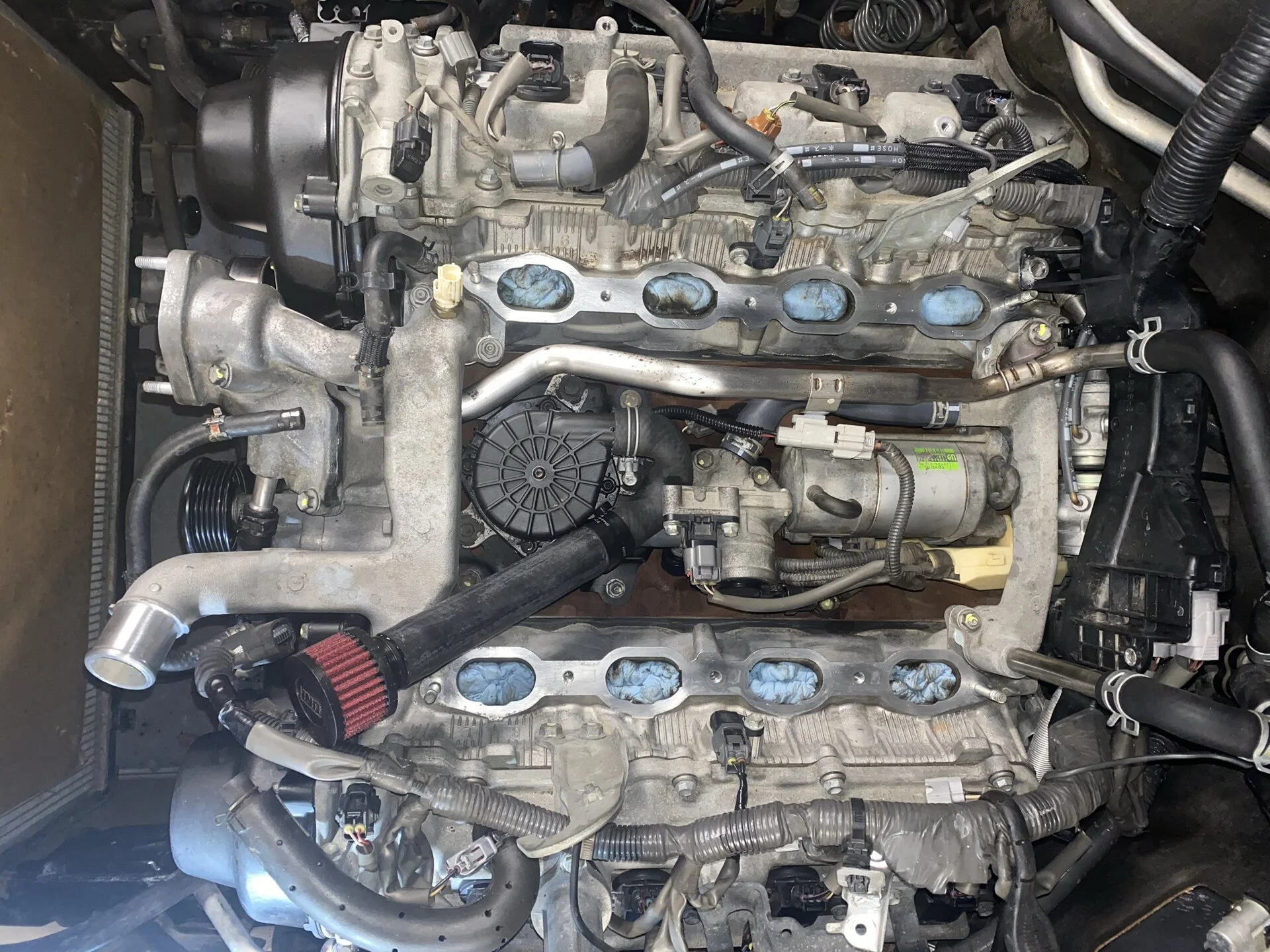

Whack or tapping on starter" is one of the best diagnostic tools I know of. It's never failed me, to diagnose bad contacts. Unfortunately the VVT intake manifold, makes reaching starter with metal rod, near impossible.
If we can get a "click" at no starter. This is much like tapping the starter. Both vibrate plunger contact washer.
There is another starter issue, we may get a click no starter. It's when the drive fails. Either bearing or locking clip, are the failures I've seen.
The start no start condition went on for 2 years, in this 98LC w/250k.

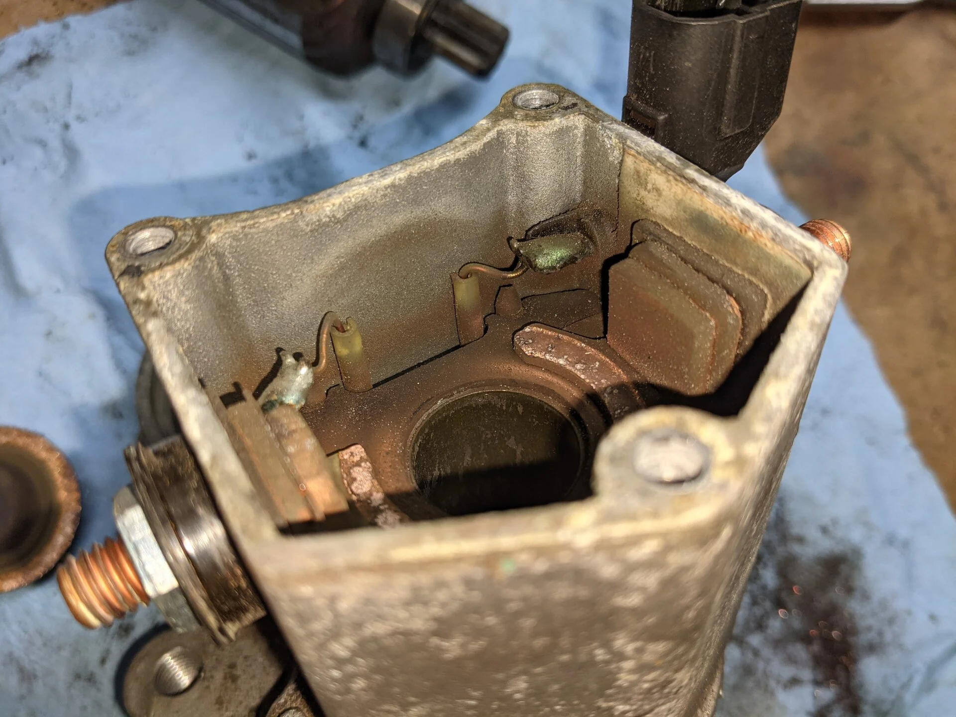

A few years ago, I was given a tip: "Reseat" the contacts in all reman starters. Adds time to service, but reduce chance of early failure. Which I do regardless if a Denso or Toyota Denso.
Toyota Denso, rebuilder has specific parts list that are required to be replaced. Denso it's at discretion of rebuilder. But in both, it's a person working to get as many per hour rebuilt as possible. Workmanship is second to speed.

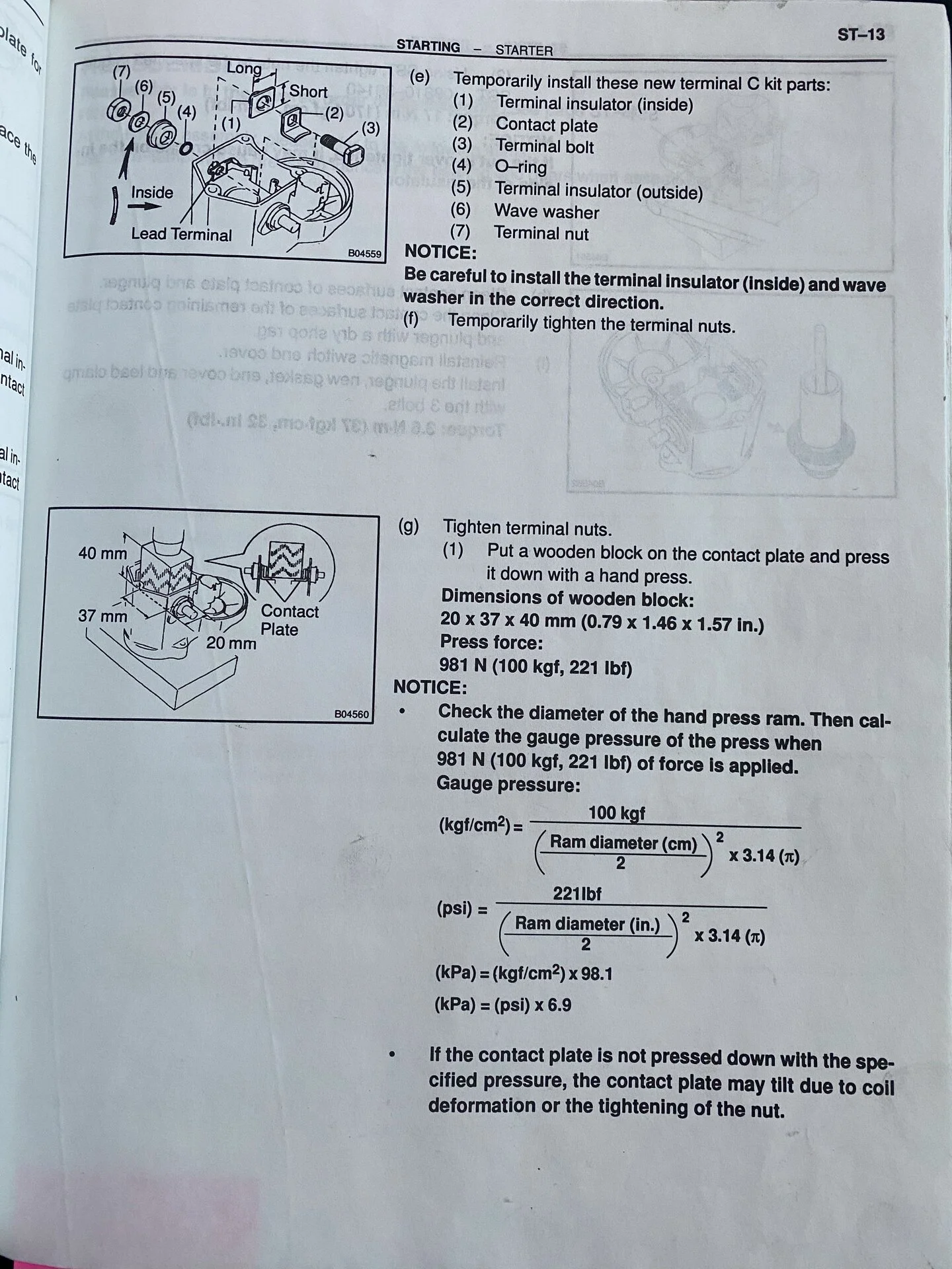

During the reseat, is it just a matter of allowing the contacts to settle in a more natural position? What exactly is being reseated? I've replaced contacts before, but never given it much consideration beyond "undo the nut, take old out, insert new, tighten again."
They're pressed down with wood block, then torque the nut(s) before releasing press. This is to insure contact washer of plunge, makes even (square) contact with both contacts simultaneously.
This is found in 98-02 FSM. Not shown after that, because solenoid is sold as assy after 2002. 03-up contacts are slightly different in size. But all require to be pressed in during assembly. If yours does turn out to be contact issue. The solenoid can be replaced with new. New solenoids do not require re-seating of contacts.
Difficulty is the nut. Toyota has SST for it.

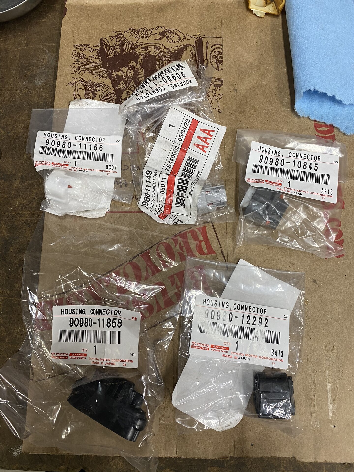

I keep these on hand. Use almost every starter service. Trick is to breakaway old brittle housing.

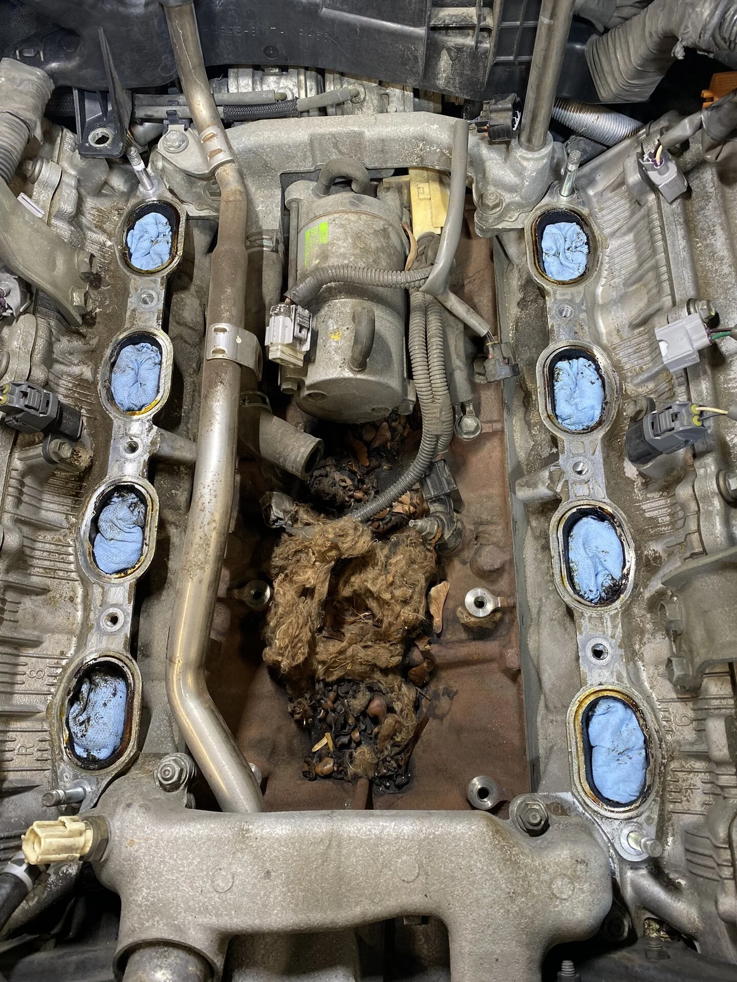

The 06-07 are a little more work to get at starter. The S.A.I stuff is in the way.
I always count on replacing the large S.A.I hose, as I cut old out.
I'll add again. This is a great time to do any S.A.I work. I do starters just because I'm in there, while doing my S.A.I filter mod. Also the water bypass gasket if any leakage.
Once I had 7 bad wire housing blocks. It was the record for a starter & S.A.I service on 4.7L VVT. Couldn't believe it! Local Toyota had all seven in stock.
Where a mask, if you find the nasty. Which I find so very often, Yuk!

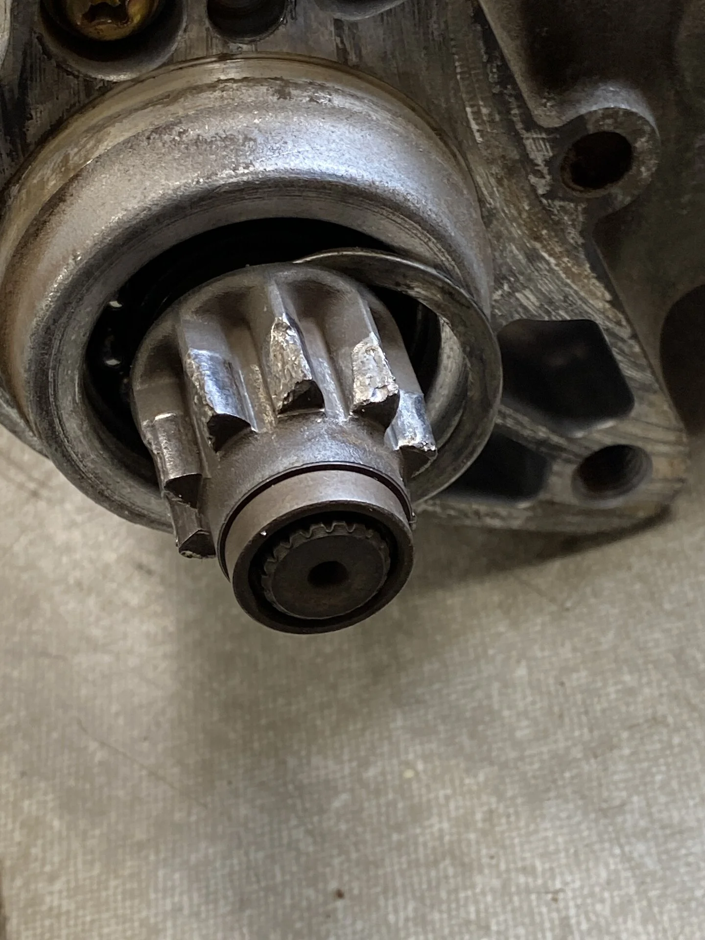

The starter annoyance continues. I think it's am mix of weak battery and bad starter. Today it wouldn't crank on its own, but did crank with a jump pack attached. CTEK battery monitor had battery SOC at 73%. 12.4V while cranking before the jump pack.

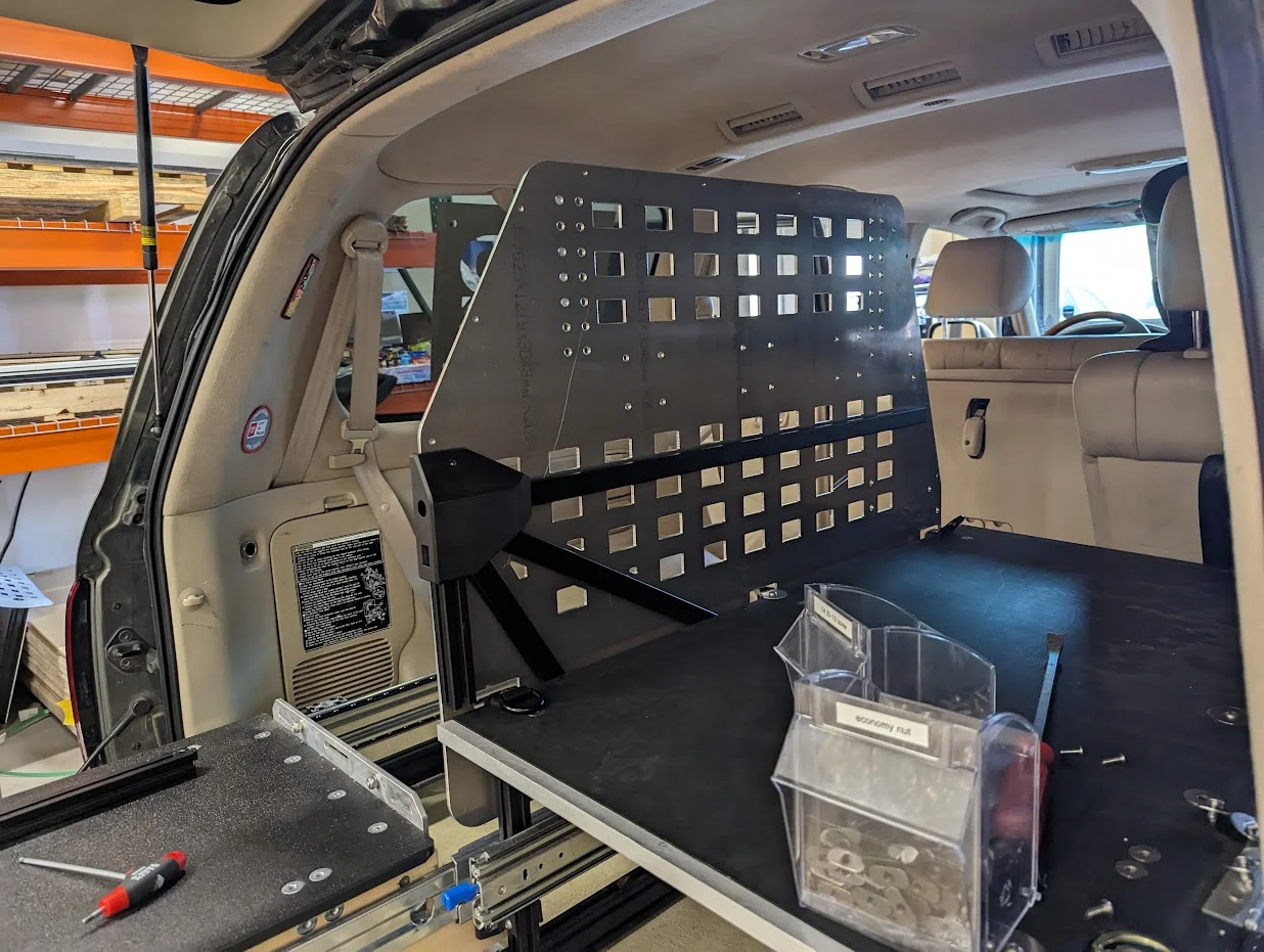

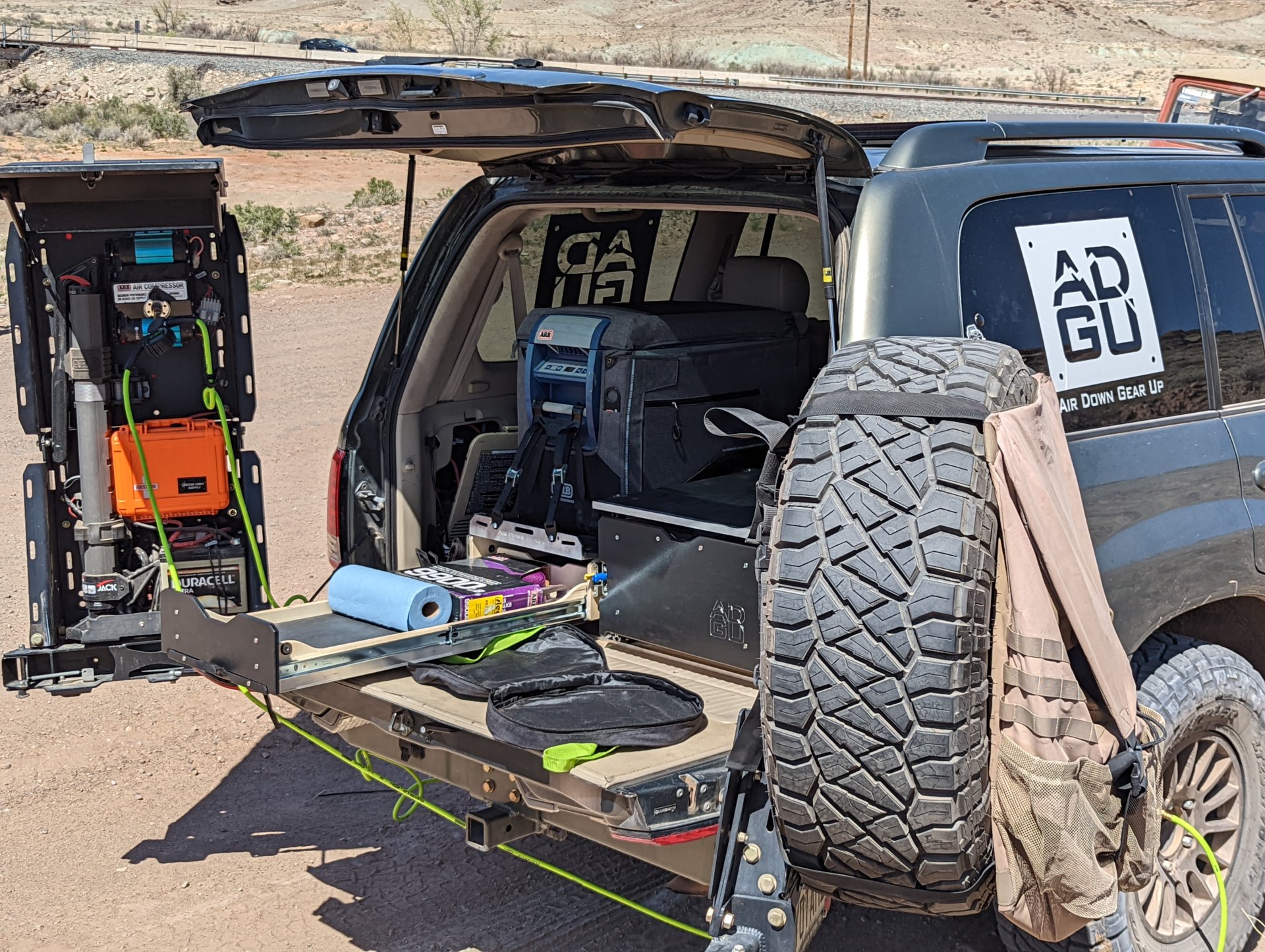

Anyways, here's a live update of the cargo area. Top Secret ADGU Kitchen Prototyping underway. Solid Aluminum is sooooo satisfying to machine....
