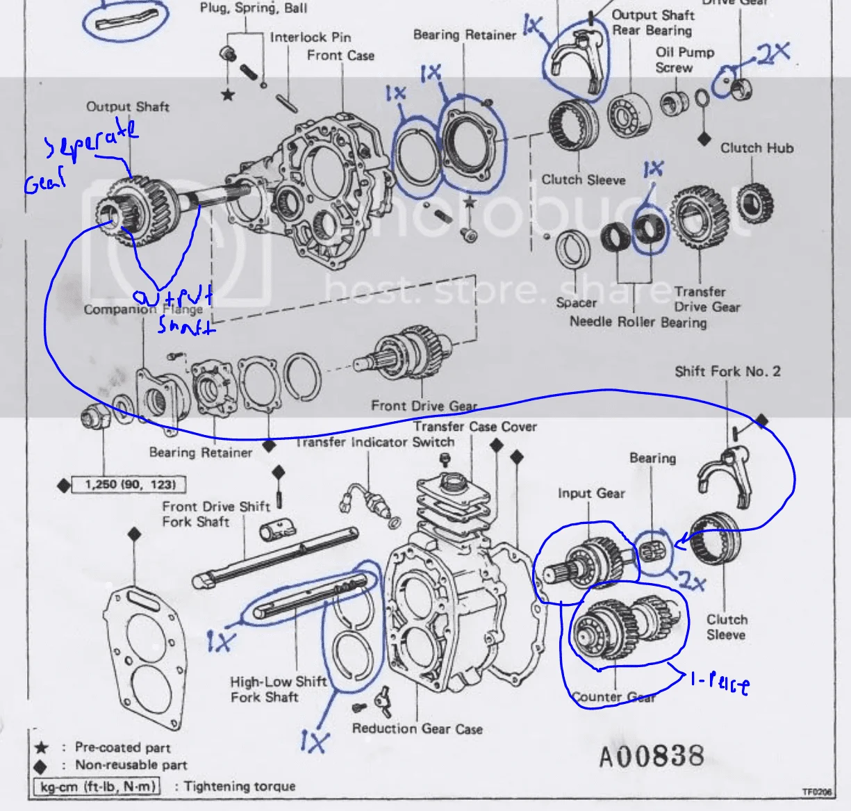

If I could get just the output shaft, I would totally do that. If I did do that currently, I would be throwing away all the things in the toybox besides the output shaft and the toybox to t-case adapter. I just spent all this money on the new drivetrain to get the toybox, and I would then have just a few parts that I would no longer need. I really wish that I could have gone that route, but I can't get the output shafts anymore which is why I had to buy the whole damn thing. I would have loved to run the current t-case that I have as well. An adapter plate seems to be pretty easy to accomplish, but we'll just have to see.

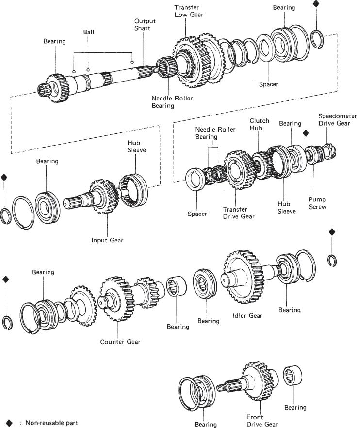

Just to clarify:
So if this above makes sense you can see that the input shaft is part of the input gear, but the output shaft is actually separate from the low range drive gear that rides on it.
The input is available in both 21 and 23spline in both 2.3 and 4.7 flavors new off the shelf.
The 4500 adapter probably used a sleeve coupler that was female on both sides.
The toybox input is unique in that it took the input gear which normally had a 21 or 23 spline male shaft, and it replaced it with a female that could except the transmission output.
-Mike
Just to clarify:
-Mike

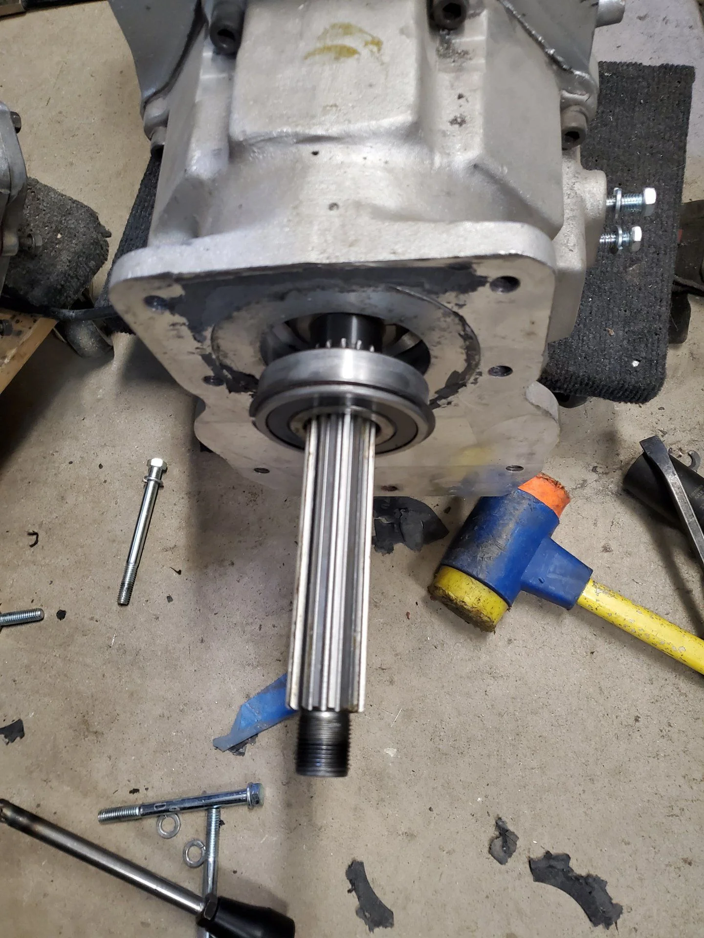

I'm planning on letting a professional weld this. I'm pretty sure the spud shaft is at least 5" long. I think that the stick out on the 4-speed transfer case that I was wondering about is the end of the spud shaft that mates into the transfer case.

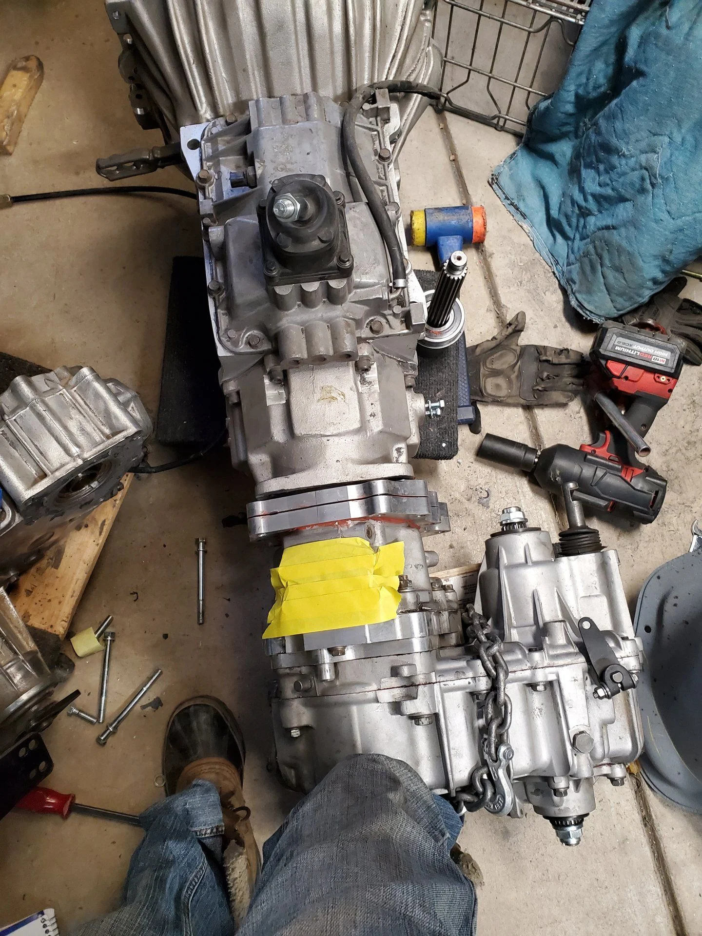

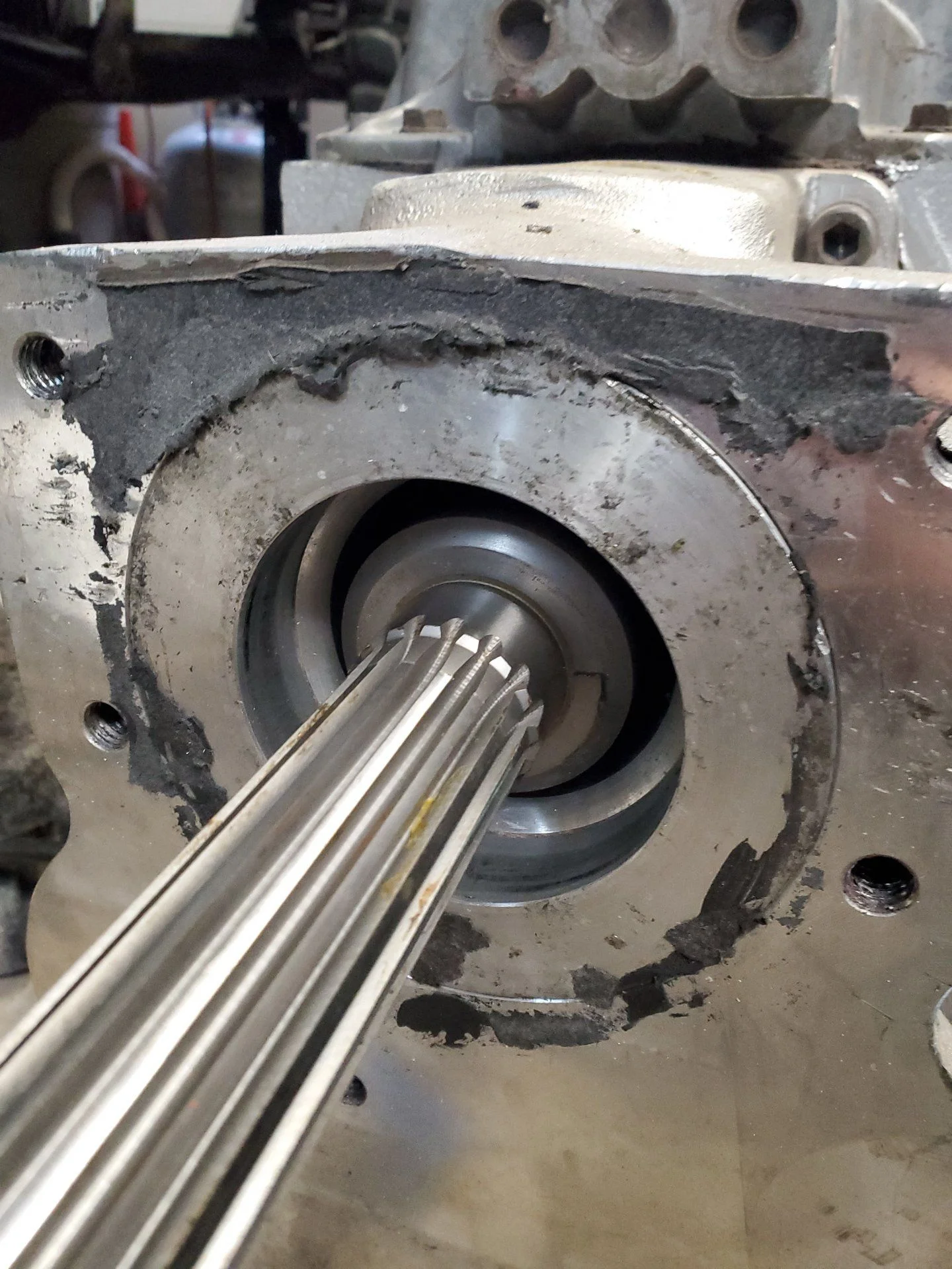

Alright, I took the shaft out from the old t-case just to look at it. The 10 spline is exactly the same, but the length may be a bit different.
It looks like there is plenty of surface area to just drill and thread new holes in the adapter plate. The way the shaft mates looks like I cannot make the adapter any shorter, but I think I can just use both plates and make the 8 bolt pattern that the SM has in the tailhousing.
The combo is really long. About 32.5" without the bellhousing. I may need to push my rear axle bax some more, but I should have at least a 17" driveshaft now. A lot shorter than I would have liked, but I should be possible.
