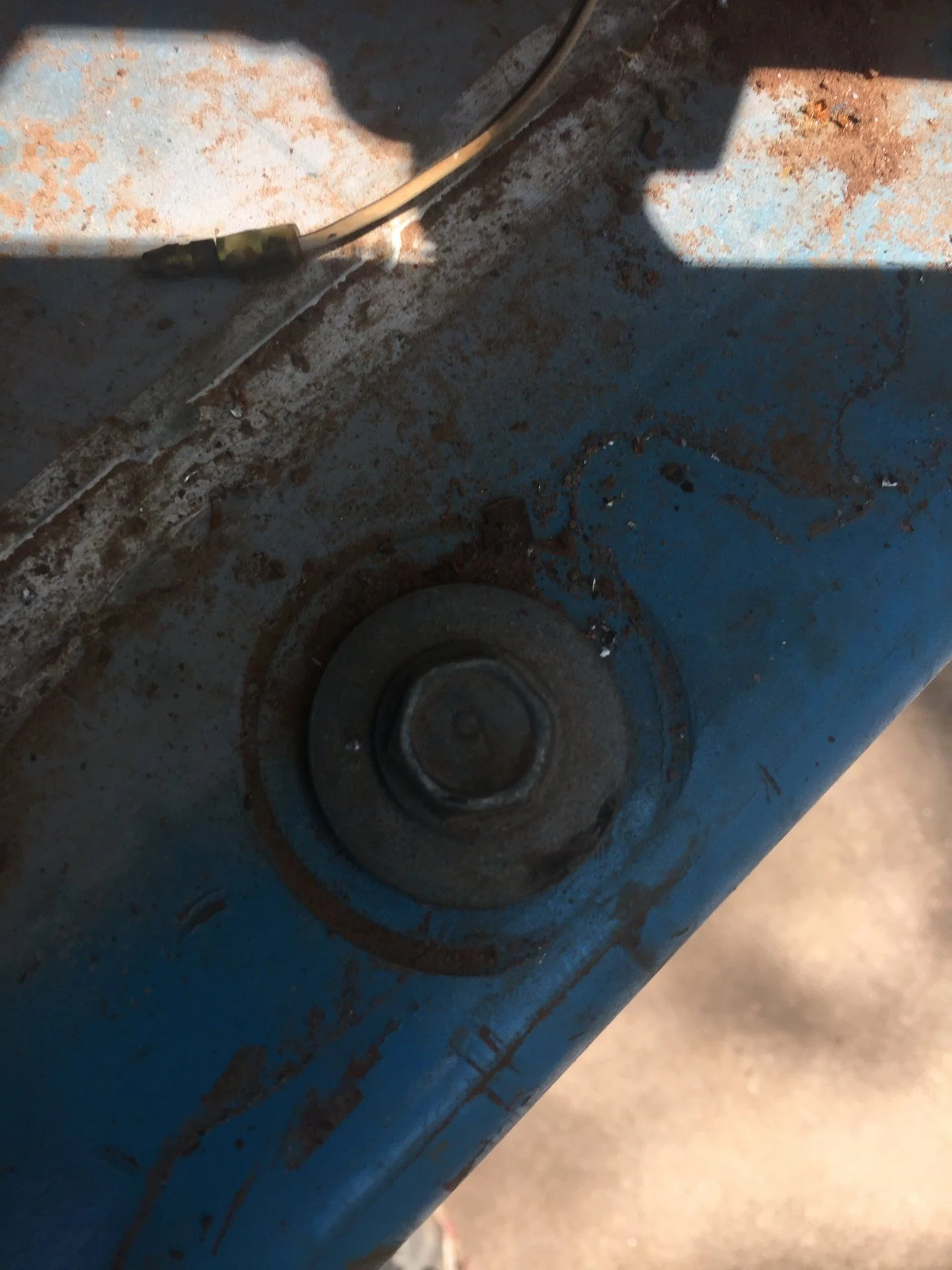

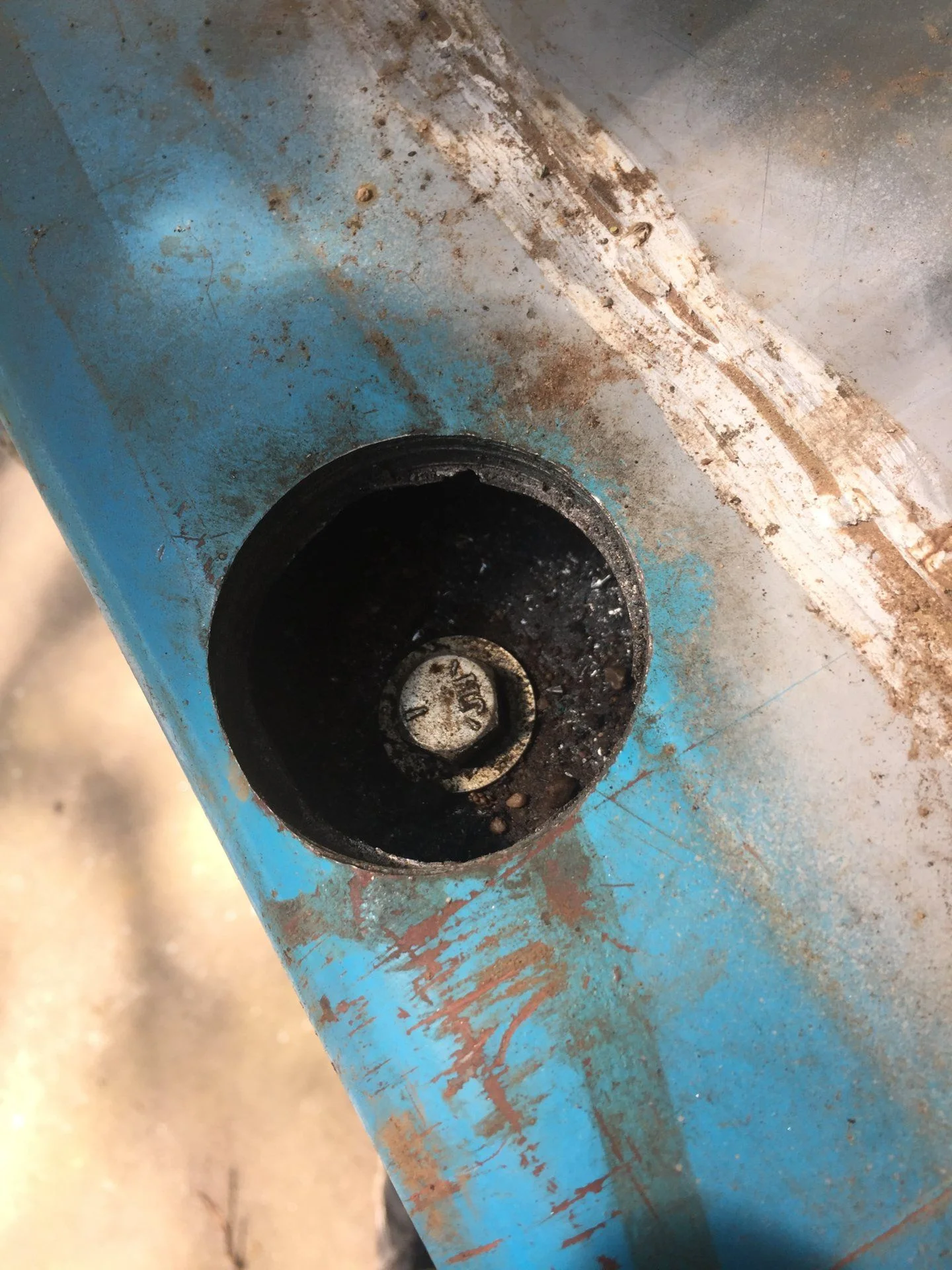

I would recommend using hole saw and recessing the bolts. I’ve done it on one side and need to buy another hole saw. Excuse the dirt I still haven’t cleaned up from my last trip.
How do you keep water/dirt out of there and maintains the doors? Or do you not run doors?
I have some 2” body plugs that I plan to use in those holes. It’s 1/4” tube steel so I’m not really worried about it rusting. Also the tube is open on both ends so I just run some water through there to clean it out.

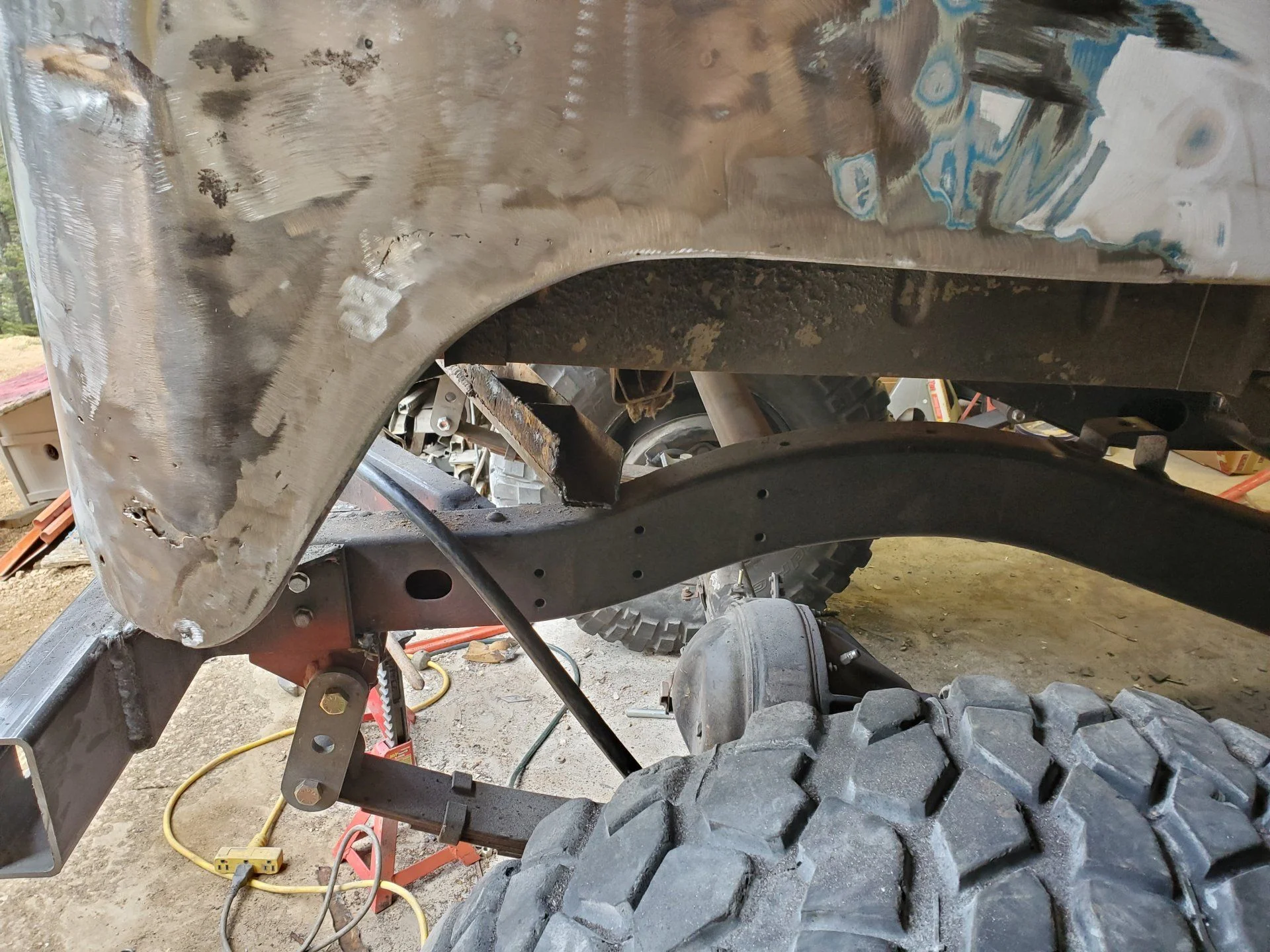

I got the other side wheel well finished.

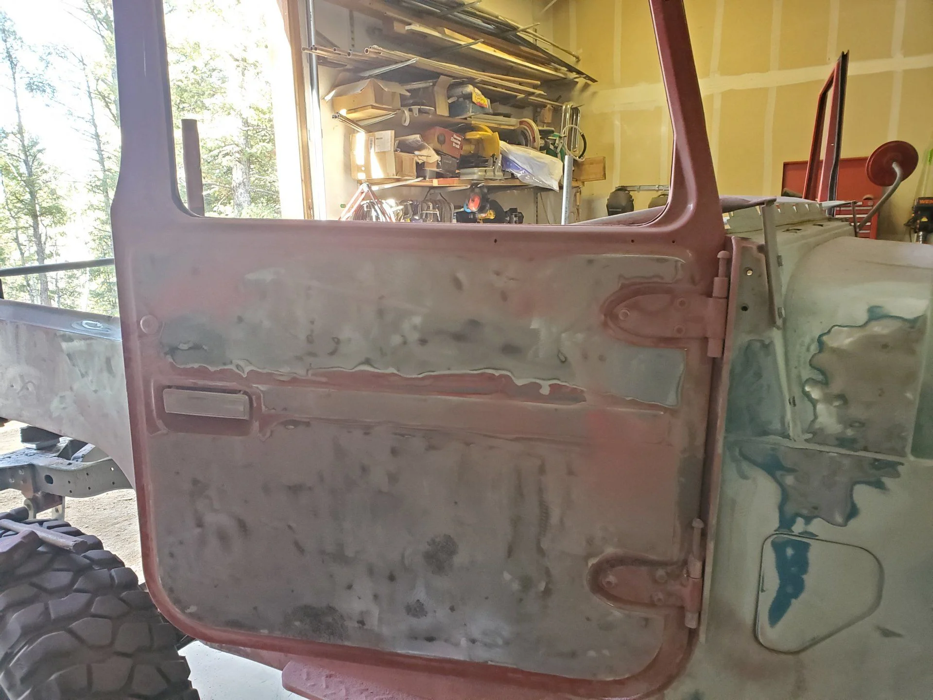

I also started stripping more of the body. A grinder and 80 grit disks make it a piece of cake.
The doors are in amazing shape. Very light surface rust in a few spots, but that is it. No dents or scratches in sight.

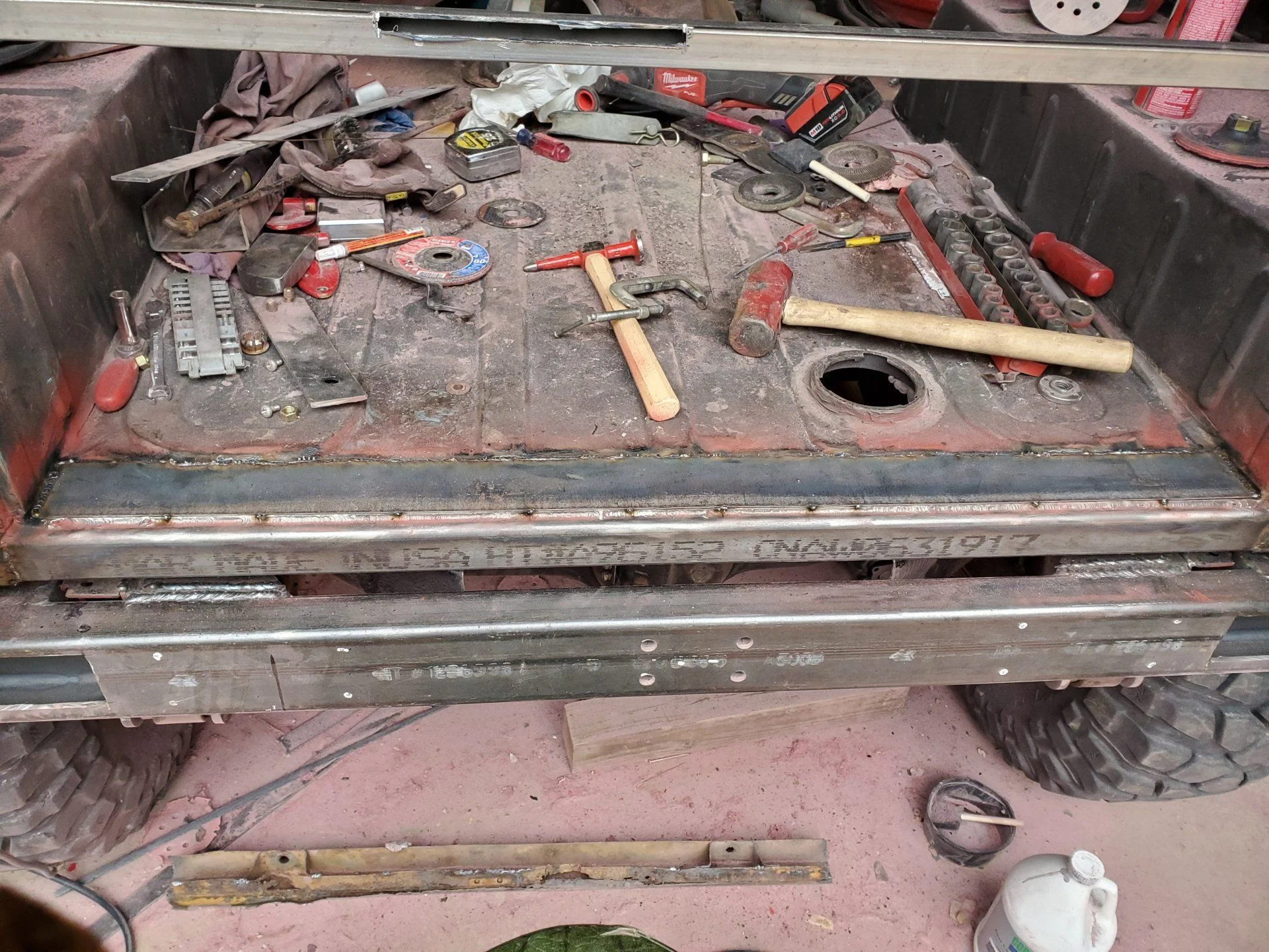

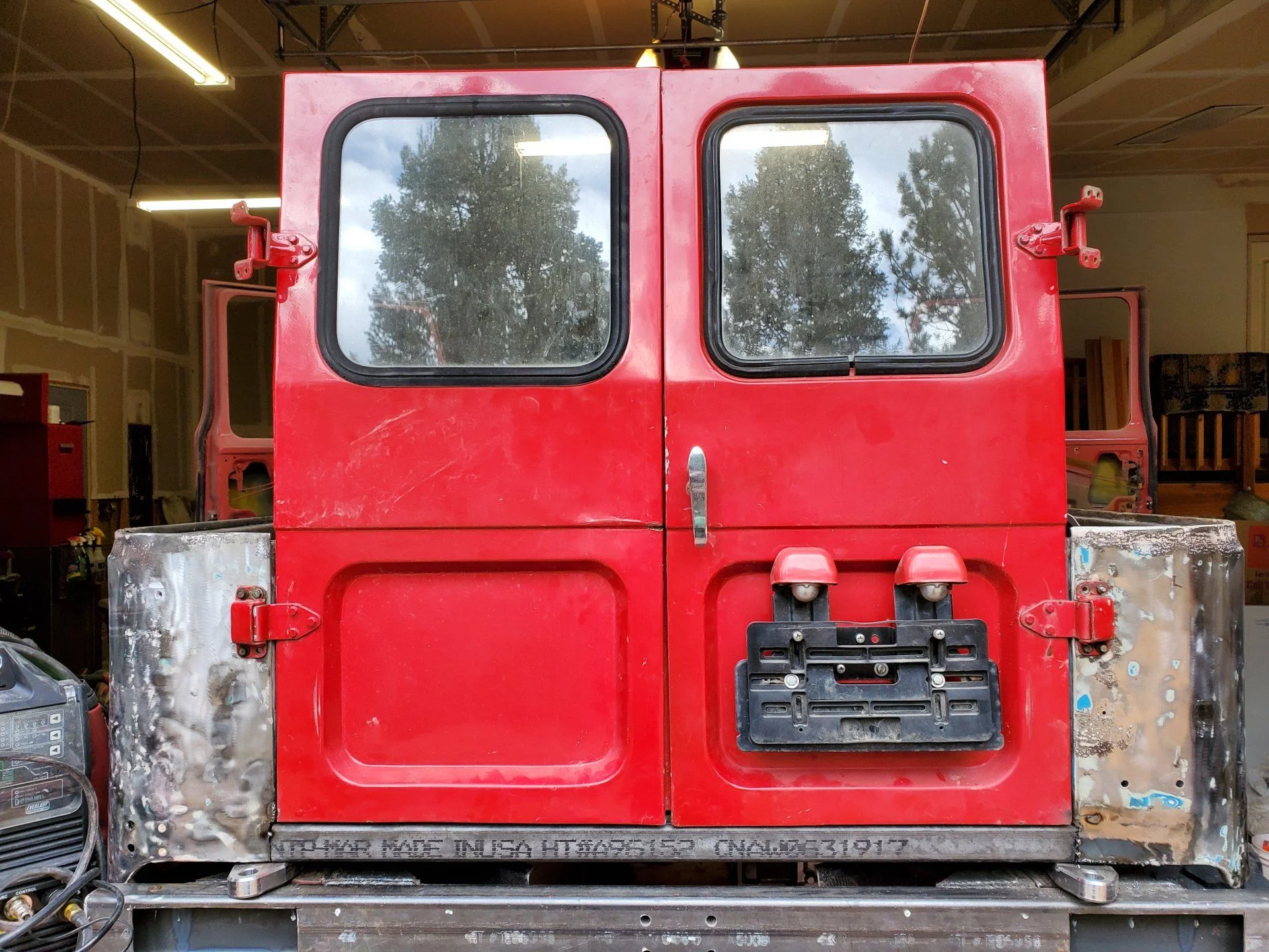

I am also in the middle of replacing the rear sill, so the ambulance doors are partially on for alignment.

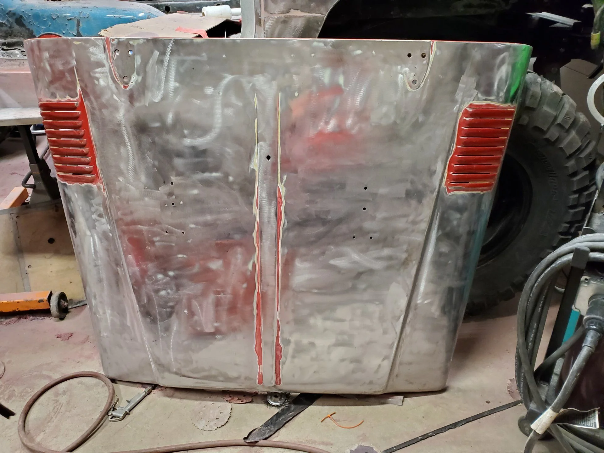

I also got the hood cleaned up. A few minor dents, but no rust or major problems.
View attachment 2294746View attachment 2294747

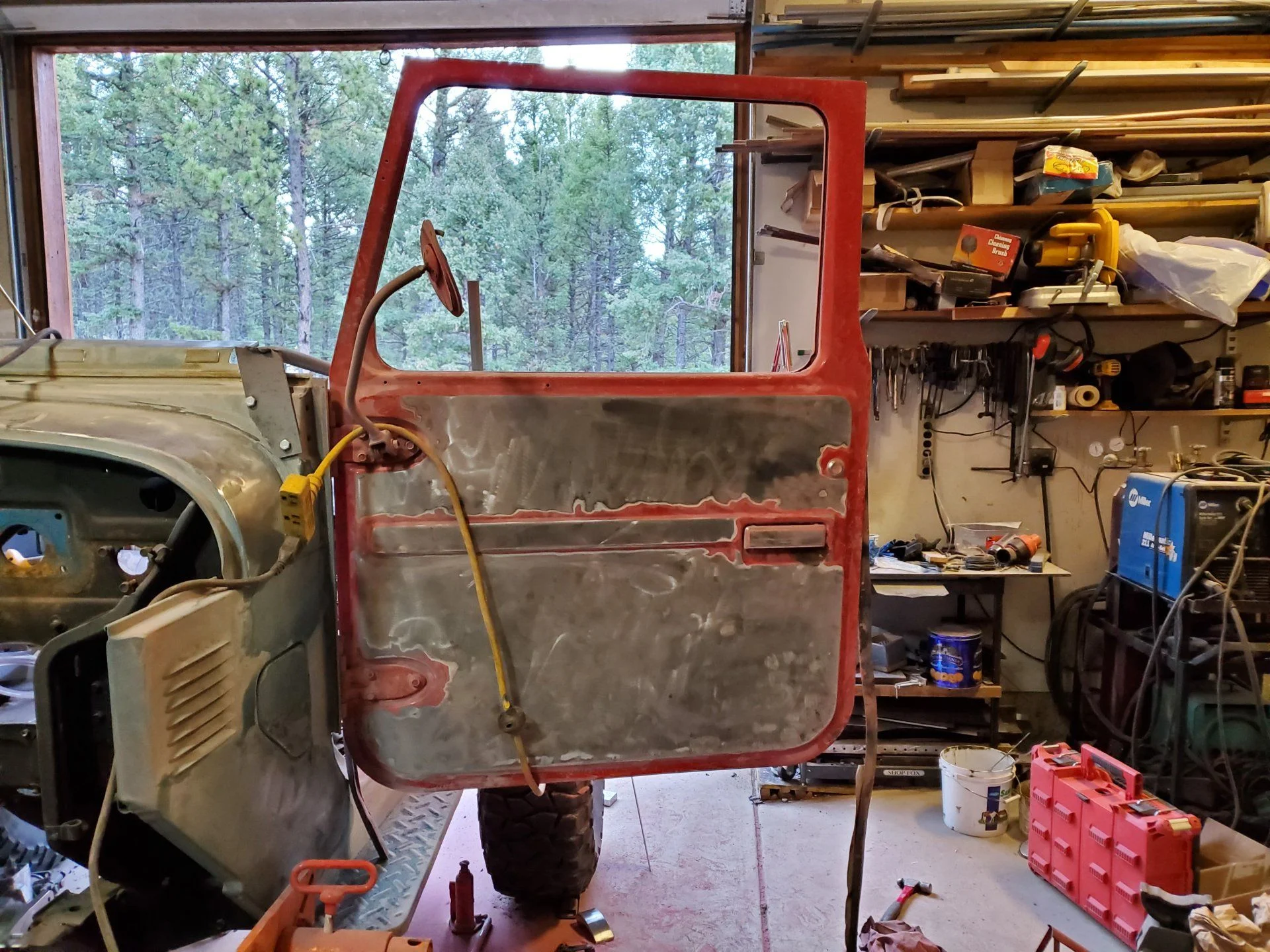

Be careful when doing the rear sill. The quarters can bow outward. Yours look like they may have slightly looking at your ambulance door gap. May have to ratchet strap back to 90 degrees and tack in a temporary brace on the top of the tub somewhere. Or maybe it's just the doors drooping since they only have one hinge. Hard to tell from a picture.
It's the hinges drooping. I squared the tub before starting on the sill to make sure I had everything in the right place. The tub is fully braced right now.

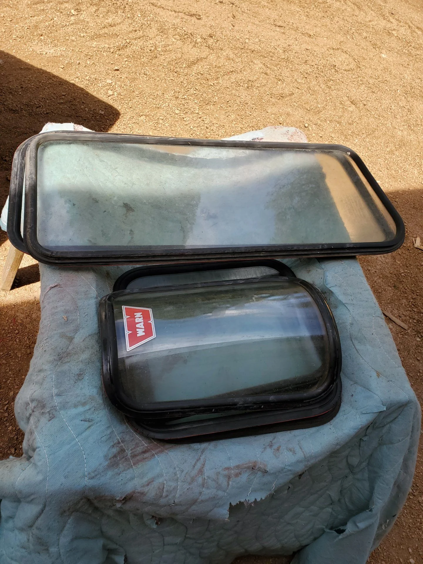

I pulled all the glass from the hardtop and the rear doors. It honestly wasnt too bad.

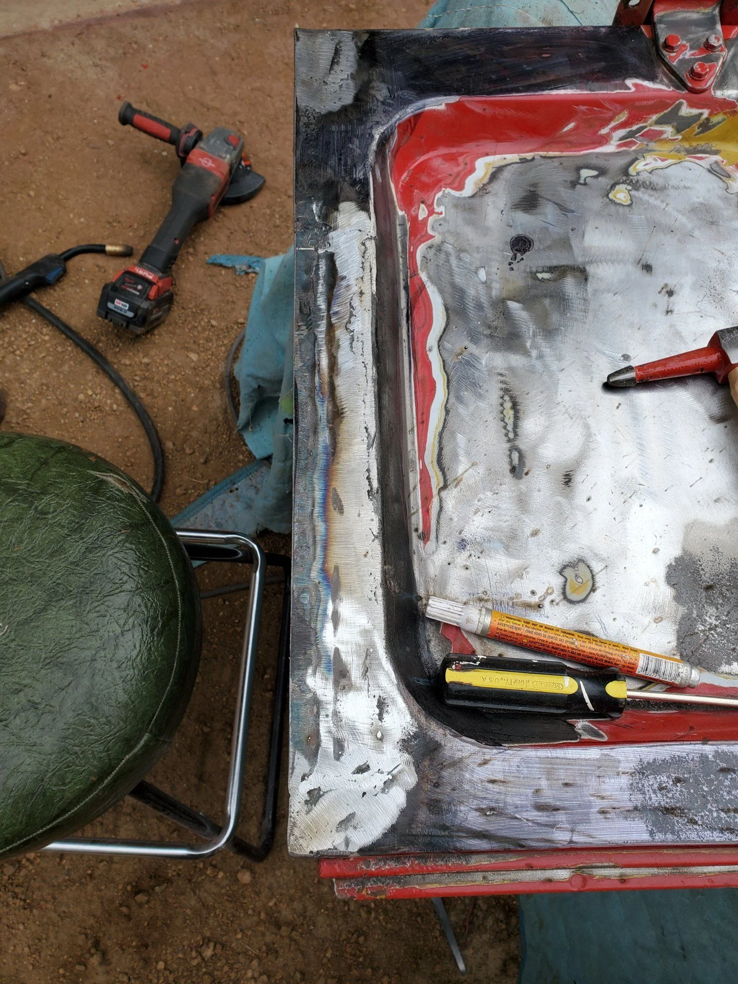

I also started stripping the rear ambulance doors. One went to South America to get fixed.
The other was mangled by a monkey with a welder.
The door attacked by the monkey was an easy fix.
The other side is going to be more difficult. Im not sure how I'm going to pull the dents with no access to bang on it.
I used eastwood's mig gun stud welder kit for pulling out dents like you're describing.
It works ok, the only problem is that you have to use vice grips to tighten the collet on the slide hammer enough for it to hold onto the studs while you hammer.
I guess another option is to just buy the studs and a slide hammer, and manually hold the studs while you weld them on.

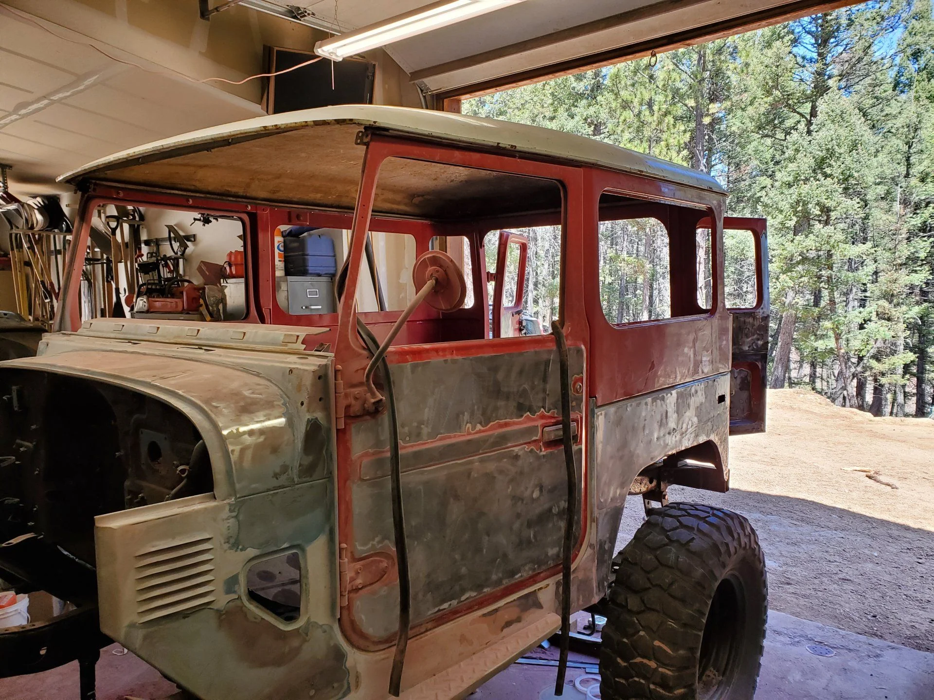

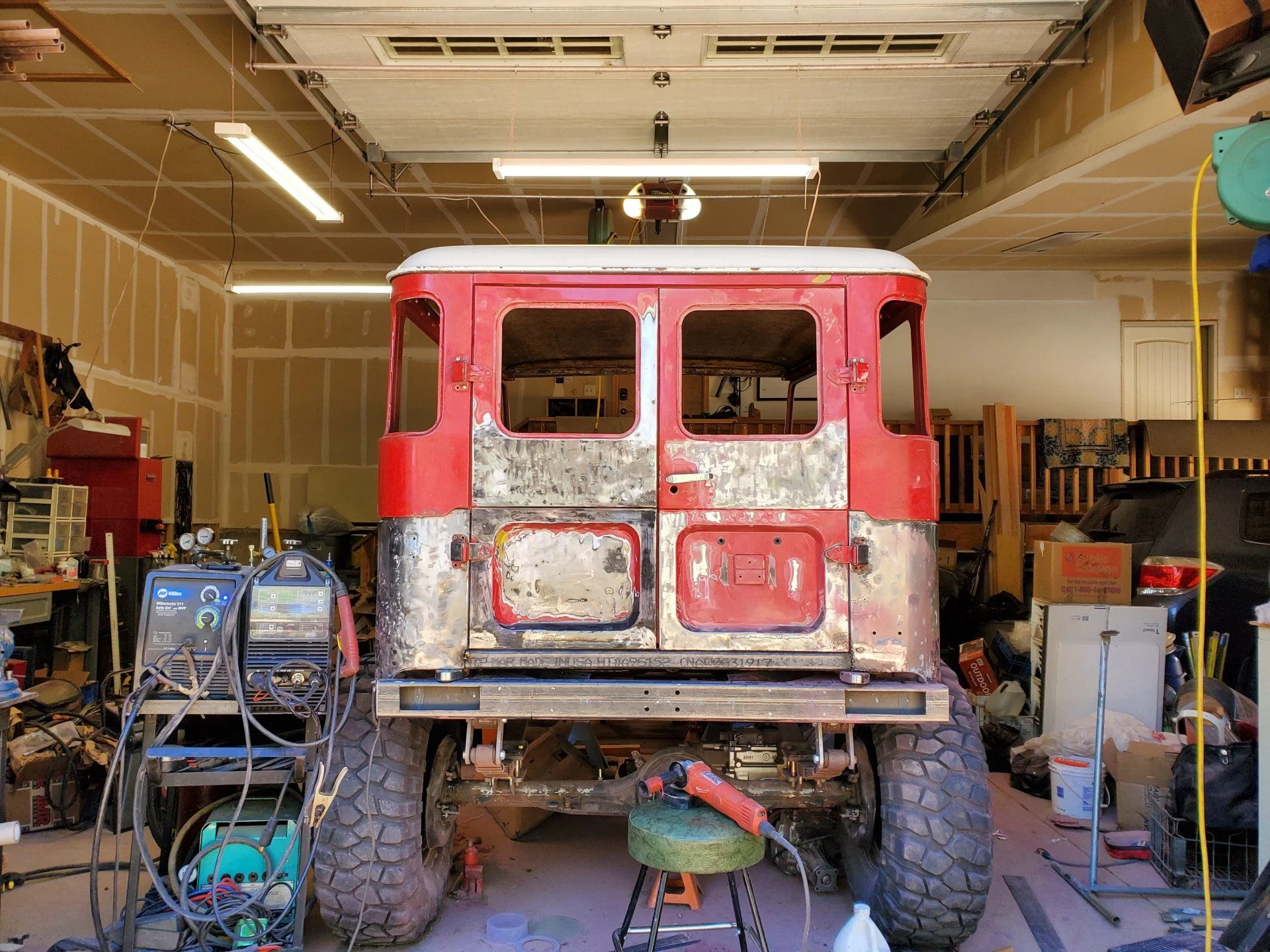

The top went on for the first time! It's really starting to look like a cruiser now.
The doors line up really well, which is great cause it's less work for me.

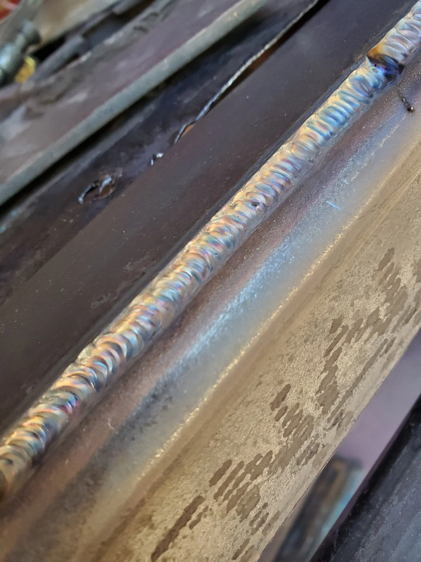

I started TIGing the rear sill together. First time doing steel, but I think it turned out ok.
Here is where I ended today. Going to tig the rest together when I get the chance.
