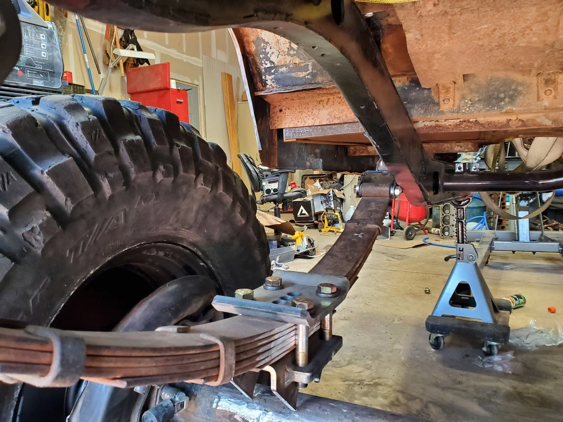

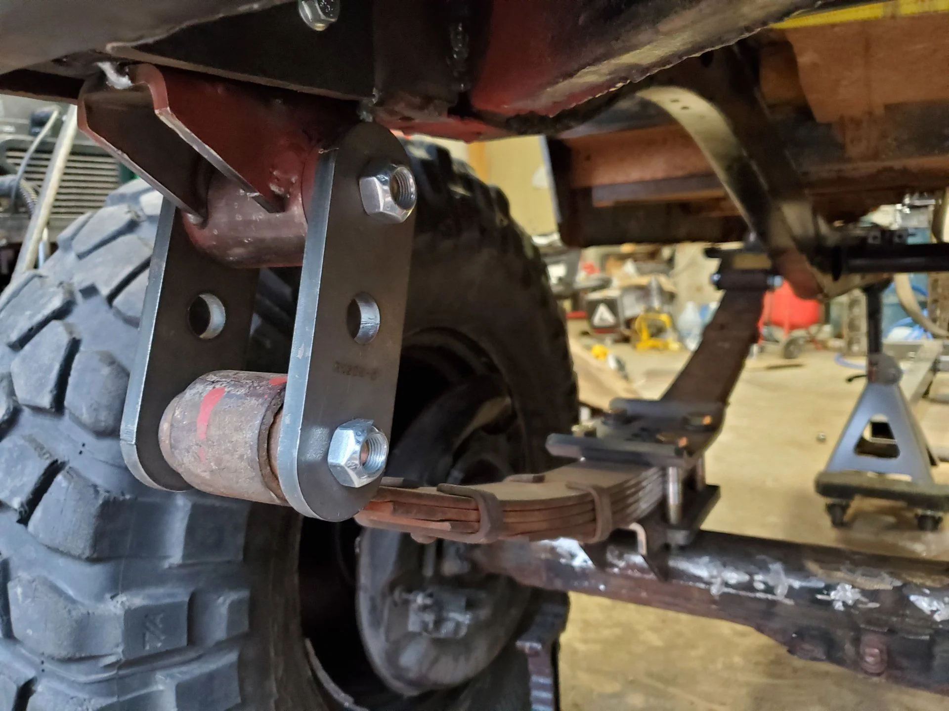

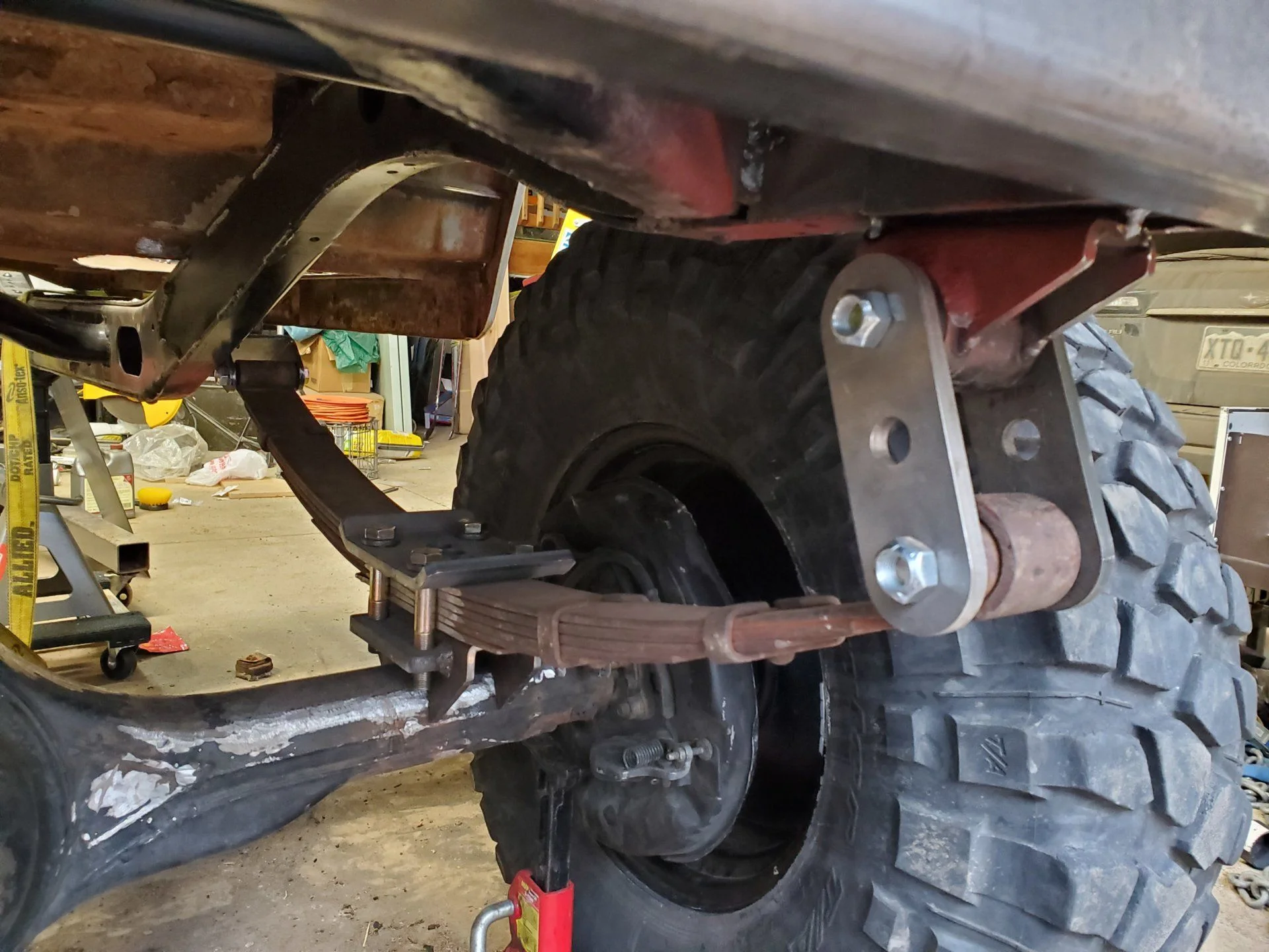

I think I'm just going to go for this, because if I move the springs up with the spring flip, they ride a lot flatter which is a lot closer to the stock suspension.
If I have to change it, I guess I will.
U could also ask @RustyNailJustin
He has leaf springs on his race truck and seems to have them well dialed in and might have some advice for u.

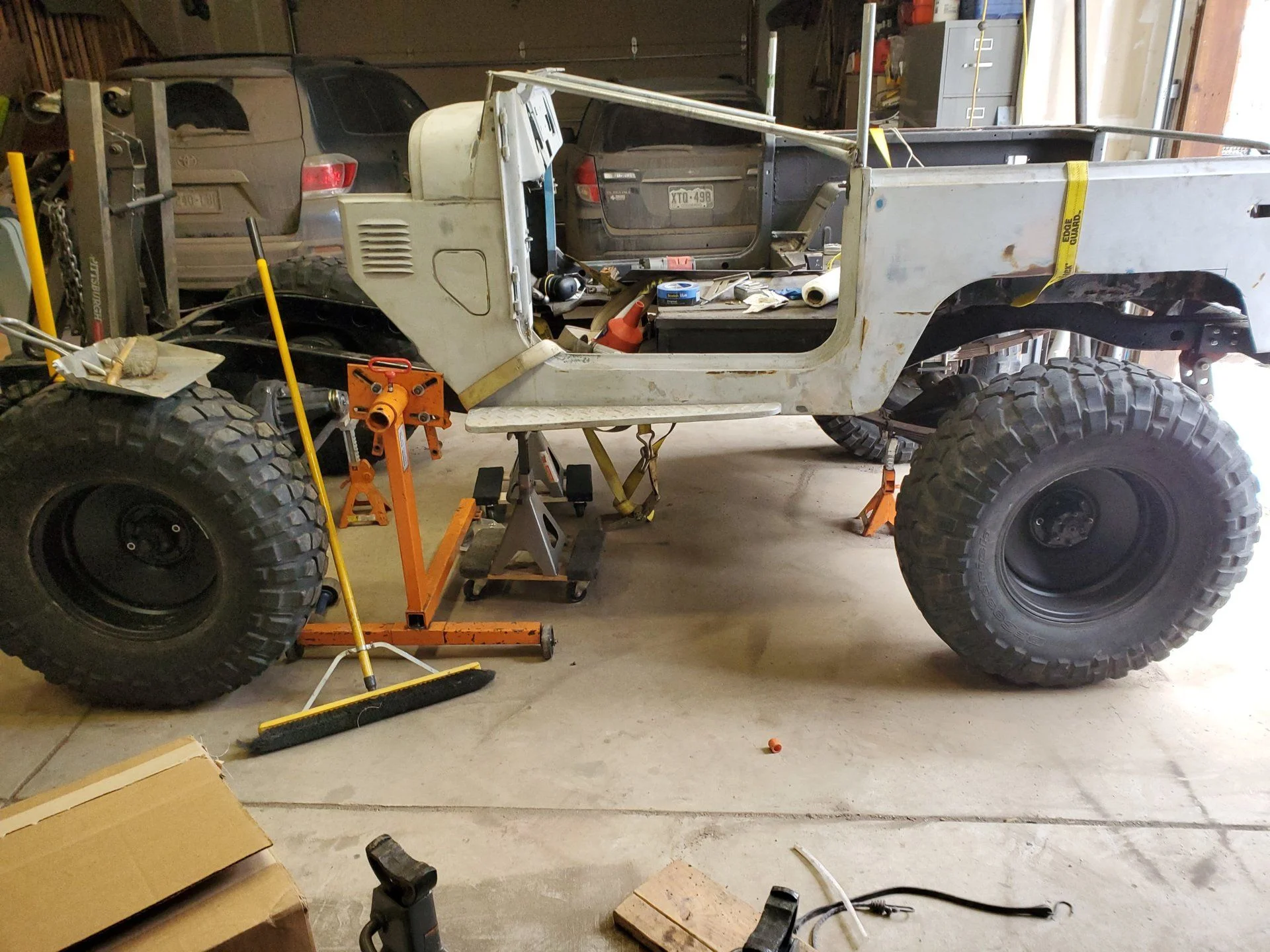

Well, I sorta just hopped in and tried to match the stock setup as closley as I could while trying to lower this thing.
Anyways, when I jump on it it seems to squish nicely. I got the frame height down to 25", so about .5" taller than I wanted. I'll take it. I hope everything will squish a bit more once the full weight is on.
I finally got the needle bearings, orings, and gaskets today, so the shop rebuilding that transfer case should have them on Monday.

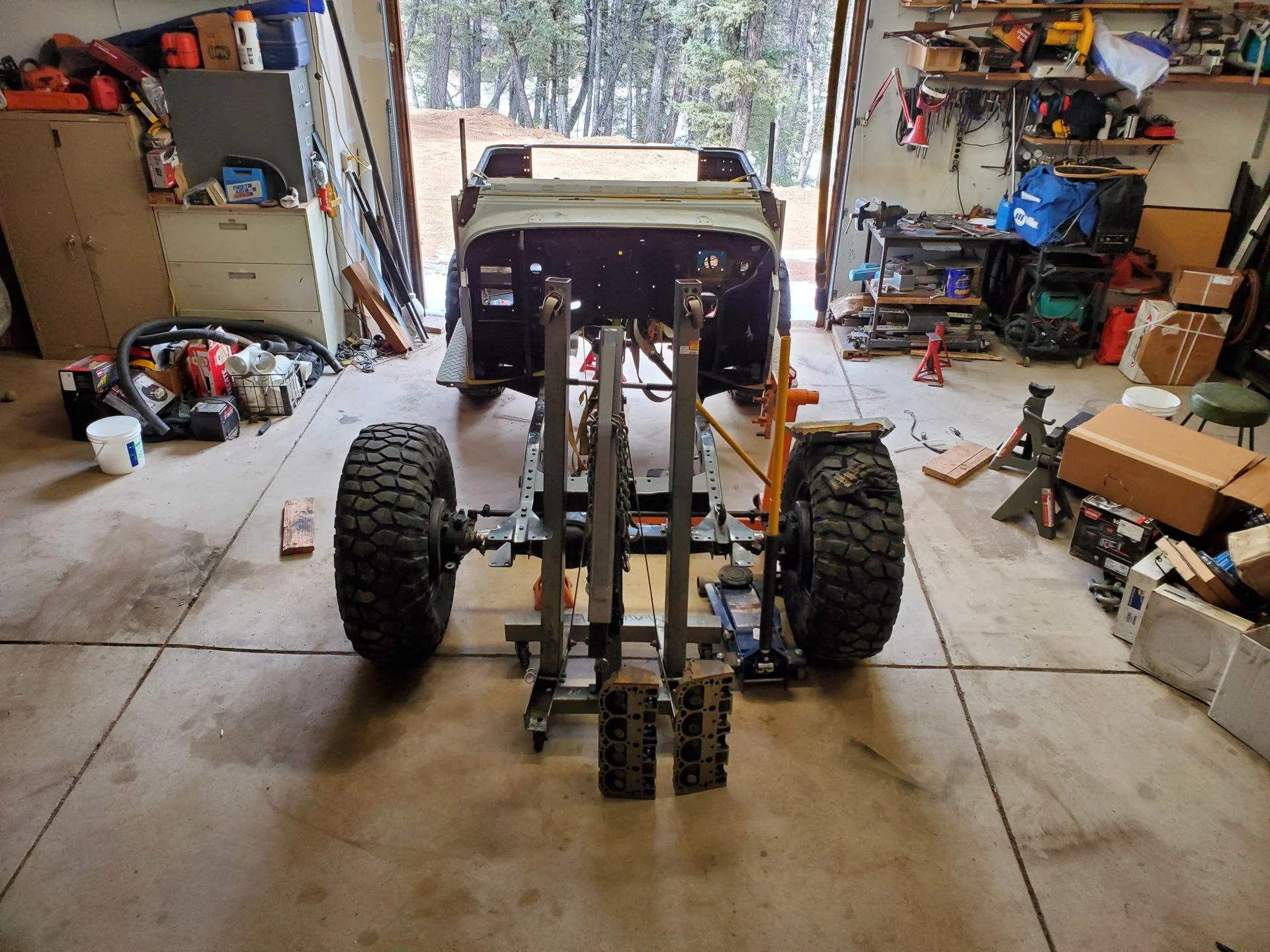

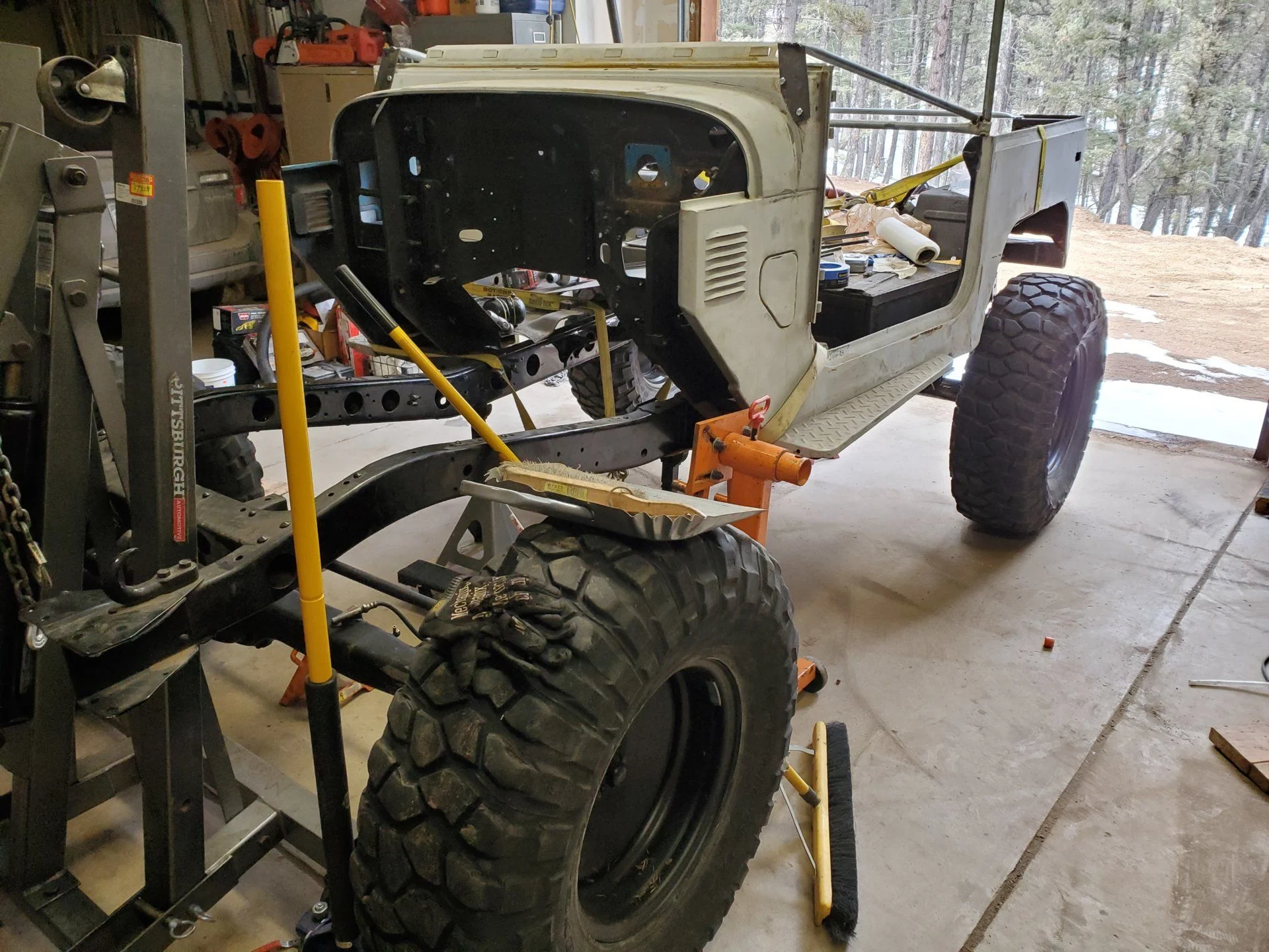

I haven't gotten much done in the past couple of days, but I did stick the front axle under the frame just to get it out of the way.
The current wheelbase where it is at is about 99"
@White Stripe what is your wheel base?
View attachment 2253278View attachment 2253279View attachment 2253280
I'm at about 96 I think. I only moved the front forward 2". If the front is stretched too much it is hard to make it look good with the front fenders. I personally felt 2" was a good look up front. If u want a lot of wheelbase you could always stretch it to a fj43 tub. I wish I had done that looking back. Extra interior space would be nice. If u have multiple tubs I would recommend it. U can get a fj43 factory soft top to match.
I've thought about doing the 43 stretch. I think it would be cool, but I would really like to be able to run a hard top without too much work. The extra space would be really nice though.

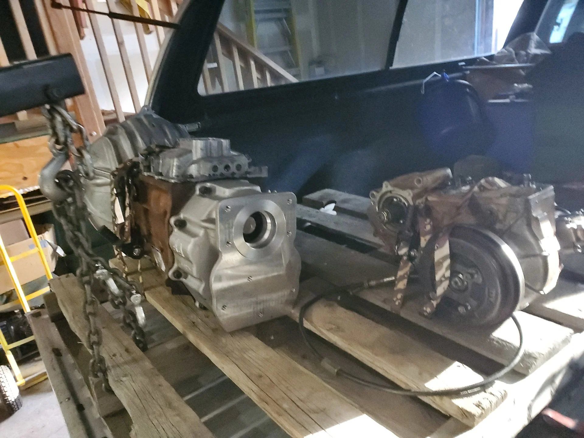

The transmission shop got the NV4500 and T-Case finished, so I picked them up last night.

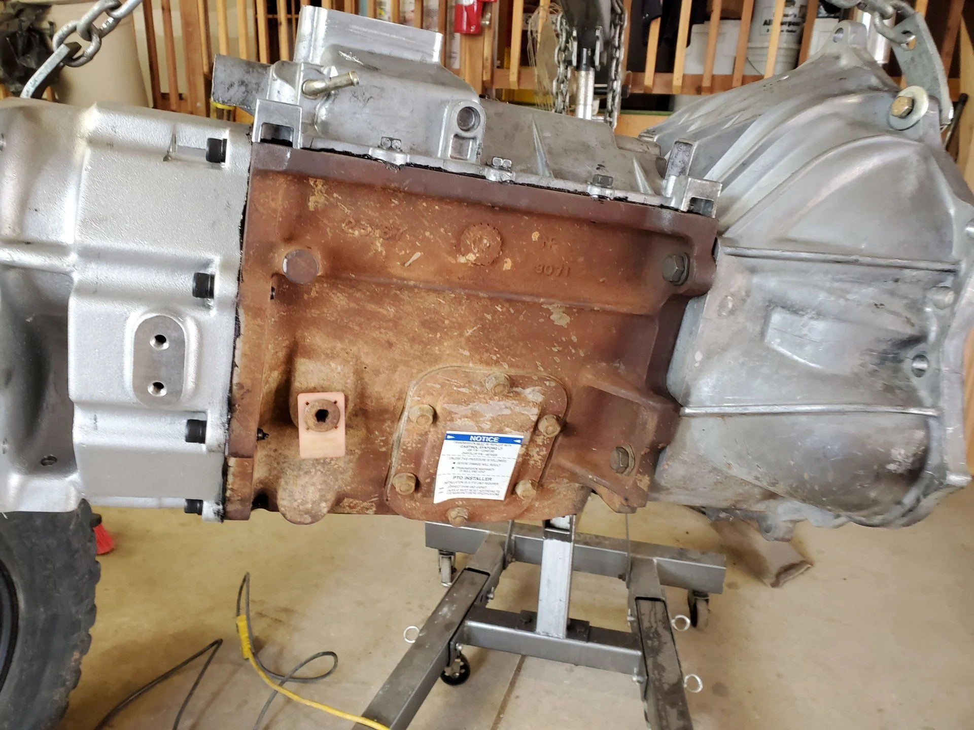

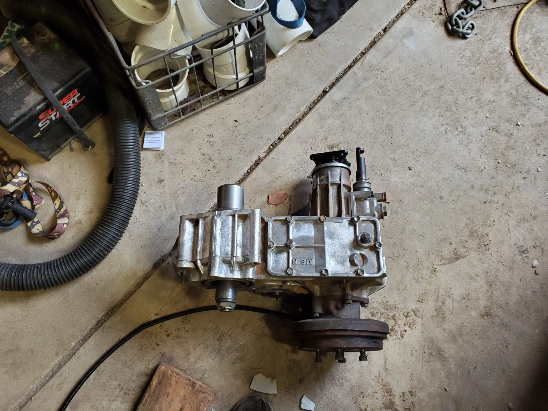

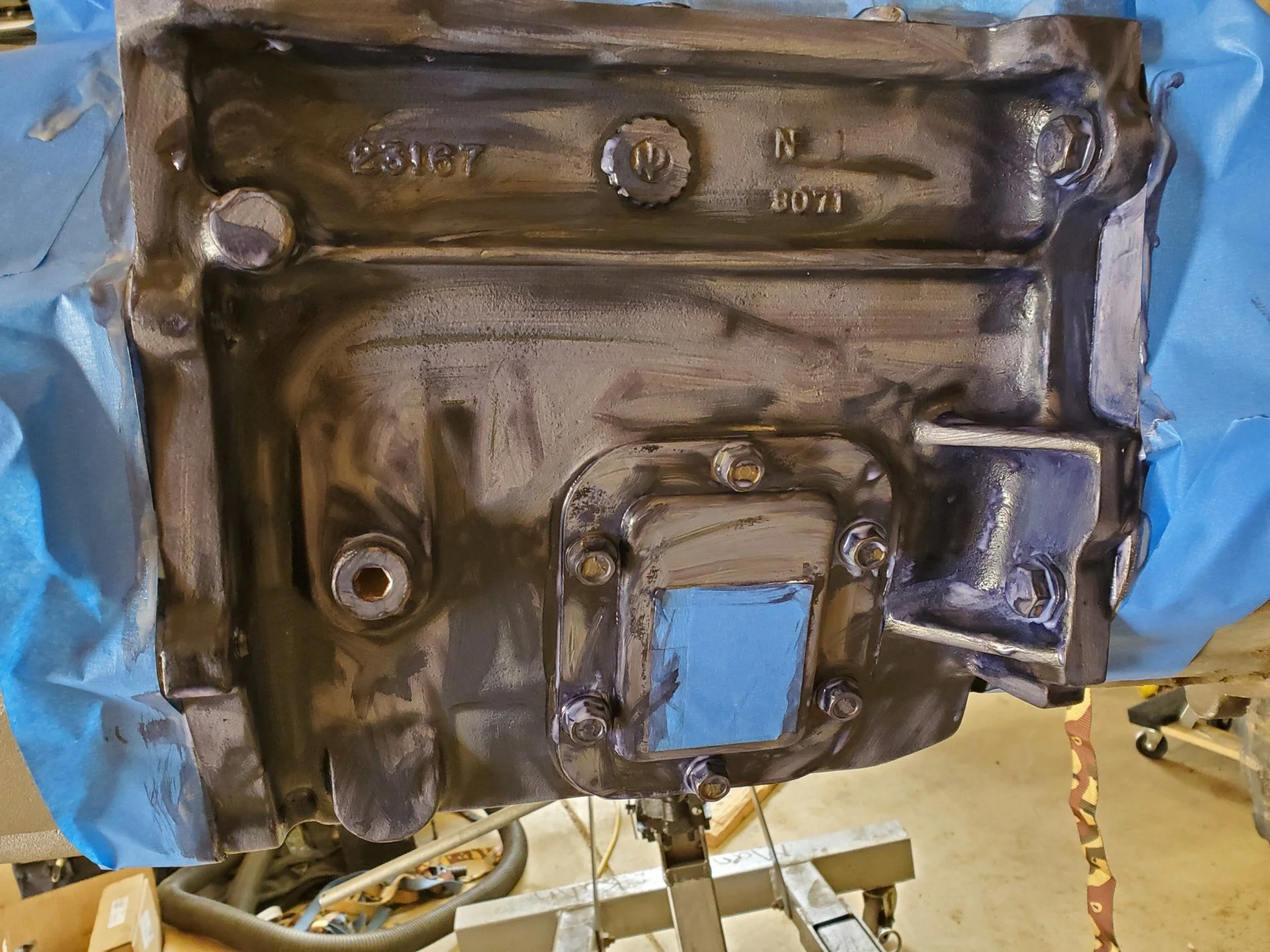

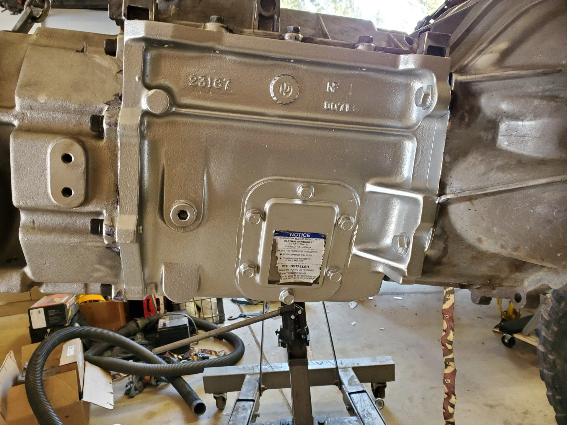

I started with the NV4500. It was rusty and looked terrible.
I took a wire wheel to it and got rid of as much of the rust as possible. I really like to look of the cast case, but it didnt really match.

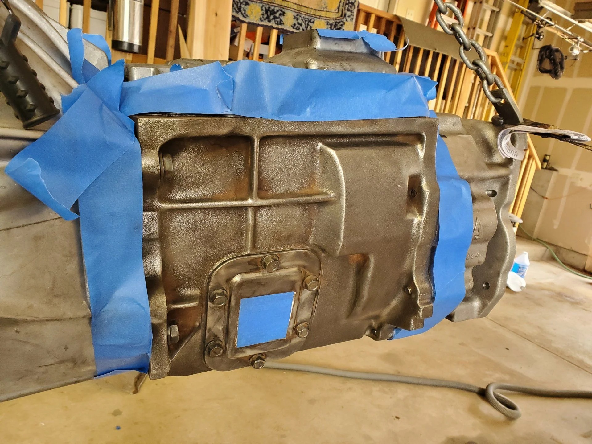

I then slopped some rust converter on there. I really like the stuff I use (cant remember the name) because it cures and turns into a primer, so you can paint right on top of it. I also got everything masked off for paint.
And paint.
I then tried to clean up the transfer case to get rid of the red Georgia mud.
I couldnt reach a lot of spots but it looks better than before.

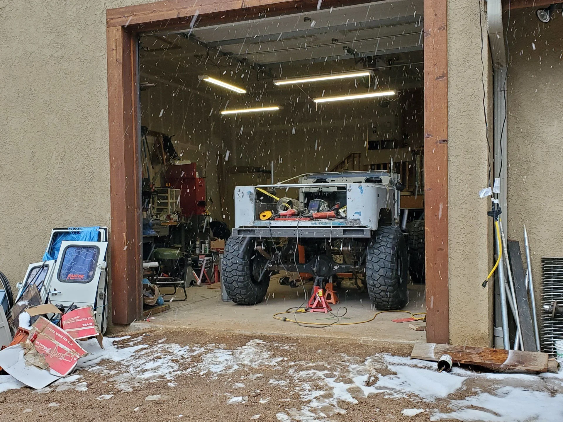

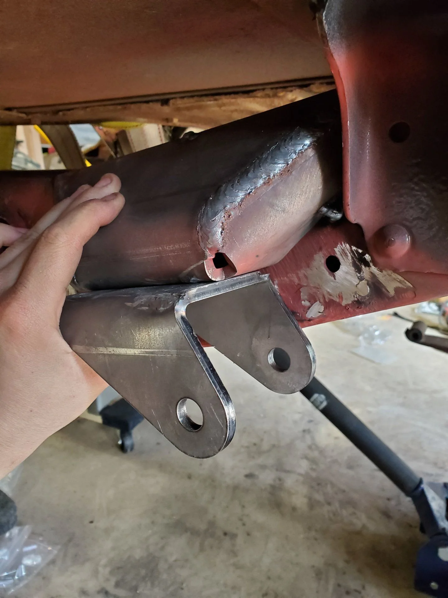

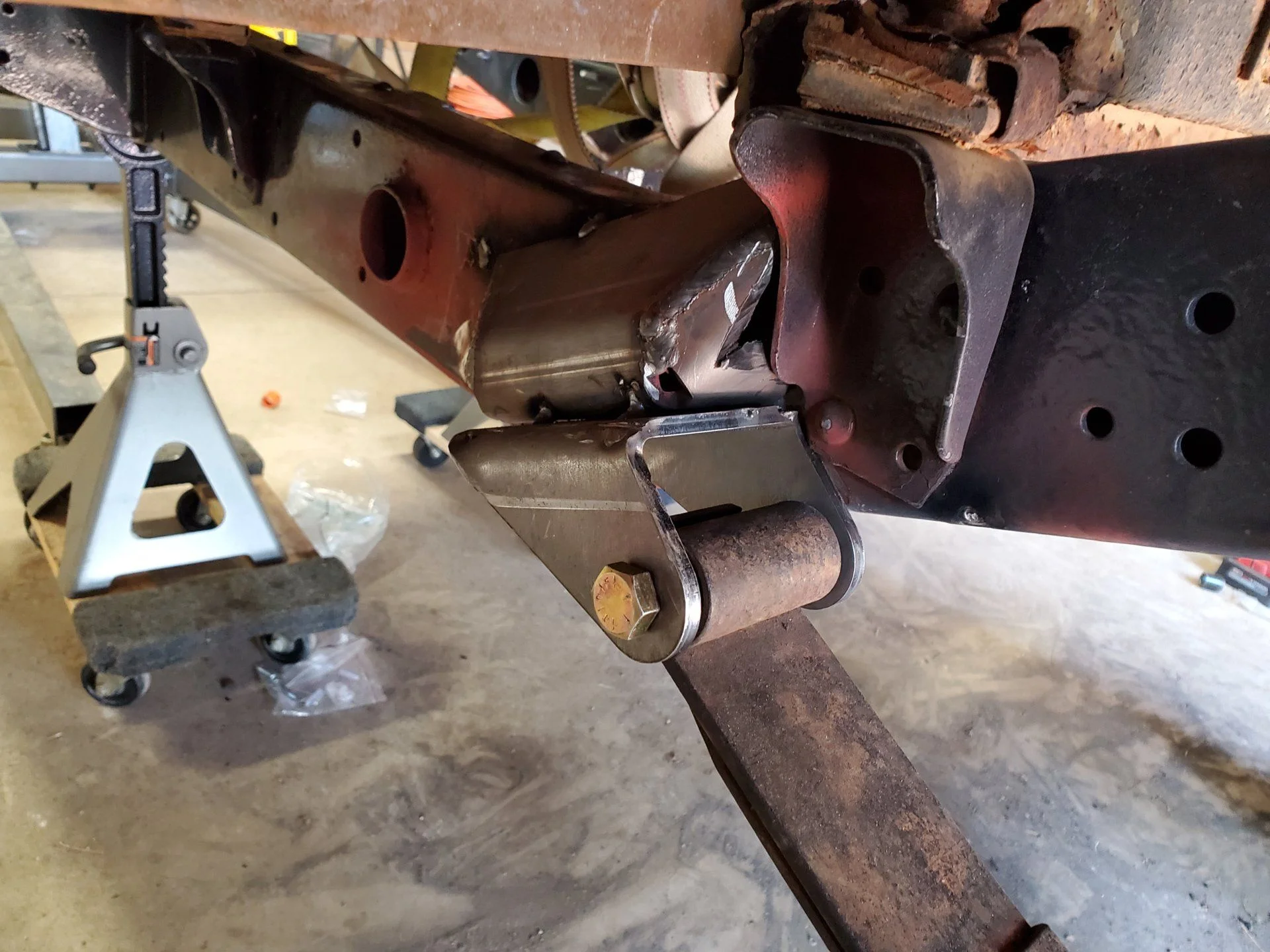

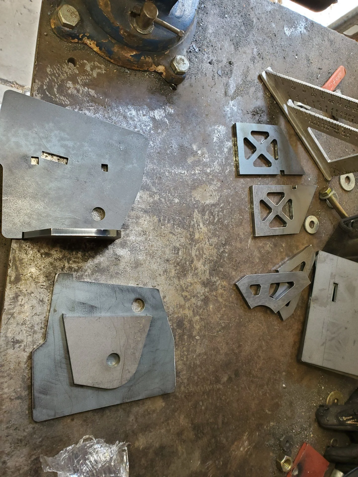

I then started working on the frameside link brackets.
It then started to get snowy and windy, and now I'm inside.

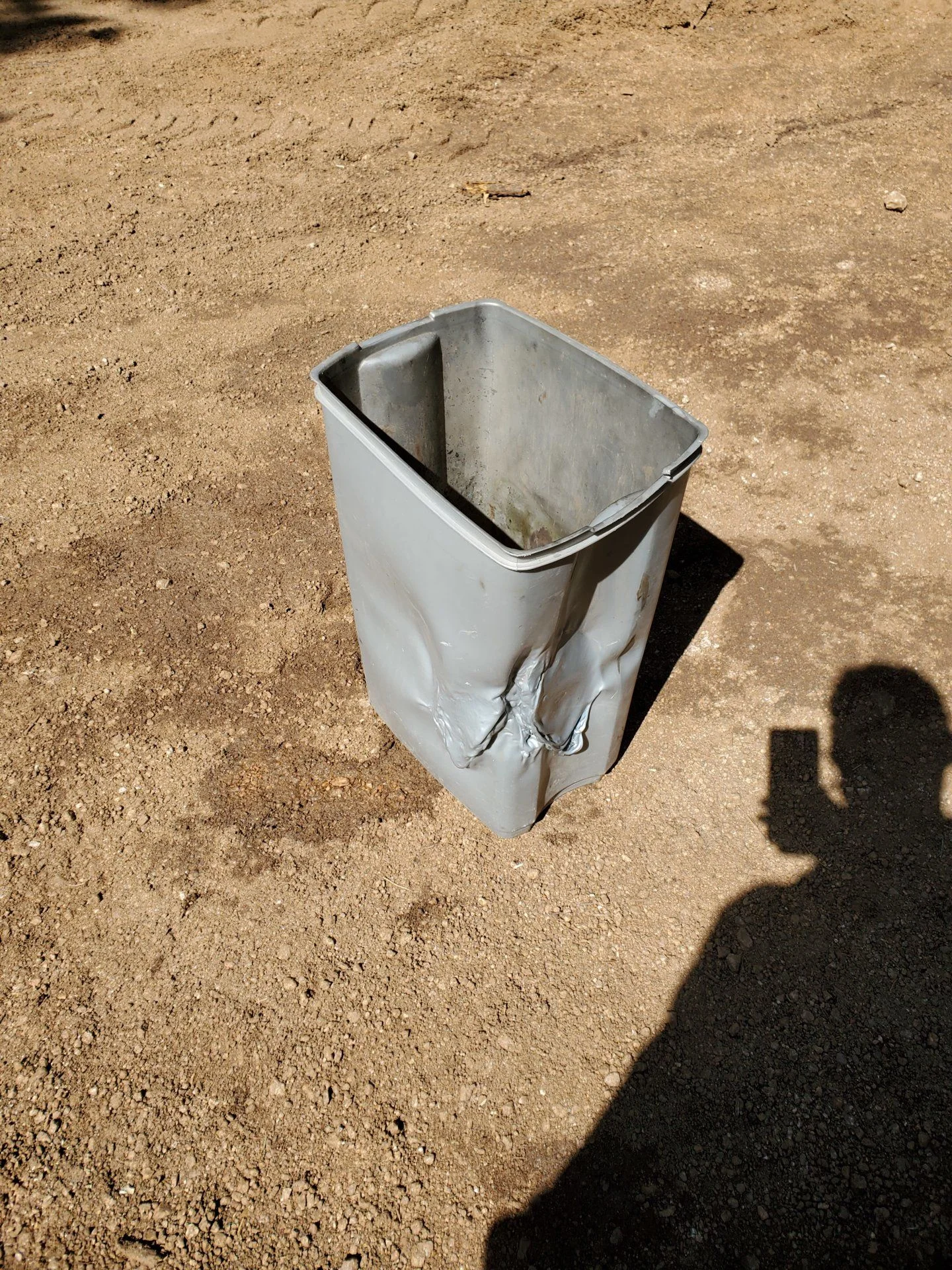

I forgot the trash can was under the tub, and oily rags and sparks dont mix. Whoda thunk.

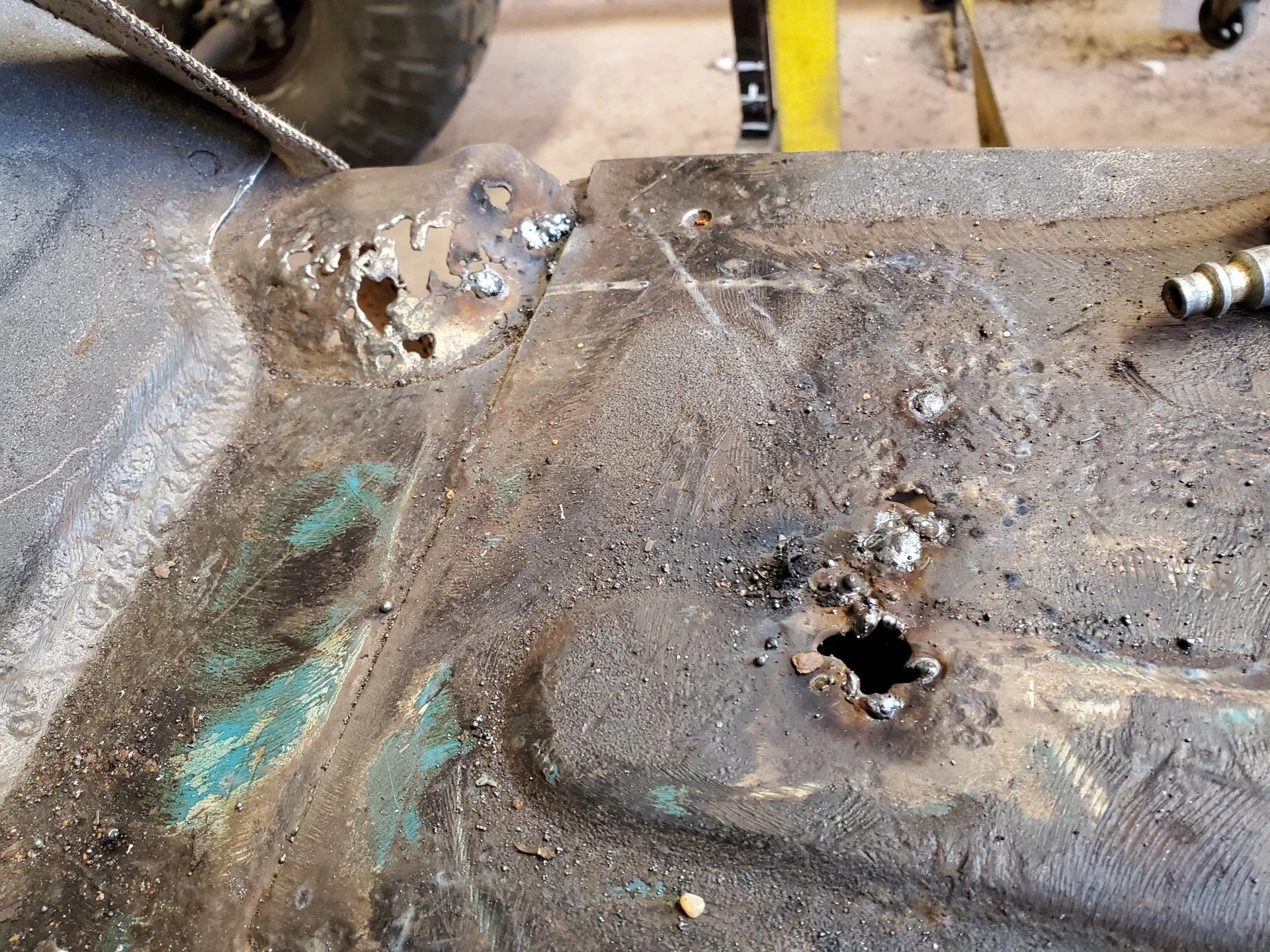

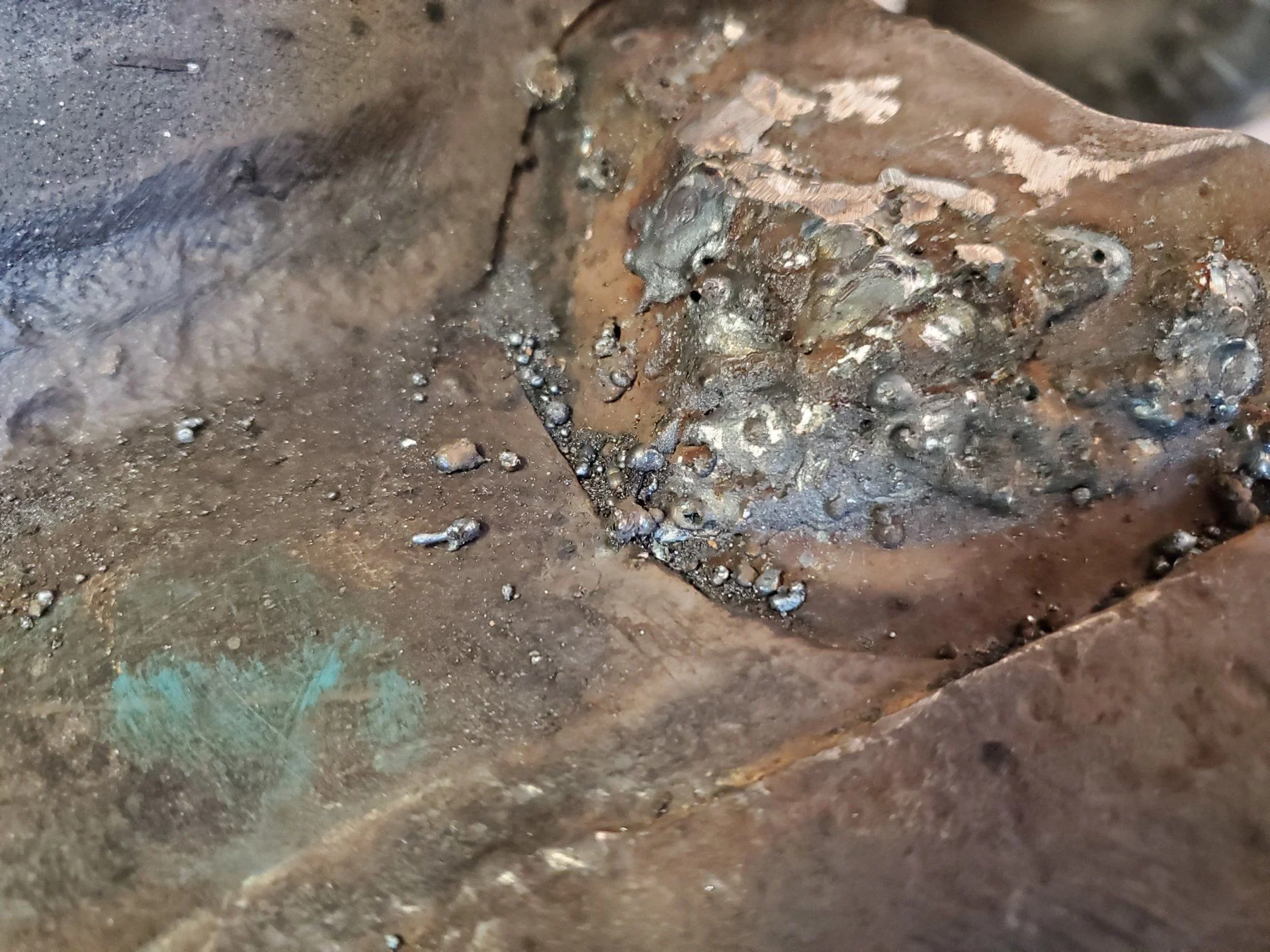

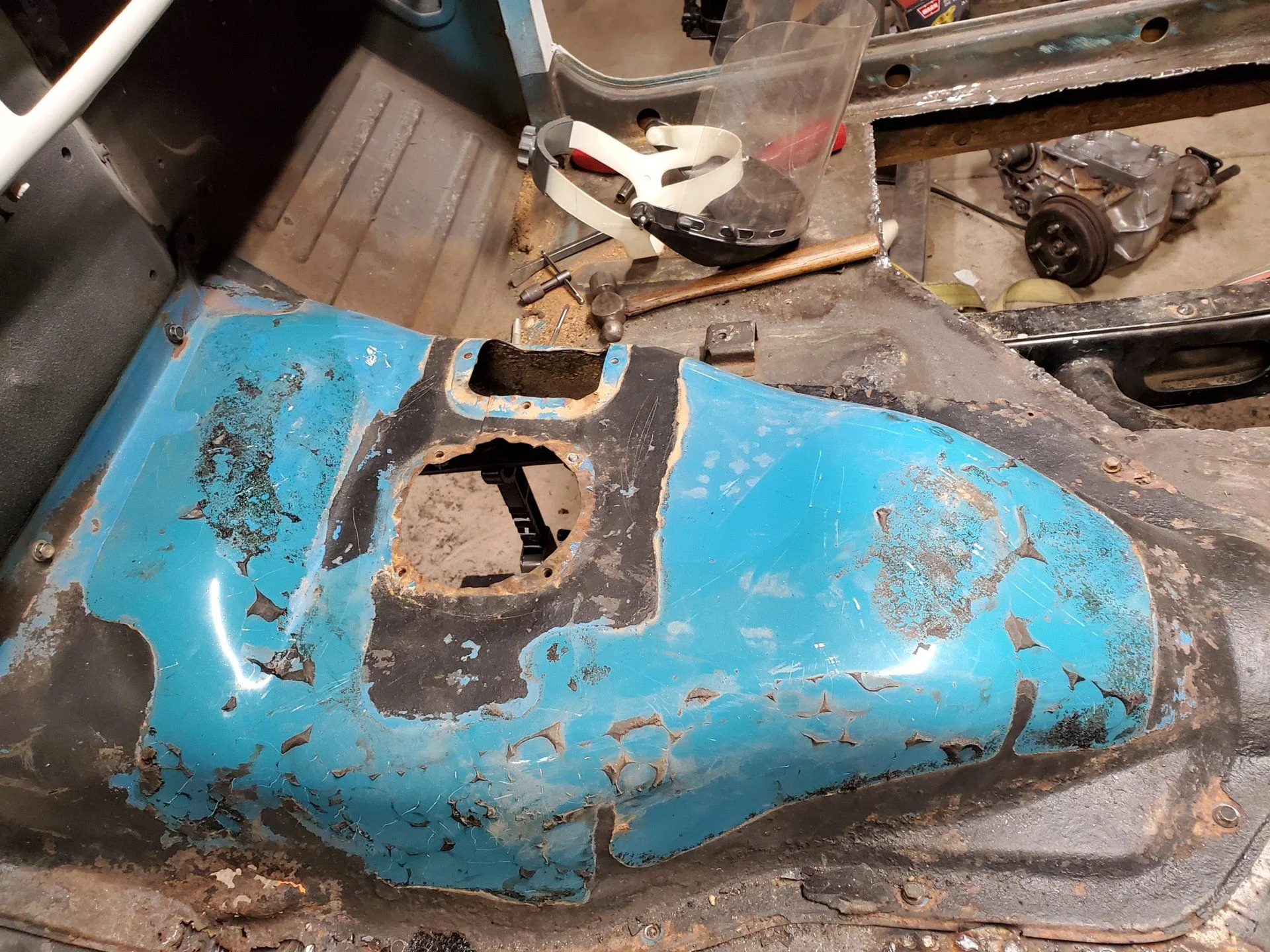

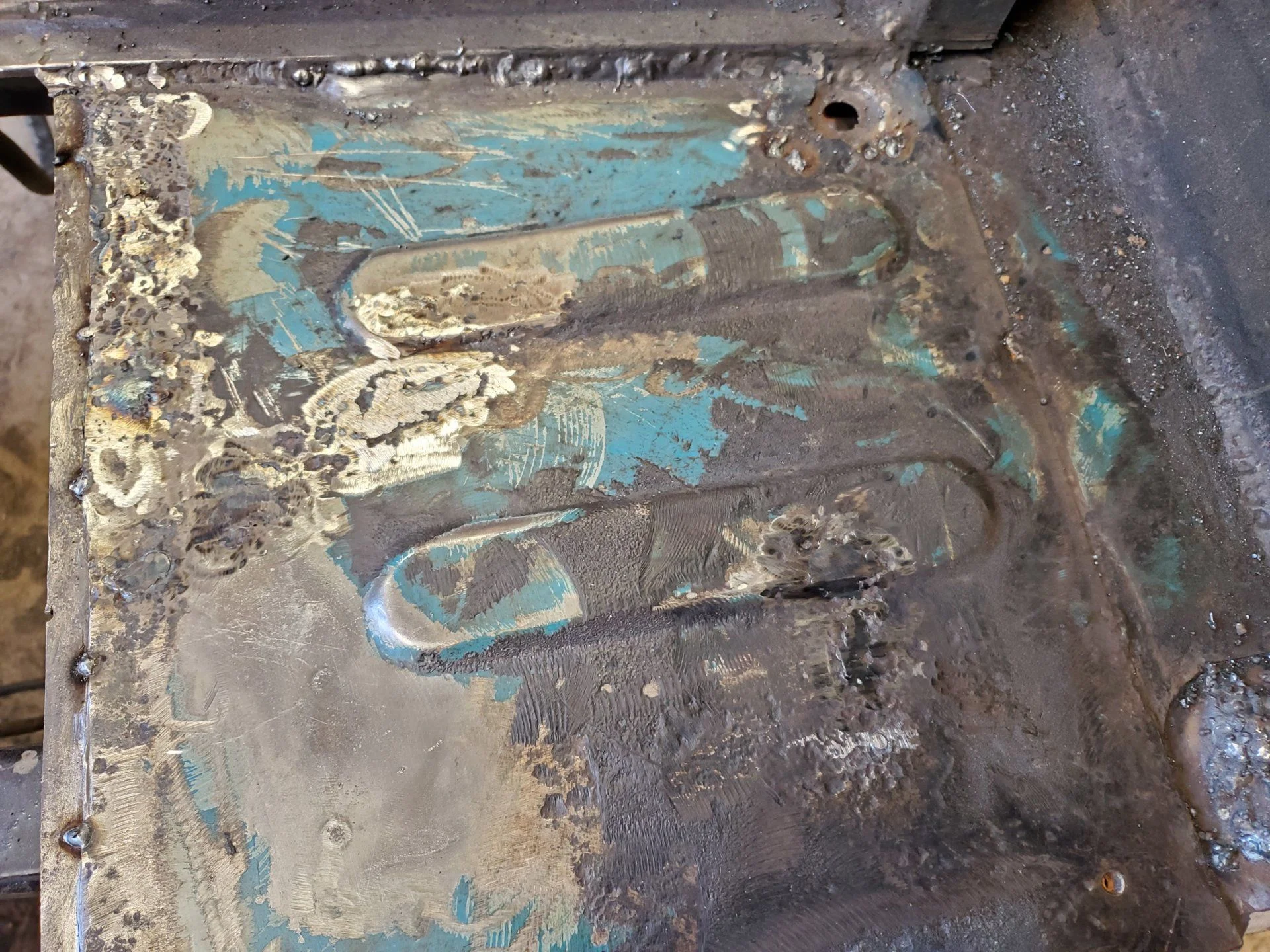

Well, I spent the day un POing the tub and filling the rust holes.

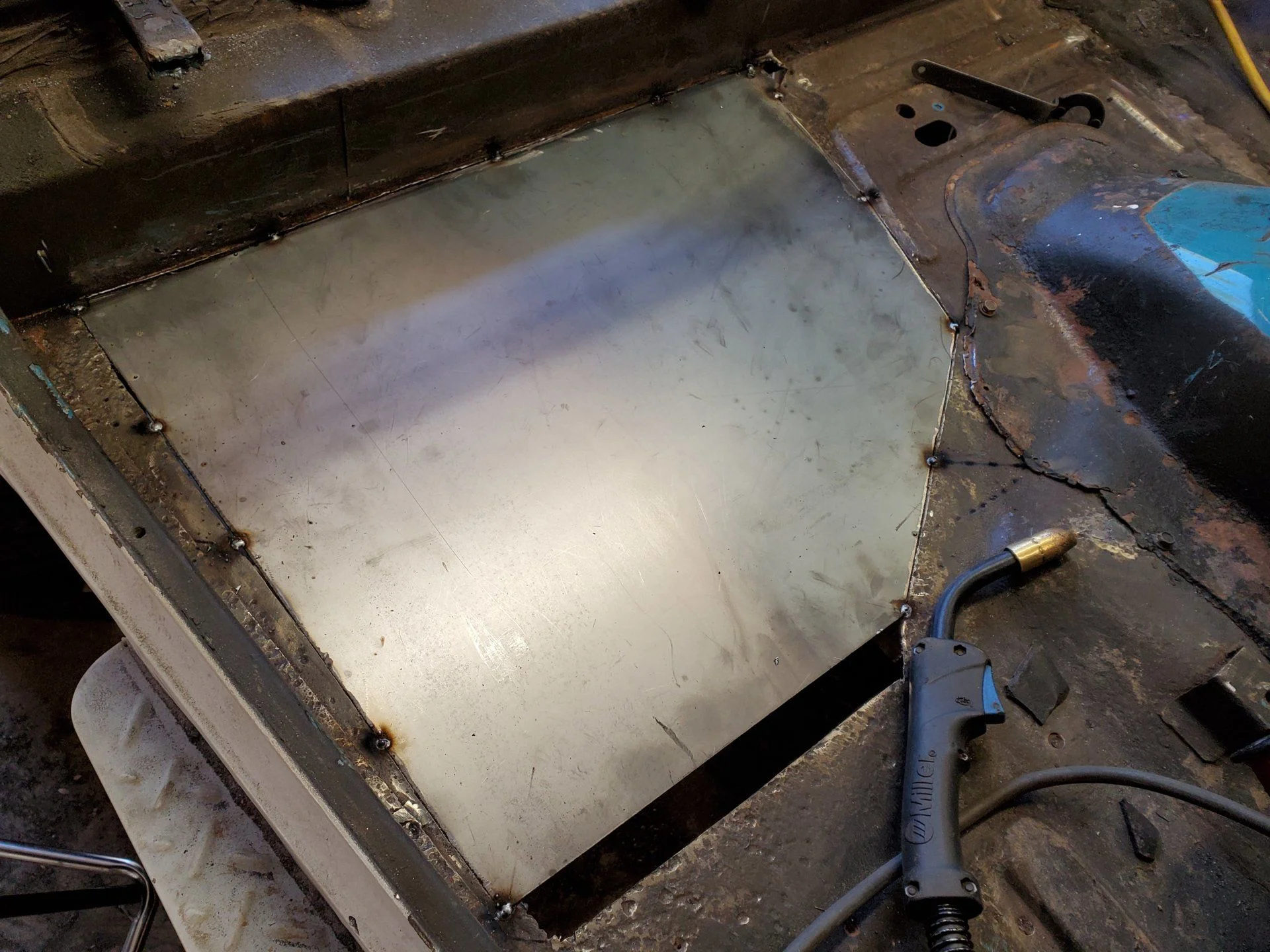

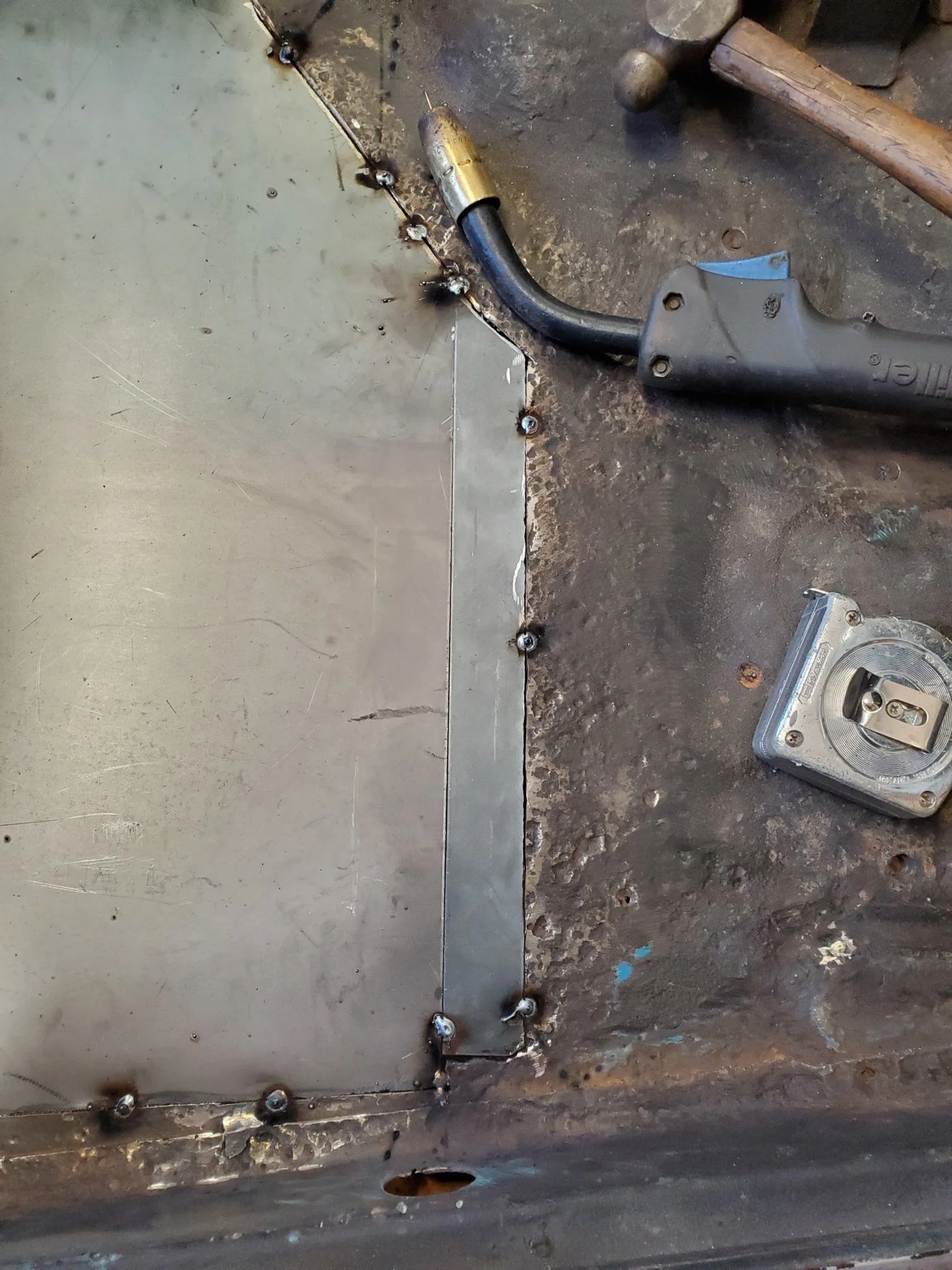

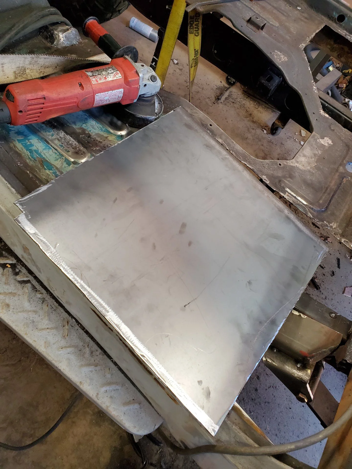

I then cut out out the patch from 16 gauge sheet
Tacked in.
The cat supervised.
I then put the tranny hump back in to make sure everything lined up.
And the finished product for today.

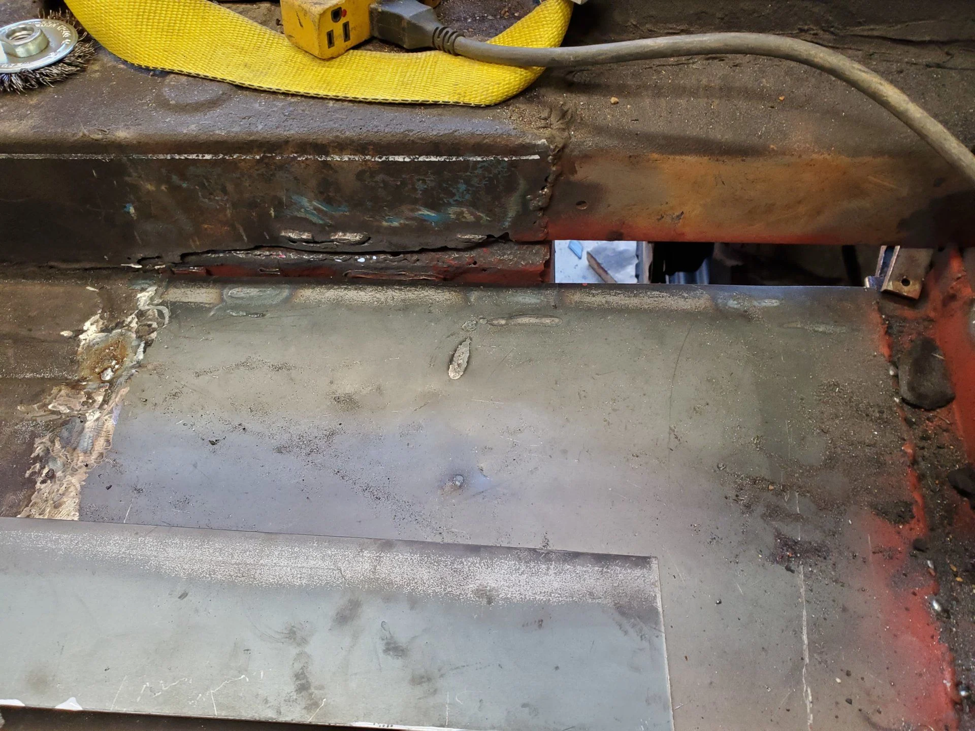

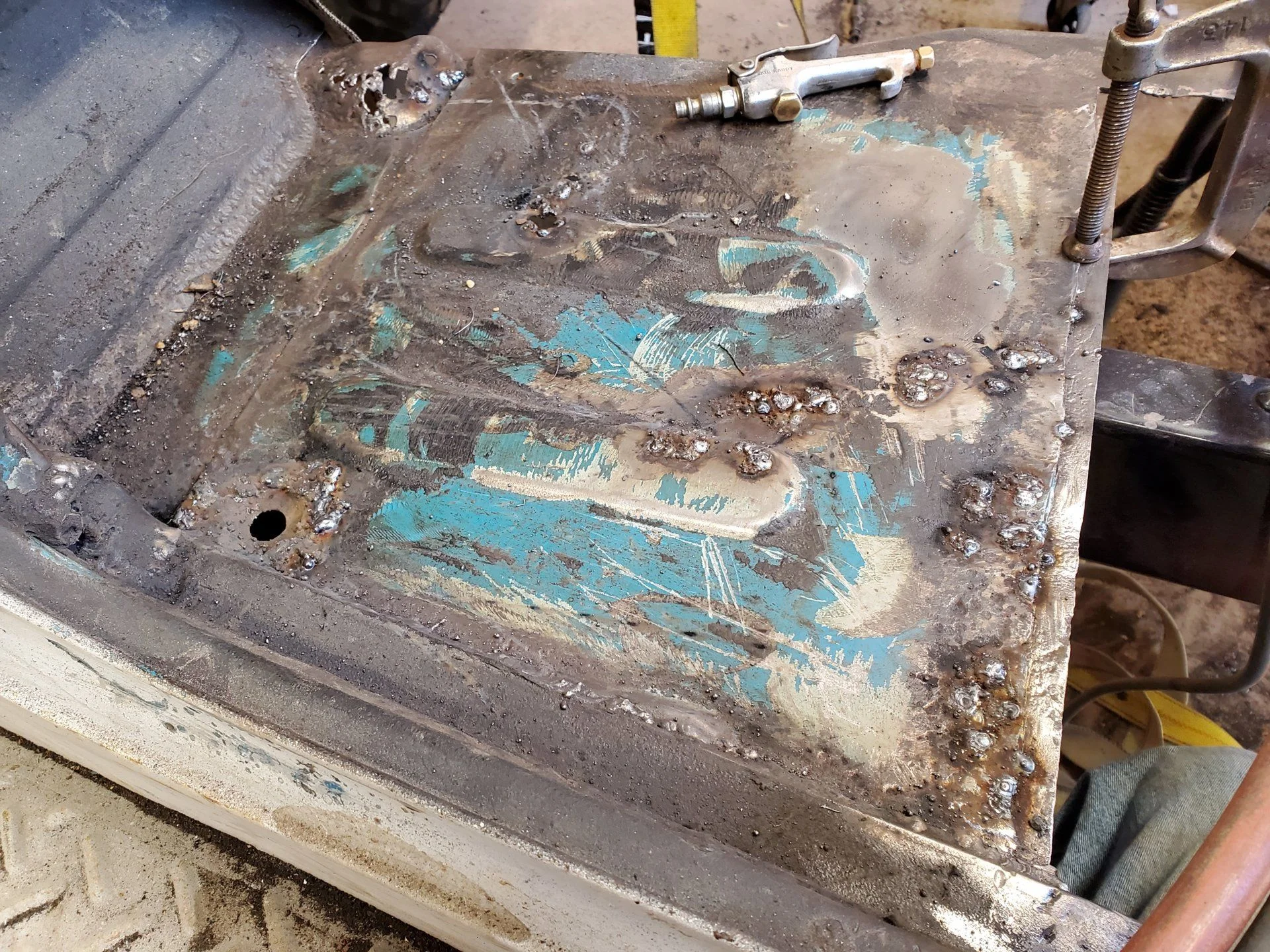

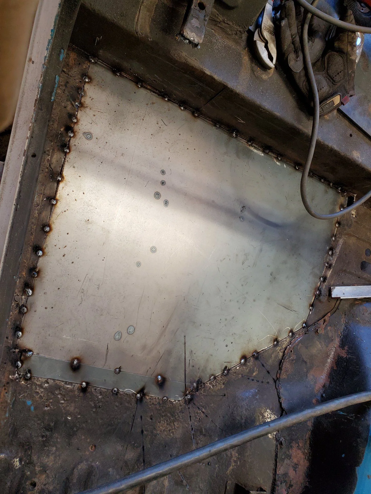

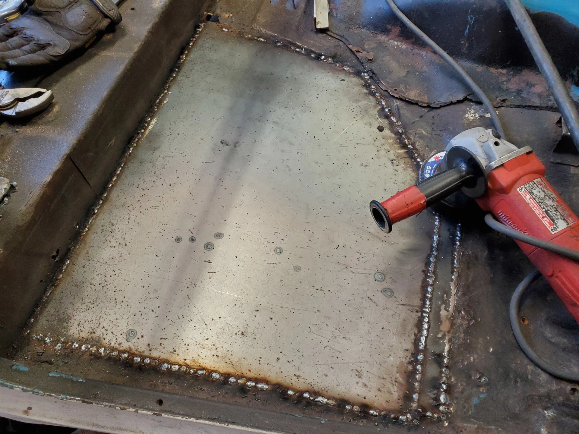

Well, I backtracked and replaced more floor today.
I then started working on the missing pieces behind the driver's seat.
Anyways, that's what I did today.

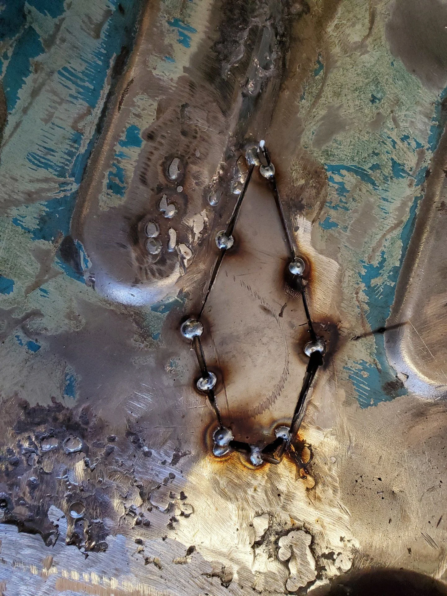

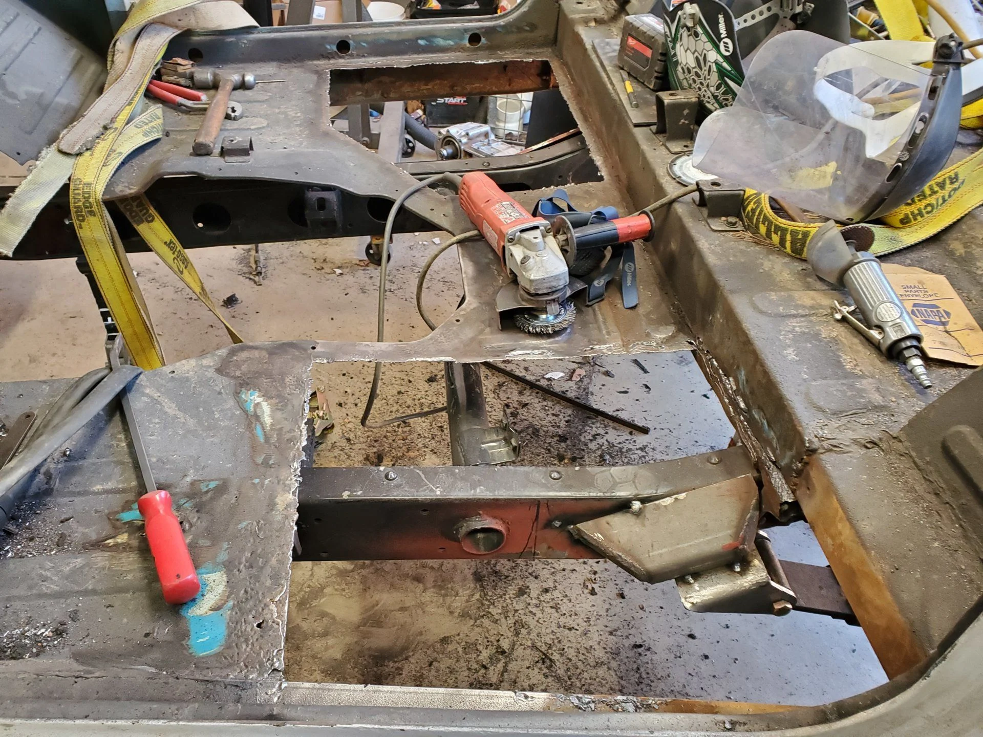

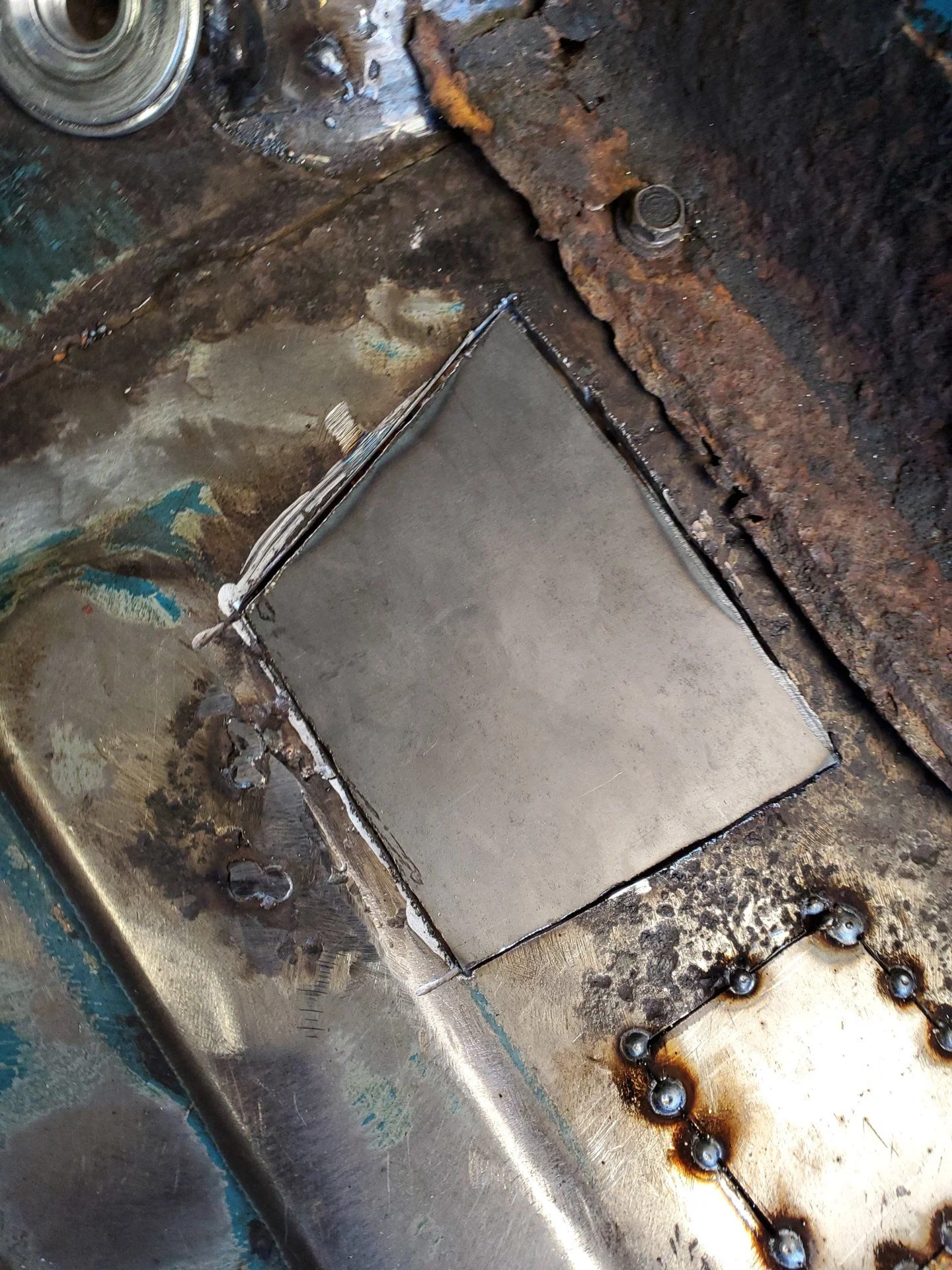

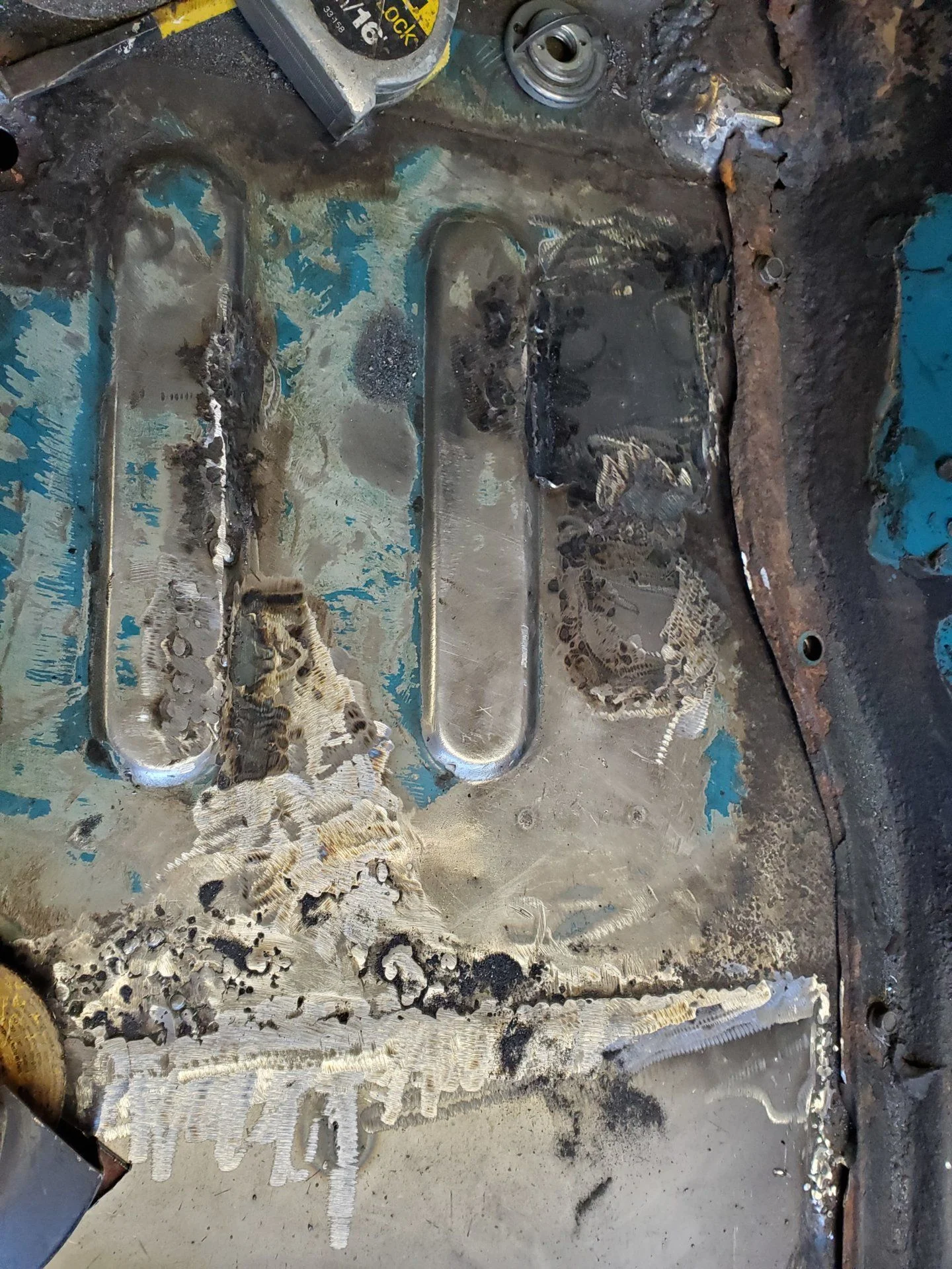

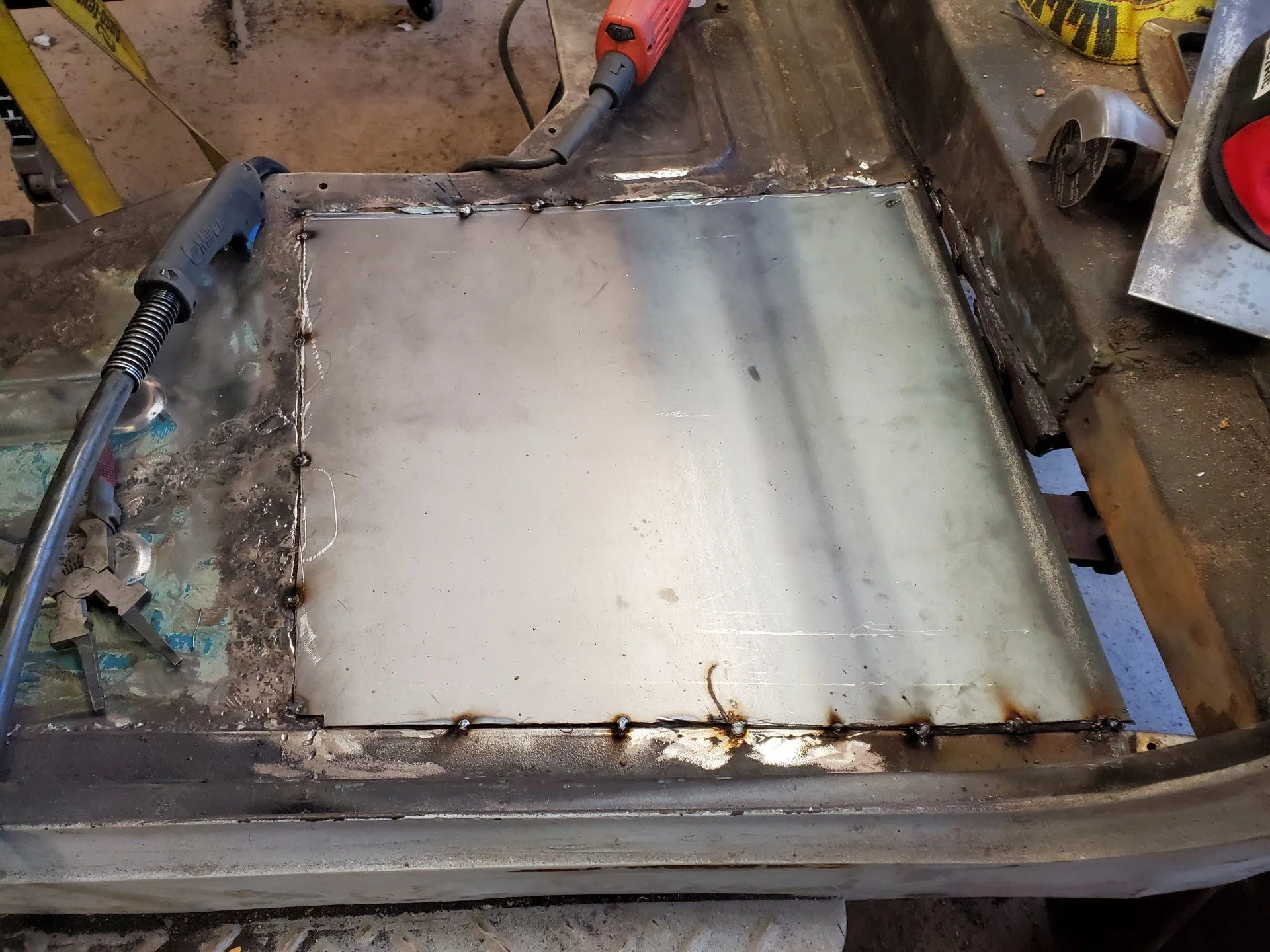

I started on the passenger side hole today.

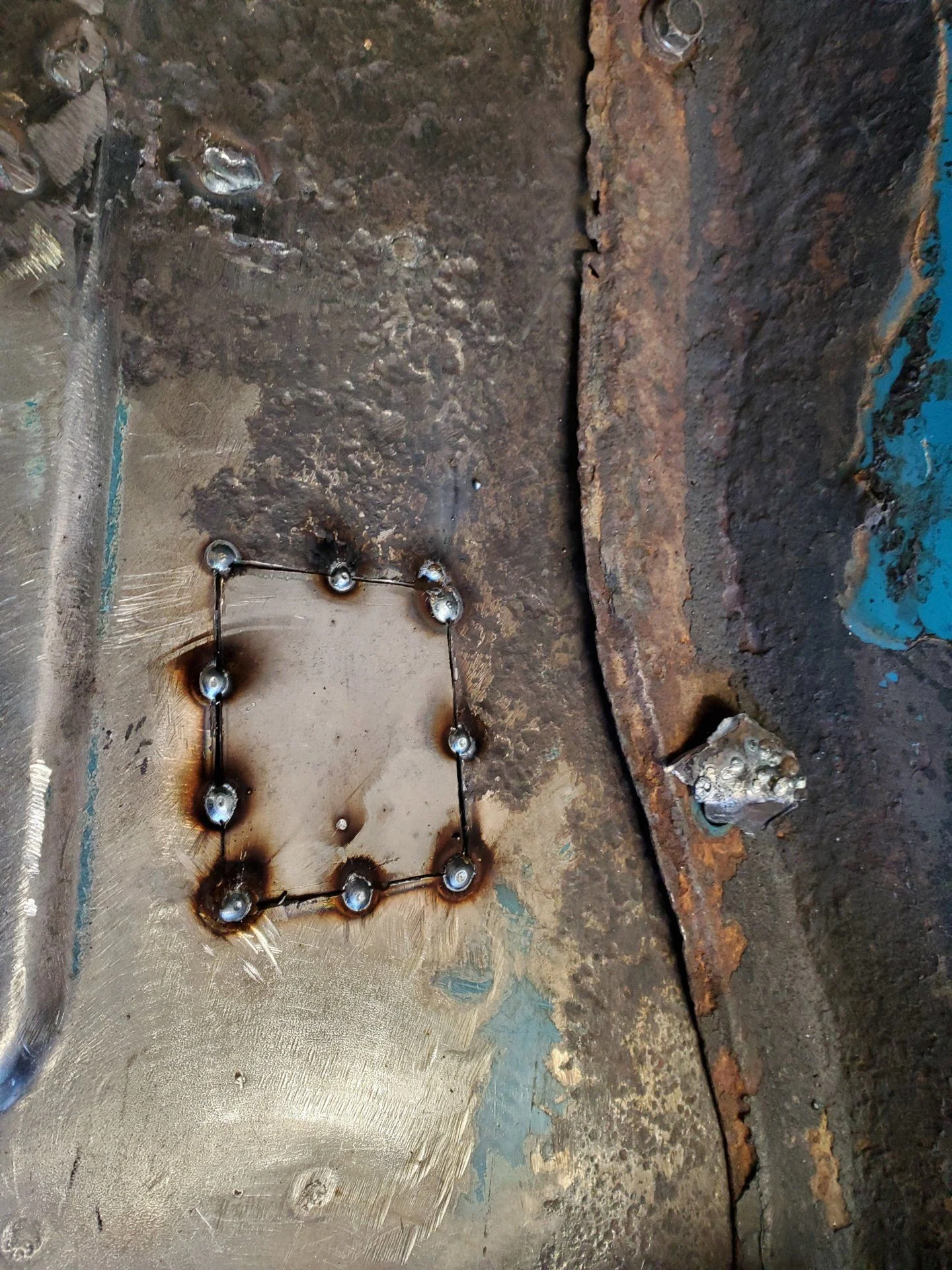

I trimmed a bunch of tinfoil out, and tried to get to better metal.
here is the patch tacked in.
Second part of the patch fitted up.
And all cleaned up.

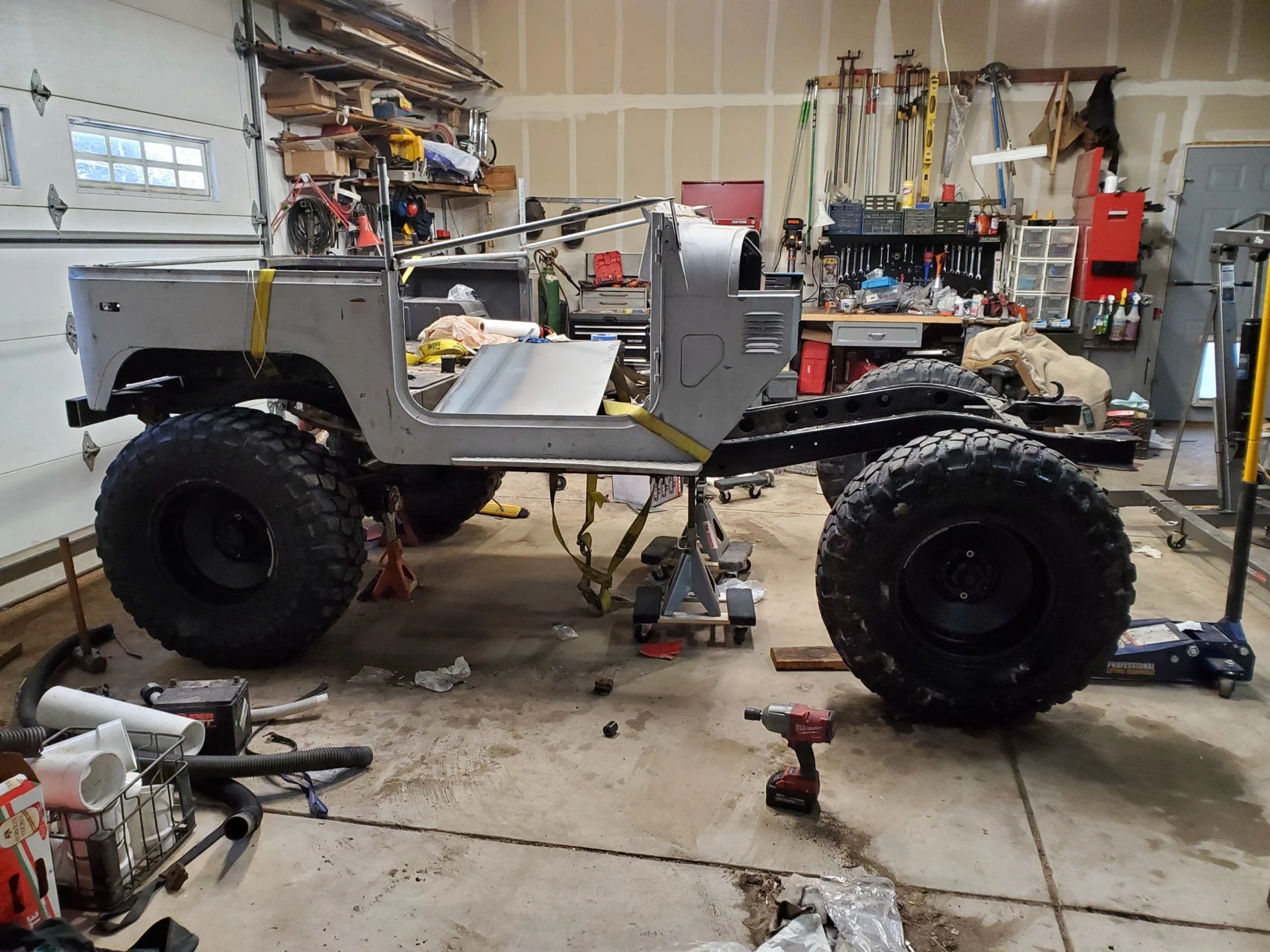

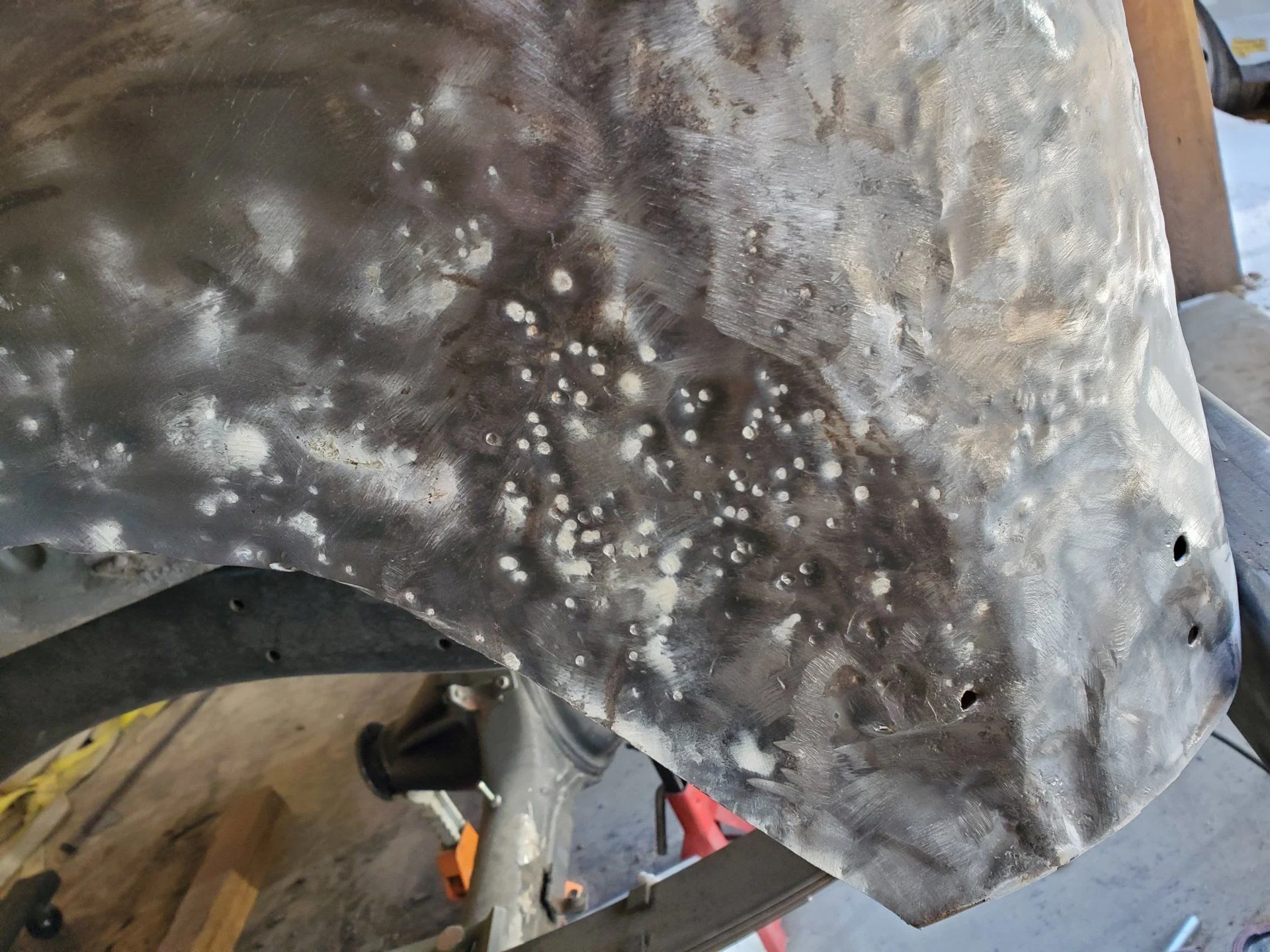

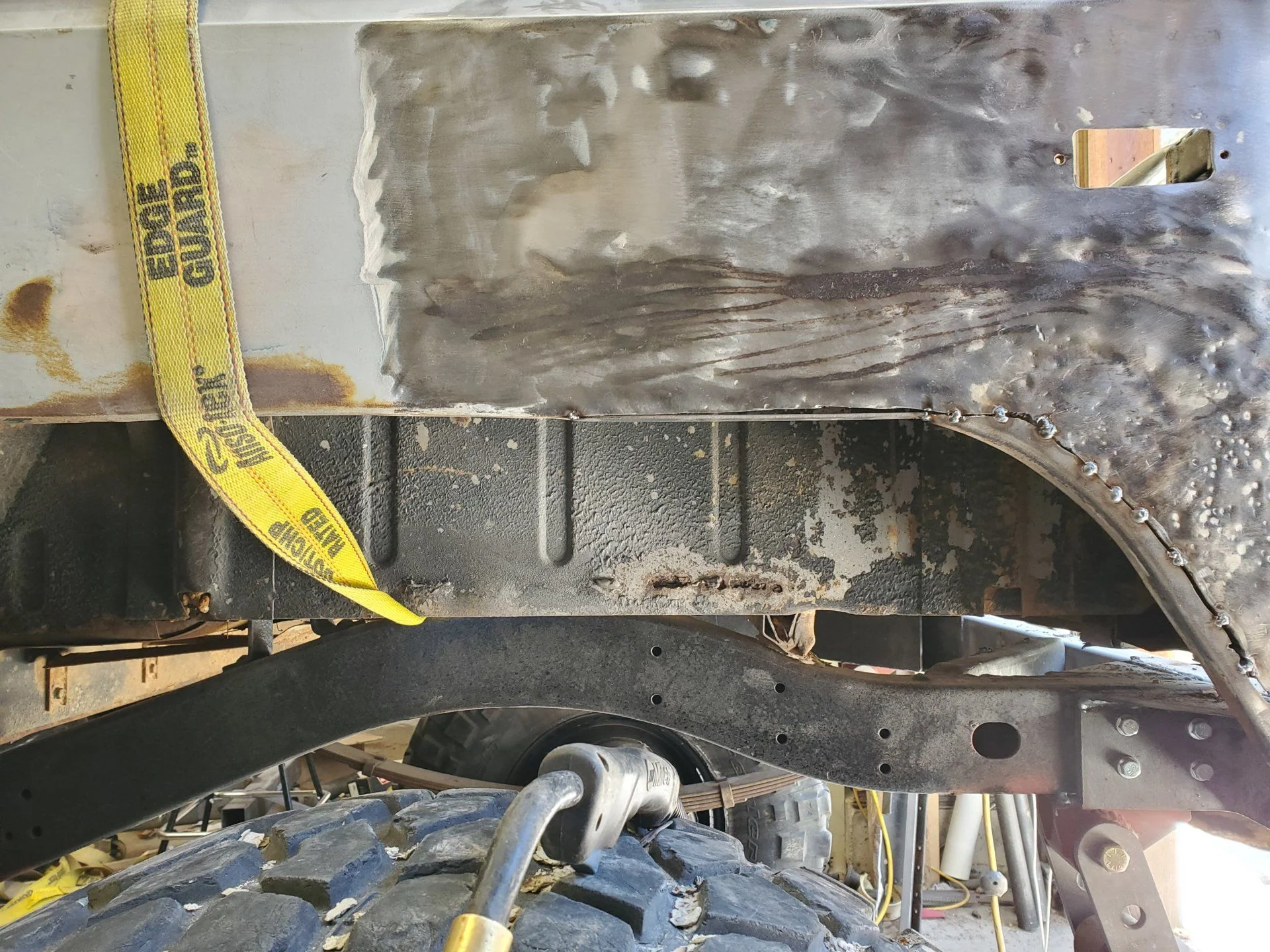

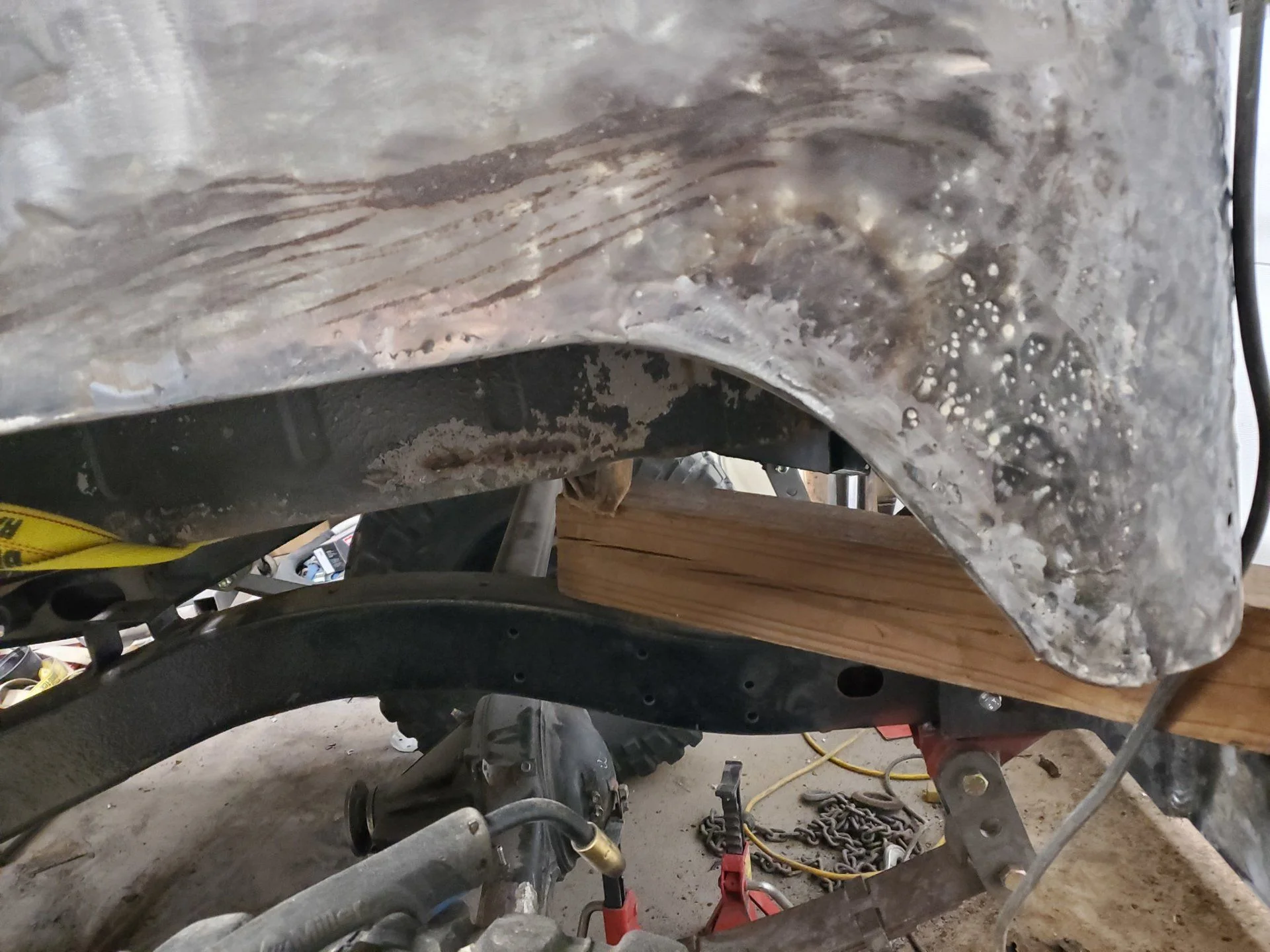

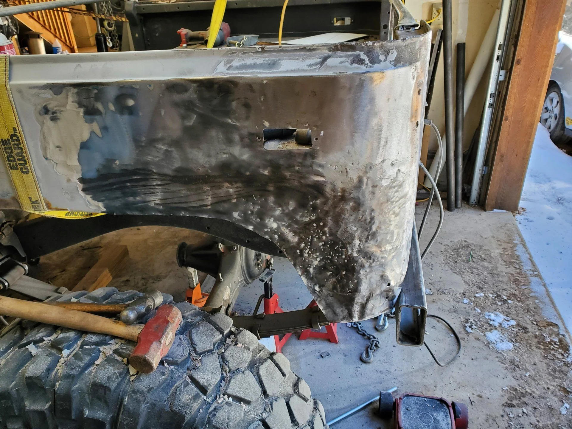

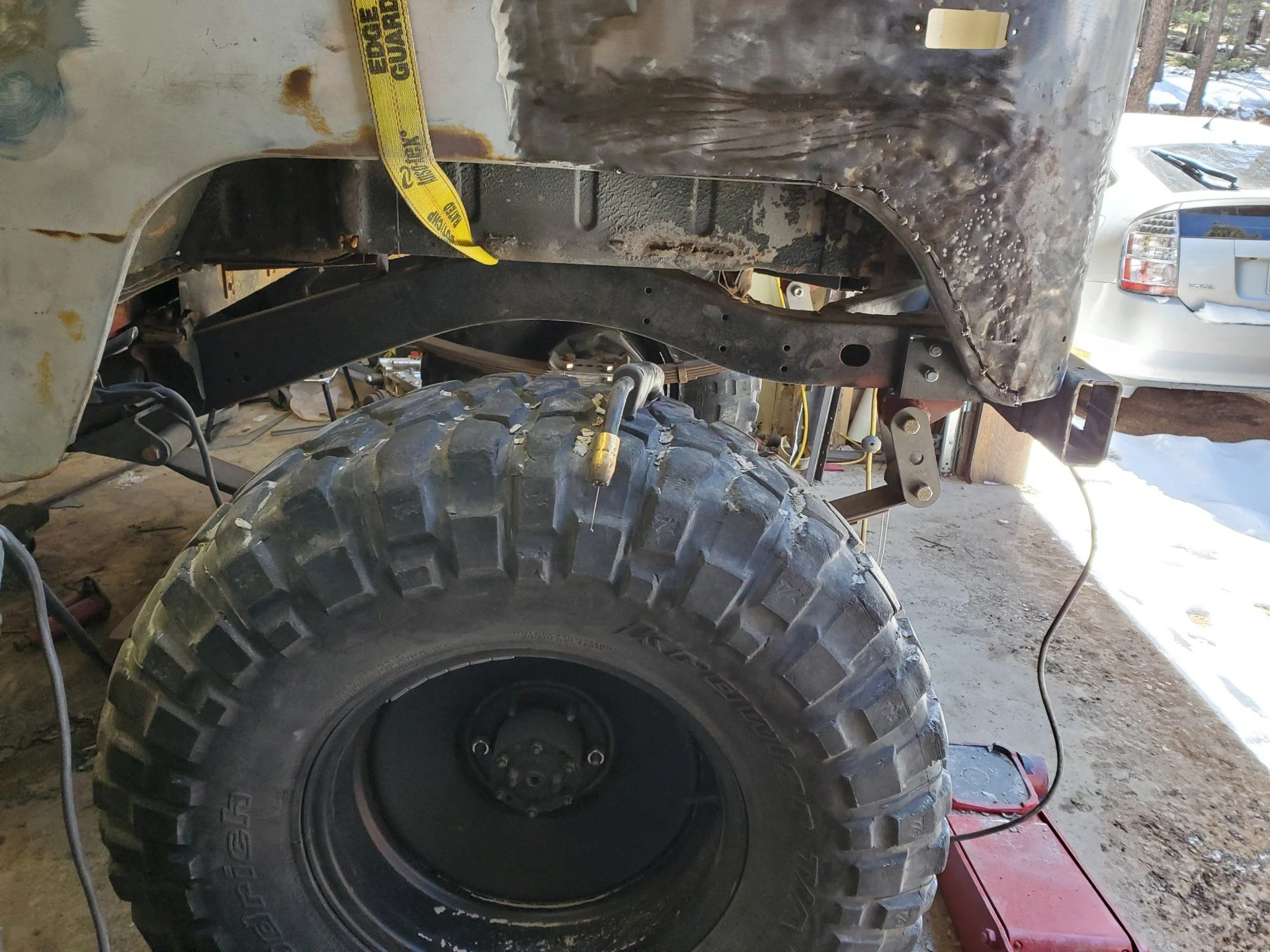

I also pulled about an inch of bondo off the quarterpanel.

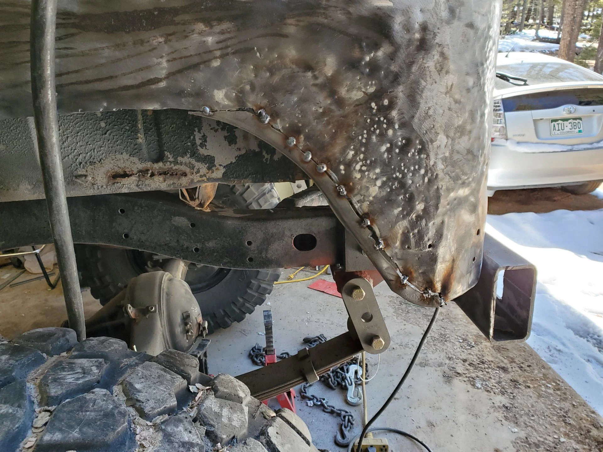

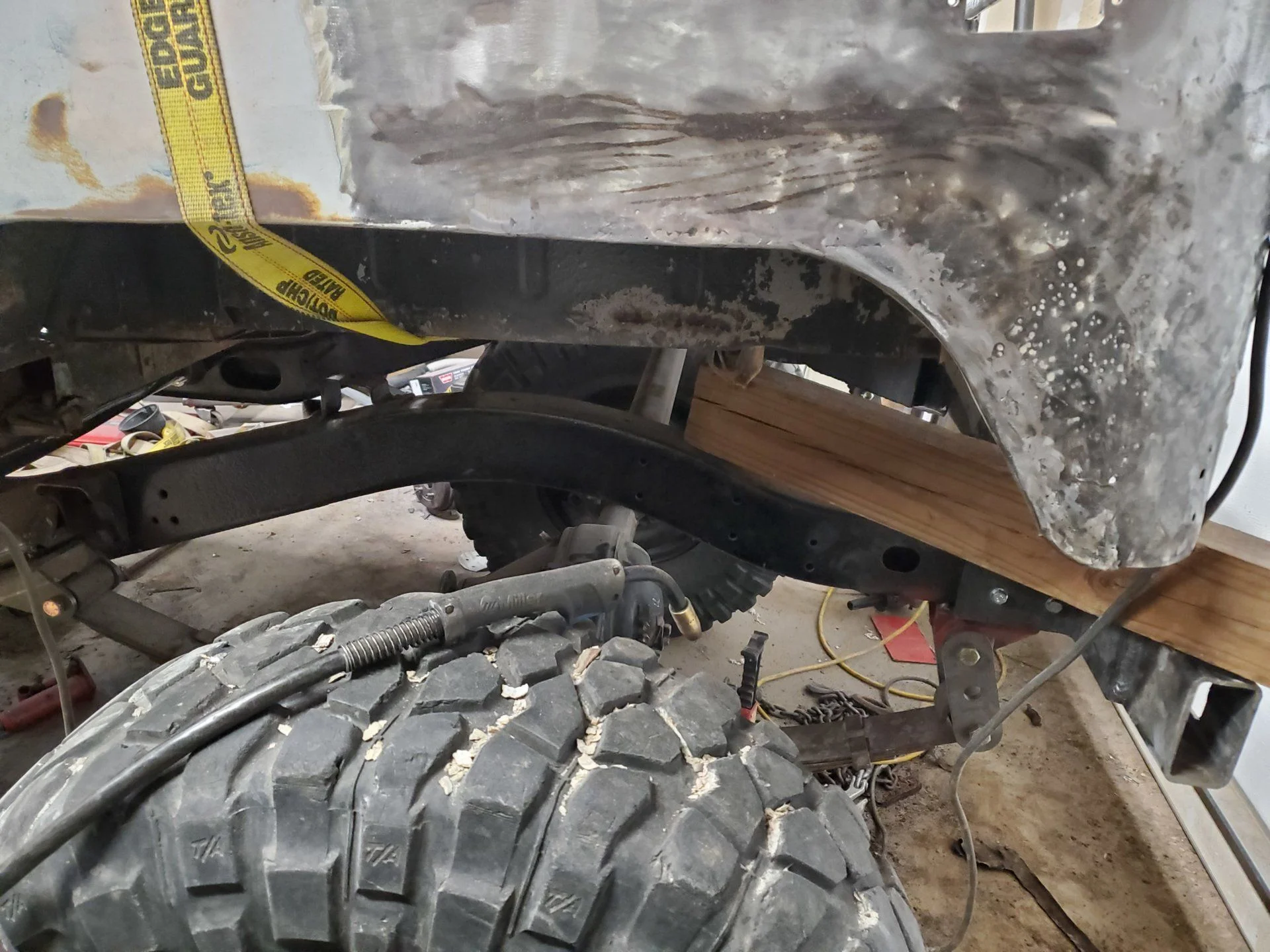

I then started putting the stock bend back on. I really like the look of the stock wheel well, and I would like to make this look as stock as possible.
I then put the rest of the stiffening peice on.
After a bunch of beating on the panels, it looks pretty stock. I'm happy with it.
All welded up and ground.

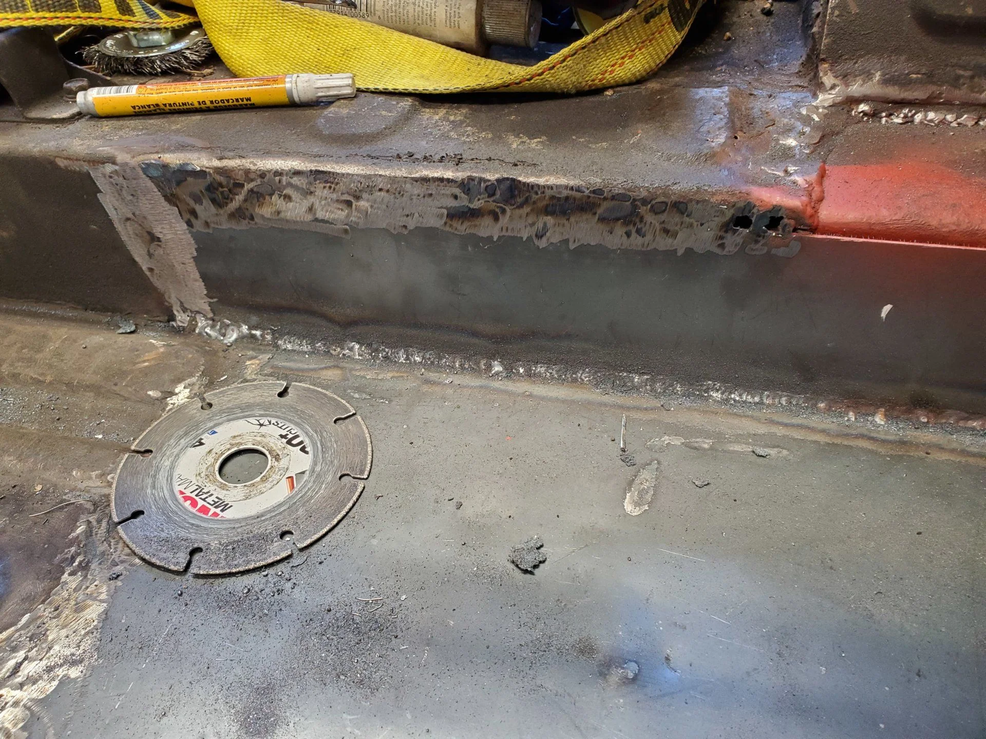

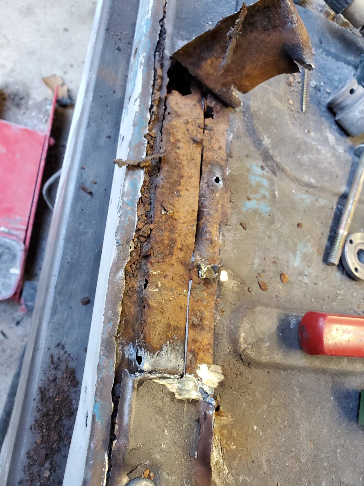

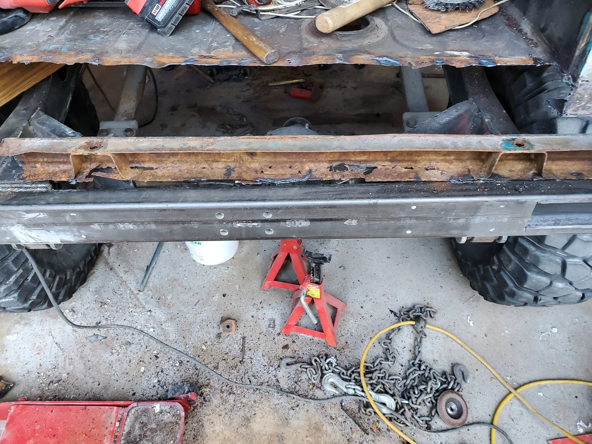

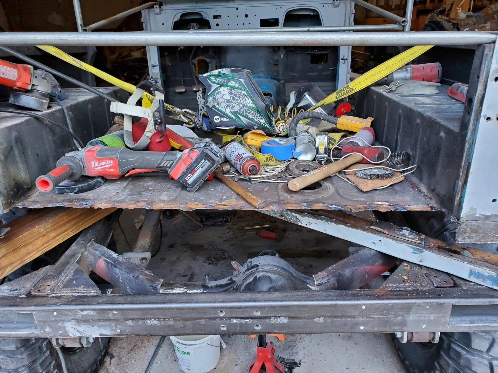

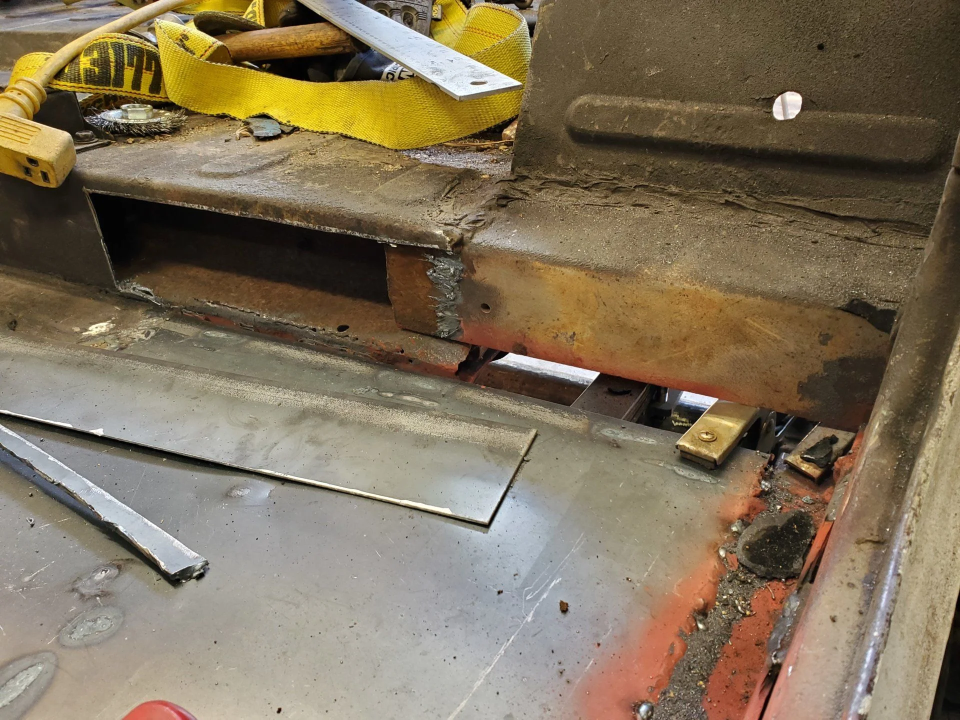

I also decided to start cutting out the rear sill.
This one was pretty cancerous.
Because the crossmember was so rusted, i decided to fully remove it and will fab up a replacement.
