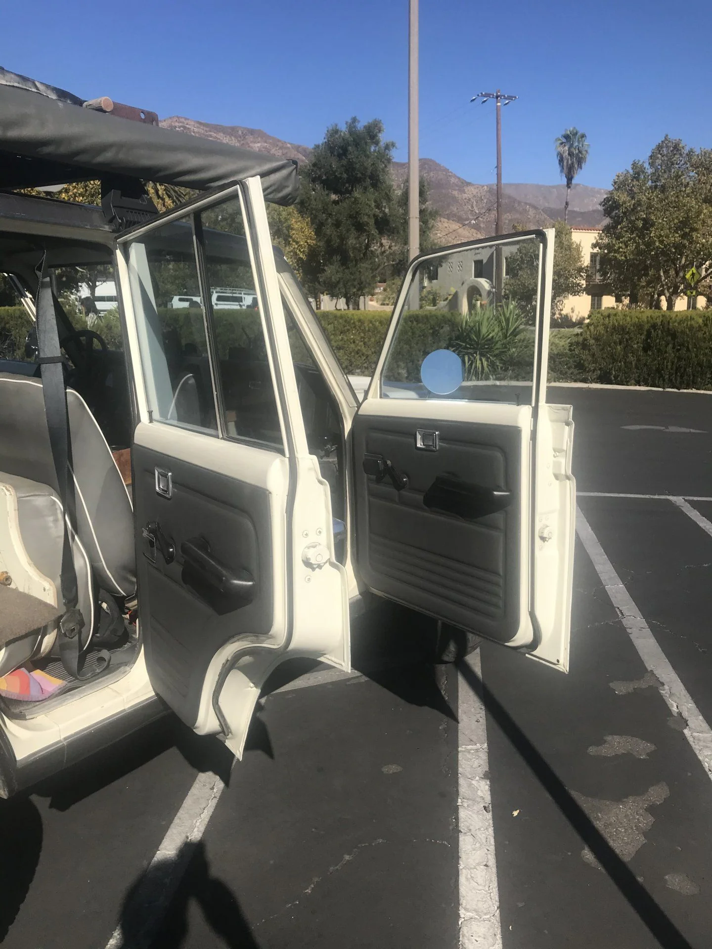

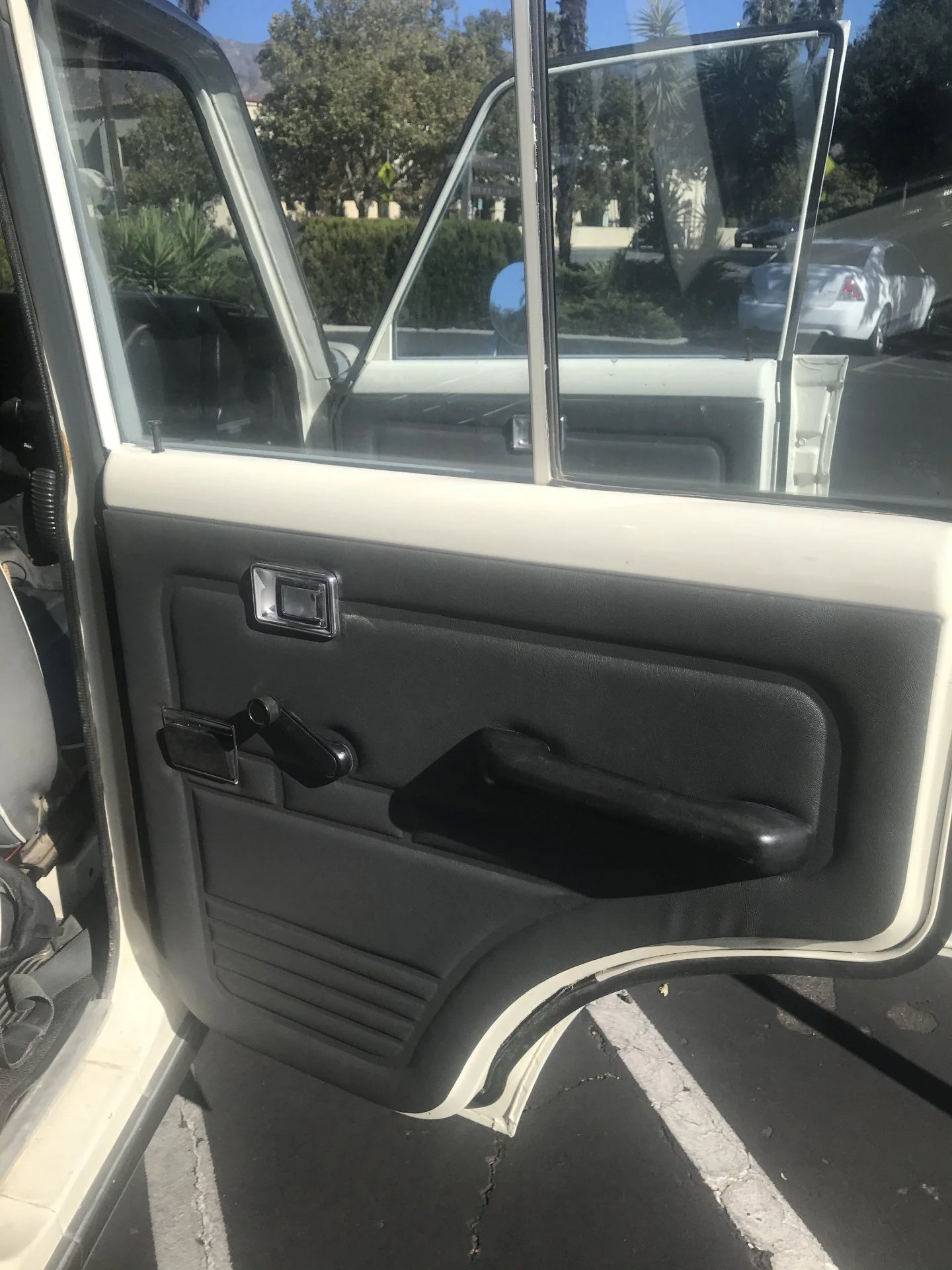

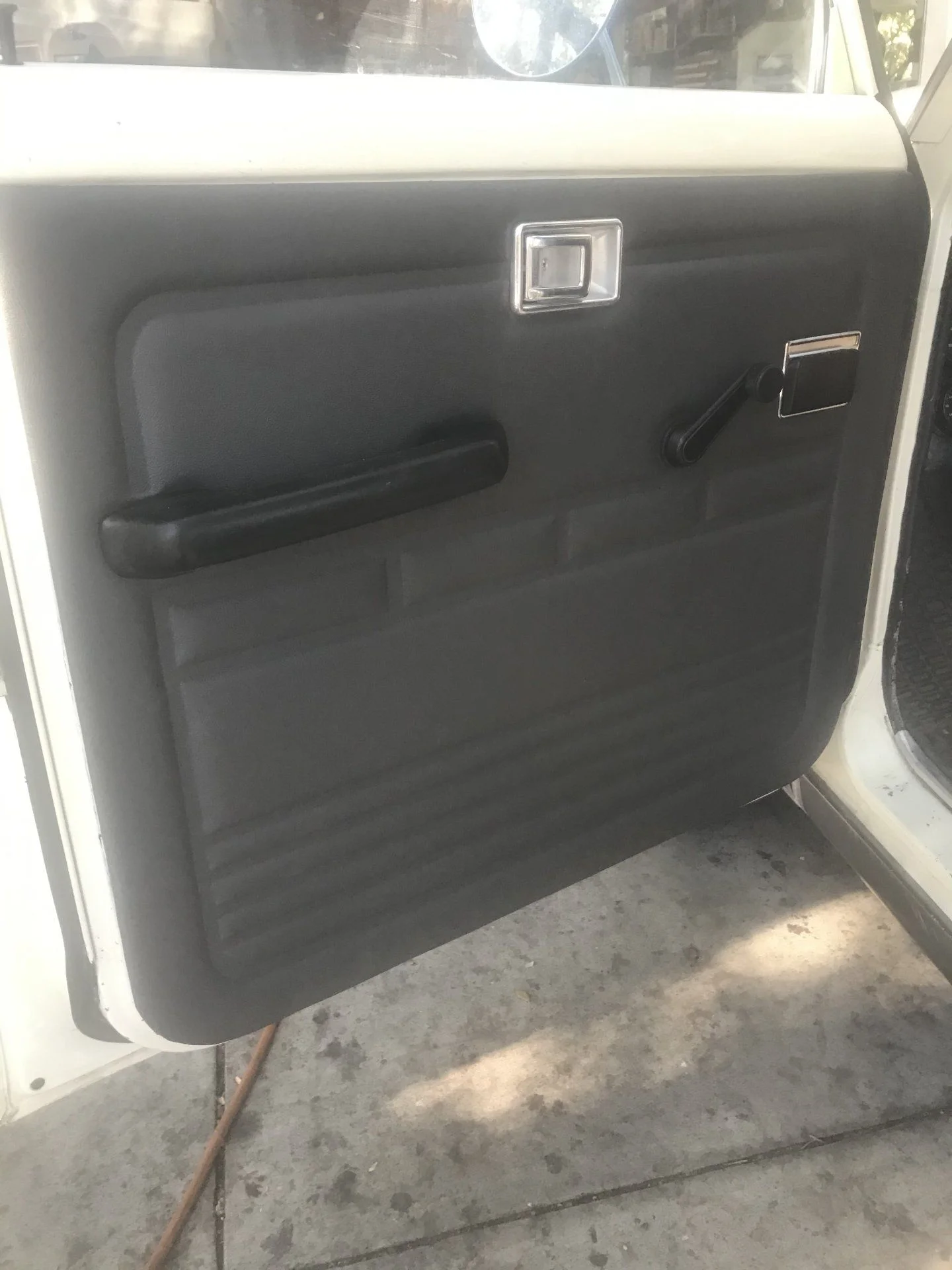

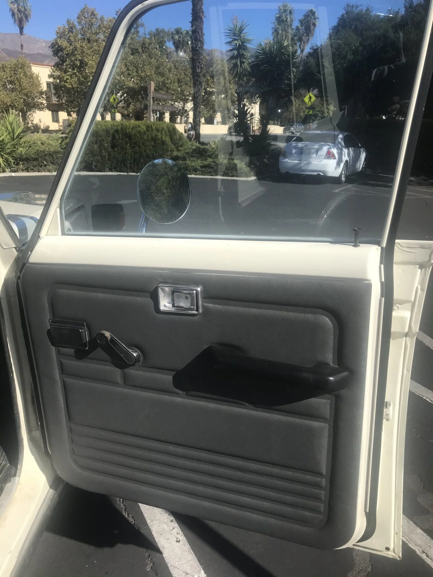

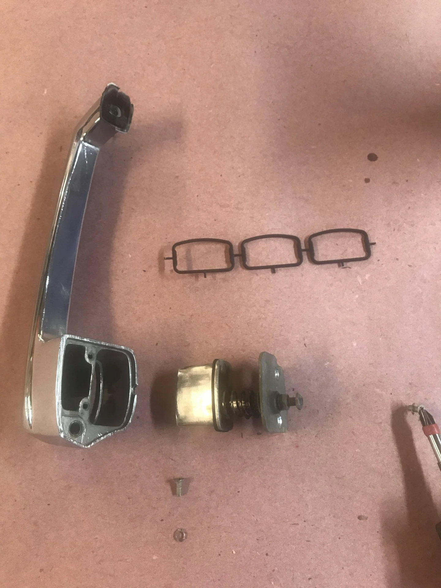

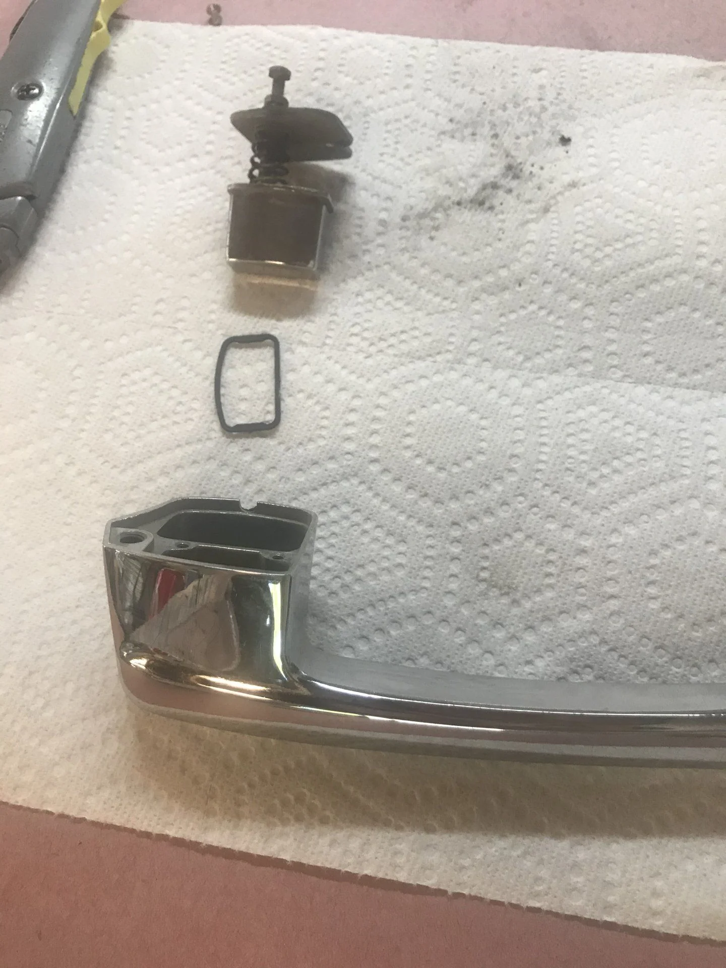

Cleaned and lubed the door latches and locks on 4 doors including install of the new latch button bumpers supplied by one of the knights. Memory not so good any more as to who (Pablo ???)
got the two new front door cards installed and the two rear doors cards prepped ready for install tomorrow
Hope they fit well and allow for smooth operation and keep dirt/dust out!
yes they installed and fit perfect. With those and a bit of lube at all the swivel points the latches and locks work quietly and smoothly
After scrubbing loose the dirt and dust on the interior of the doors I sprayed some ospho then a coat of ivory color paint that matches the original interior perfectly. Now the interior of the doors are preserved and the four door panels installed. Will attack the B pillars next week and leave the rest for another time. These door panels added another level of sound deadening also. This is the quietest this mistress has ever been and for under $5,000.
I’m feelin like I might want to get a gold front tooth next.
I went with the polished aluminum door release cups instead of the original black plastic ones in memory of my 72 pig I had in the 70’s and the dark grey panels to go with the bronze exterior. Had an all black interior once and it was to much black. (If thats possible)!

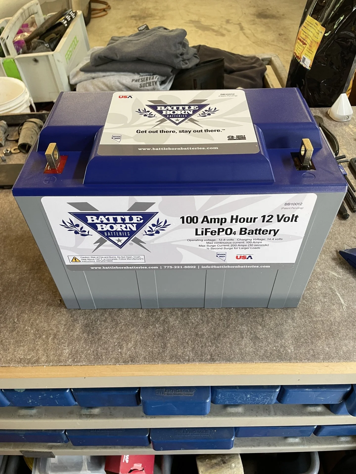

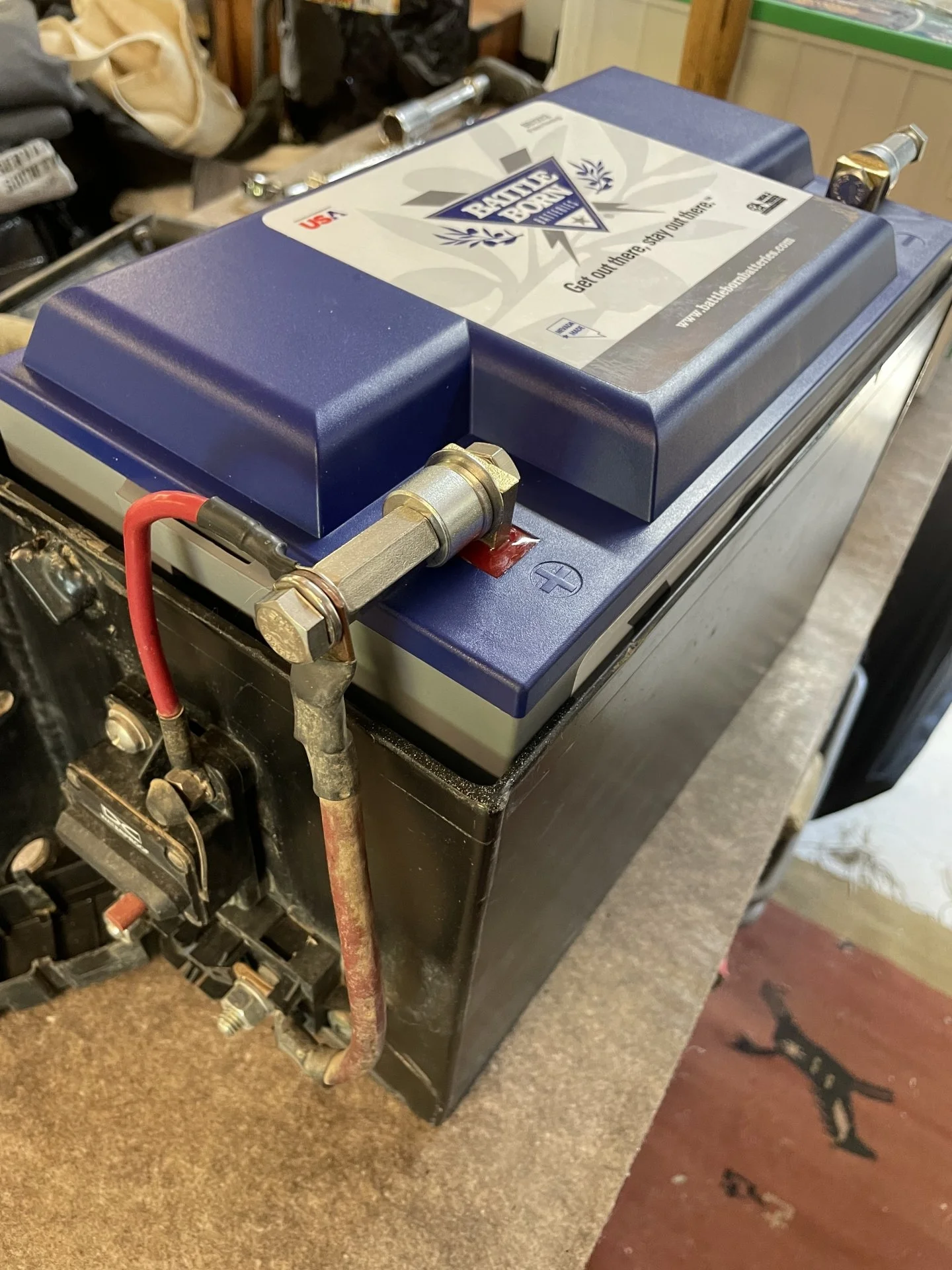

So the lithium battery experiment has begun. Although I mentioned this in the PP thread, I figured I should but it in the build thread. Contrary to my statement earlier about not attempting this for the long PP drive I may give it a try. Caveat is that the dc to dc charger needed hasn’t arrived. Hoping for tomorrow so the I can test the system for at least 3 days.
pics are of dry fitting battery in box, snug fit. Then created extended battery posts to accommodate existing wiring so modification of wiring at the battery location is not necessary at this time.

as I mentioned in the PP thread, the starter battery keeps the house battery charged when the engine is running. They don’t speak the same language so the charger keeps them separated. No more using in parallel. In an emergency you could use jumpers to start the pig but lithium batteries aren’t geared for that or operating heavy loads like a winch.
Your battery is more forgiving and robust than you are giving it credit for..
From Battle Born,
Built-in Battery
Management System
Our BMS keeps you and your battery safe and
ensures your battery will last for many years.
• 100 Amps Continuous
• 200 Amps Surge for 30 Seconds (More than enough to start your pig)
• ½ Second Surge for Loads Over 200 Amps (More time than it sounds when we are talking about inrush current)
• High/Low Voltage Protection
• Short Circuit Protection
• High/Low Temperature Protection
• Cold Charging Protection
• Automatic Cell Balancing at Top of Charge
*Please Note: This built-in protection will reset after 5
seconds in most fault conditions. Disconnecting the
battery from loads will also reset the BMS.
As long as you are getting 13.3 volts minimum back to that Lipo battery you’ll get nearly all the benefit of switching from the lead acid.
