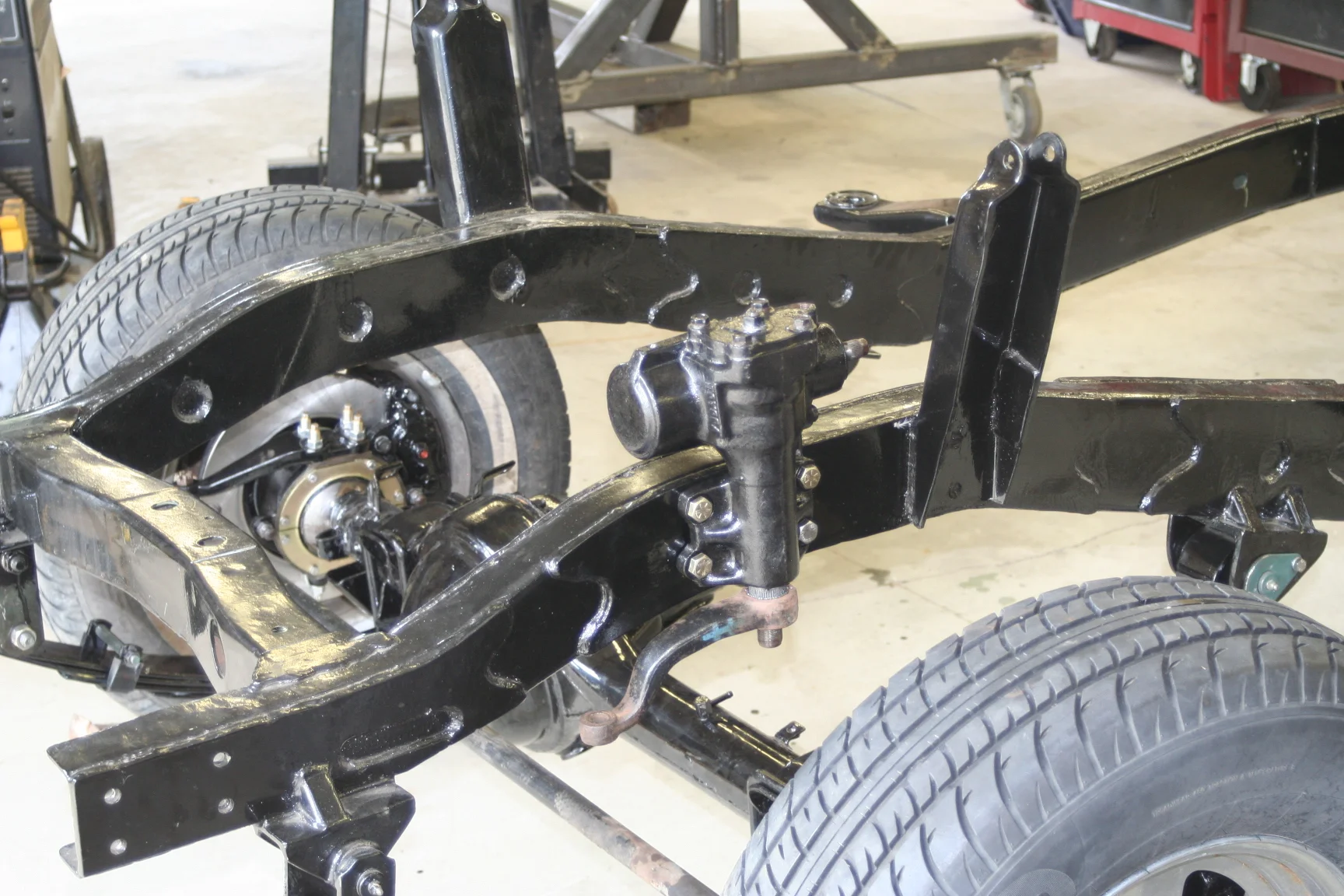

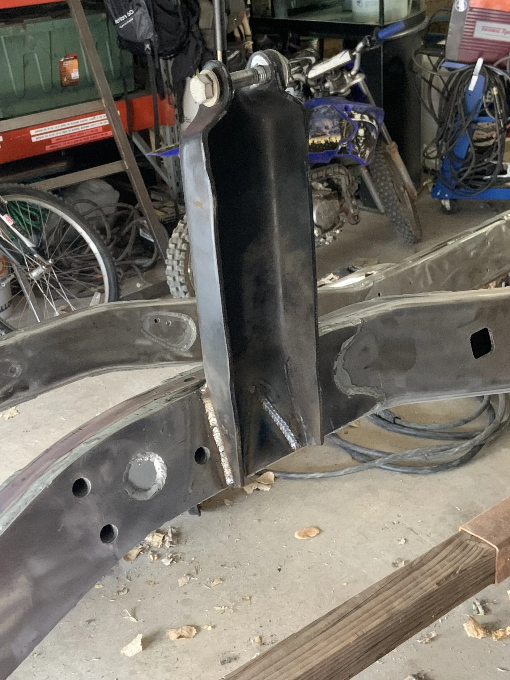

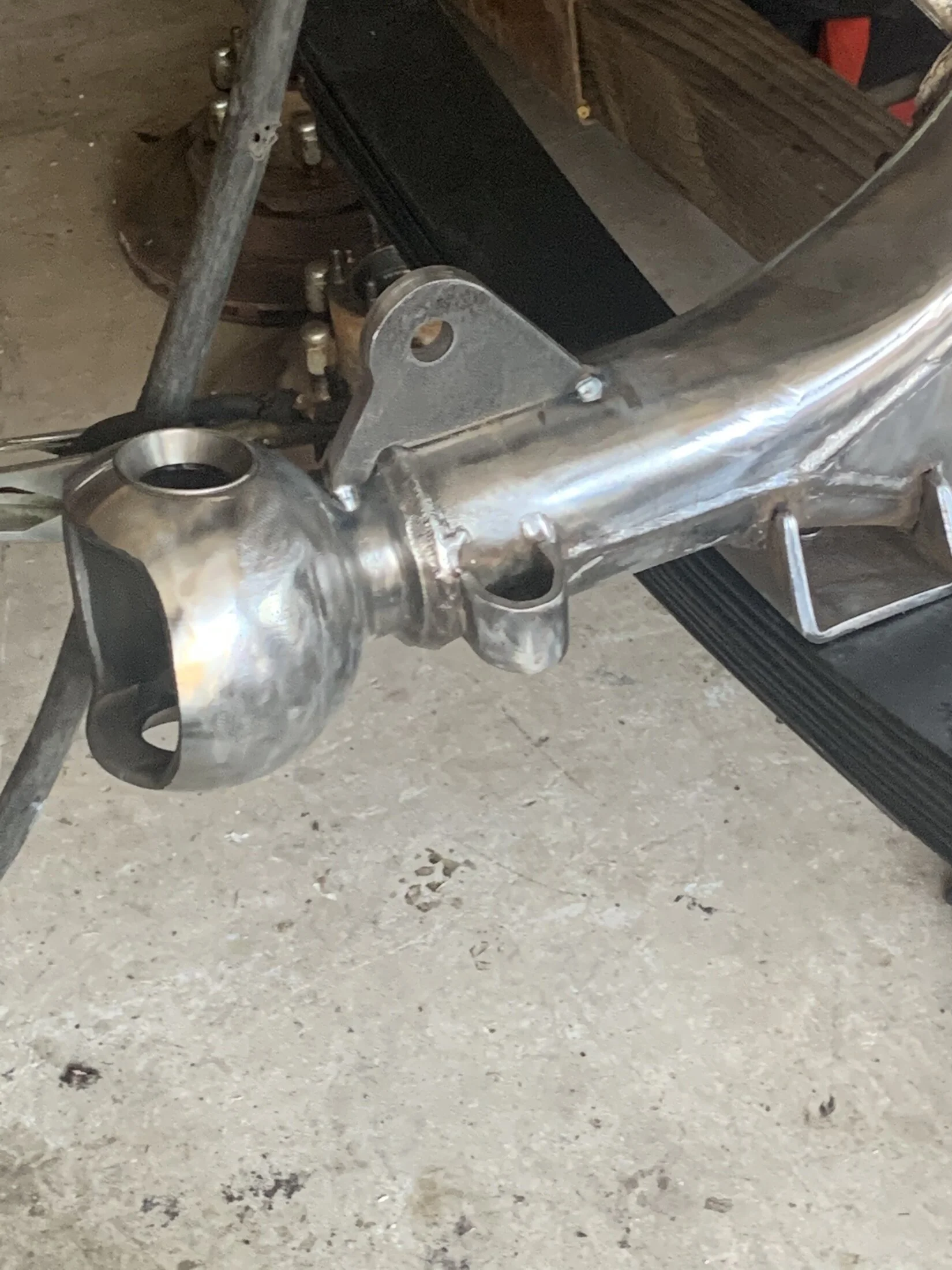

Nice welds!
It does but it’s negligible. Would have been better to weld the mount on with the normal load and spring position but that wasn’t going to happen in my case.Nice welds!

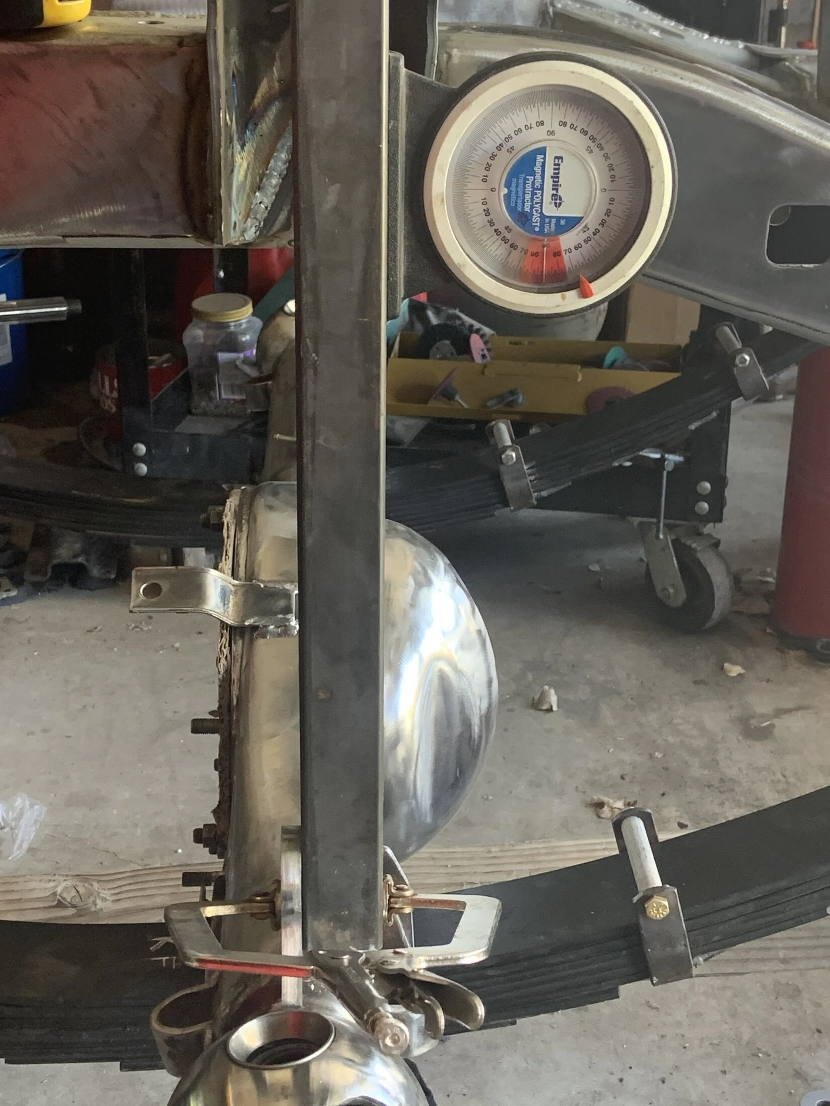

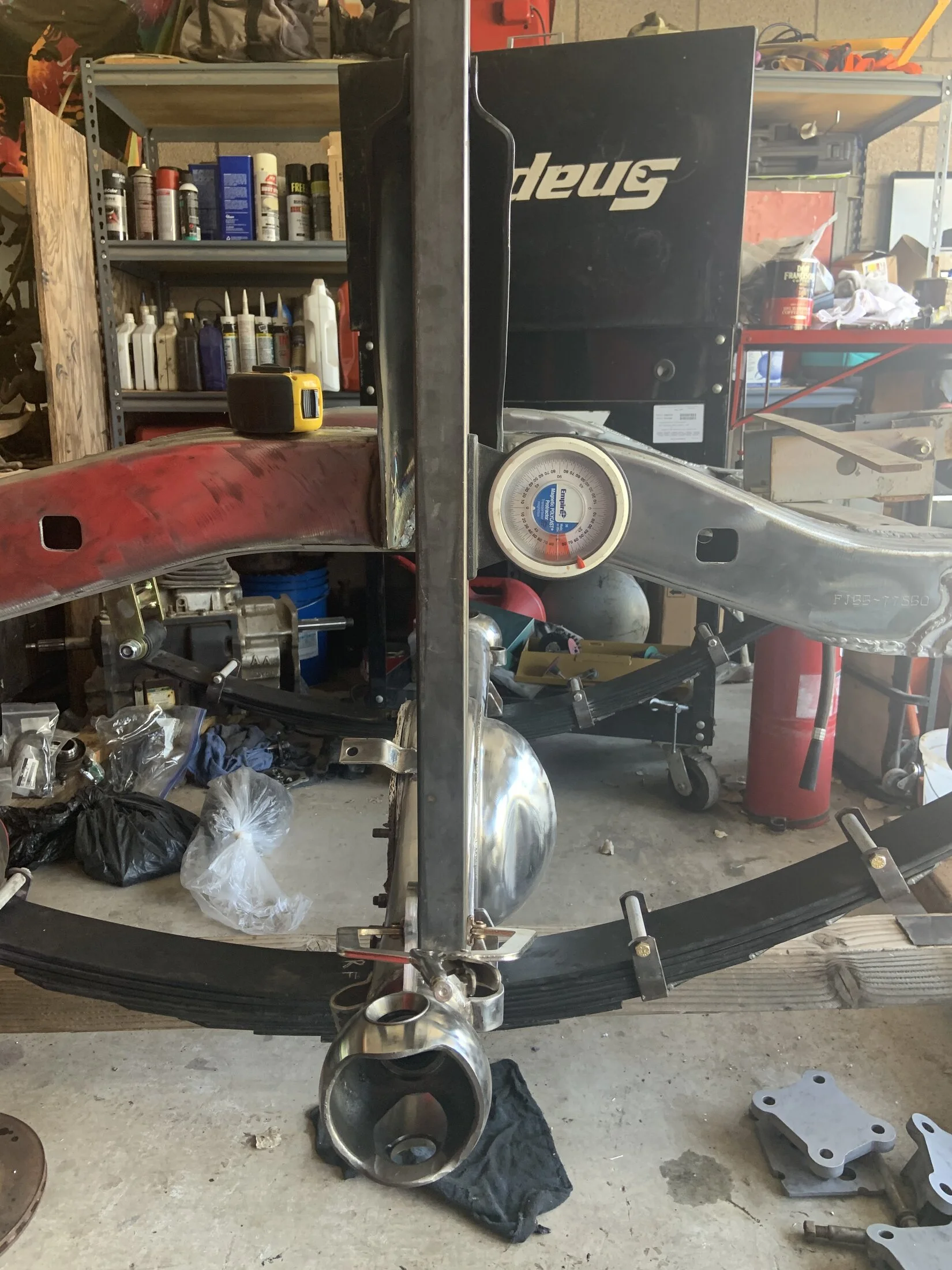

You set the axle mount for straight up (0 degrees) at full droop? Does that change a little when stuffed?
Completely understandable!It does but it’s negligible. Would have been better to weld the mount on with the normal load and spring position but that wasn’t going to happen in my case.

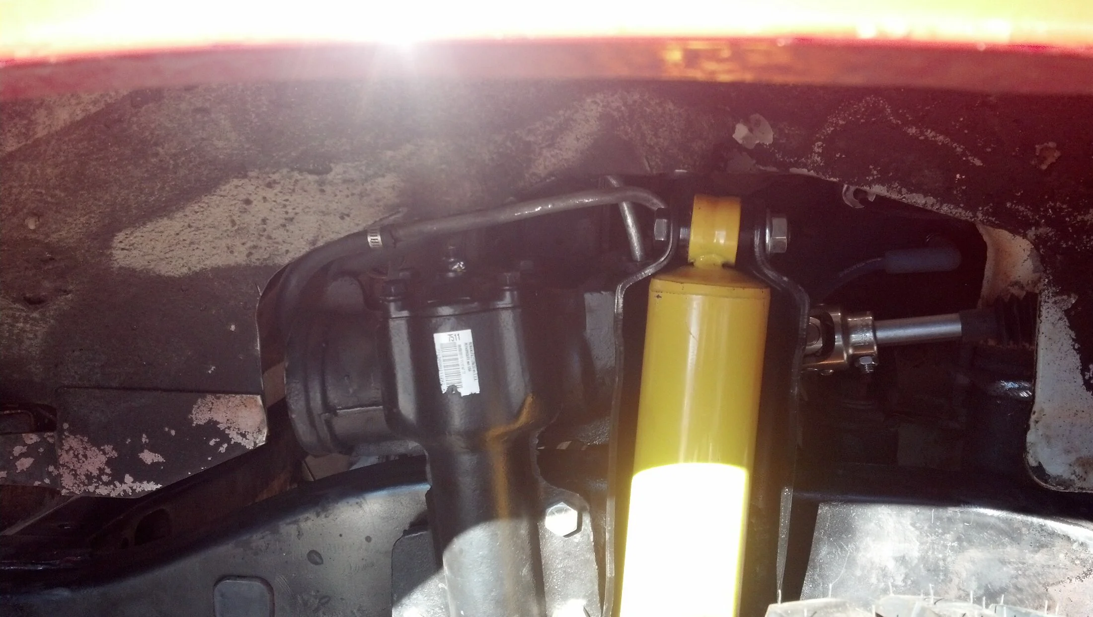

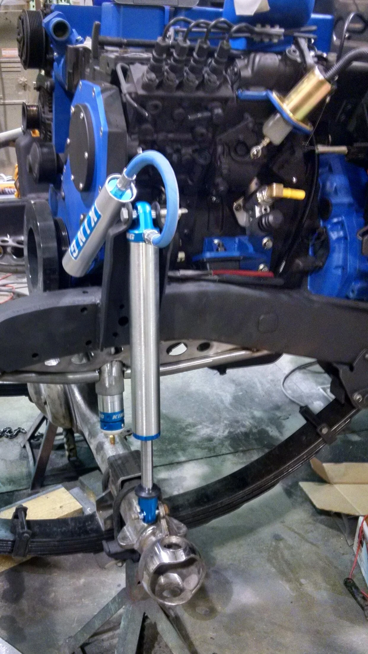

I had to do the same when I had the OME shocks to get the angle and length correct.Here's mine, but I played with the angle a bit and can't remember why?
These appear to be further aft than many I’ve seen. Are your lower shock mounts behind the axle centerline?
