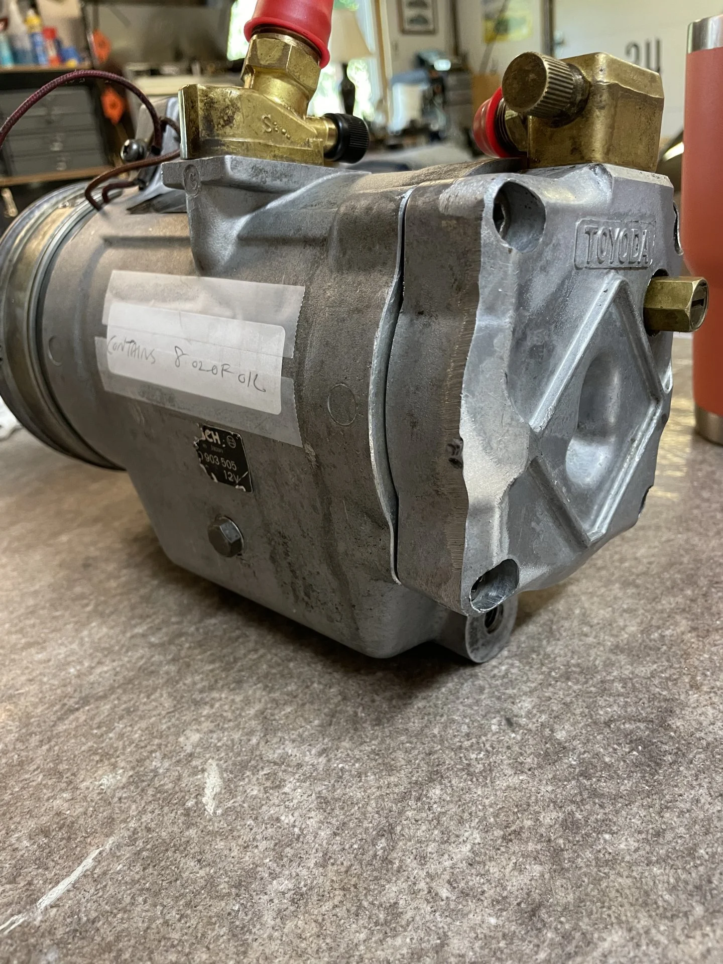

Yahoo, went to smell-a today to pick up the rebuilt Toyoda ac compressor. It is a non-binary trans gender compressor now. It has a Japanese made German body with a Toyoda butt.
Next week it will get installed into the multi Asianal pig with a South African refrigerator powered by American auxiliary batteries sun sucking jigatWATT panels.
I don’t think I’m going to the olympics any time soon. But my pig might be eligible.
Peace, (or is it piece)

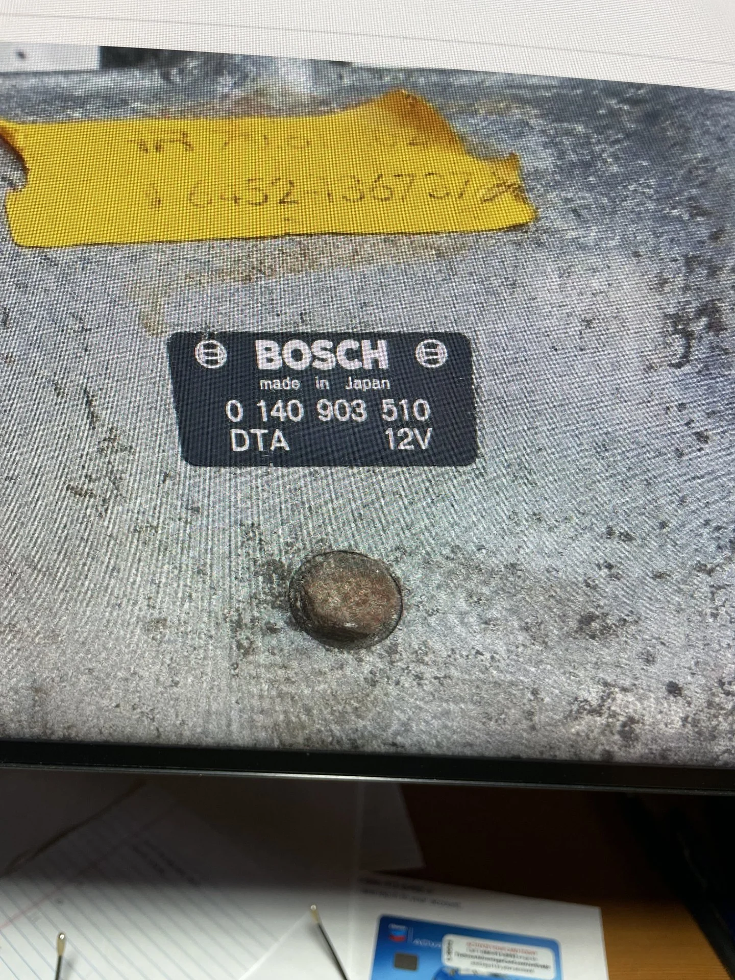

So today the AC is back functioning in the Silver Spoon with the install of a Japanese/Bosch/Toyoda compressor. It works quite a bit better then before.
Maybe is the mixing of blood lines!!!
Happy camper.:geek:

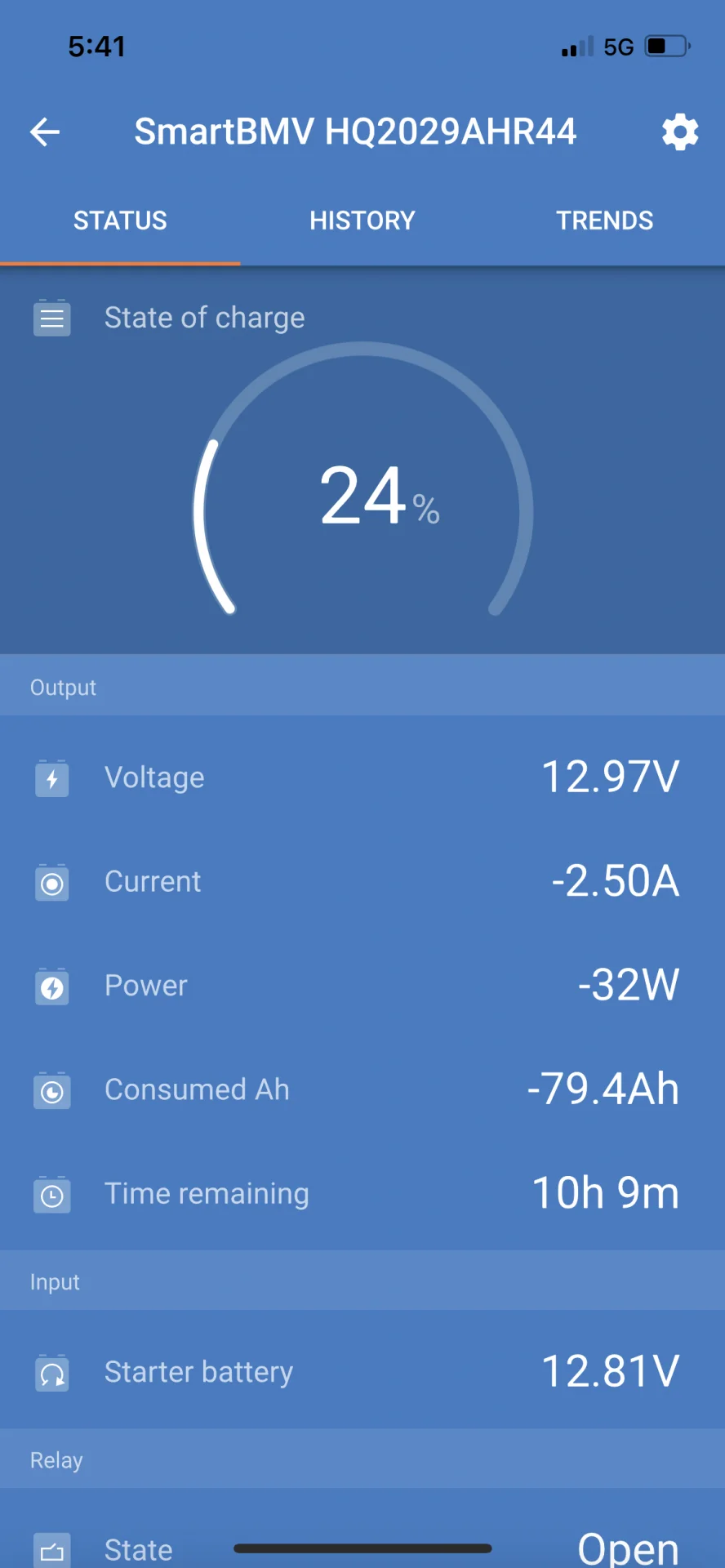

So I have finally sorted out the new lithium battery system for auxiliary power to the SilverSpoon. When I merged the DC to DC charger wiring diagram with the monitor diagnostics wiring diagram I ended up with to many negative connections and not enough ground connections, casing a continuous drain on the starter battery. I made a simple diagram into a complicated redundant diagram.Duu
It is now all sorted out. The resulting performance of running the refer on a full lithium charge is 3 days of light use and no recharging. Heavy use would be 2 to 2-1/2 days.

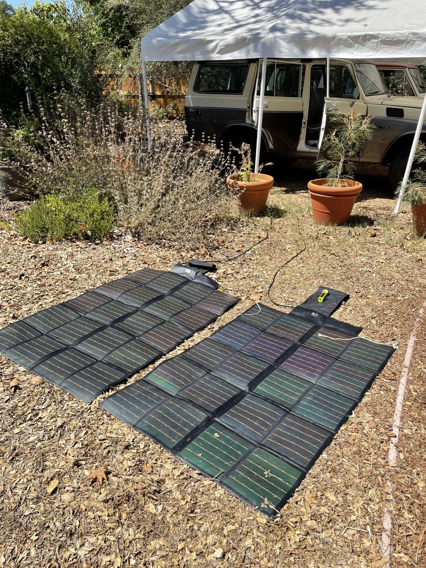

If the 250 watt solars panels were connect might be able to sit there indefinitely. Going to have to do that test next.
Follow photo of the monitor reading is after about 68 hours of continual operation with no charging

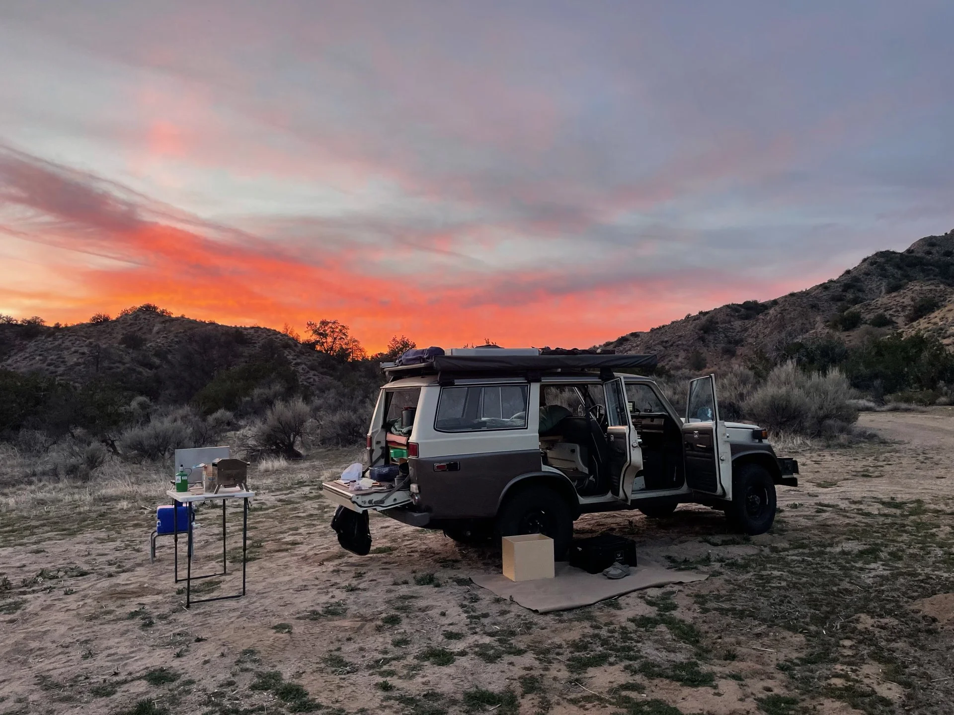

Thought I’d come out of hibernation and do an overnight to stretch our legs.
primitive camp site 90 min outside of Ojai. running silent

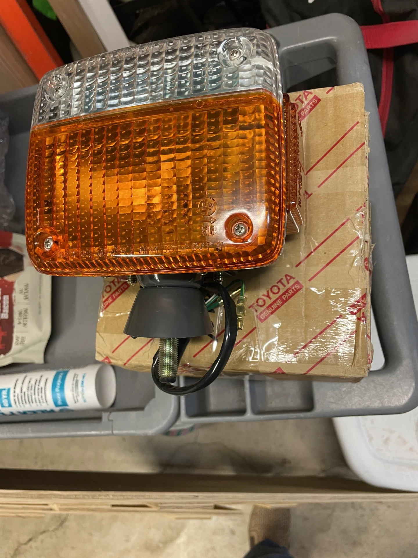

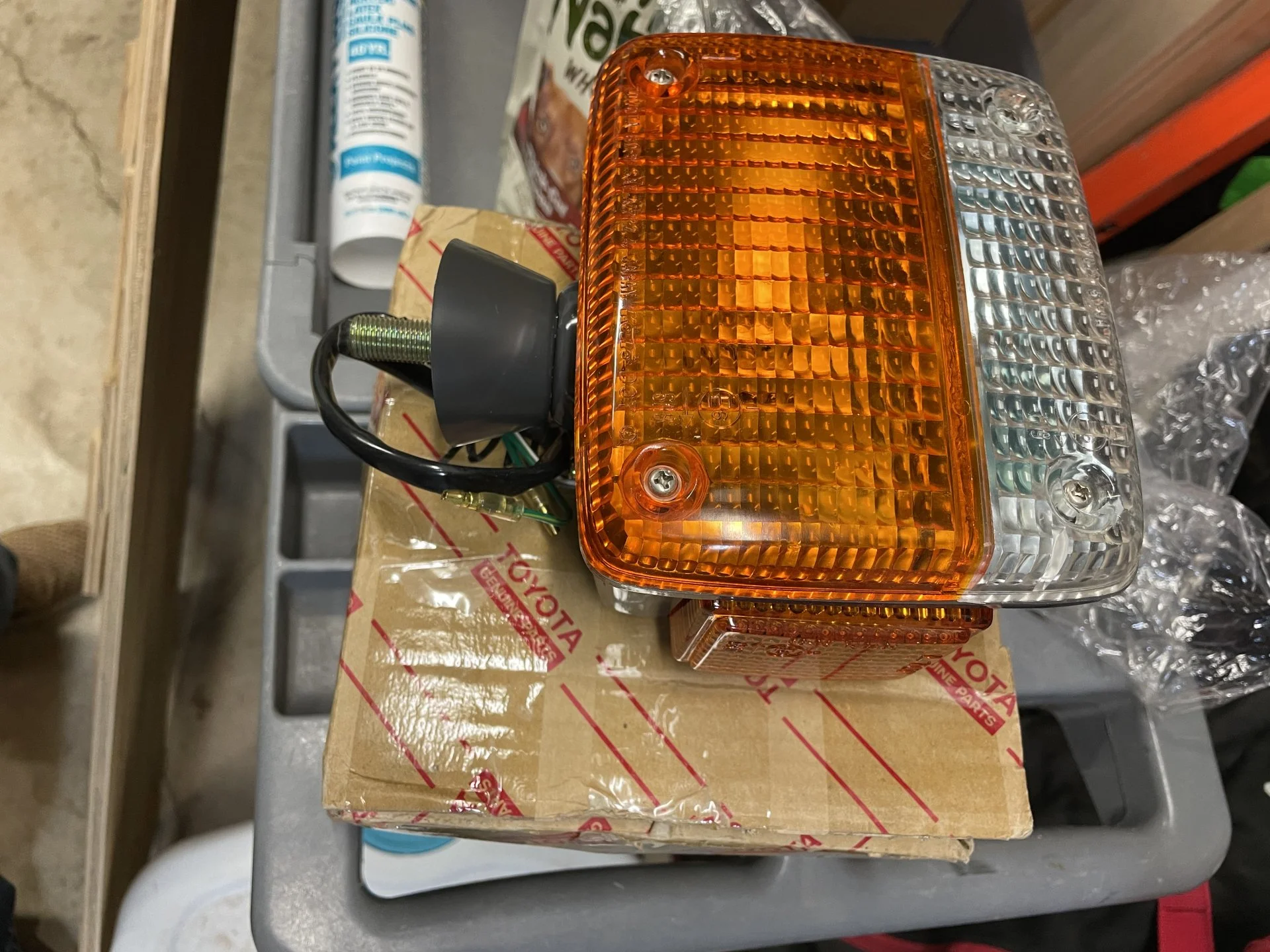

also going to replace blinkers that have seen better days. Thanks to wardamneagle for middlemanning a pair of brand new factory ones from the Middle East connection
