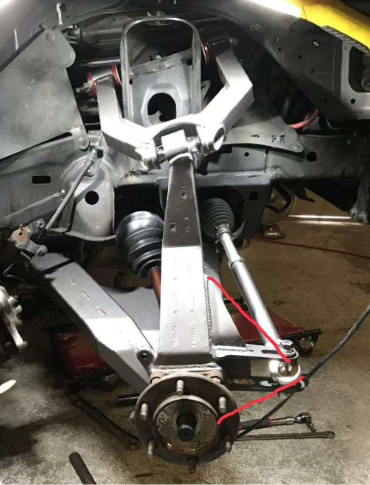

Marlin needs to re-design that, way too thin to have that much stress on it. Almost looks like an after thought after seeing the rest of the design????
Agree. When I first saw it I had a bad feeling that would be the weak link.
1899123
Yeah, don't know that the hell they were thinking with that. My Cruiser's engine mounts are stronger then that and they barely see any load. They should just weld a shock mount on it and box the other side if it's intact for the 4400 race they said they were going to run on Friday. I want to see this thing on some rocks!!

While in one of the tightest sections going around 20-25mph, we both felt our Front Passenger tire hit something. We had seen a rock and thought we had avoided, but honestly couldn't see very well with a huge Blue Ford bounding everywhere right in front of us.
I looked at my Co-Driver and said "Did you see what we just hit?" He said he didn't and I said I didn't either. We drove another 100 yards or so and I started to feel our steering get really weird. We were still in the middle of a pack of 4-5 4600 cars, but I had to pull over and check it out.
My Co-Driver jumped out first and went silent. I asked how bad it was, but he wouldn't tell me. I finally made it over to the Front Passenger side and saw that we had bent the heck out of our Tie Rod to Spindle connection. We had a few comments on Facebook about this being a "weak link" a few days before and my heart sank.

Not only had sheared the steering off, but we also bent the Lower A-Arm to Spindle joint. Our Crew Chief Brittain and our two wives showed up about 2-hrs later and we were rescued:
