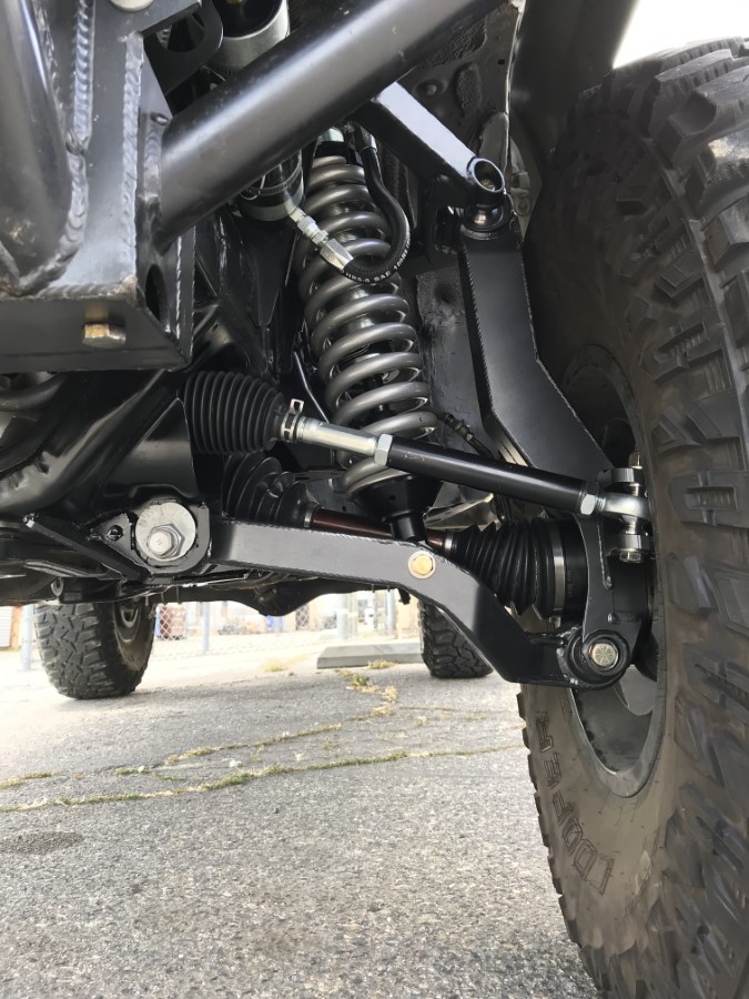

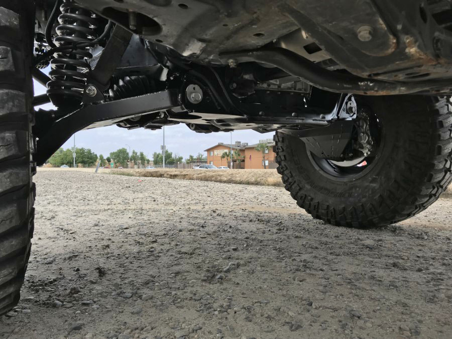

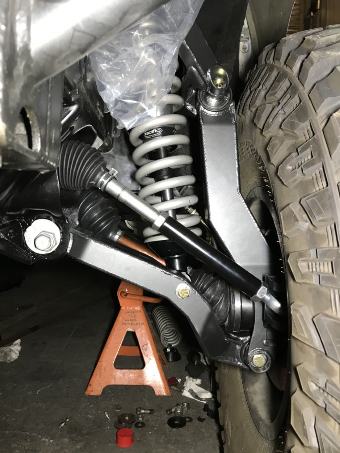

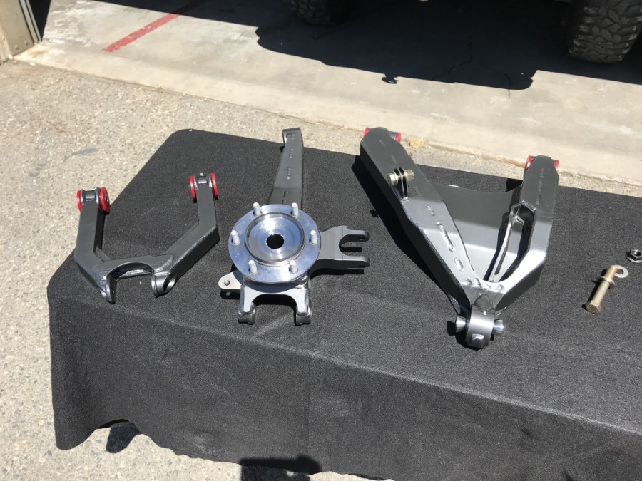

As a quick update, our Prototype RCLT front suspension is all off and will be shipped back to Marlin this week in anticipation of v2.0 in March:
Stay tuned.

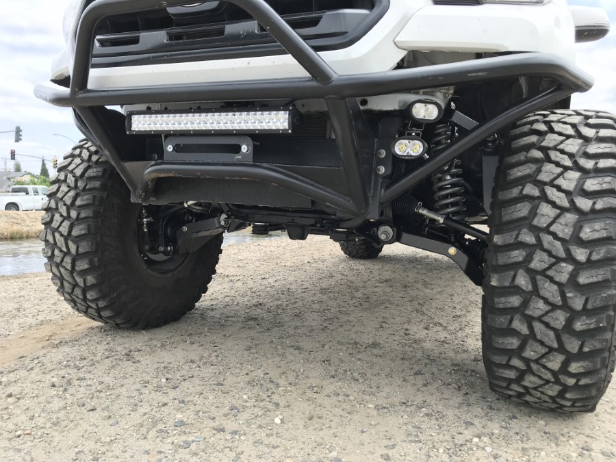

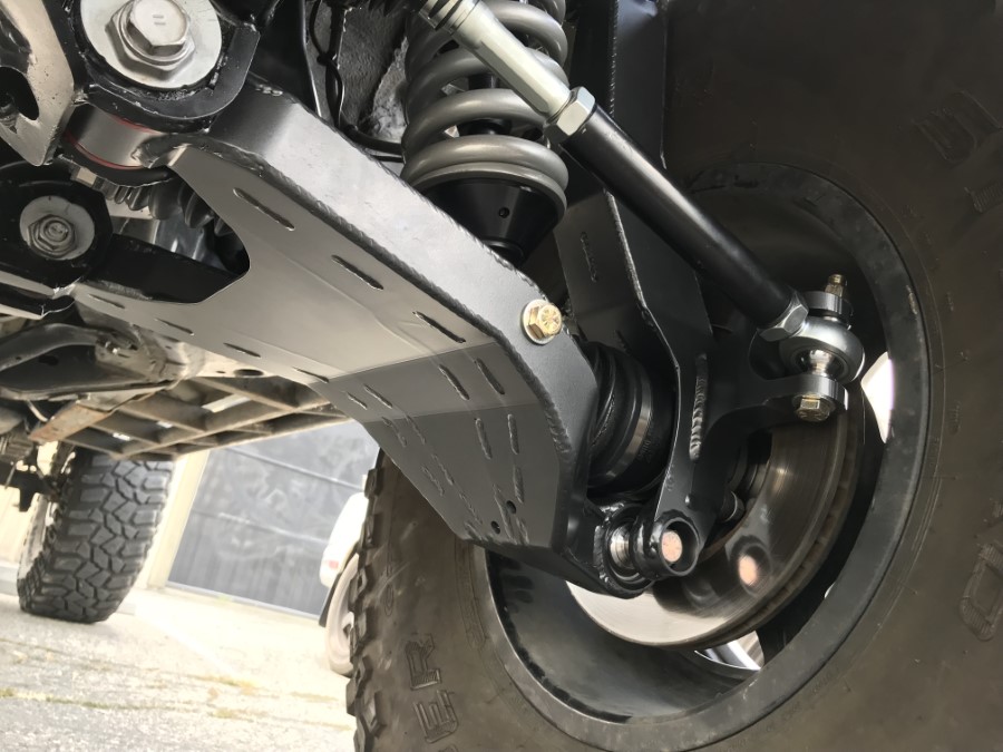

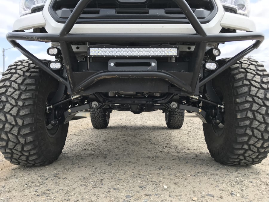

Quick Update: Here's what we've been waiting on - straight from BigMike at Marlin Crawler:
We've been receiving regular updates from BigMike at Marlin Crawler over the past few months since KOH and are really excited to see his announcement of their RCLT v2.0 Kit.
Even better - the first version of v3.0 of Marlin Crawler's RCLT kit that he hints at in the posts is coming to our Steel City Racing 4Runner in a month or two. Can't wait to get our hands on RCLT v3.0 and finally get the 4Runner out of the garage!
Also, a few more technical specs and details can be found in BigMike's personal build thread here:
And some pics of his Tacoma on 40's with RCT v2.0:
As a side note, while we've been waiting for RCLT, we stripped the interior, applied a finish coating to our roll-cage and all steel work, re-routed our fuel lines to get rid of some excess hose, and are working on a few small upgrades including looking for ways to cut weight.
We also have a few more upgrades planned with RockSolidToys and Otwell Fabrication for KOH 2020!
More to come...

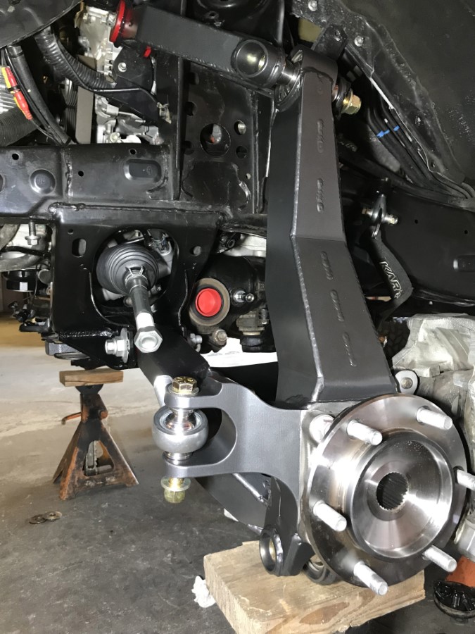

Yes, significantly beefier where it needs it. I saw the post on FB, but these shots really show the difference in engineering.
More to come...
