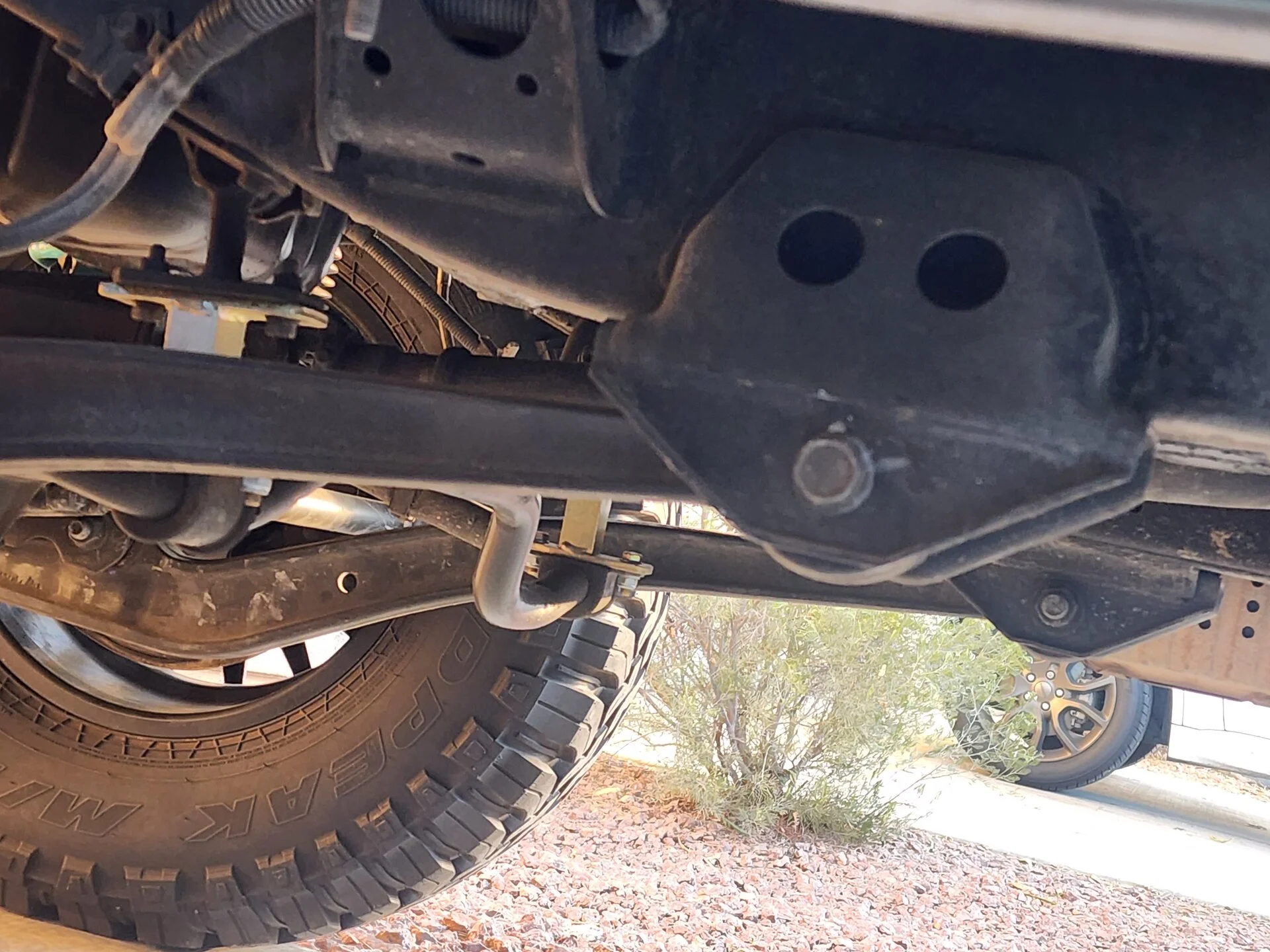

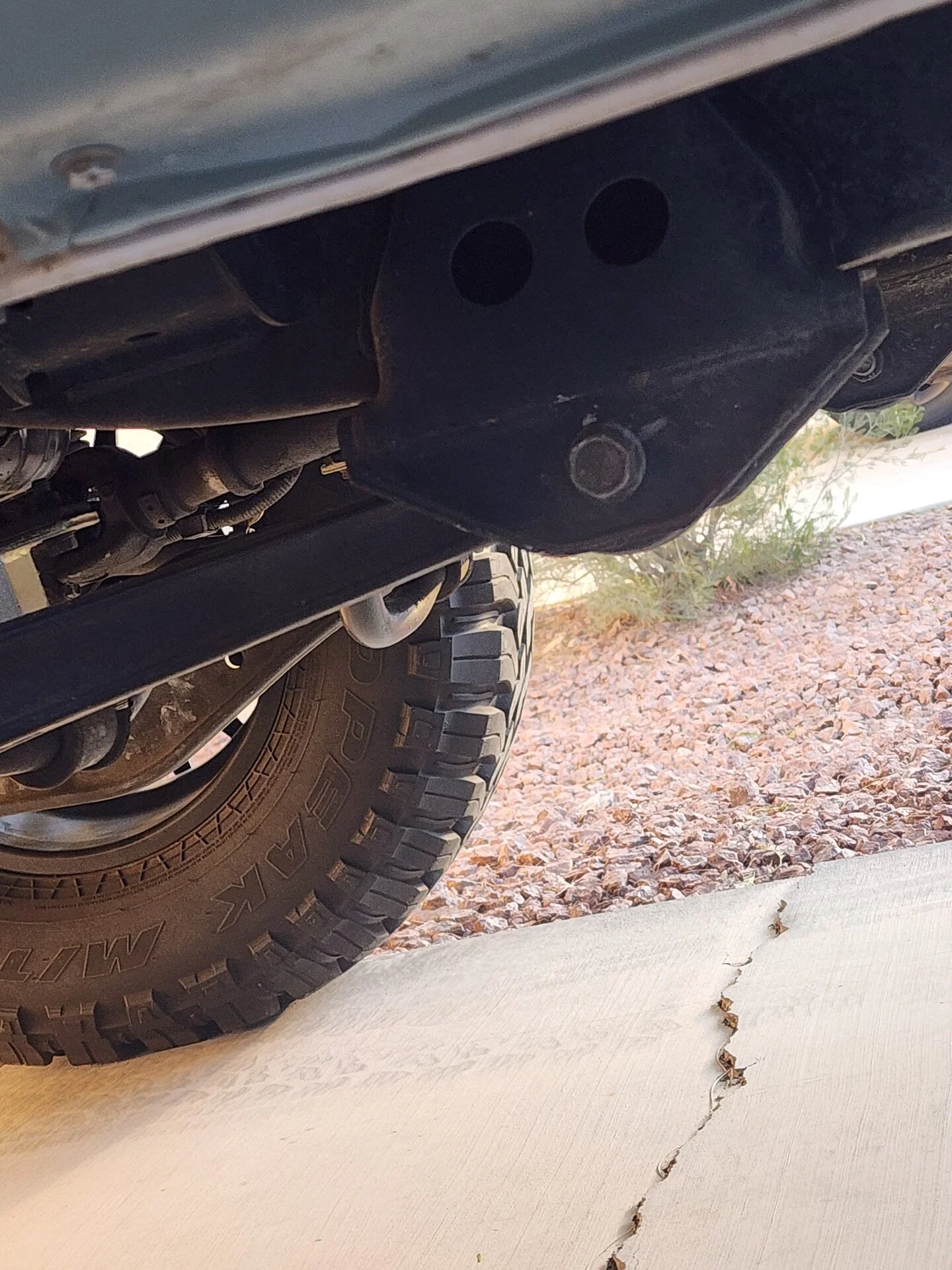

If you don’t know what you got take a pic and share. Our clarevoyance is limited. There are no oem drop brackets. But there are frame side radius arm mounts. They are asking if you have brackets to further drop the frame side of radius arms to address castor instead of bushings, plates, or aftermarket arms.

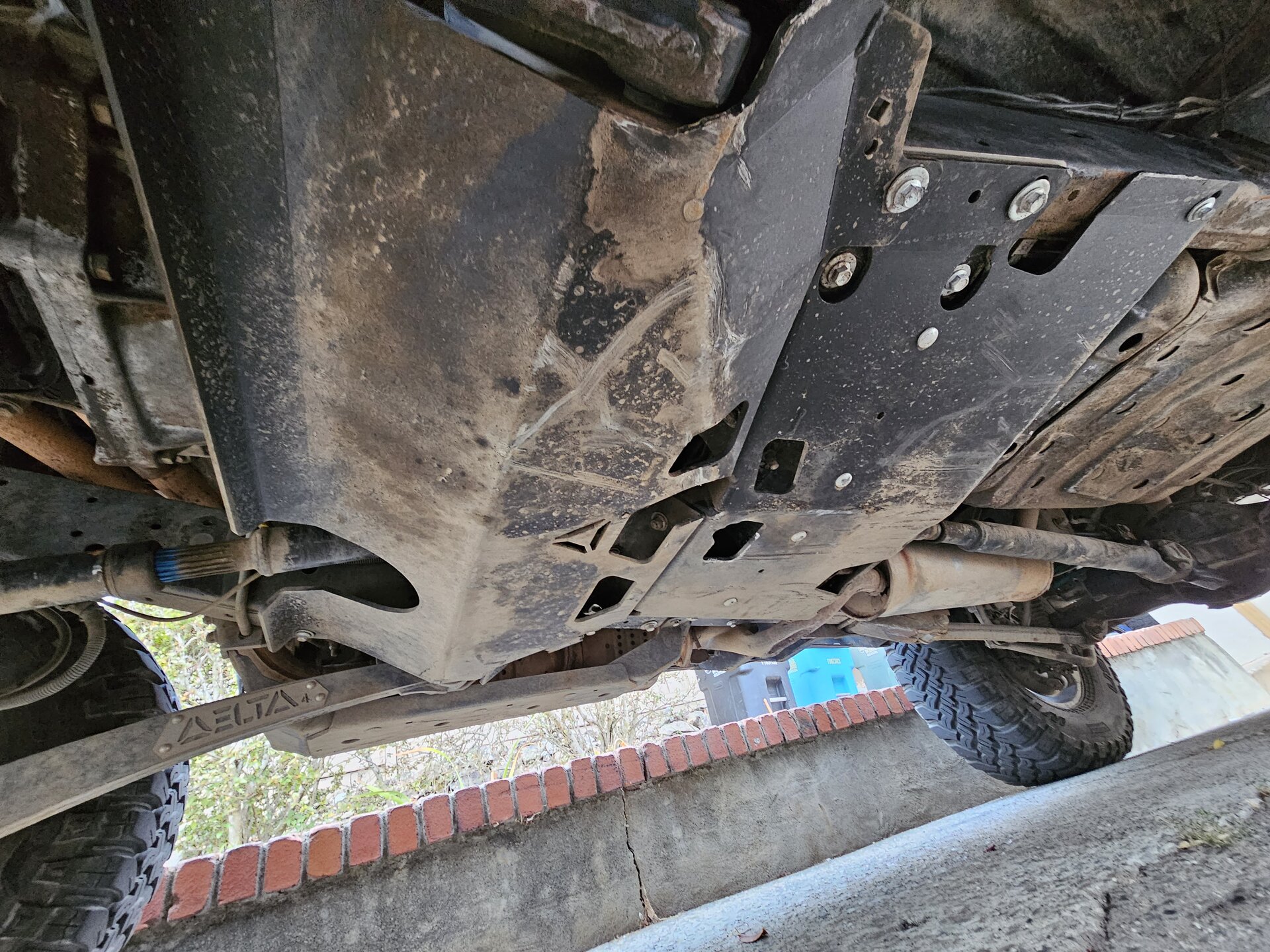

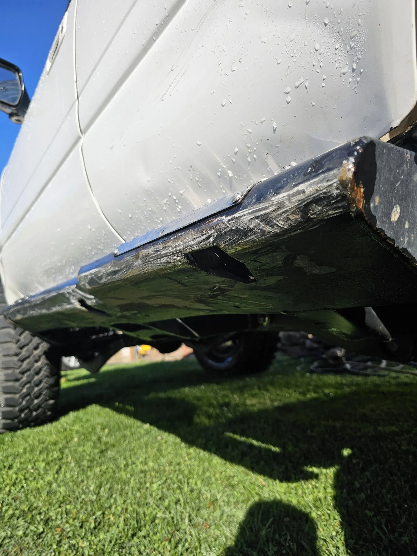

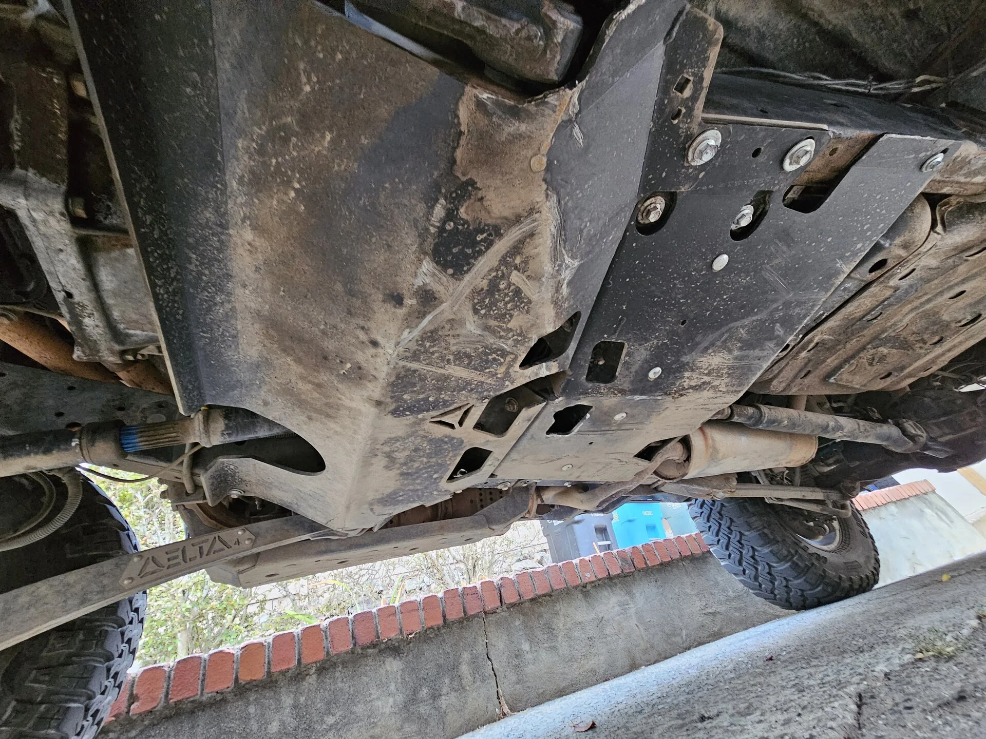

Some pics of mine...as mentioned earlier WKOR with 15 degree angle and kickout. Mine is a 94, so cat protection will be different on yours...I think WKOR is one of the few that tailors the skids to model year cat placement. Kickout is important in my opinion if you still have flares...it saved my rear from damage a couple of times. Fortunately my 94 has the exhaust over frame after the CATs so I don't need to worry about the extra protection that you and @Rusty Marlin need. One note on my CAT protection...looks like a lot of extra space there, which there is...they were made for the OEM CATs that hang lower which I replaced with the Magnaflows which are much smaller...I may do something about the skid to give a few extra inches of clearance in this area.
And a few "use" shots...definitely saved some damage on the underside and rear flares on more than one occasion of a hard wheeling weekend....
And a shot of the Slee transfer case skid that was installed by the PO on mine, definitely put to use as well.

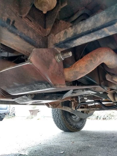

Next up is something for the rear diff....

Here's a couple pics..I'm guessing these are just the factory mounts you mention...
