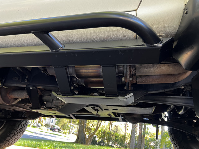

Creeper skid looks solid...mine came from PO with the Slee which is beefy too. I have the WKOR sliders and really like the option to have them in DOM tubing for piece of mind. Haven't crunched mine yet, and not really excited to do so as I want to enjoy my rig but not bash the hell out of it. The only thing on the WKOR on the 94 is that I changed to the Magnaflow cats and they are quite a bit smaller than the OEM, so leaves an unnecessary gap there, which seems to be the low point overall. Definitely not a WKOR issue, but I may pull at some time and have the skid raised up about 4-6" by a pro welder that does frame work near me (did a Taco frame repair for my son and was super solid). I also like the bolt on, choice for a shorter version to keep my mud flaps, and choice of angle (I chose the steeper angle rather than flat).
You can judge the gap to the cats better here...

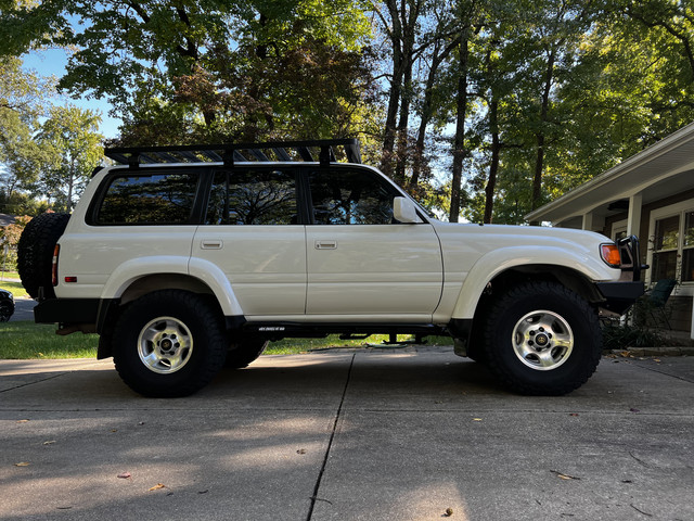

WKOR DOM 10deg full length (no flaps) Full dimple top plate, DIY paint
Here you go. These are one of the best you can get IMO.
Looks STOUT!
