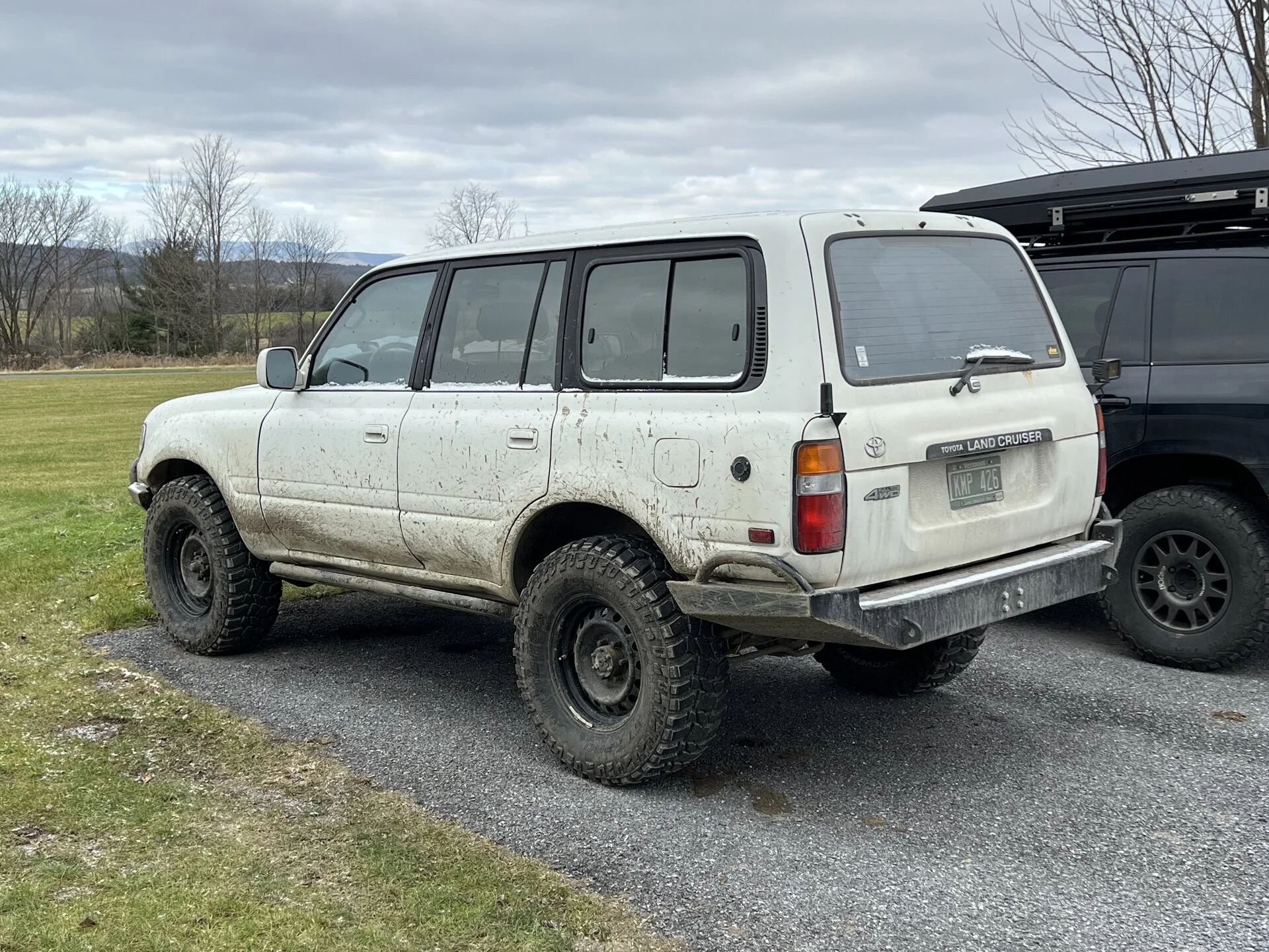

Best? Dunno. I'm running 17"x7.5" steelies from a 4Runner and have been happy with them. I do not run spacers, and I get some contact with the rear frame rail on full stuff compression offroad, but not enough to bother me. 35" STT Pros

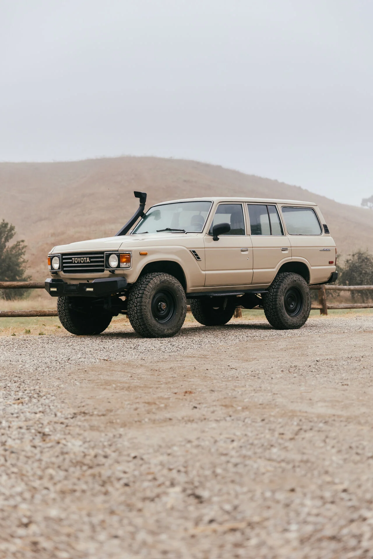

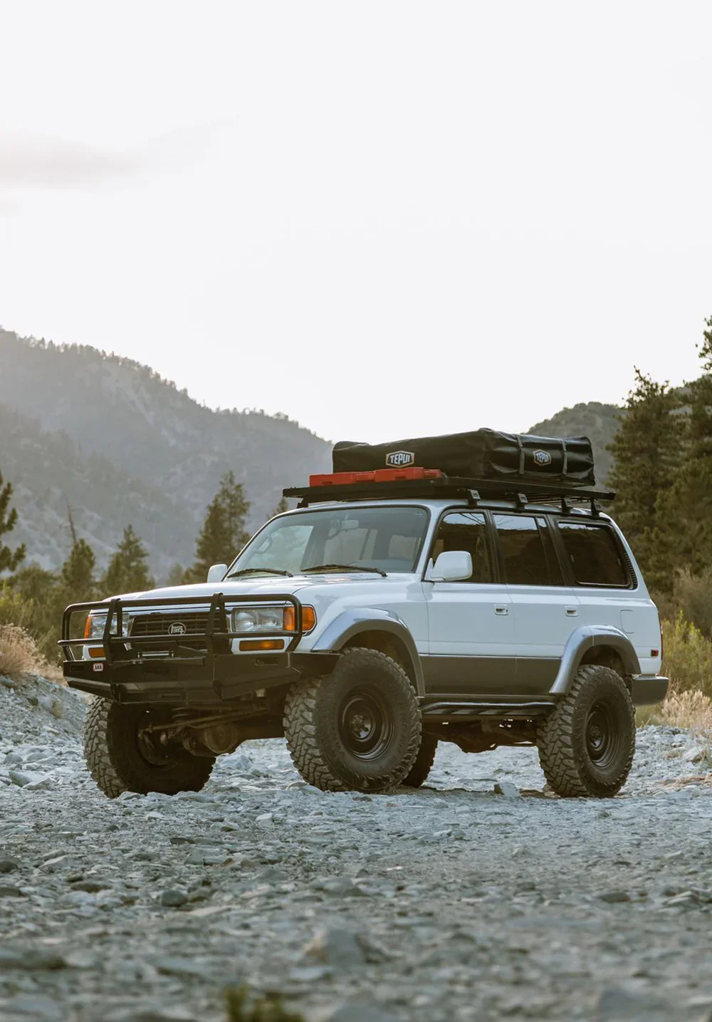

17" alloys that look like split steelies by Fifteen52
From Fifteen52's gallery. I love these. They have steel wheel look but are an alloy.
Not my Cruiser

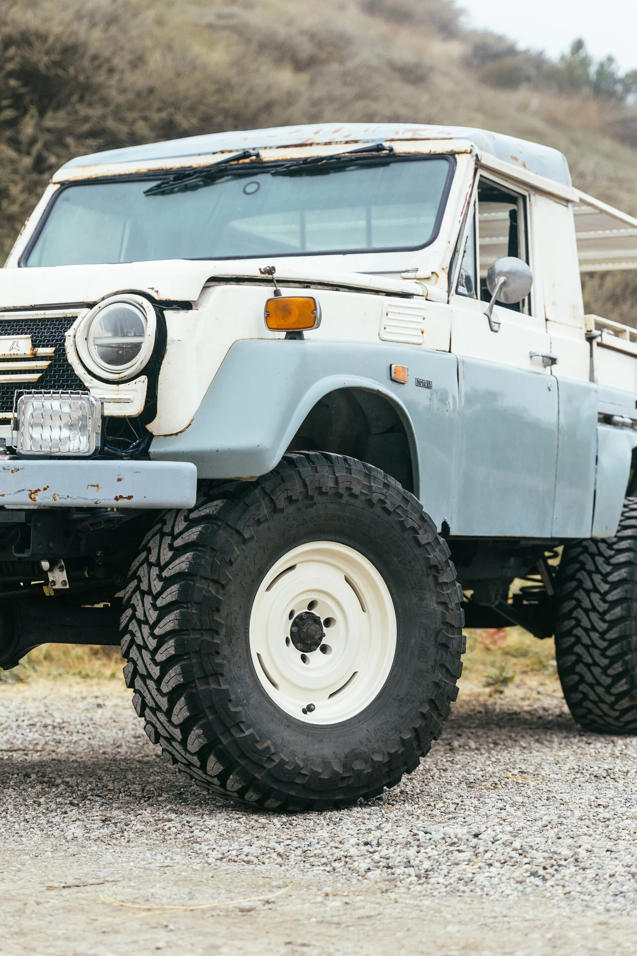

Have them on my 60 as well

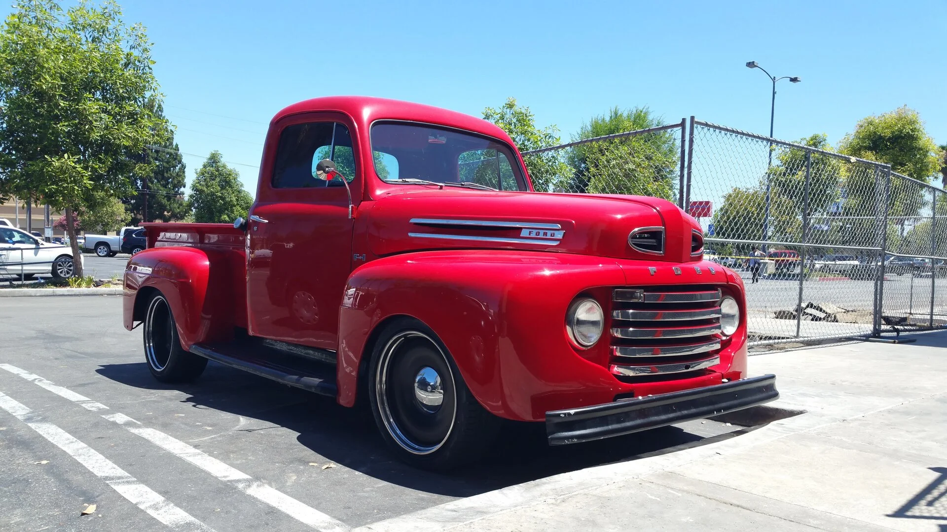

Has anyone used Detroit steel wheels? I'm planning to use their D-town smoothies in an old F-250 4×4 patina build I'm doing. They have a clean look with hub caps.
I have them on my '50 Ford F1. I ran a 20x9 Front and 20x10 Rear. I did not go to aggressive on the offset since I have an Air Ride system waiting to be installed so I wanted them to tuck in the fenders when fully aired out.
