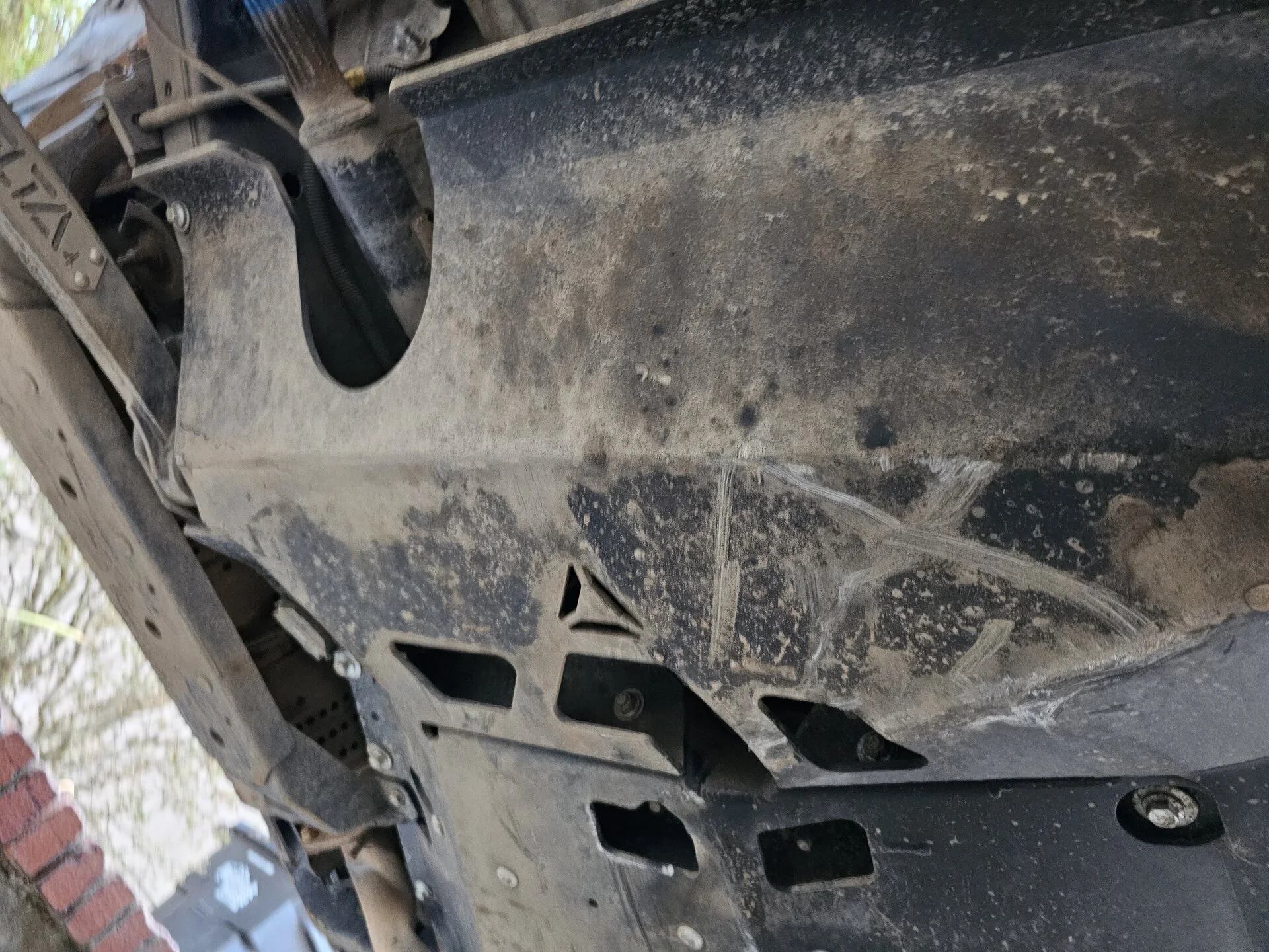

Our design has a separate skid plate and cross member, so if you need to add low range gears you have way more access than oem. Holes in all the right places for draining, etc.
It also looks to hang down lower then most !
If anything it’s the lowest profile one commercially available.
The cruising offroad skid has just as much coverage and a much lower profile and is now made by trail tailor.
Just saying 😎
Yours hangs down to the bottom of the control arm frame mounts. Inches lower.
