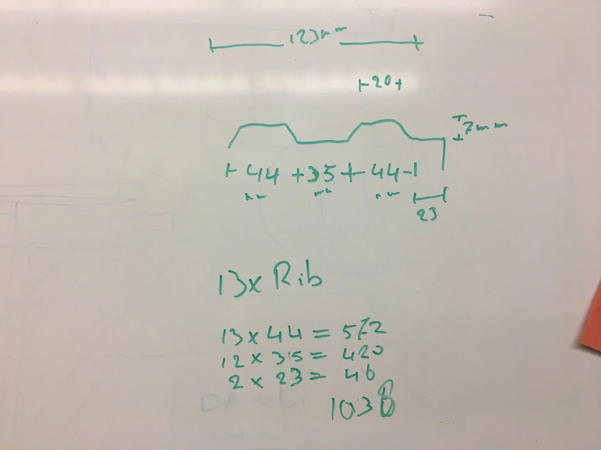

These are the sizes of the ribs.

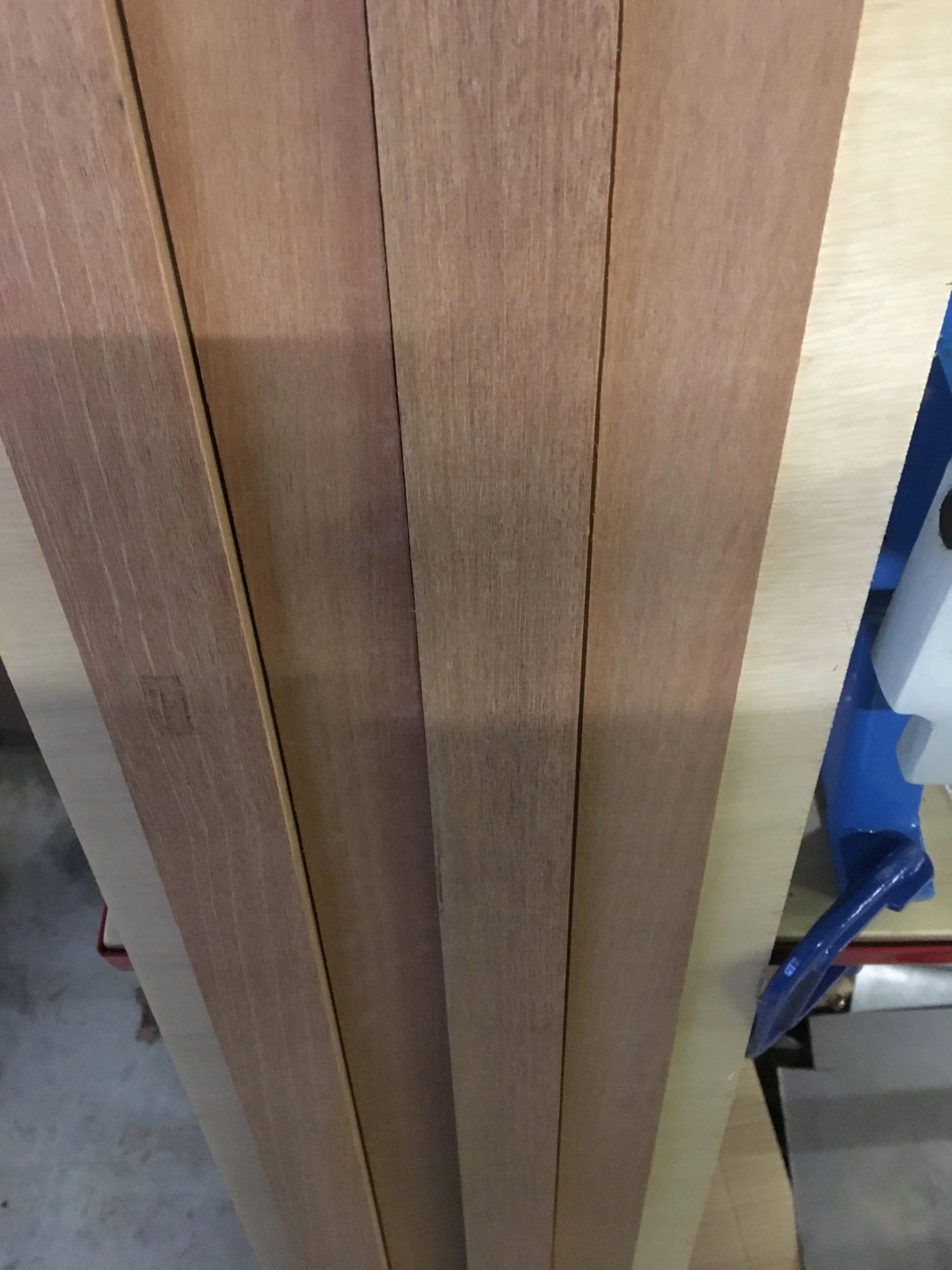

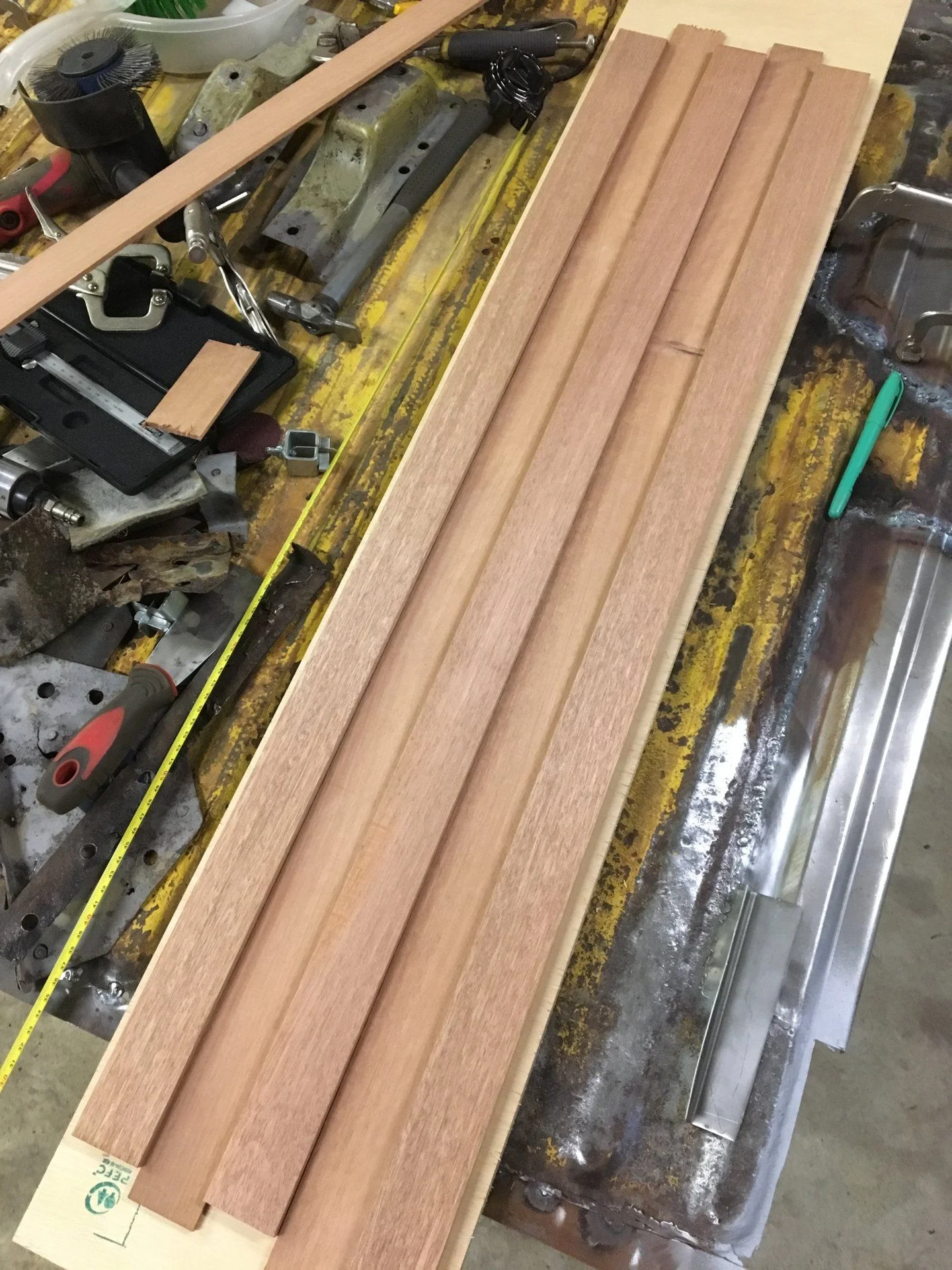

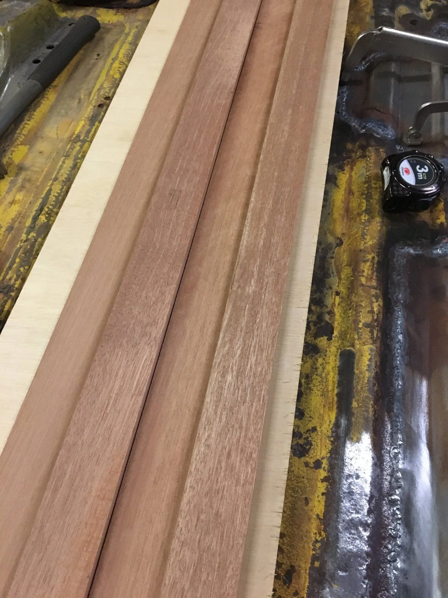

Got some wood to create a template for the ribs.
I’ve had a bottom plate cut and got some strips of hard wood.
The lower one's are still to wide and the higher one's need to be shaped in the negative of the ribs.
I want to try to make the entire panel at once.
Yeah, this thread just gets better and better! Can't wait to see how this works out. What type of wood are you using and what as a
@waiting for time that's way cool.
Thanks Nolan, I was spending a lot of time in patch panels and cleaning the paint and rust. Creating a new panel wil be more fun, results in a new panel and Provides a learning curve.
I’m using standard hardwood and a plywood base.
The wood will be shaped to the ribs, not sure yet how to hammer the shape in, thinking of making a wooden hammer shape to slowly drive the steel into the template. After the first rib is made the first track works as a guide for the second one to be hammered in.
I just hope the wood is strong enough to last the entire panel.
Going to make a test piece first to see how much extra steel is needed for the ribs.
Is there anyway you might could use your English wheel to roll the low points in? Maybe load a narrow wooden template underneath the sheet, if you had a narrow top wheel maybe?
The Ewheel doesn’t work like that, what you are sugesting must be done with a bead roller.
The panel and the ribs are to big for that. A reciprocating hammer would be the way to go but I have no access to one.
What I am going to try is similar to what a reciprocating hammer would do only slower.
I wil strech the material before hamering the ribs in. I will use the wood on both sides of the steel to create a smooth finish with as little as possible hammer marks.
