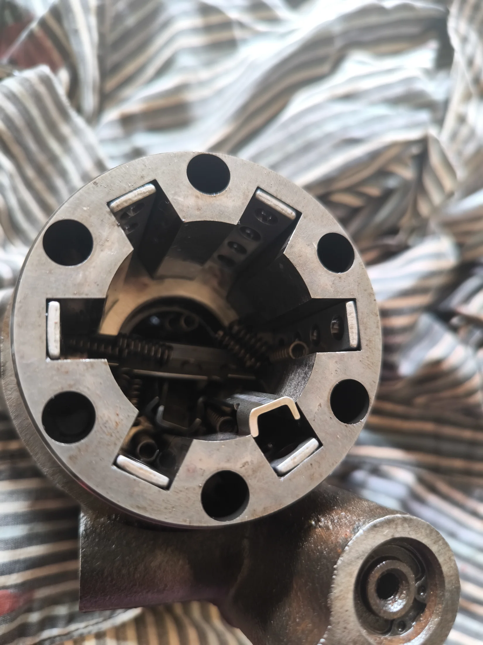

Can you guide me on how to return the slipper, when i disassemble it, the springs pushes it inwards that's why im now confused on the orientation of the slipper... I found one on the forum and it seems mine is wrong
@majdomo rebuilt his recently. Are you still needing assistance?
This is looking at the front of the pump. The open end of the slipper should be on the right hand side if it's on the bottom, like so. Just follow all the way around the circle and you should be gtg. Install with all 4 springs as a sandwich using some grease so they kind of stick like glue, with the bottom of the cylinder already in the housing, so they pop out and press against the eccentric shaft once installed. Use lots of lube on the big O-rings on either end and make sure you get all the little O-rings in the body and on the pressure regulator (?) thing. Good luck!
